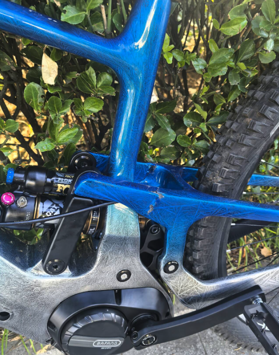

Can you post the picture here?
Yeah I heard that they are strengthening the rear triangle but like I said I have not heard or seen any rear triangles break from these older designs. All I heard that they have more flex than some people like and they would make it more rigid. I don't think the frames have had any problems with breaking.
For me I see this issue little bit different than you. The fact that they are pulling the already made parts from the market and will crush the ones they have in warehouse is only sign of good quality. Yes it sucks that people have to wait longer for the frames but I can trust on them to make sure the quality of the frame is well taken care of. The picture you were sent might have been from someone they sent the rear triangle to do the tests. Most likely not ordinary customer.
Here is what I was sent, the person was described as a "customer" and the frame is all painted so I highly doubt this was a durability test of any sort. The reported jump that broke it was about 50cm high...
I agree with with you that it's great that they're continuing to work on it and open and honest with the issues, but on the the other hand, a frame that has been publicly shipping to consumers for almost a full year and had the same problem part "fixed" 3 times to only keep having the same issue is certainly indicative of a serious problem. Had it been resolved any one of the first few attempts it would just be viewed as any normal manufacturing issue and nobody would be too surprised it cropped up. A perfect example is the i9 hydra hubs which had some bad issues early on, but they modified the design of a part and they've been solid since.
I still like LC and would buy another frame from them in the future for my next bike, I was really looking forward to the LCE971, but I just got spooked and tired of waiting, having lost just about an entire riding season on something I was supposed to have in about 6 weeks so I'm trying something else for now.

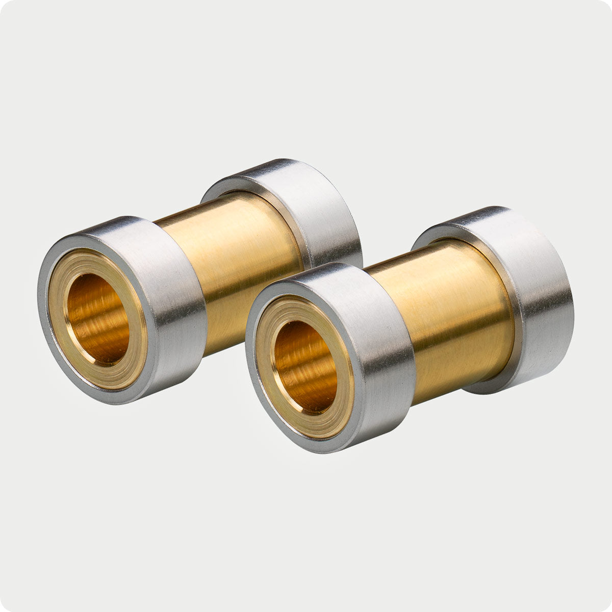

What size shock bushings do I need to fit the frame/yoke for a Fox shock? I haven’t seen the size spec’d anywhere and wanted to make sure I get the right ones shared of time if possible.
Edit: All I could find was a reference to them matching the E55 bushings and being a weird size Fox doesn’t sell of course. I went ahead and just placed an order from these guys to see if they have the correct size.

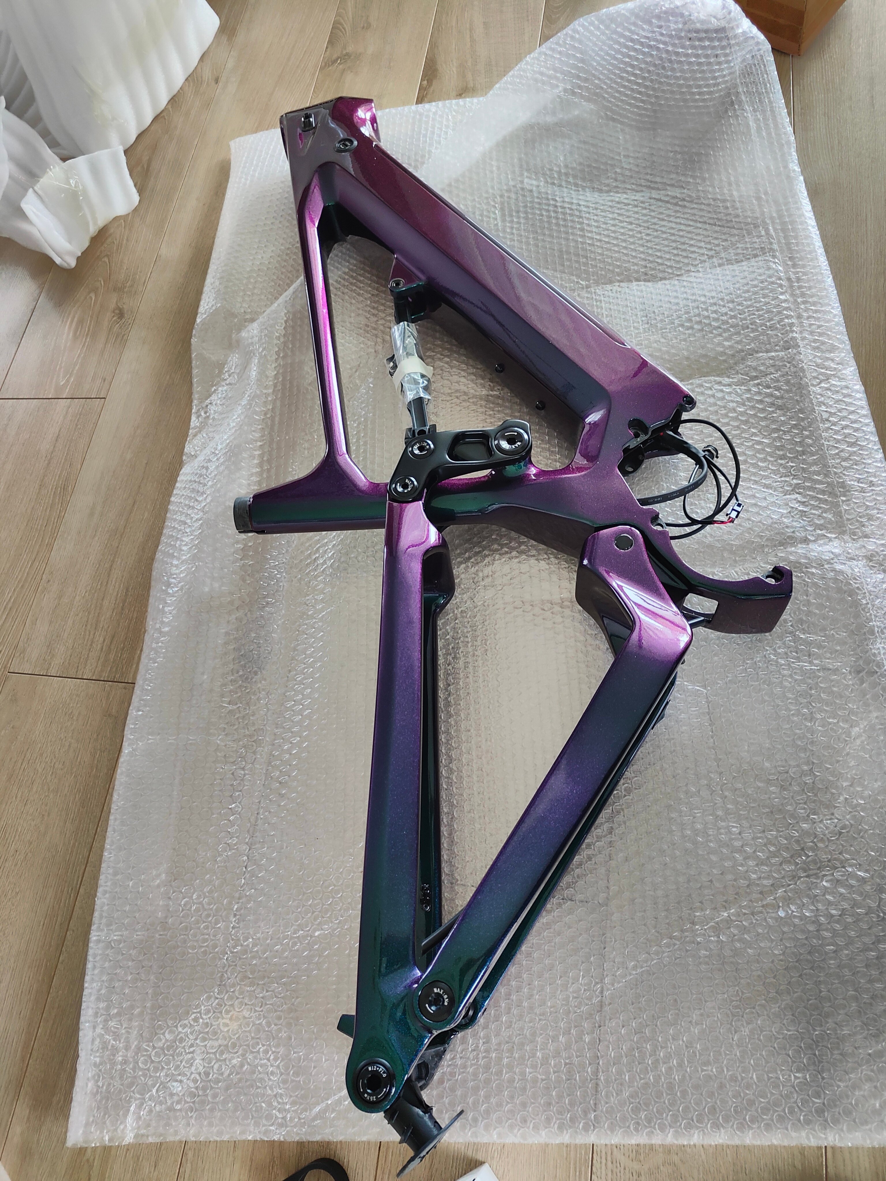

Wow!!!! the frame paint job is great.
if your ordering from Dengfu they can send them with your frame just make to mention in your order details. also you will need to use DU bushings in the shock. the polymer ones will not work
I don't know why they made it sound like their bushings were only for a Rockshox shock, likely just a lack of understanding on behalf of the person answering the Alibaba chats from Dengfu. I think the ones from offsetbushings will be of better quality anyway, so I'll stick to those.
I do have to say, it's pretty frustrating they couldn't have just picked a size that Fox/Rockshox sell standard and made it all much easier. Lightcarbon did that with the LCE971 for example, and they simply specify the size mounting hardware required on the product page.
