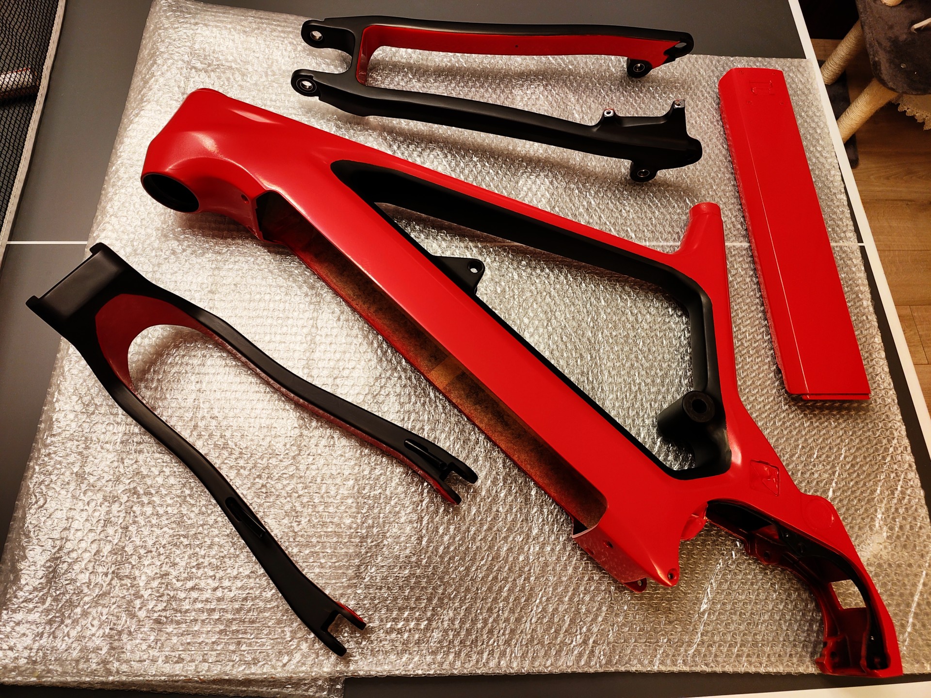

Got it, fast delivery from aliexpress.

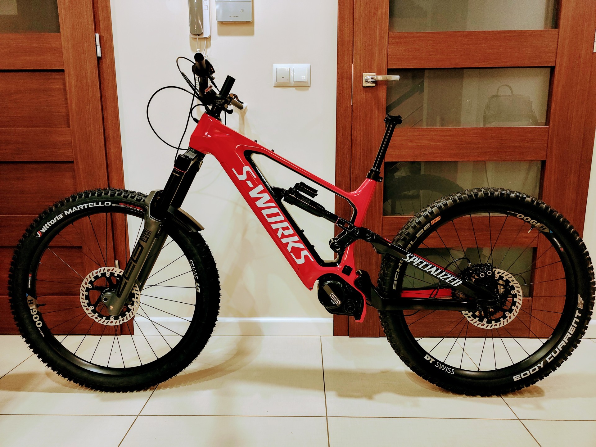

Able to get first ride in this weekend? 😁 excited to hear your opinions about the frame and motor!

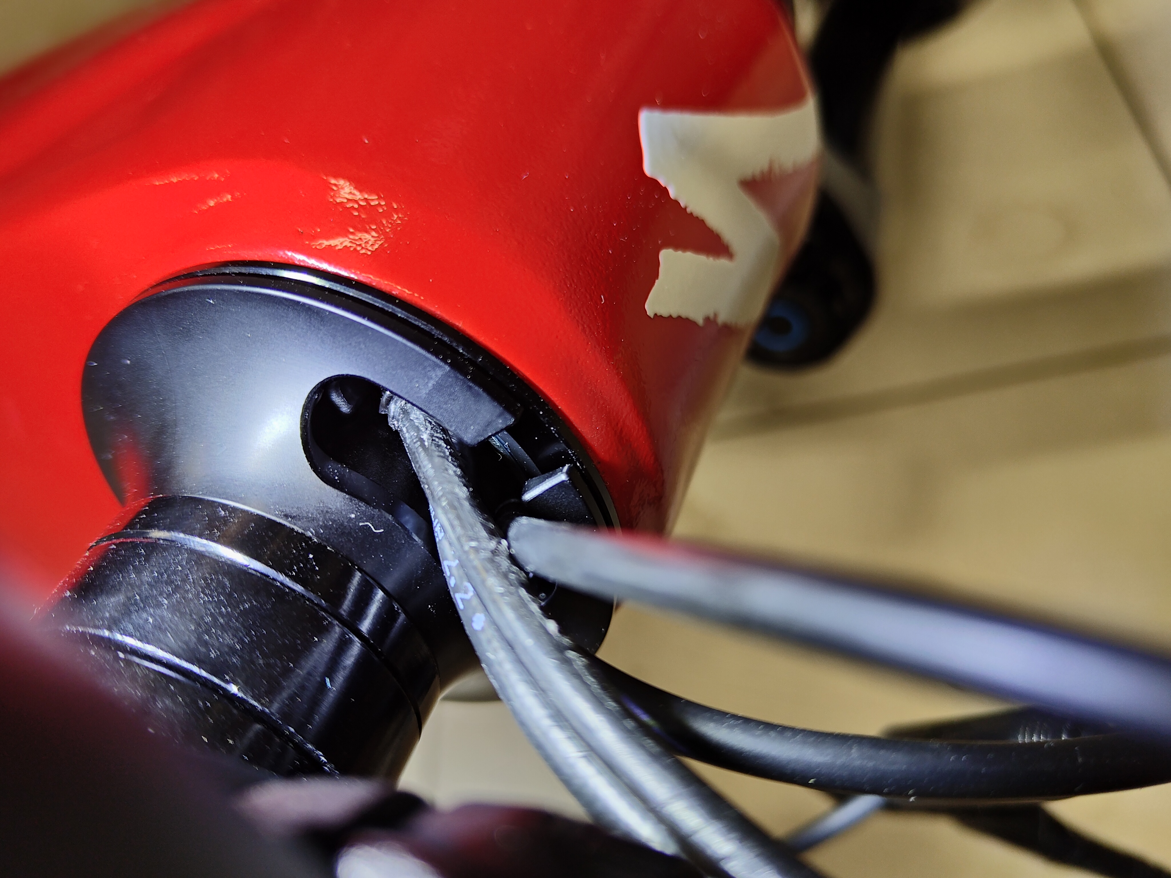

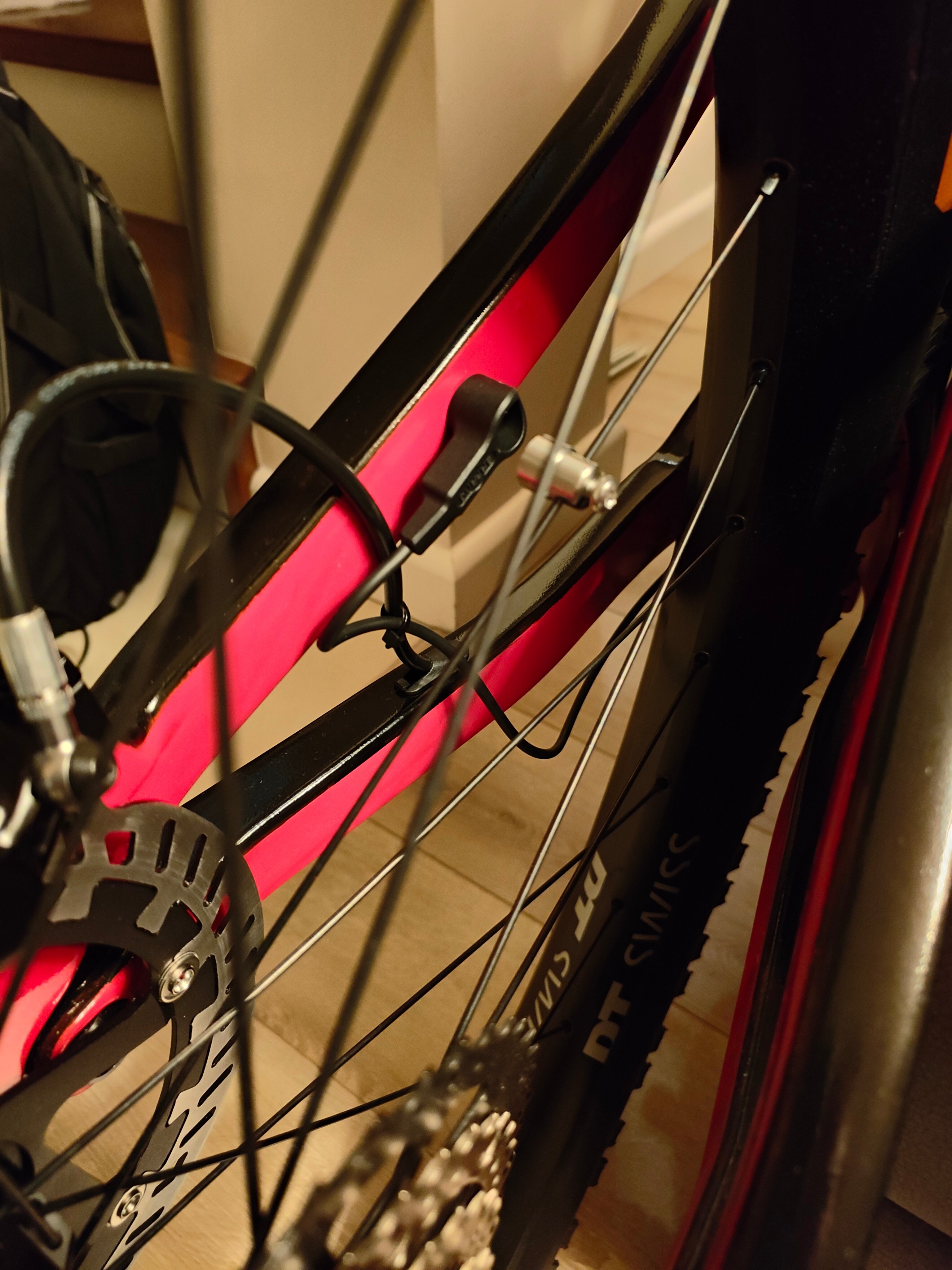

I rode about 20 km. Yes, M560 is loud, but after these 20 km it became quieter. I think that after 200 km it will be even quieter, as it was in my m620. Only 2% of the battery was consumed (mixed mode econ/sport/boost).

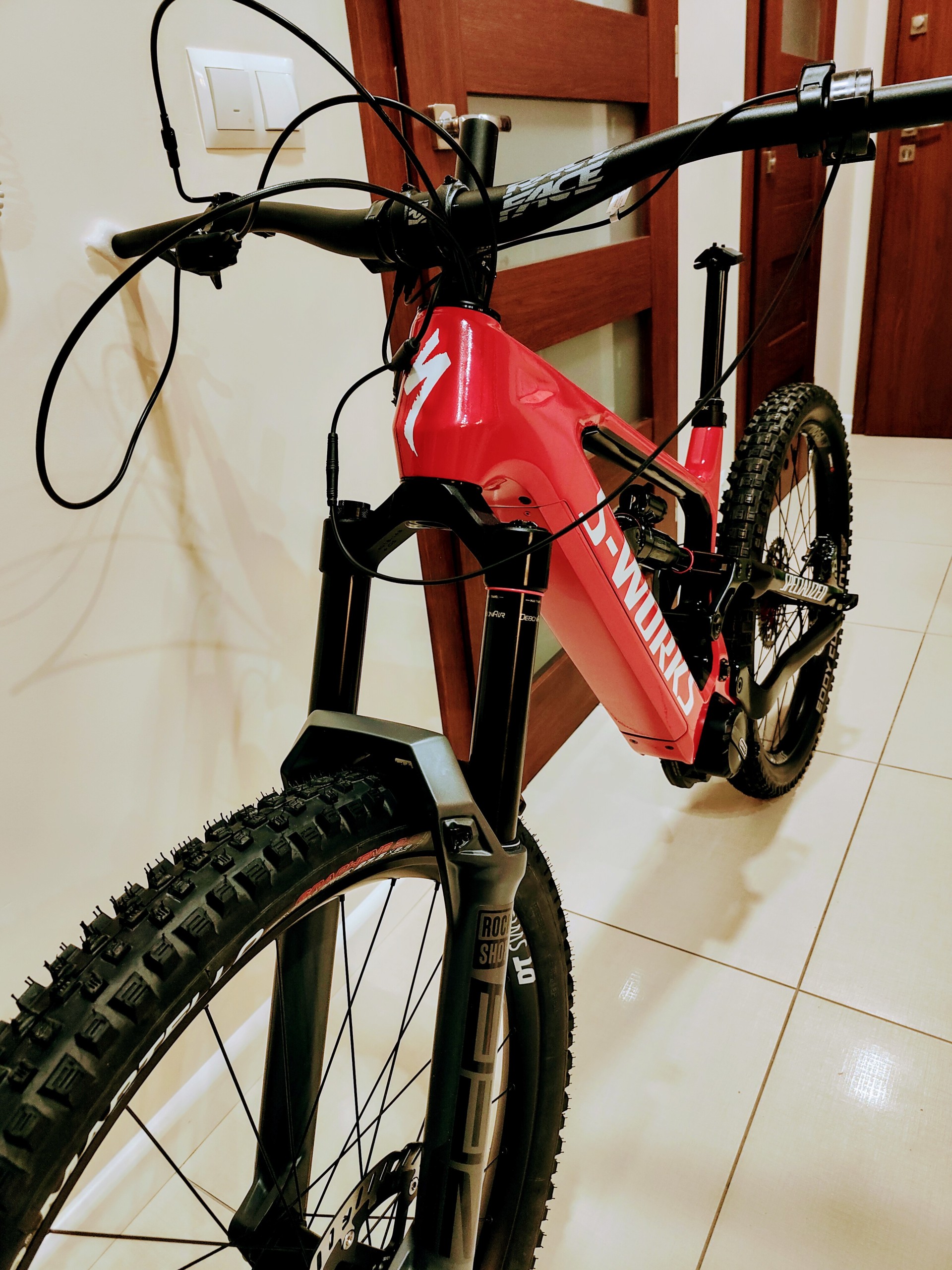

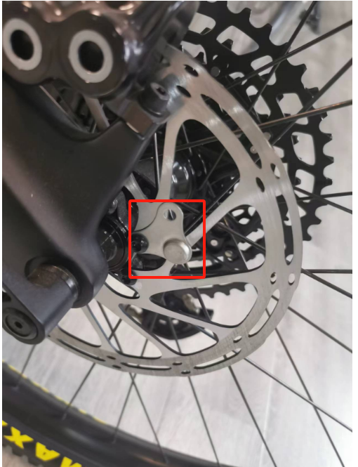

About frame - I'm not happy with the wires running through headset. It depends on how the links are set up and when turning the handlebar left the derailleur shifts by itself and when turning right my dropper extends :) I need to improve the routing of these lines. Dengfu recommends that the speed sensor should be installed close to the disc to which the magnet is to be attached but I did it a different way. The battery moves and rattles, which can be heard when driving over small bumps - I stuck a piece of foam to the cover and there is silence.
Yeah, I'm planning on asking Dengfu to make holes in the frame near headset and use those instead of the headset cable routing. I guess you can get the headset cables to work if you are able to get everything perfectly in place but I wonder how long they will stay in place. Headset cable routing is terrible idea.. I hope they won't force it in mtbs in the future.
What's the difference between your magnet placement and dengfus? What made you do it that way instead of the recommended way? You found some pros/cons with these different placements?
Is the battery with the mounting points moving or the battery only? Or was it the battery cover which rattles against the battery? Definitely seems like something isn't like it's suppose to be. Why would they intentionally desing it so. Or maybe this is one of the problems with these early frames where they test things out.
Have you contacted Dengfu about the battery rattle problem? Really want to know what they say about it.

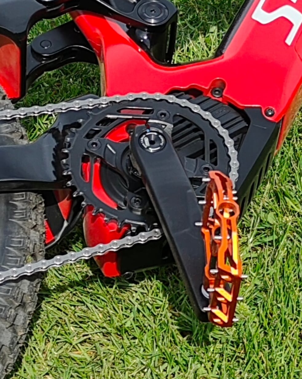

What's your setup with the spider, chainring and cranks? Did you get those with the motor or purchased separately? Is the chainline perfect with that spider? Haven't found information about what spider I need to get so it works with the frame. I'm hoping to find 160mm cranks for myself.

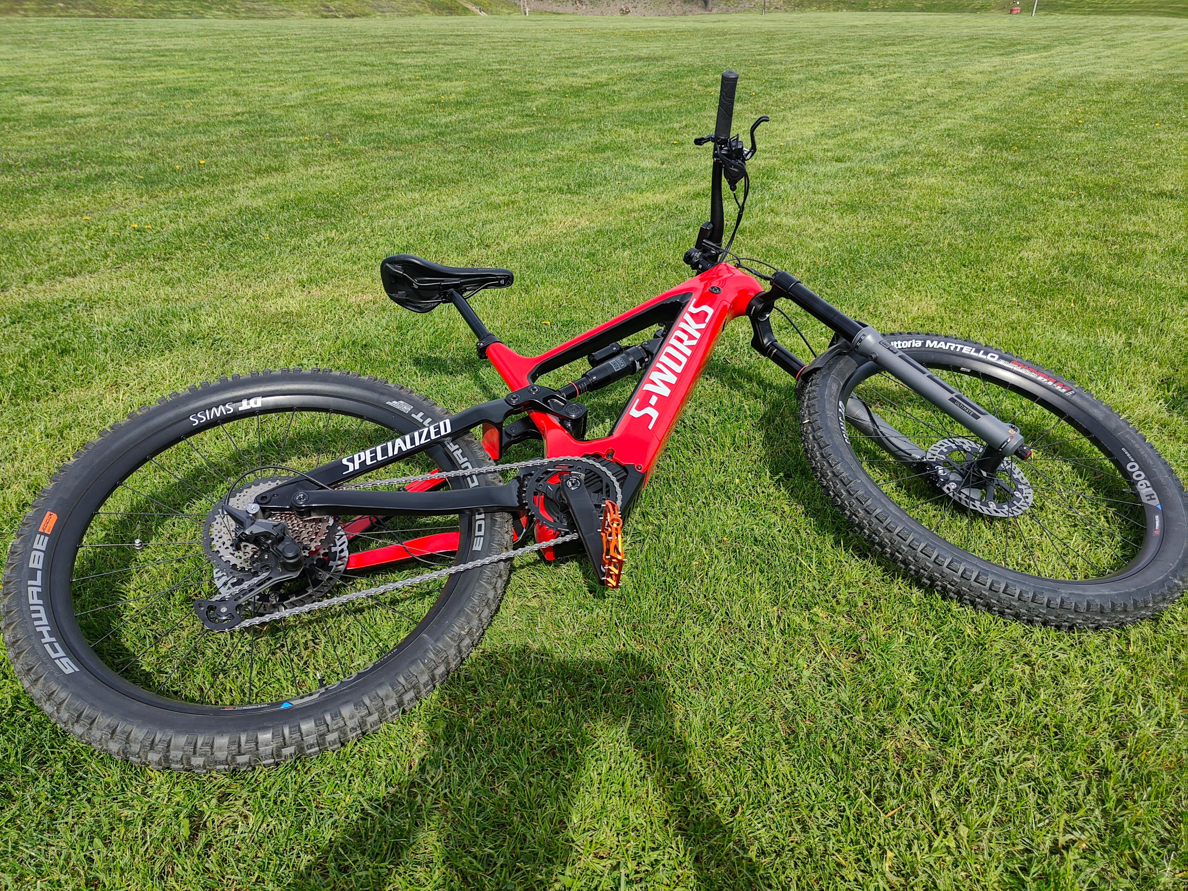

See photo. I don't have magnet and sensor that would fit such a solution.

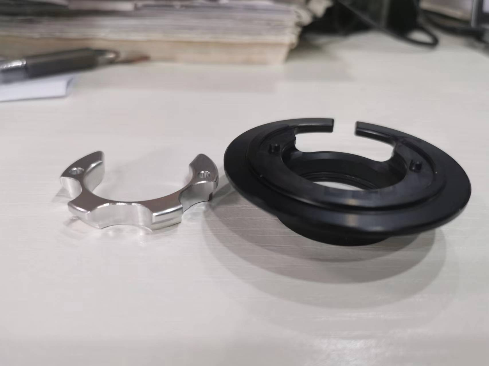

I agree with this.
I think that's it.
I contacted Ben about hedset routing problem and I got the answer that they have improved this and he will send me new designed headset. This is terrible, look what condition are the cables in after 20 km...
A get those with the motor. 38T and 11-50T rear. There's no ideal chainline, but nothing bad happens under heavy load.

It would be better if they brought back the normal wiring ports in the frame. So many movements and all for nothing.
I disagree with you ; if cable routing is done correctly, it's both aesthetically pleasing and functional. There are just constraints if one wants to service the bearings.
patdam
Jan 17, 2019
945
608
france
i disagree with you. With battery it have too lower space on ebike to allow easily cables/wiring translation, sometime when you fall with MTB the handlebar can make 360° and done too many constraint on cables.
iscander13
Oct 11, 2021
185
59
earth
If you have your bike serviced in a workshop, I don't see a problem either.
But I have to service the bike myself, in which case it will always be damaged cables and problems with removing the fork every 50 hours.
Not to mention what patdam described above.

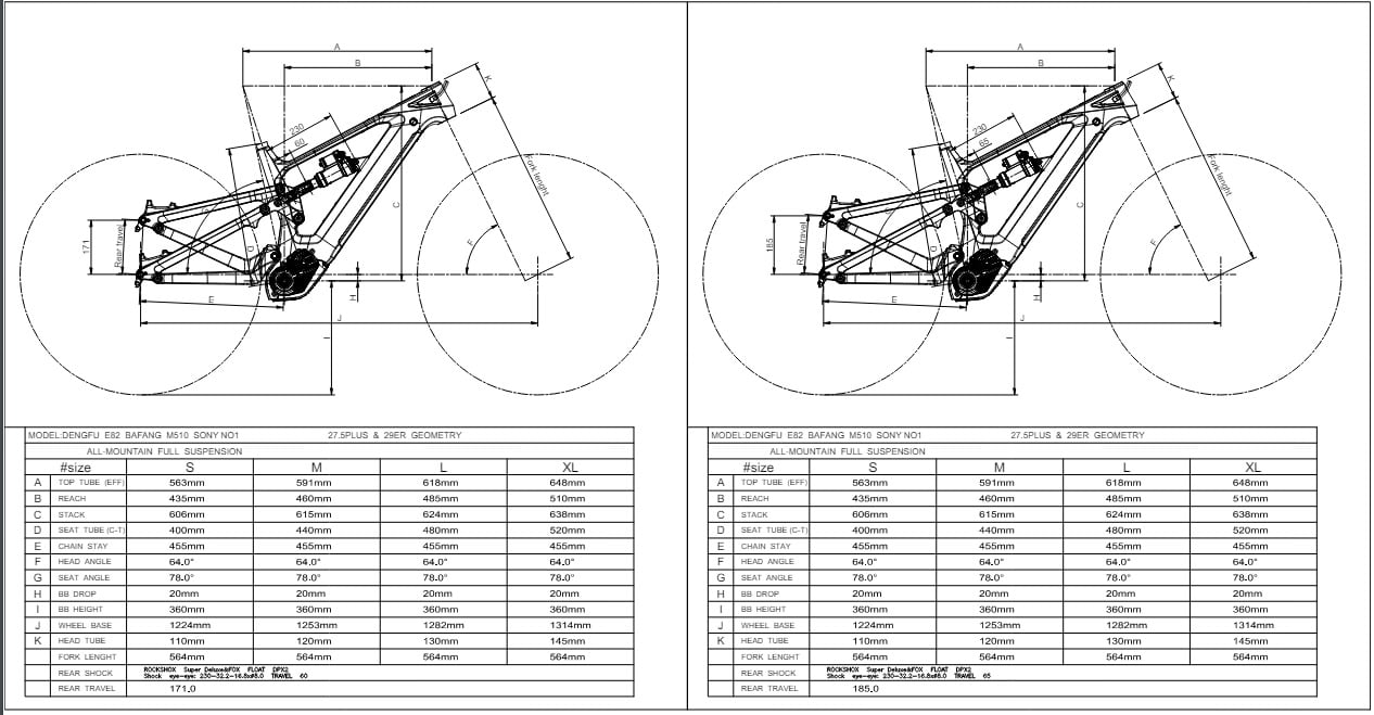

More chat with DengFu today and I discovered that this frame also accept a 230x65mm rear shock, thus reaching 185 mm of travel as per attached geo chart; interesting if building it as a big enduro/ freeride bike when paired to a 180mm fork IMHO.
Another important aspect is that they're now providing E82 frames with a conventional internal cable routing instead of the ICR.
