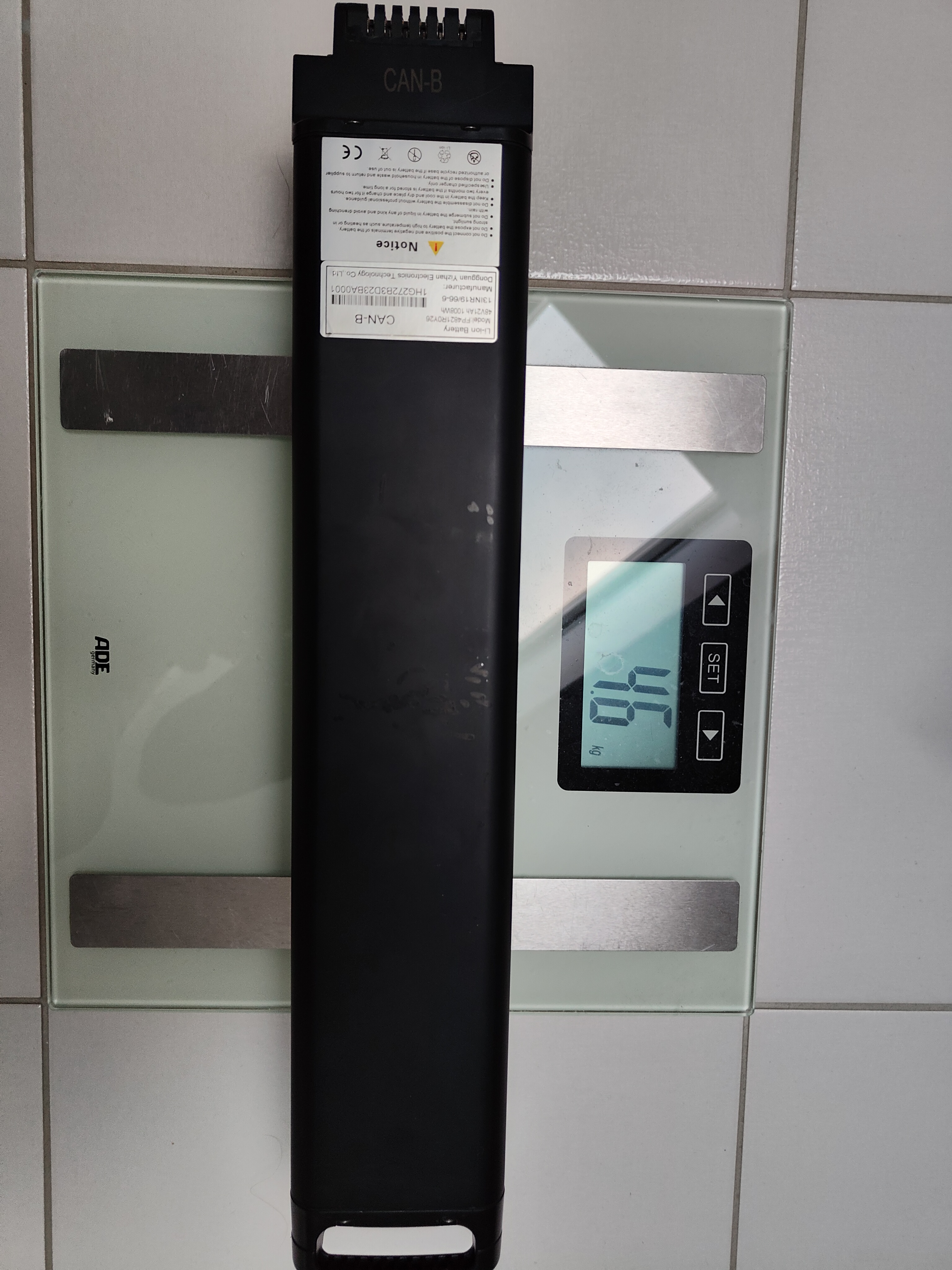

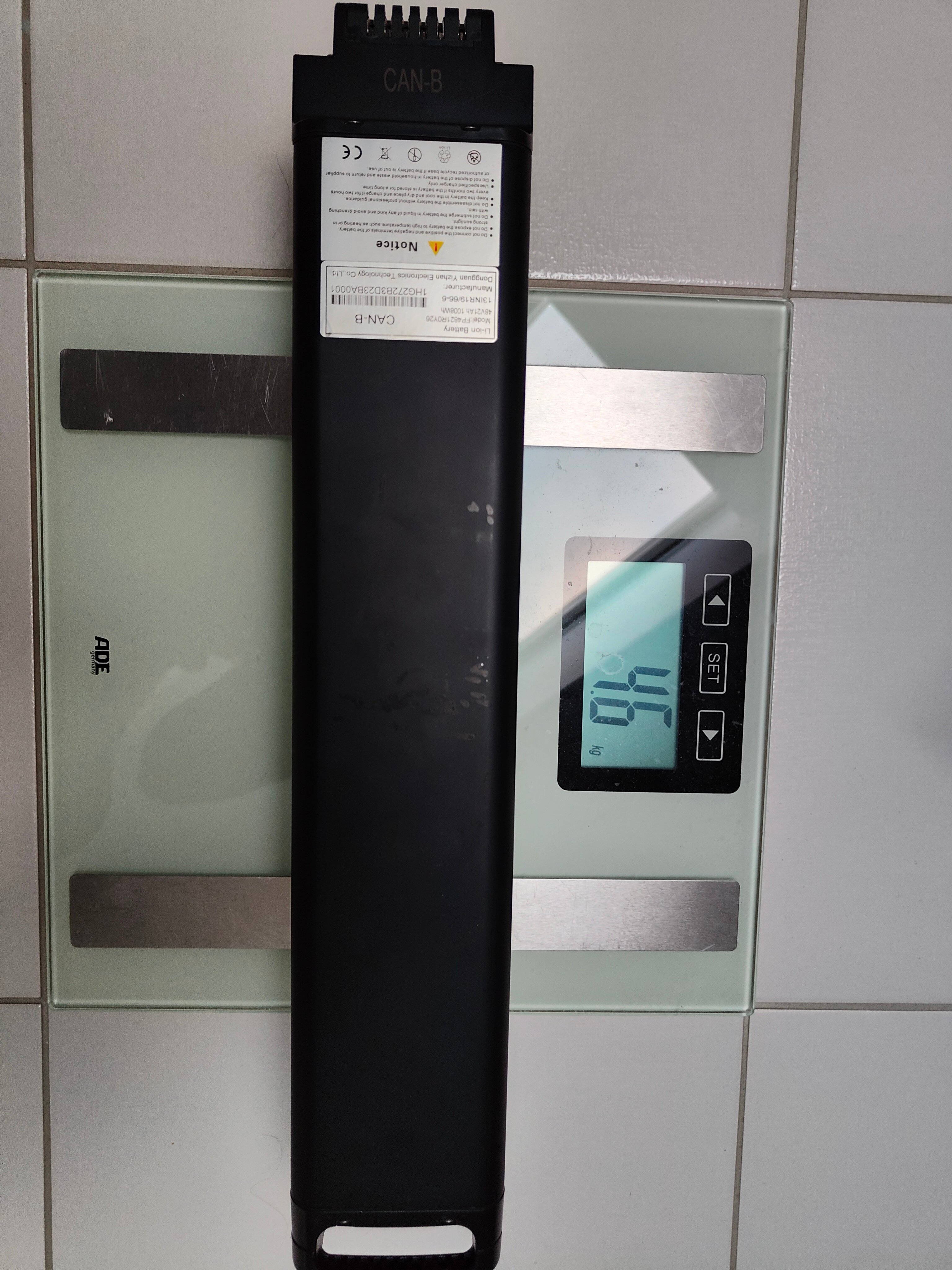

The frame weighs approx 3850 g. ( frame, battery lock, battery socket, derailleur hanger, battery cover, seatpost clamp, all screws).
Battery weighs 4600 g.

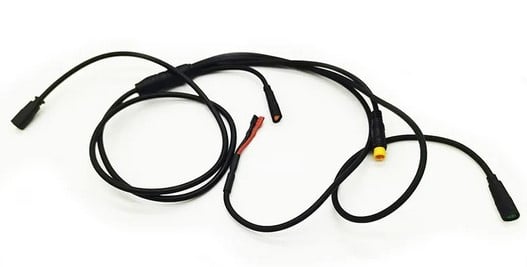

Battery has canbus plug in slot, but the cables supplied with the motor don't have it (3T cable).

Can you provide the alibaba contact?
Is it possible to connect canbus battery to T3 motor? My knowledge with wiring is abysmal.

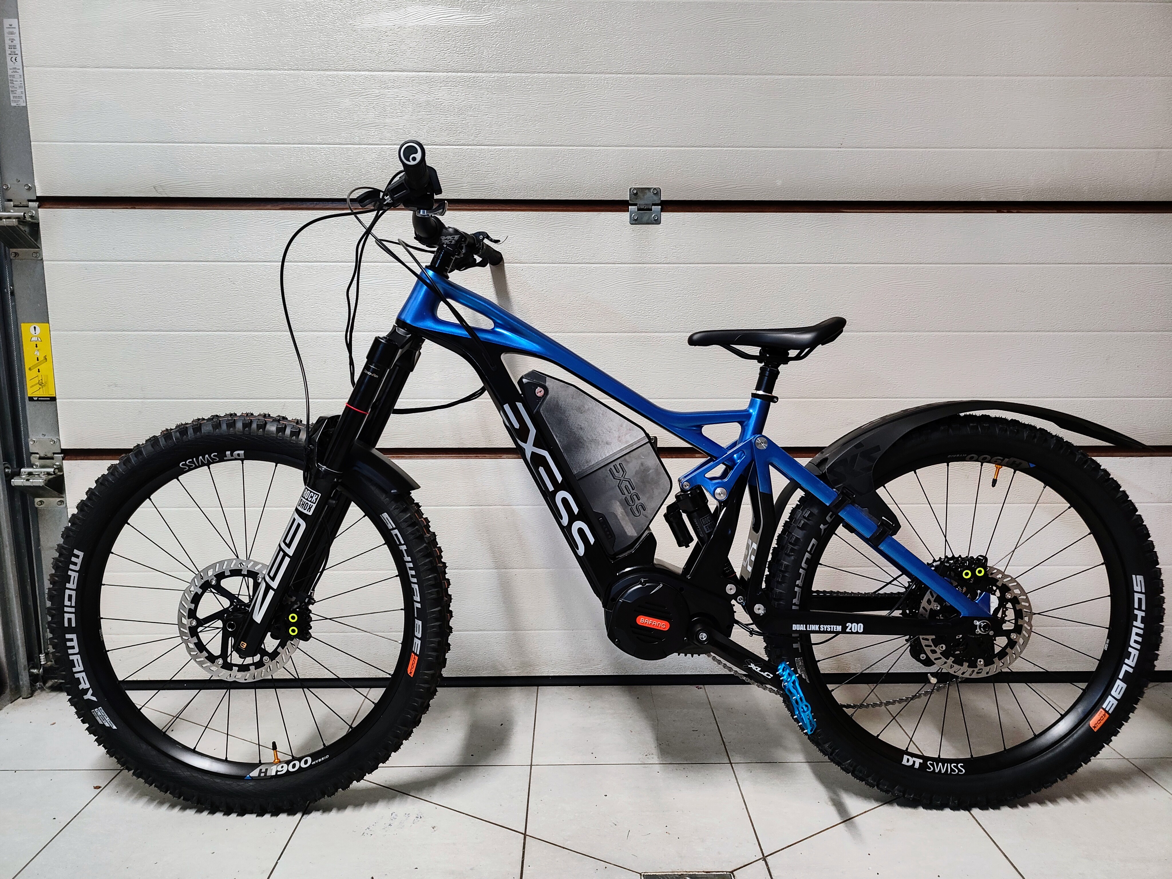

More pics and info of the build and frame please! 😁 what fork and shock are you going with?

Search for Ben Dengfu for frame and chili Shen for engine on Facebook. They will provide you and prepare order on alibaba. You can connect battery to display but you need eb bus 4T cable with extra connector for battery. Standard 3T cable doesn't have it. Im going with rs zeb ultimate charger 3 and rs super deluxe select. Will paint frame this week.

Frame seller should add you the cable with appropriate cables to have also CAN battery connection. I suppose from big battery socket is running extra CAN orange 3 pin triangle cable. Right? I saw already 3 different types of connectors to CAN battery. :(
1T3 cable (display, battery CAN and light) you should be able to find on Ali. 1T4 (with throttle connector) is little problem to get.
Oh…almost same frame weight as the E10, and the battery is 600g heavier at 1008 Wh then 840 wh E10 battery at 4.0 kg….

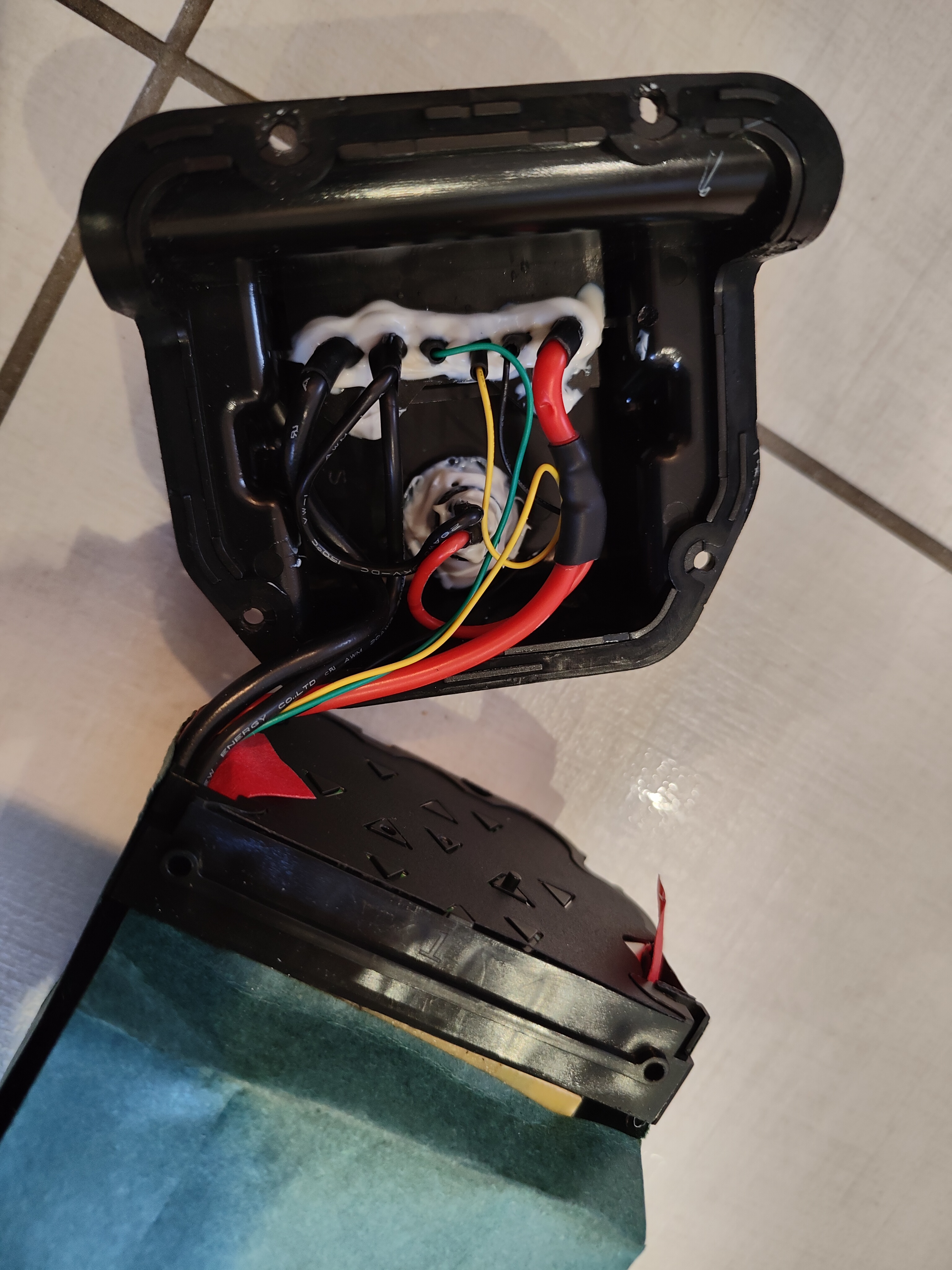

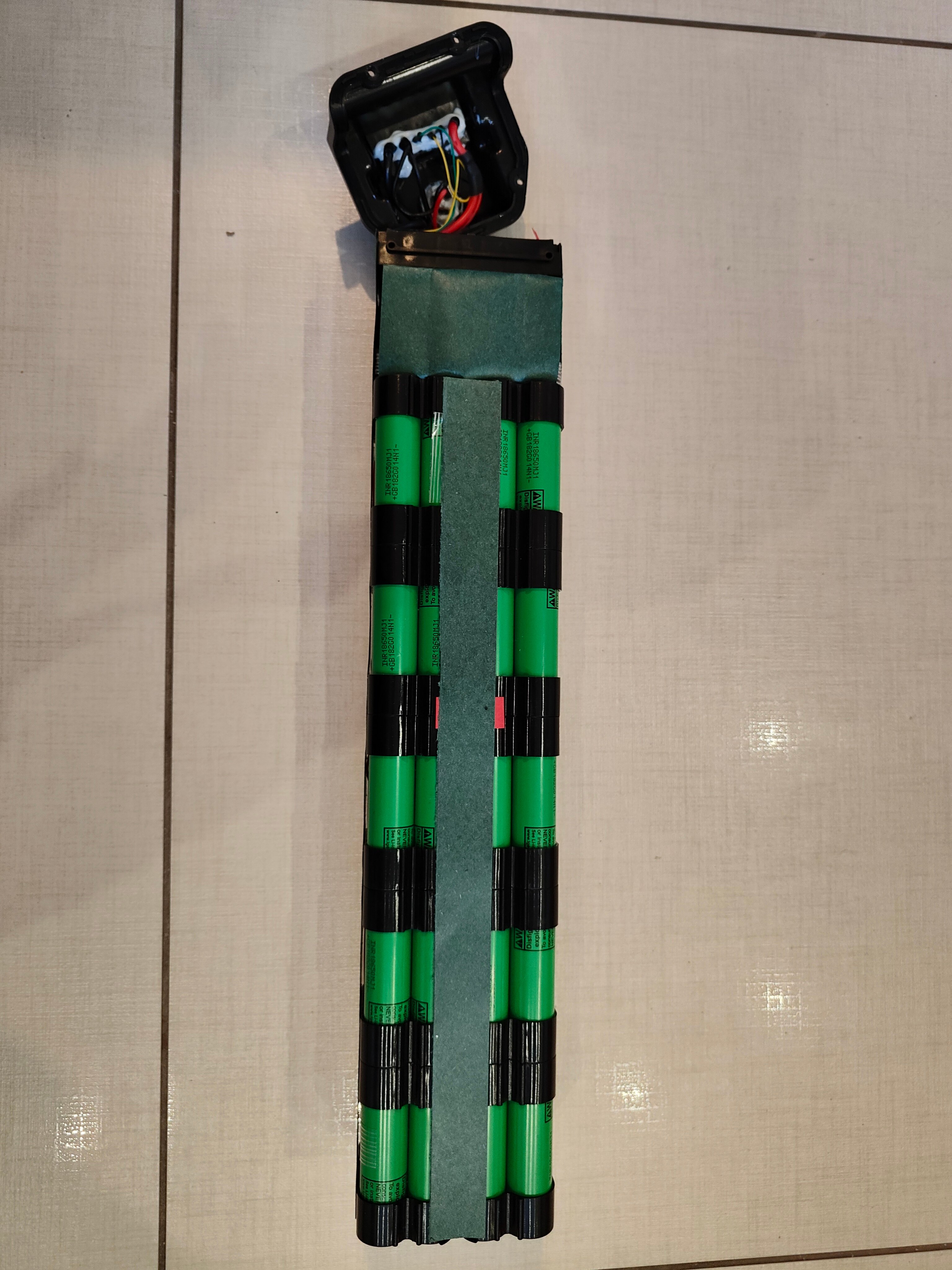

Hello guys. Is there anyone who built or are building an E82 ebike can send me the scheme of the battery? I purchased only the empty case, since I already had the cells and BMS but I am having a hard time figuring out how to build the battery pack properly. It fits 80 18650 samsgung 3400mah cells inside the case and setup is 13s6p.
_gregor
Mar 16, 2024
68
91
Poland
spectra
Apr 4, 2024
Brazil
Dear Gregor, thank you for the photos. Did you built the pack by yourself? I need to understand better the wiring below that green adhesives and where the zync plates goes before going to the BMS. Therefore I need some more detailed photos which I believe will be hard for you to take it, because envolves taking apart the adhesive and plastic structure. I asked Dengfu and I am waiting for their reply.
_gregor
Mar 16, 2024
68
91
Poland
I bought it already made from Dengfu.

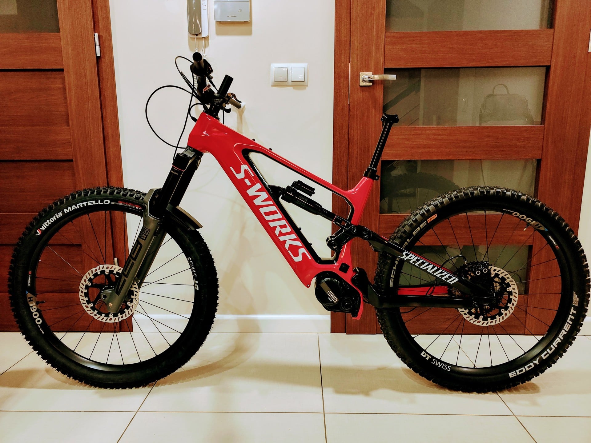

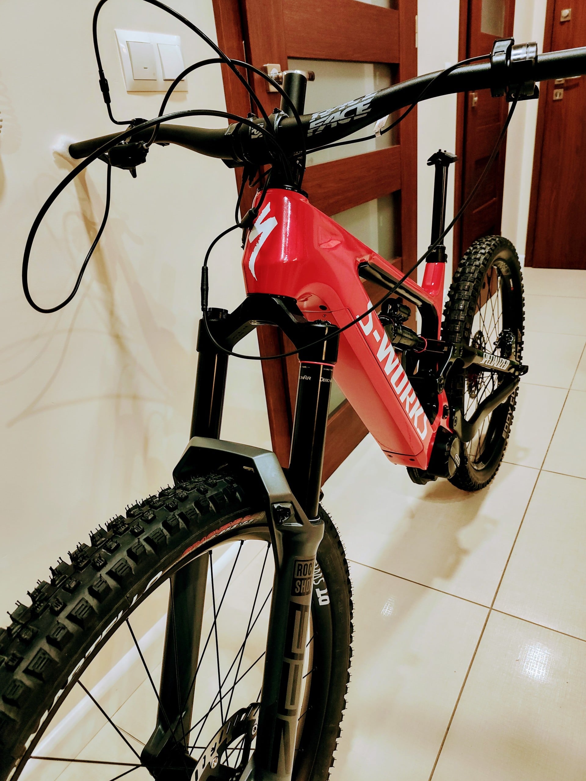

_gregor
Mar 16, 2024
68
91
Poland

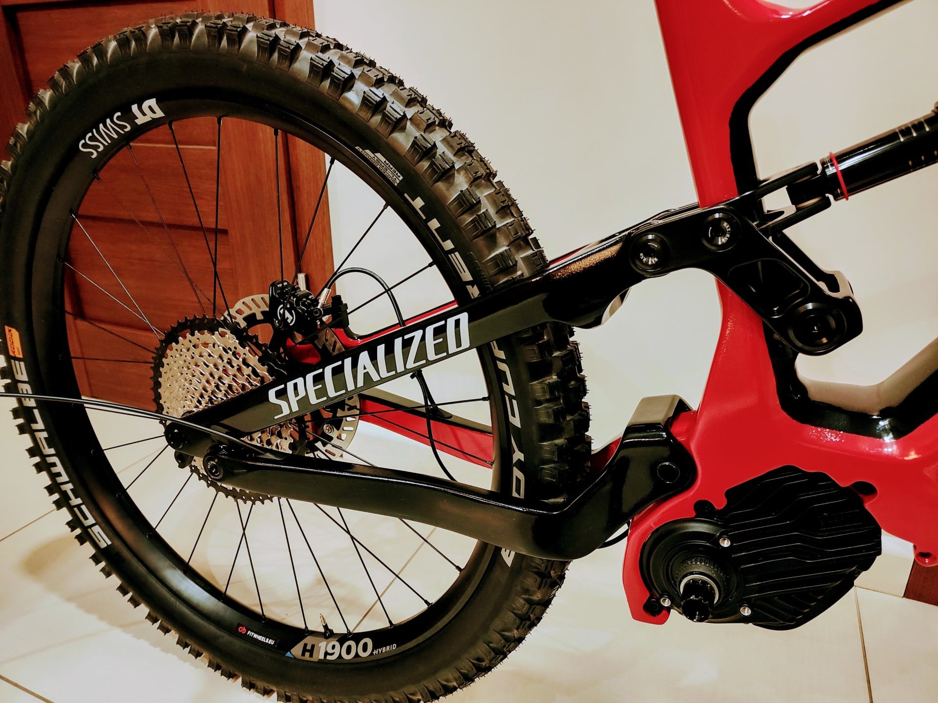

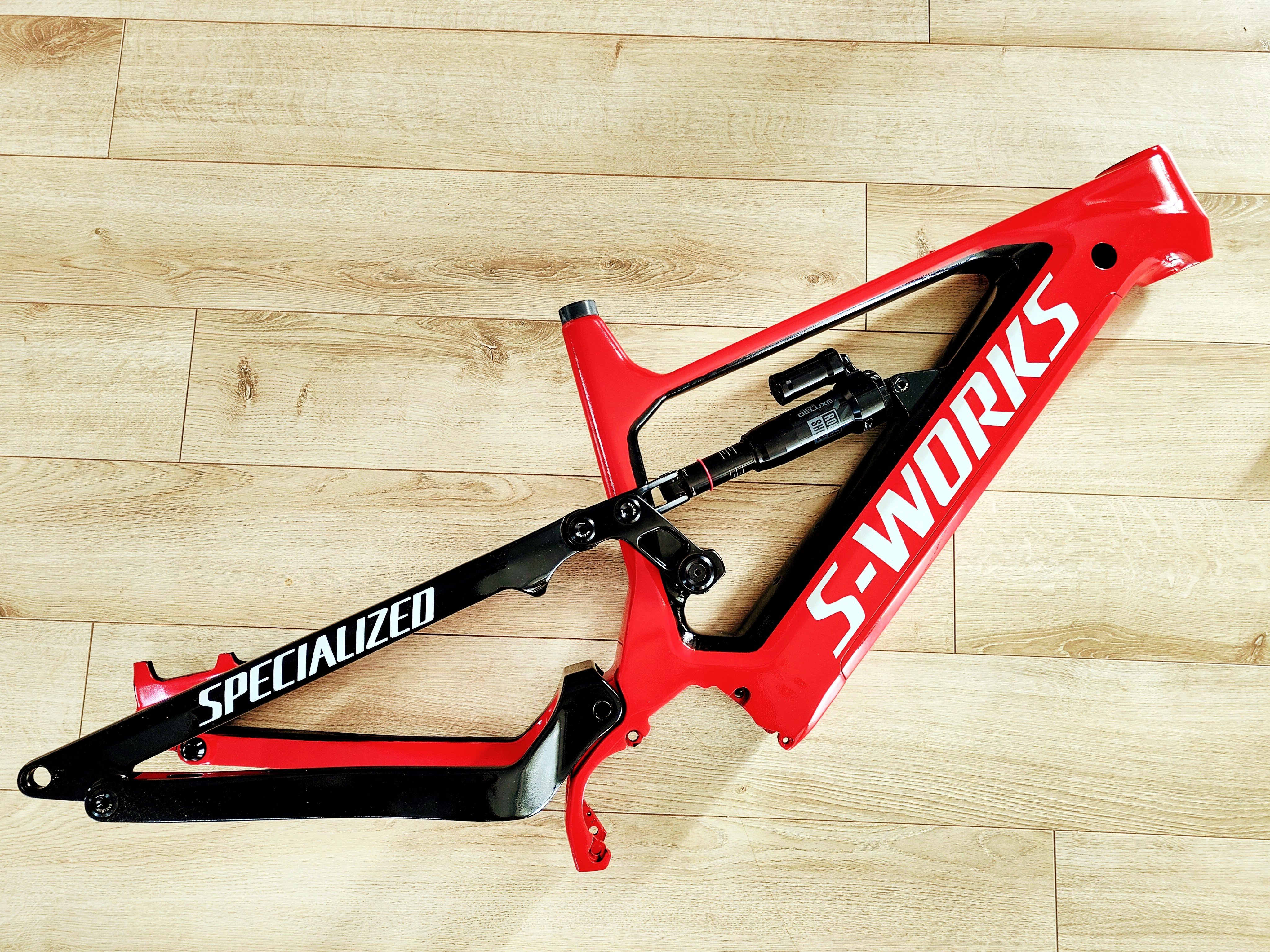

Did you do the painting yourself? If so how was it? What made you go with the specialized theme?
I did the painting myself. I used acryl paint and 2k klarlack.
I was looking for stickers quickly and these were the right size for this frame. I'm not a fan of specialized but it looks good for me :)
