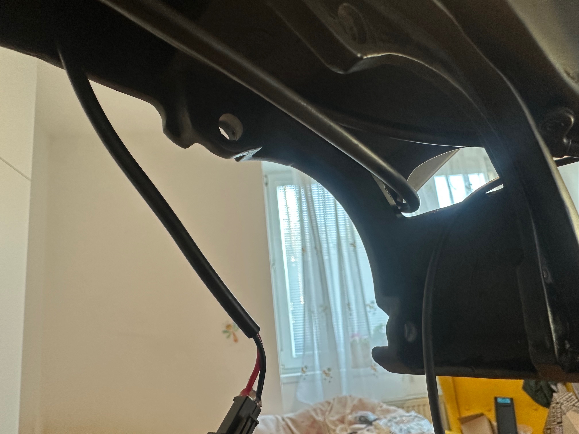

My one outstanding issue is still getting the Dengfu battery to work. I ripped the motor out last night hoping to find a loose connection for the battery CAN wire, but no luck. Wiggled all the wires, tried reseating things, it just won't power on. I think the battery itself is fine, I get 44V between the first two pins which I assume means the battery has some juice. I don't know if something is messed up in the BMS or my wiring harness is bad. I ordered 2 more 1T4 cables from Aliexpress this morning that will probably take 2 weeks to get here and then suck to install, but if that doesn't do it I'm not sure what the issue might be.

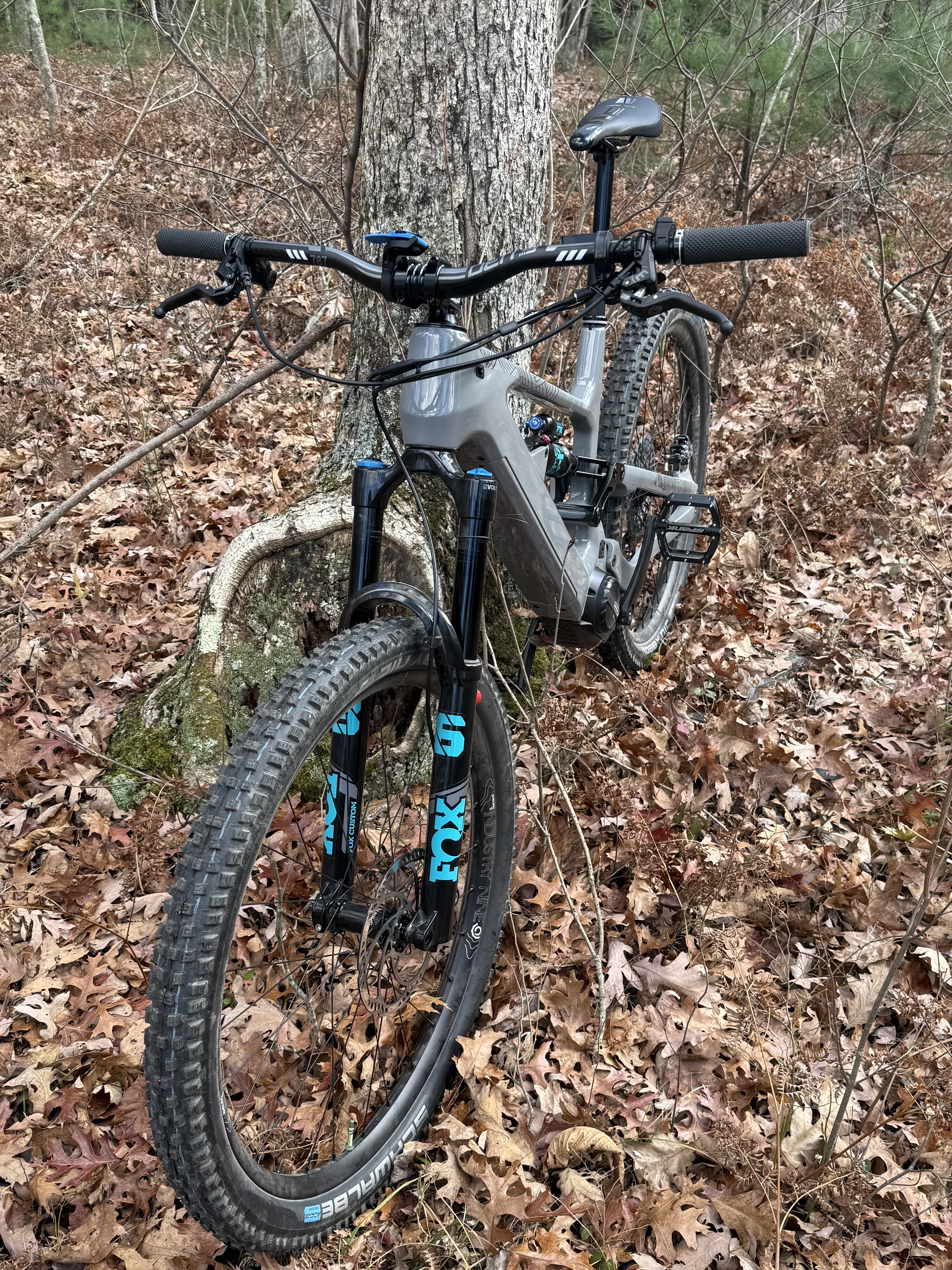

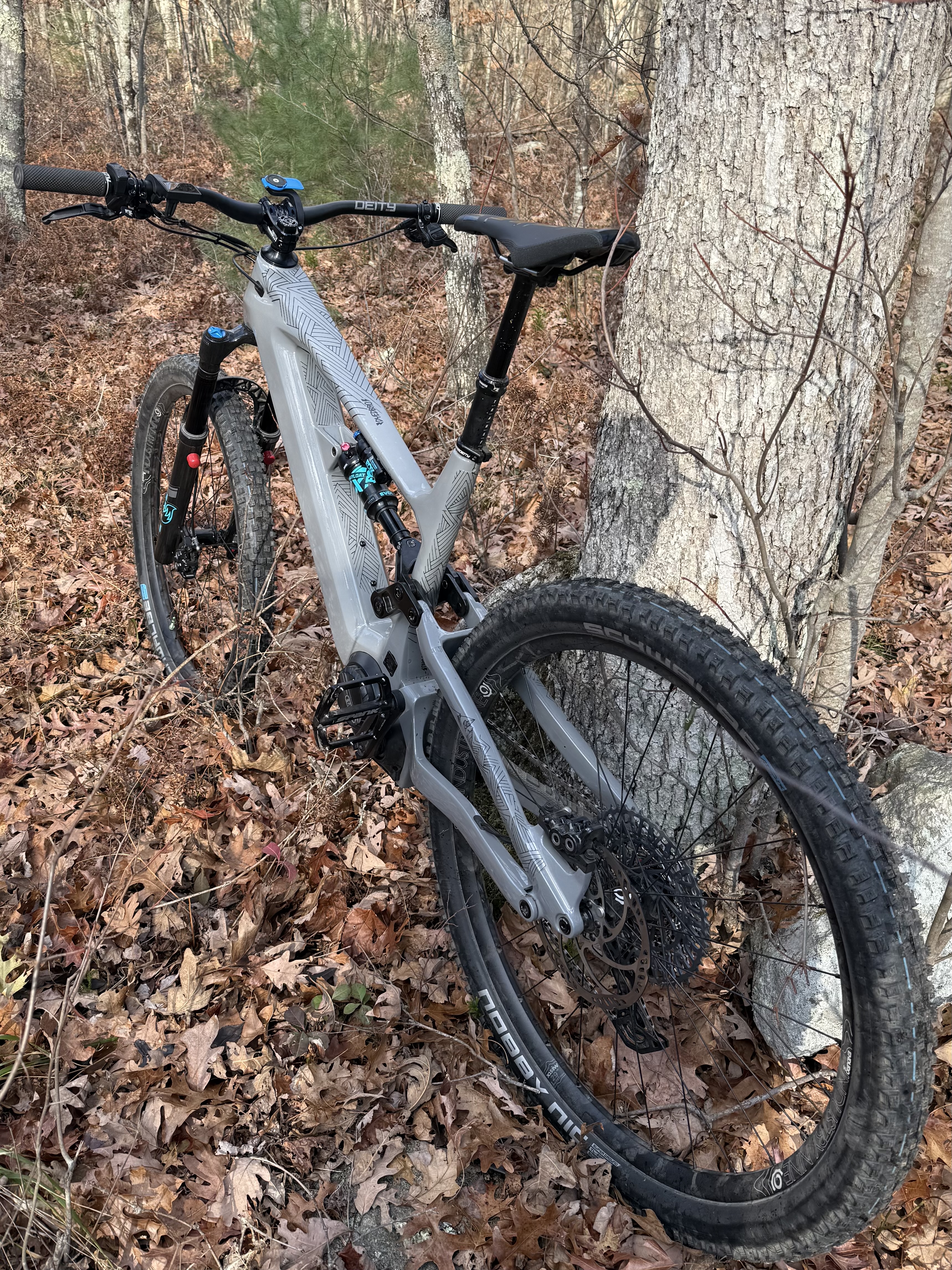

A quick update after about 45 miles or so over last week across a few rides. Everything still going great, no issues that I’ve seen at all and bike is a blast to ride. Hopefully my Dengfu battery works with a new CAN cable, although I really have no need for a bigger battery at all, the 720Wh is plenty for me.

clean build 👍
hope you have a lot of fun with it
i did see one thing tho, you running a speedgrip up front ? i would change that to a supertrail otherwise its going to be slippery when wet...
i used these tires for some years and i also use speedgrip but rear only. even there it feels to slippery when wet.
They are, yes. These tires should have just been sent back when they arrived in the wrong casing but I just kept them because the retailer gave me a big discount to keep them. Wasn’t the best choice in tread, should have gone with something a little skinnier, and probably the wrong compound.
With the weather here lately wet is the least of my concerns, we’re currently under “severe drought” conditions where I live, and combining that with the immense number of leaves that have fallen in the last few weeks makes for conditions where you can’t even see the ground most places you’re riding. The dry leaves all stacked onto each other is like trying to ride on a bunch of pieces of paper, you just slide right out anywhere you attempt to break with any meaningful force or lean the bike in a turn and usually aren’t able to regain traction either.
I’ve already had the front wash out on me twice where they were layered up real bad. The tire will grab the first layer of leaves of then have the leaves it grabbed onto work like a ski on the 5 layers below.
I plan on replacing the tires with a better suited setup, probably in a 2.4” width at some point. I was reading about the Tannus inserts and they sounded pretty cool. You get many of the benefits of both tubeless and tube setups in one, and it often ends up being a bit lighter than a CushCore setup due to not having sealant or needing to run as thick of a casing tire.

Figured out my silly battery issue with the big Dengfu pack - Someone on Facebook said theirs did something similar and throwing it on the charger “woke it up”. It sounded ridiculous so I tried it, and low and behold it worked, couldn’t believe it. All I had to do was plug the pack into the charger for a minute and then threw it into the bike and it powered right up, his thought was that they go into some sort of weird sleep state if not used for a long time. The battery clearly wasn’t dead and needing to be charged, it was at 70% when I got it to turn on.
