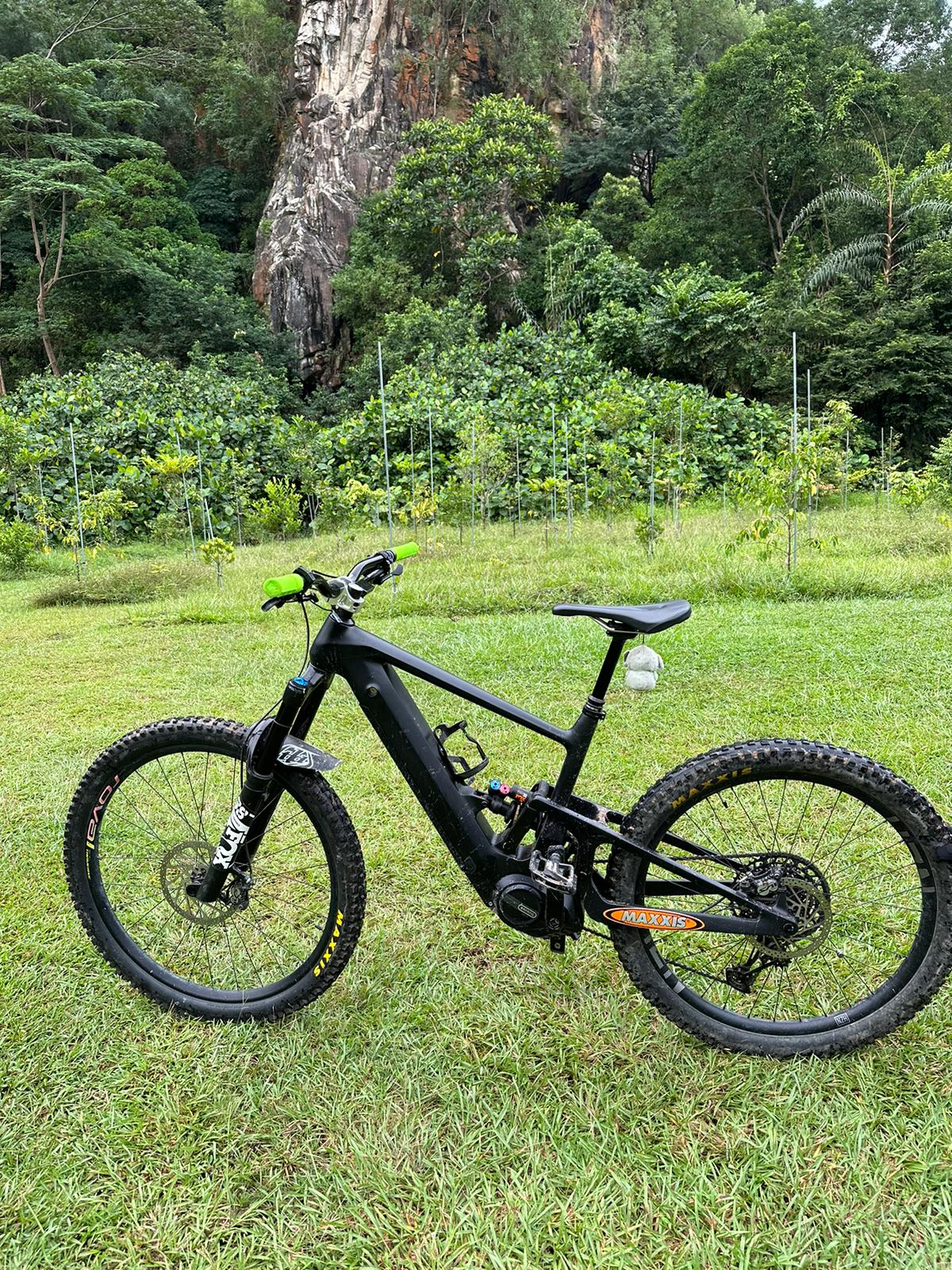

Option for chain guide ?
The chain guide is compatible with the motor (for example: Bafang M510).
You just need to order a chain guide in the "ISCG05" format.
