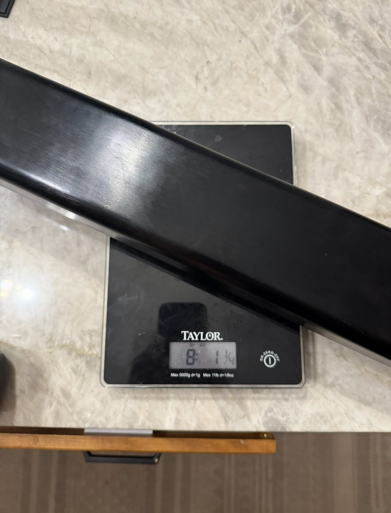

Used a dremel to up my hack job with the angle grinder and found some enamel epoxy appliance paint that blended in with the anodizing fairly well. With this section being something you never really see at all I’m fine with how it came out.

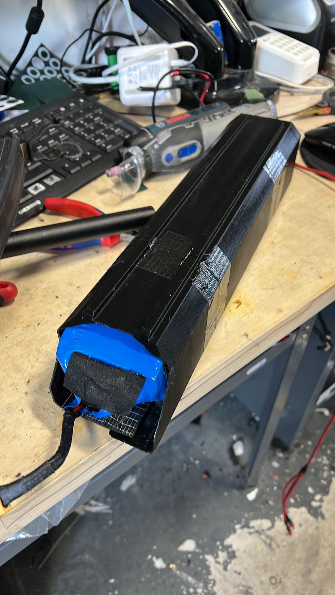

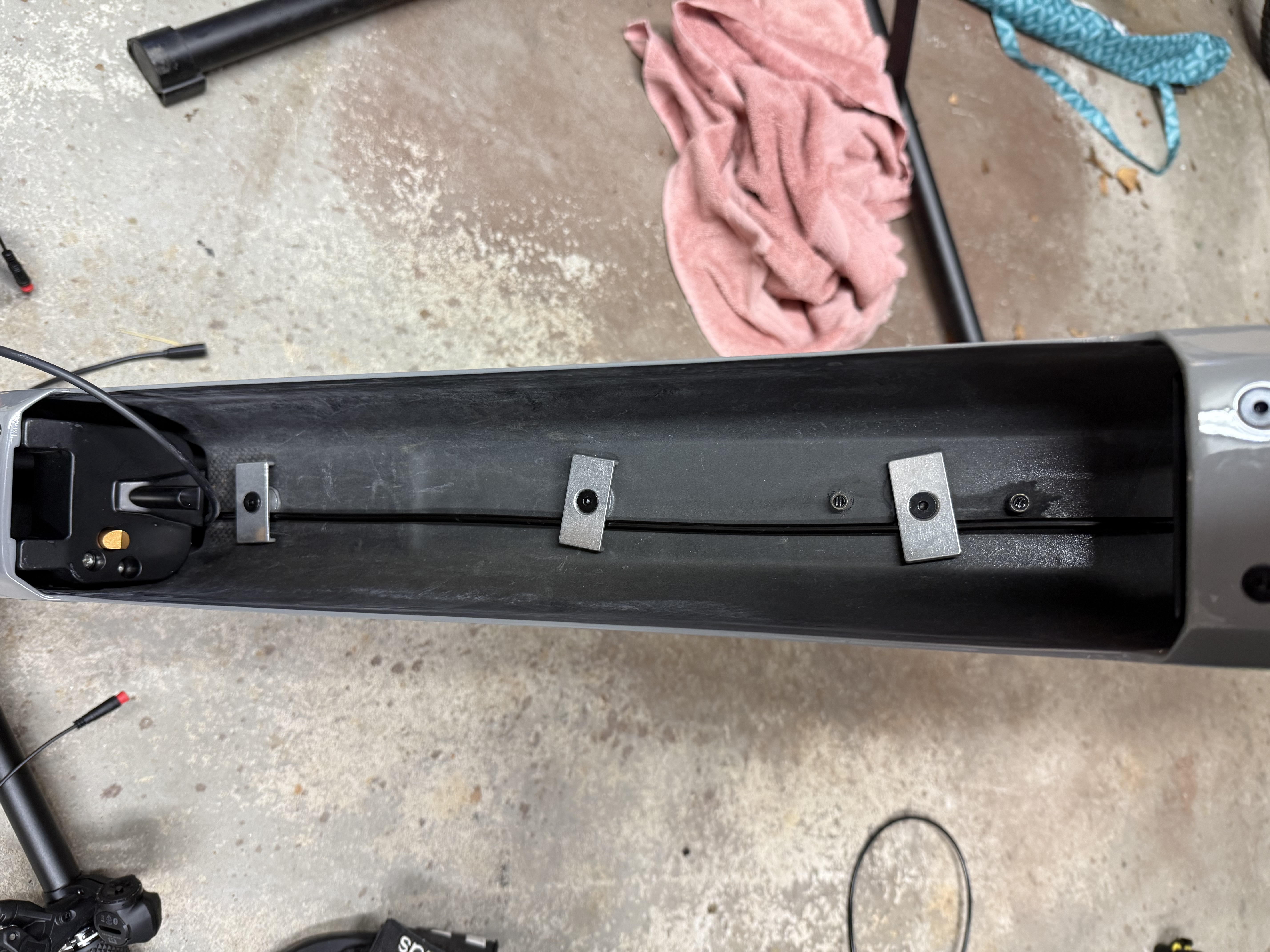

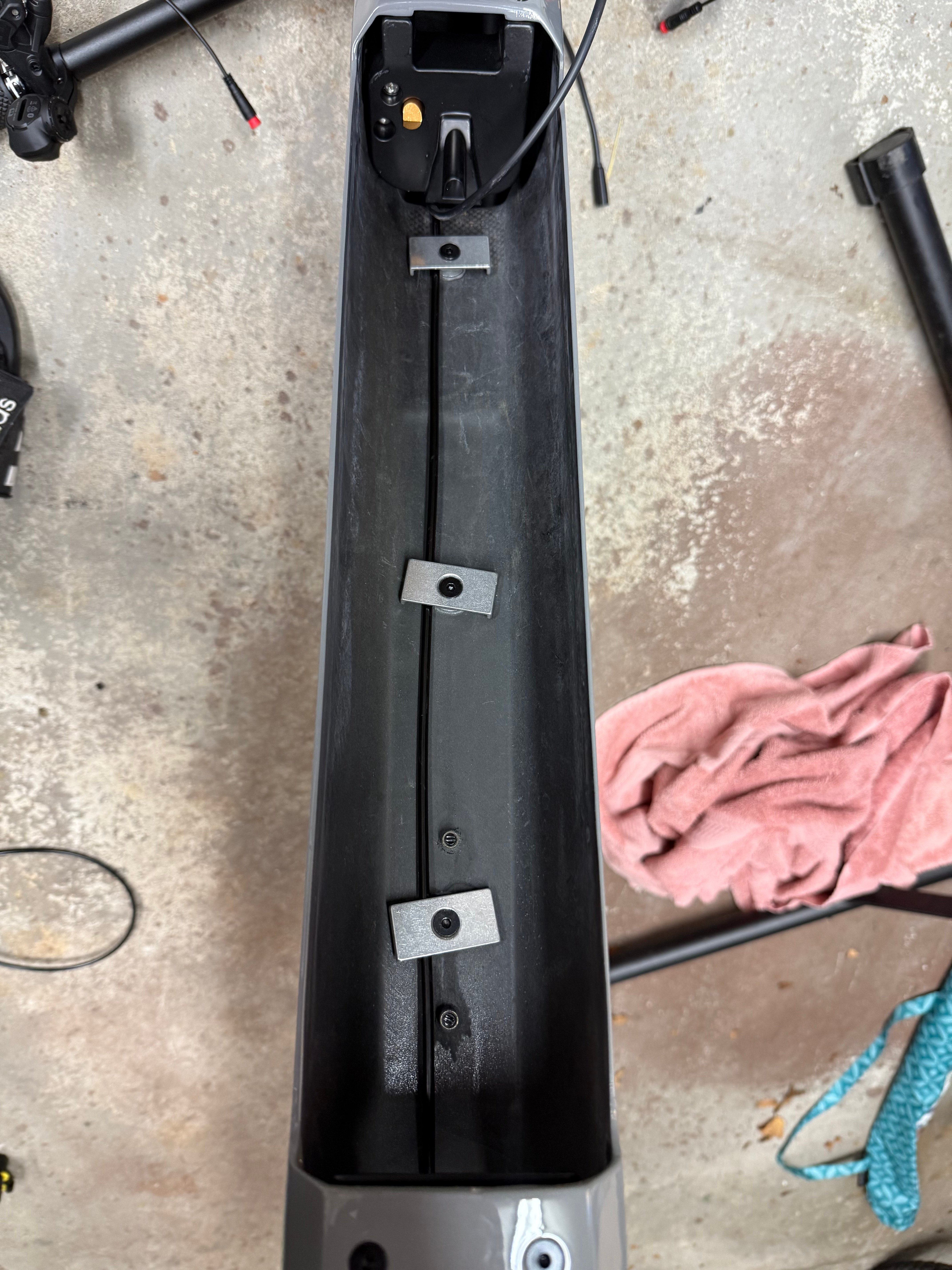

Speaking of weight, they put these nice clips to secure wires in there, but they definitely could have chosen something lighter to make them out of.

I did buy an extra battery case that I now have, I was hoping to slide the pack from the LCE971 into it to have a much lighter 728Wh battery. It’s going to be very tight, I only tried messing with it for a minute so far, the cells definitely aren’t in the right configuration for the E82 case, but I was able slide it about 1/3 of the way in without much difficulty. I may need to redo the shrink wrap and/or do some slight grinding inside the case and I think I’ll be able to fit it in there.
Dengfu is supposedly thinking about a way to offer the E10 sized battery in the E82, but that’s been talked about for a while. I really don’t know what they were thinking making a massive battery be the only option for the frame, nobody else in the industry on a bike in this class is only offering a battery that damn big, and I highly doubt everyone with an E10 was complaining about short battery life with the 840Wh pack because that’s already on the larger side to begin with.
xtraman122
Mar 2, 2024
282
231

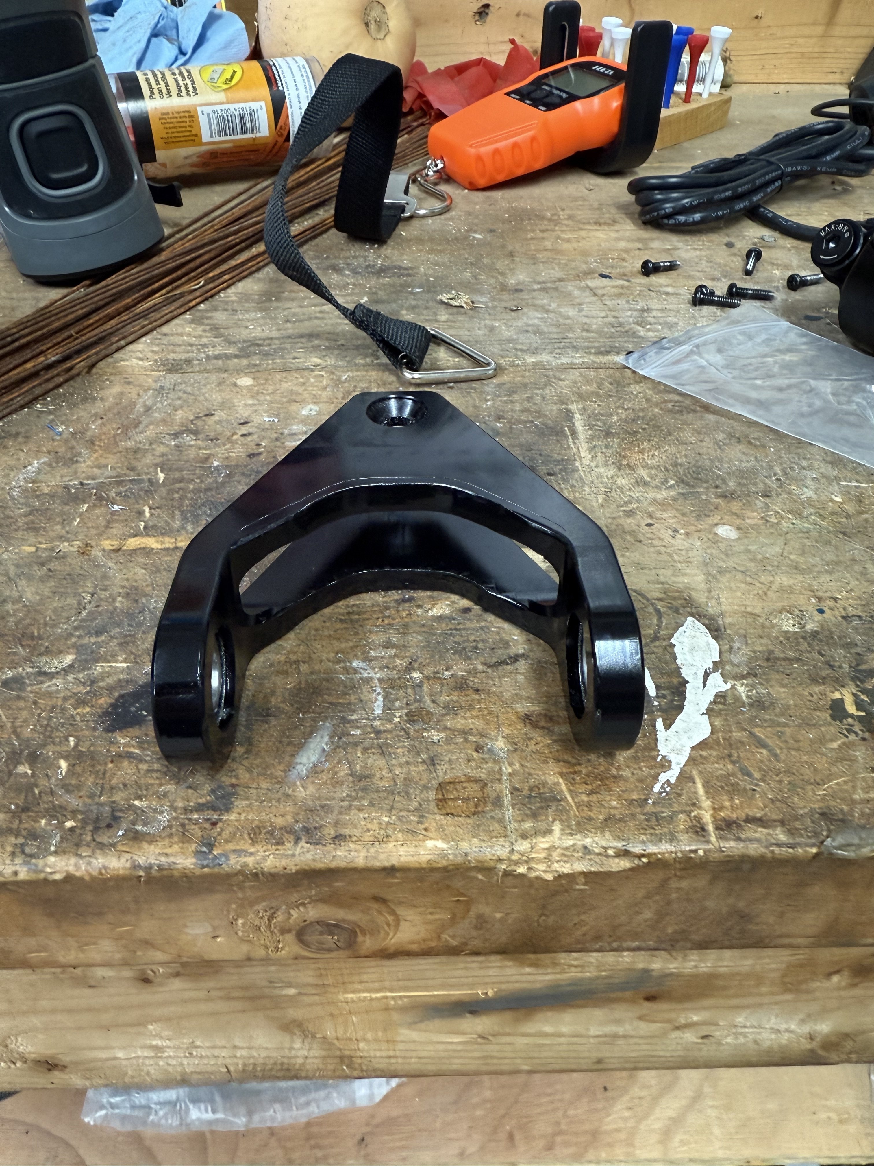

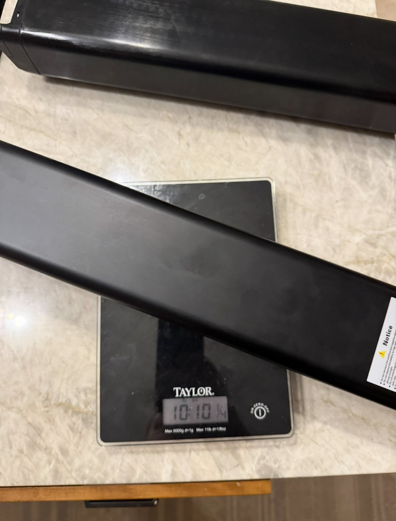

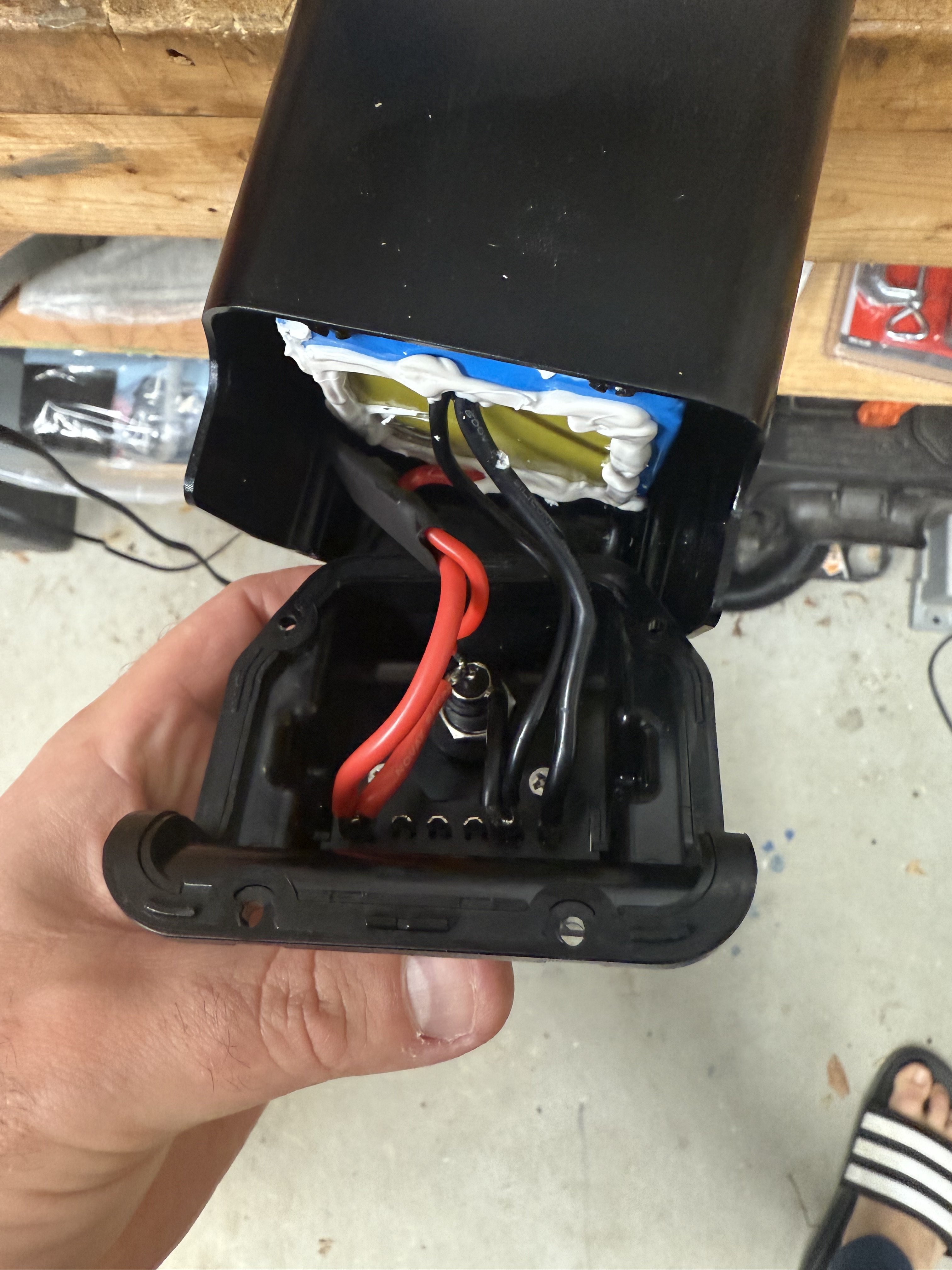

Finally something actually worked out with this build, I was able to squeeze the pack from my LCE971 battery into the extra E82 battery case I purchased and get it all hooked up. The BMS on the old pack was never setup for CAN communication so I’ll go without, but I don’t see any big issues with that anyway.
A comparison of weight between the 728Wh pack and the stock 1008 (728Wh: 3.66kg 1008Wh: 4.82kg)
Just need to get my connections sealed up with some silicone and put some glue in there to prevent and shifting and it should be ready for business.

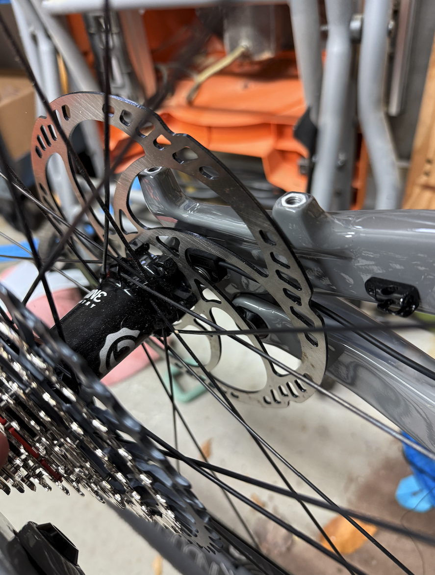

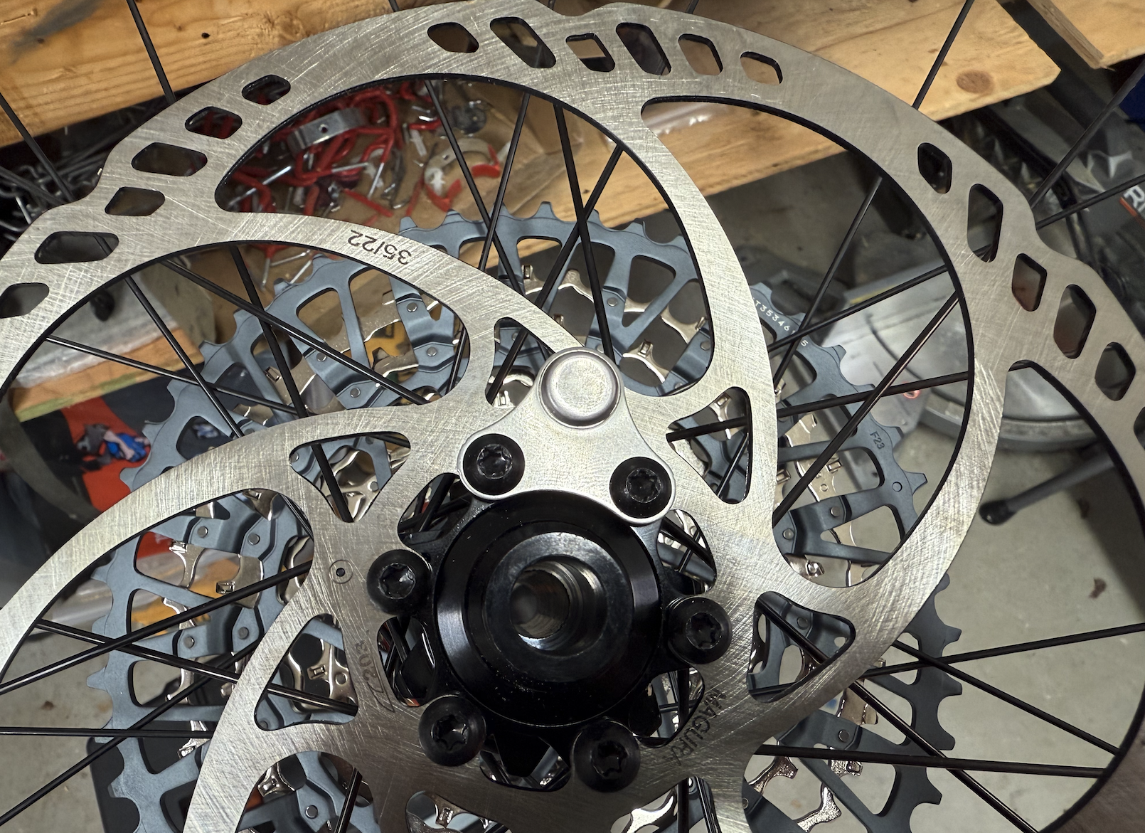

Anyway, the front of the bike is mostly together now, brakes all mounted and line cut to length. I think I have my cockpit the way I want it, everything seems reachable and the display should be in a decent spot. I wanted the display near the stem, but with my phone mount and the display not being invert-able (And it having a very short cable) I wasn't left with many options.
I also found a supplier for the SD071 rotor brake sensor on Alibaba (Changzhou Fieldebikes who I've used a few times). Dengfu pretty quickly told me "no, we don't sell that alone" implying if I had bought the full frame + motor kit maybe I would have gotten it. I can honestly say I would never recommend doing business with Dengfu at this point and hope to never need to contact them again.

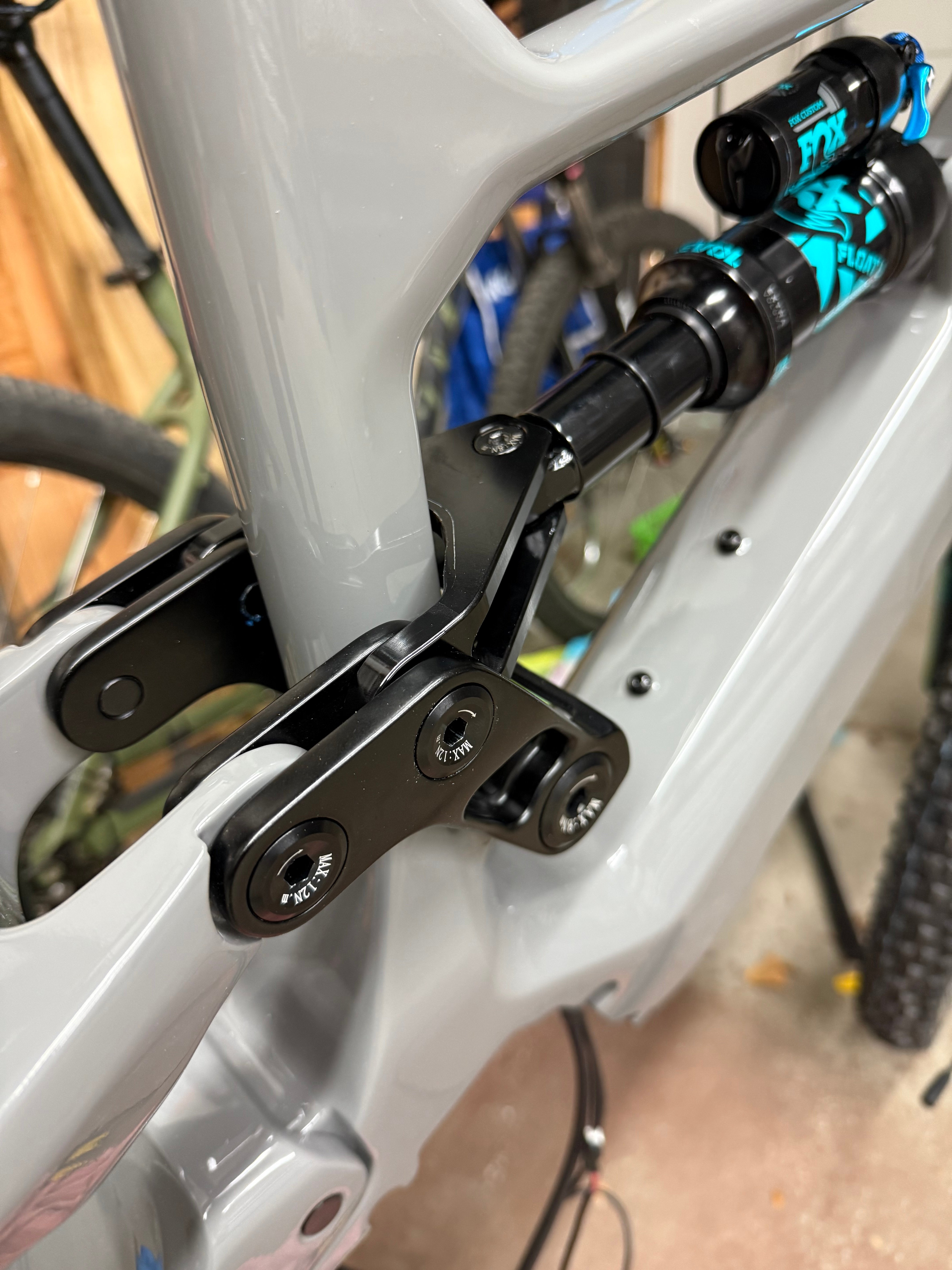

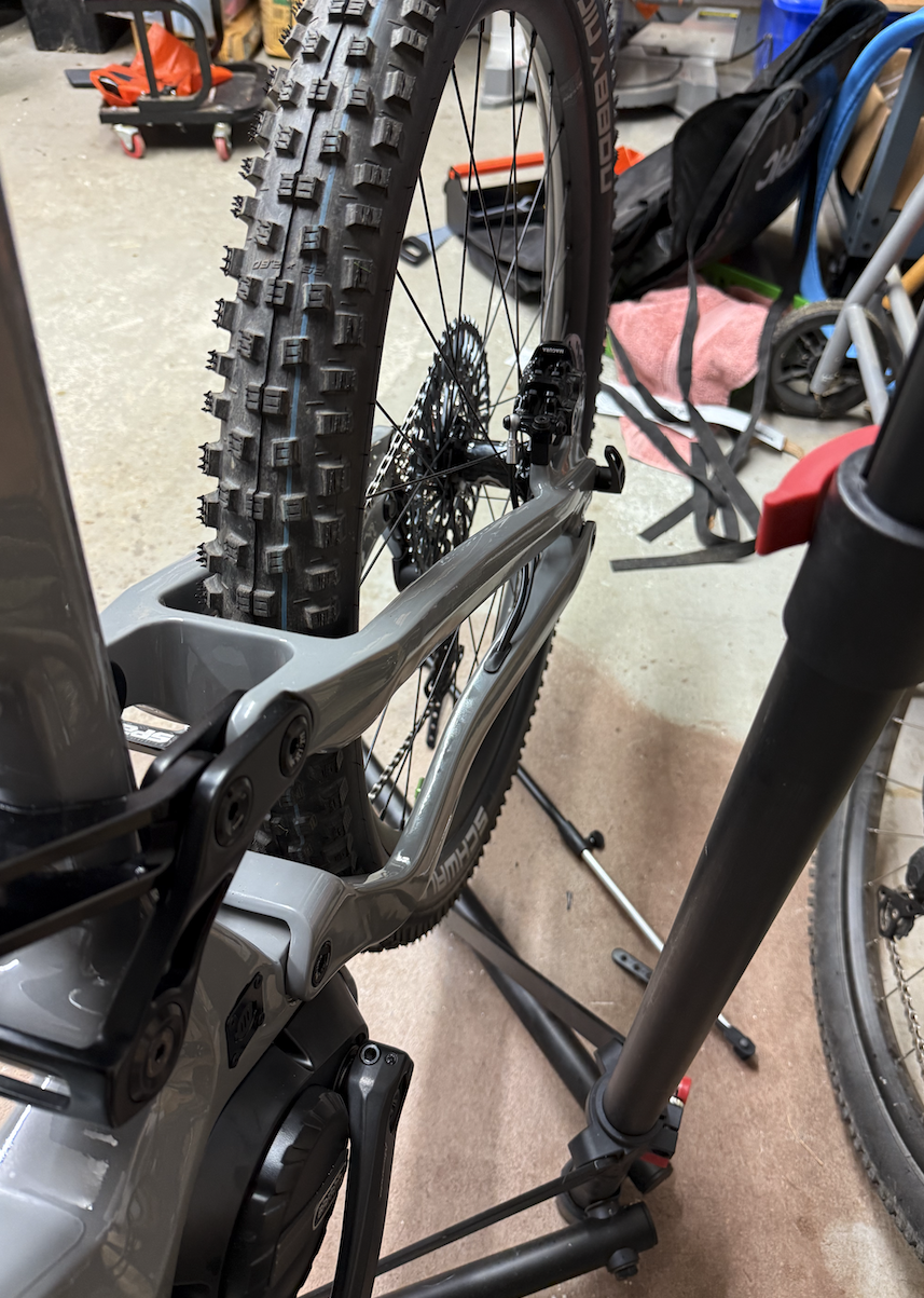

Bored with not much to do until I get my new rear triangle piece (Can’t mount my derailleur, wheel, caliper, and therefore motor because it’ll be in the way) so I decided to do some stickers… Applied part of my Dyedbro frame protection to break up the plain paint a bit.
Not sure where to put the last pieces, probably somewhere on the rear triangle. I considered the side of the downtube too, they’d fit almost perfectly, just not sure how it would look.

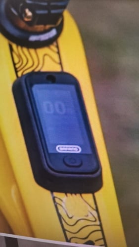

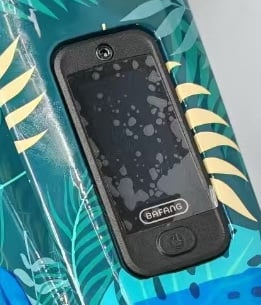

This is not the best version of the display. It does not connect to bafang go+. There is a newer version of the C030 with bluetooth and a larger screen. But it is necessary to make a large hole for it. Or you can print such a detail on a 3d printer and make small holes in the frame for the wires
WhatsApp Image 2024-10-22 at 11.39.36.jpeg WhatsApp Image 2024-10-24 at 19.23.15.jpeg
kaaskopf
Oct 11, 2024
177
227
Berlin
View attachment 148824 View attachment 148826
aha good info 👍
wont need bluetooth as i have a besst tool. only set it once and never look back 😬

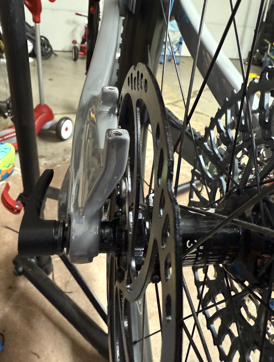

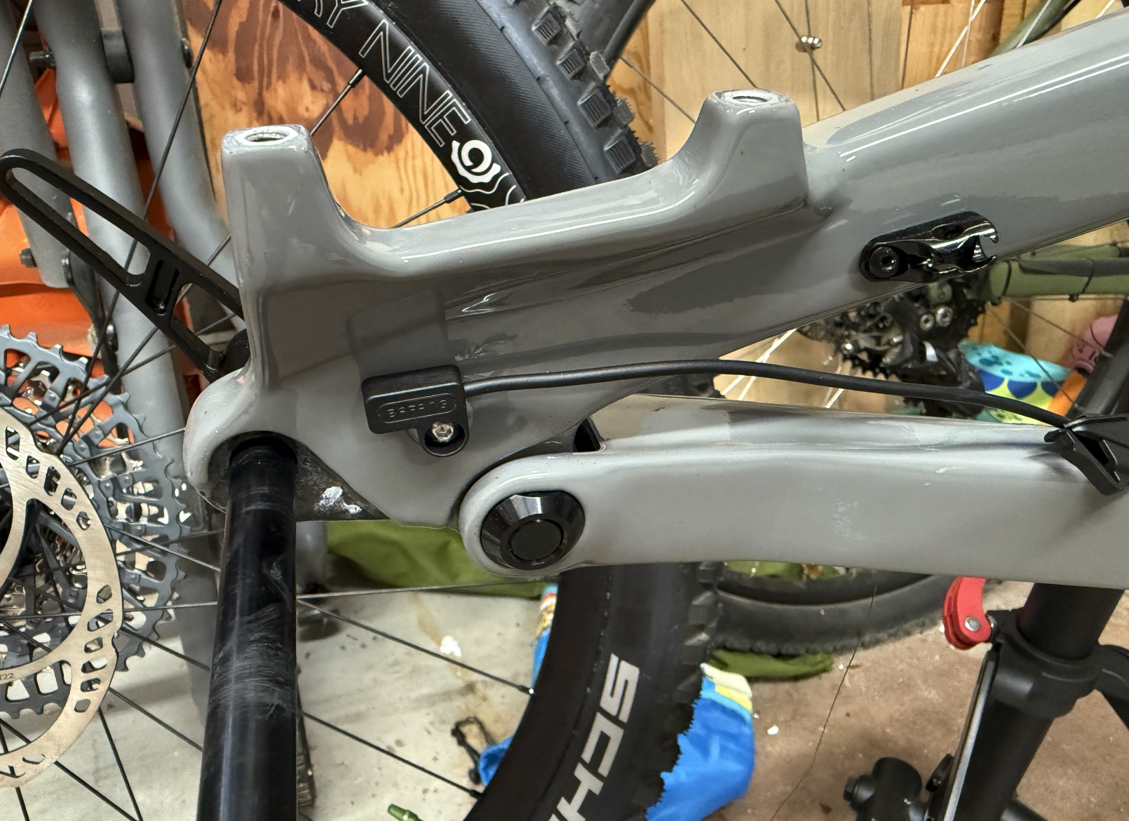

My speed sensor arrived today so I quickly mounted that while I wait to see if I'll ever get my correct rear triangle from Dengufu...
I've seen a lot of people ask for the right speed sensor for the E82 and where to get it. It's the Bafang SD071, I was able to get it from Fieldebikes on Alibaba (About $14 + shipping). I actually really like how this mounts up, way cleaner and more integrated looking than having something hanging off a spoke. Less likely to get bumped as well.
here it is attached. Very tight clearances but everything fit like a glove and looks like it should work out (I know... The sensor will be coming off once I get the right rear triangle).

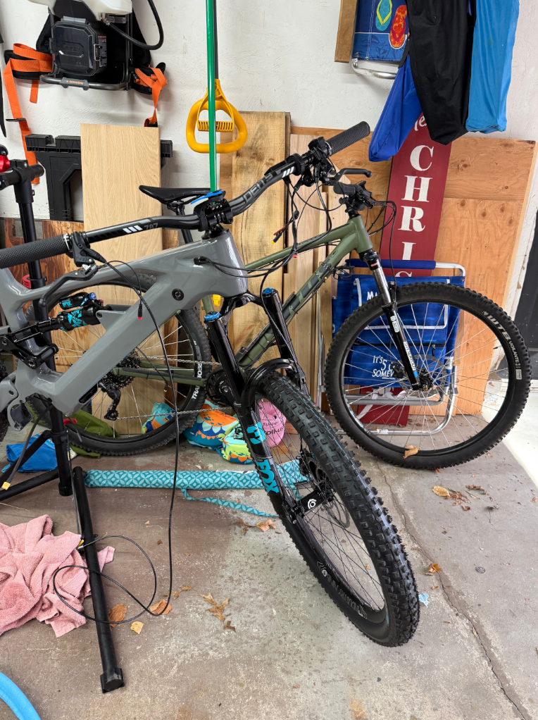

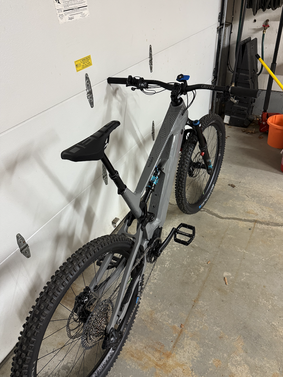

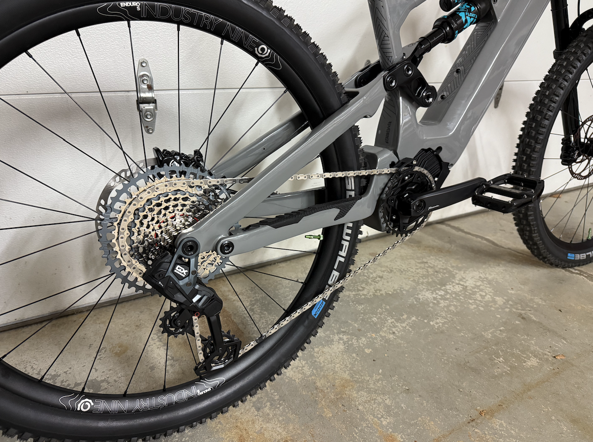

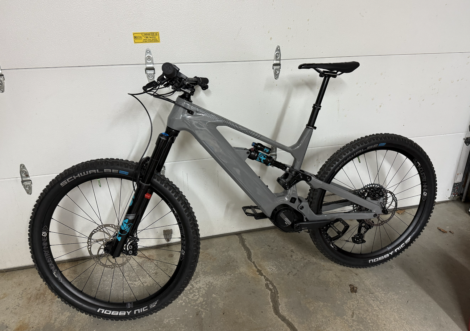

I’ll get some pics when I have time and still have some tidying up to do, but long story short I got my triangle today and completed the build. Finally. 5 months and a week after I started the journey to build a bike, and expected to have it completed by mid July.
After receiving the new upper rear triangle piece I couldn’t believe how god awful the bearings they use are. One of them was literally trash, could feel it clicking a bit as it went around and had quite a bit of resistance. I tried getting them out but was too afraid of damaging the carbon so I just left it for now. I had heard someone comment on the quality of the bearings from Dengfu before but honest couldn’t believe they’d be this bad. Not sure if the bearing itself it truly that shitty or someone damaged them forcing them into the frame; probably a combination of the two. Another good reason to use LC instead of Dengfu, they advertise they use name brand bearings in their frame.
The SRAM transmission setup was interesting trying to follow all the specific steps, but overall was pretty easy and the system is just awesome. I did some small micr adjustments through the app and was blown away by how damn smooth and fast it shifts under any load, quite a change from my old beat up Deore 10-speed 😂
The bike weighed in at about 52.2lbs (23.6kg) with my smaller 728Wh battery. I say about because I couldn’t find a good spot to hang it from where the scale would sit perfectly still so I just held it and got as consistent of a reading as I could get.
Mounting the motor was a little scary, I started hearing some quiet but audible light cracks as I was tightening the motor bolts before getting anywhere near the recommended torque so I stopped and left them tight but not to spec according to the Bafang manual. Those numbers seemed damn high for a carbon piece anyway. We’ll see if the thing falls apart after a week because I damaged it mounting the motor. If so that might be the icing on the cake to find a new hobby after this experience.
My one outstanding issue still is my Dengfu CAN battery doesn’t seem to work at all. Bike just won’t turn on, works perfectly fine with my custom non-CAN one, so I suspect something is up with the CAN stuff. I have the wiring harness with the little CAN battery connector and hooked it up, but something must be wrong. I noticed one of the little wires from the CAN connector to the battery receiver was cut off from the factory and didn’t look right. Someone on Facebook told me the CAN wiring is only 2 connections, but I have my doubts what’s there is right, it’s a 3-pin connector and I don’t know what that wire is doing, but if that came defective as well I’ll have another reason to despise Dengfu. It has truly been an abomination of an experience in terms of quality from them, from the ordering process, to customer service, to the physical product itself. I would never recommend anyone use their stuff based on this experience. I really wish I could have just stuck with an LC frame.
I only had a chance to do a few laps in the driveway in the dark to test it, but it seems like it’s going to be a blast. The motor seems damn powerful just on Trail, I think where I used to run my BBSHD was between Eco and Trail on this, more riding will tell. I would always try and stick just PAS 1/5 on the BBSHD which peaks just under 500w according to the display. I do need to bleed the brakes a bit more and tidy up some cables and then I’ll have some completed pics up hopefully tomorrow.

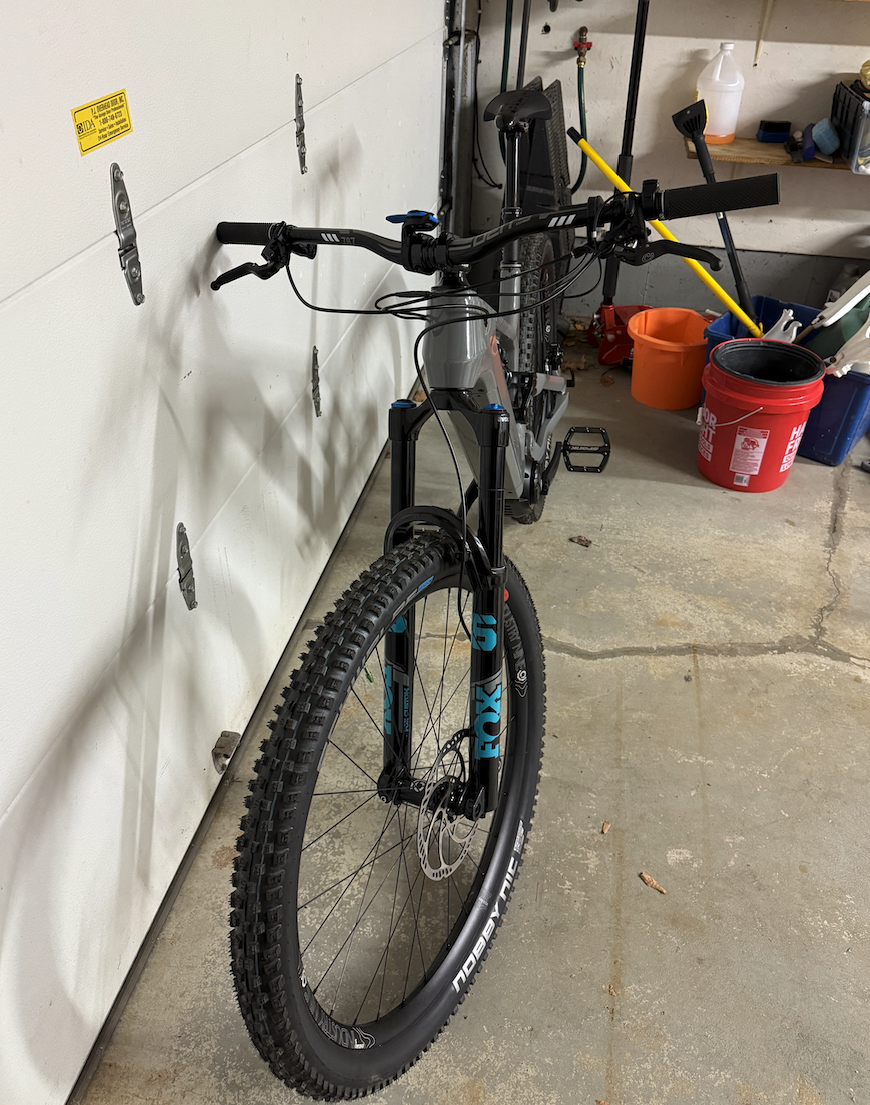

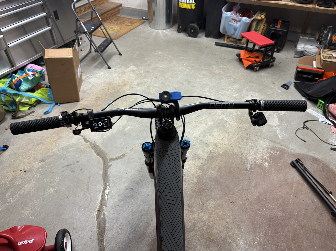

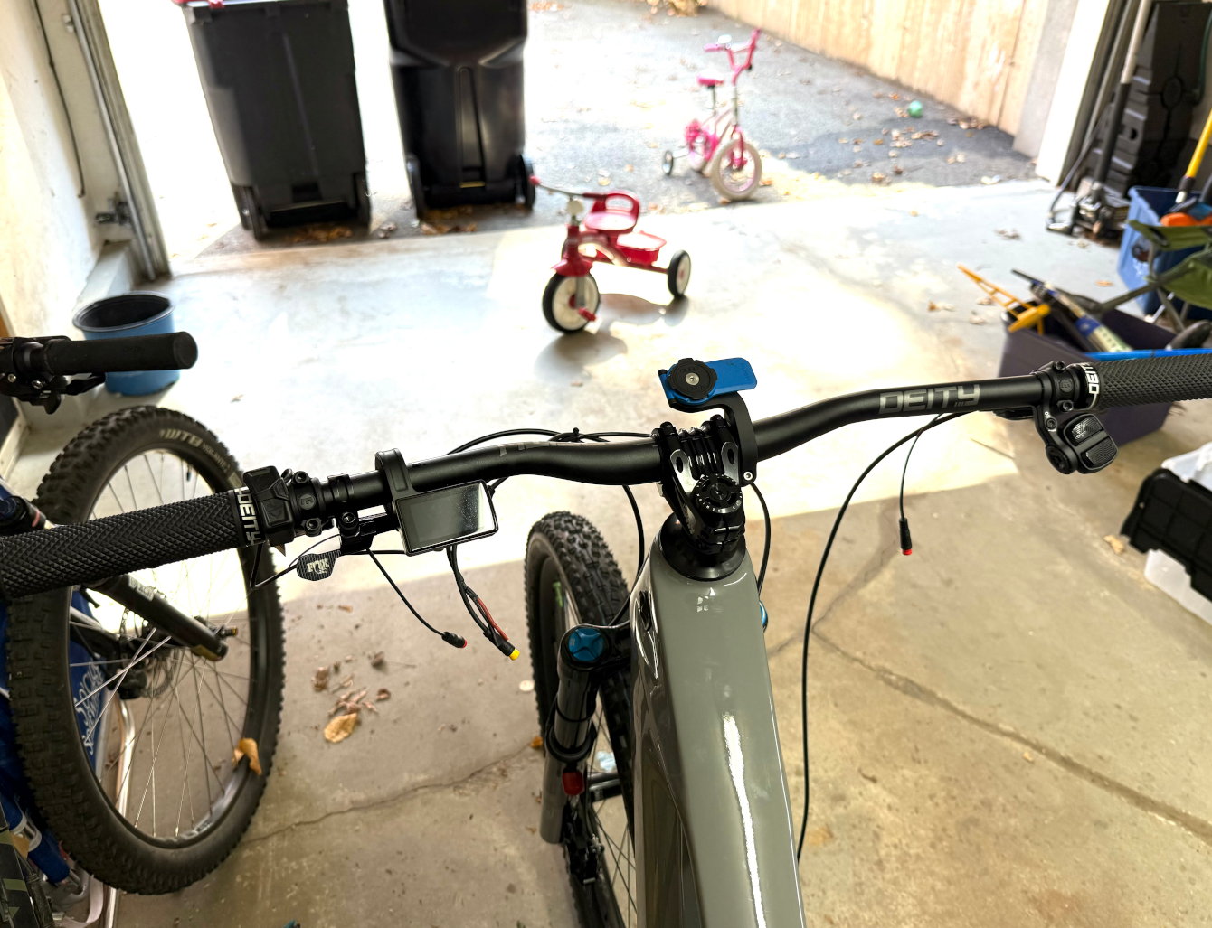

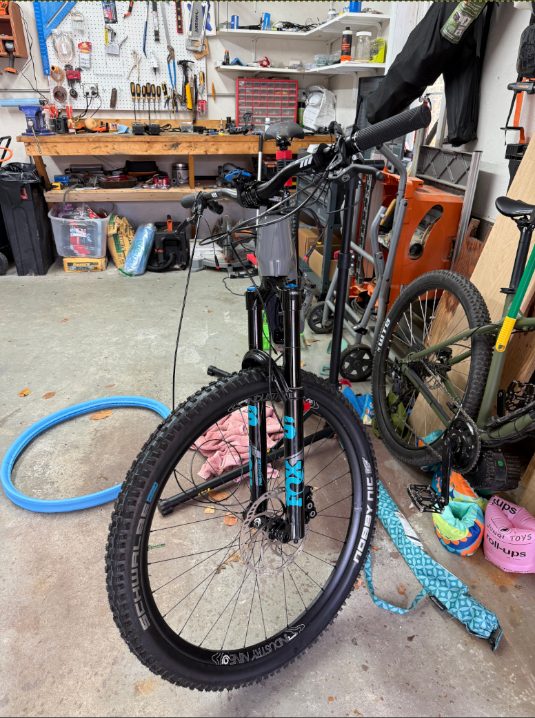

Fixed my dropper wire and took a few pics. I don't love how my front brake line is wanting to stick out, I'll have to play with it a bit to get it to sit nicer. Yes, I know I could have gone with a much longer dropper. I wasn't sure how much space I'd have and just played it safe with a 125mm. This will be my first bike with a dropper anyway so I'll enjoy it as it is.
