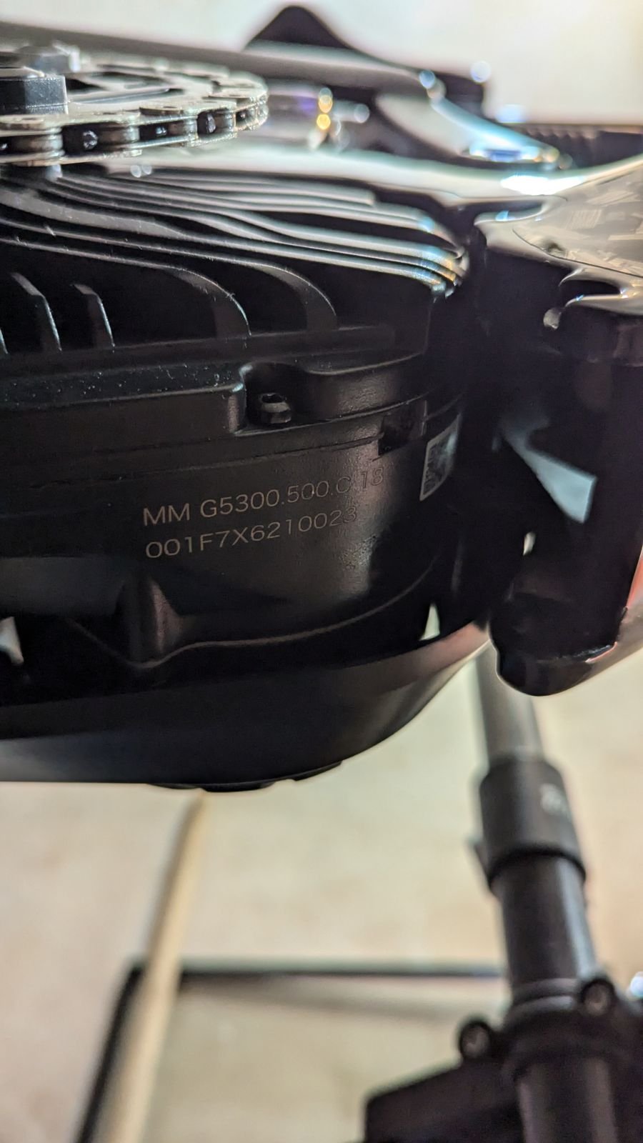

Here's the bottom of the motor in question
Interestingly, my 750 updated version doesn't have any such etching on the case itself, maybe that's one way you can tell old vs new. I only have the sticker. When I opened mine up there appeared to be a manufacture date stamped into one of the gears as well, but I'm not sure of a definitive way to tell from the outside. The fact that you have etching with that info where mine has none tells me that might be one of the identifying pieces. Would be good to see a known updated 500w version to confirm.

With laser engraved label it will be old M560. Now they putting only sticker.
Also 750W version is reading as 500W hardware.

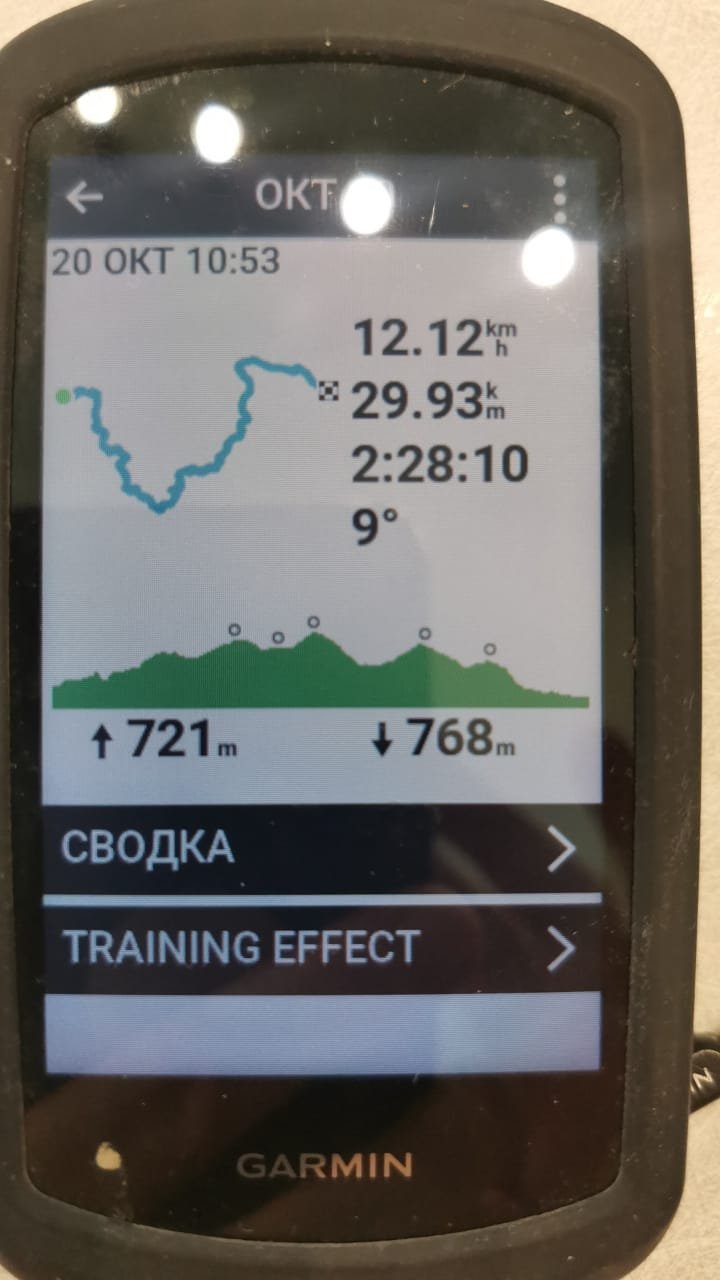

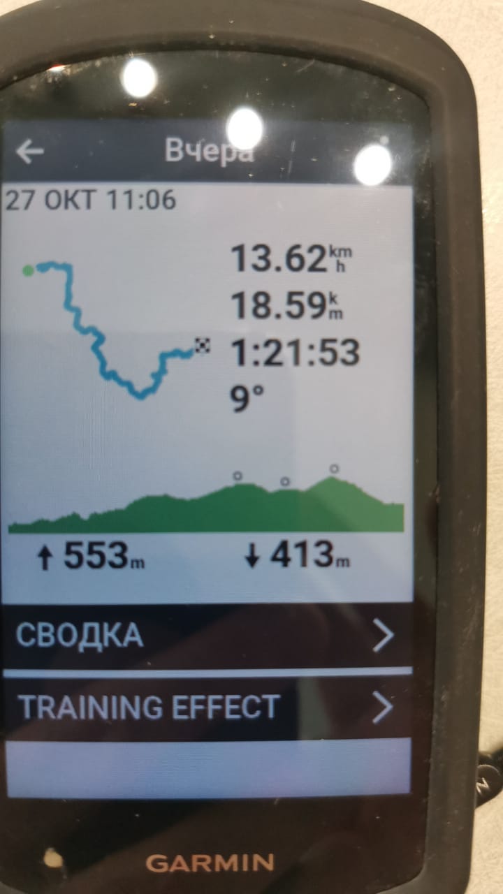

Ride on the M820 43V and M560 (500W) 48V motor. The battery is 48V 5A. Both motors are set to 5 acceleration. M820 40% - 250W. M560 - 25% - 250W. The route is the same. The speed is about the same too. The battery on the M820 is discharged to 39V, the firmware is 43V. The battery on the M560 motor is discharged to 42V, the firmware is 48V

Hmmm, thats quite a big difference 39 vs 42V left. Efficiency of M820, or this motor is running in higher rpms, where more loss. I can check in charts what is the difference in capacity taken, is it 5Ah battery? But that looks to me too low for 30km and 720m vertical.
Also dont getting that pictures, one has 30km, another 18.6km.

The test was carried out on a 5A 48V battery. The average speed in the ascents was 8km h. If I could discharge the battery on the M560 to 39V. I think I would have driven 20km. But it's still a big difference.

I got it now :sleep:... you went till battery died.
Indeed here is something not OK, it is too much difference.
Quick calc from your numbers and for 250W max:
10.84 Wh / km - M560
7.38 Wh / km - M820
+46% consumption
