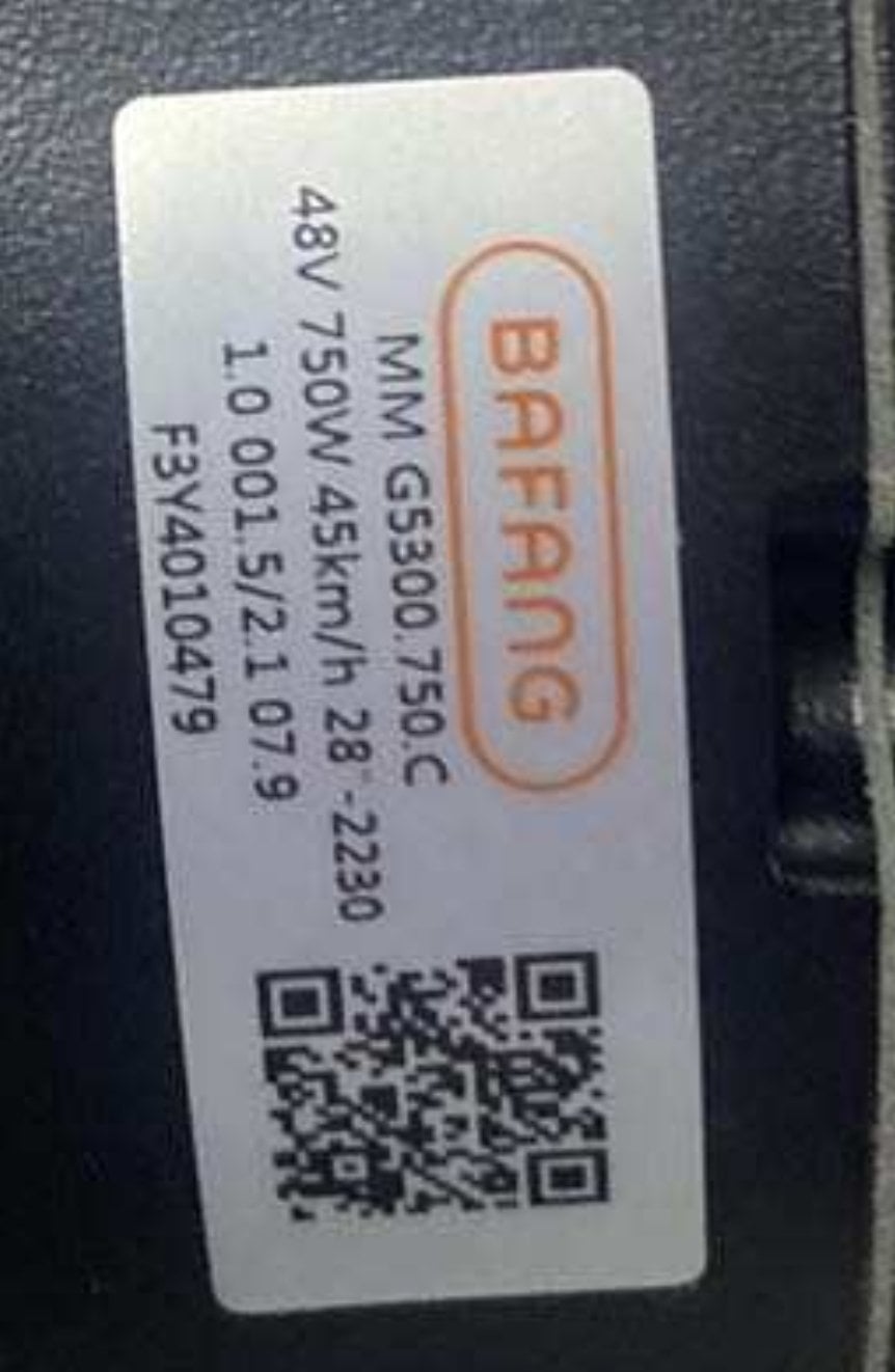

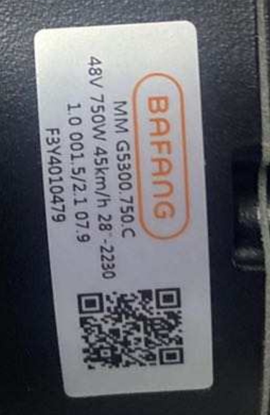

Yes, but it’s firmware changes only allowing higher current to achieve the 750w, physically they’re the same motor. Noise is the same as well, what changed was essentially a redesign or a v2 of the motor that was more of a running change around May of this year that cut the noise down a pretty good amount.
Any way to identify "old batch"? Looking to buy this motor, but still little bit concerned about this.
Dado
Jun 28, 2022
735
497
Bratislava
Not easy. What I noticed, old M560 had lasered serial number, new does not have, have a silver sticker only.
You should be getting now only new version.. Only if you find some seller on Ali, who has still old stock.

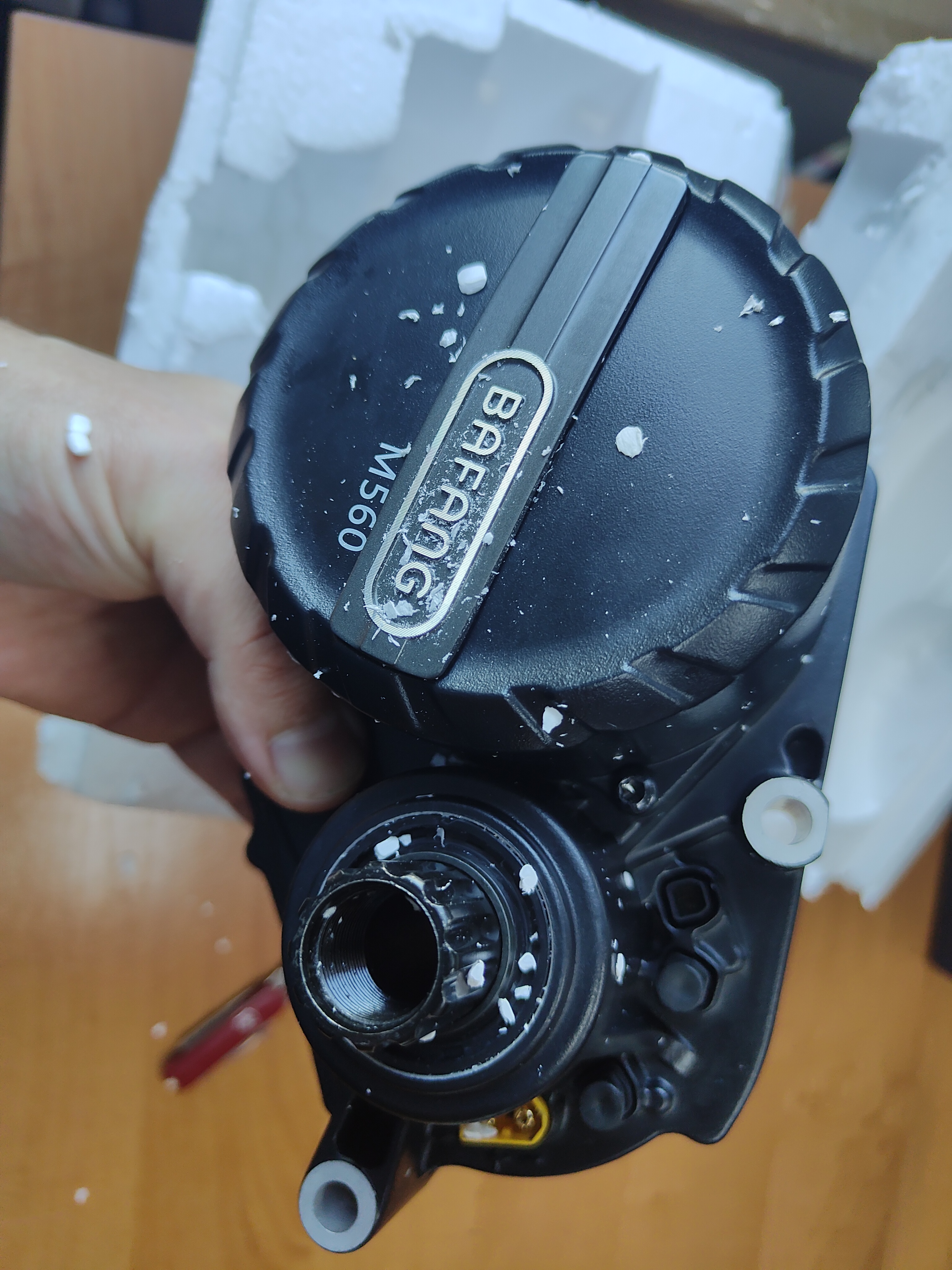

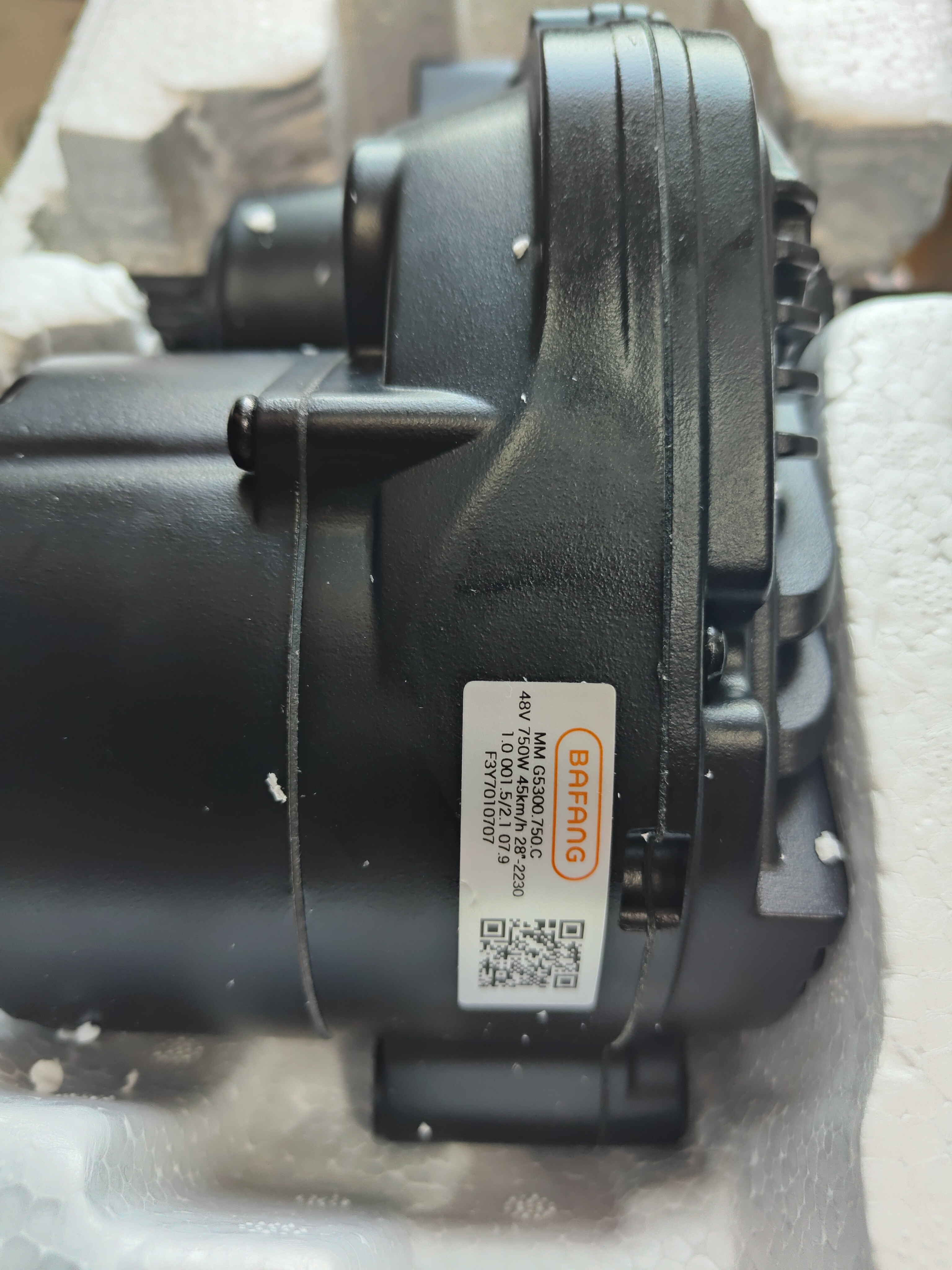

Yesterday I received my second m560 engine from the July production. New look of the sticker with the engine model etc. and a new bafang badge on the side. I am still waiting for the shipment with my second dengfu e82 frame.
Along with the engine I received a DP C245 display in version 2.0, i.e. with BLE 5.0, which until now did not work with the Bafang Go+ application. Now it works. Checked, it connected to the display without any problems and you can change the engine parameters in the same way as when connected to the display in version 3.0.
I will let you know when I check the noise level compared to my first m560 from the February production of this year.
