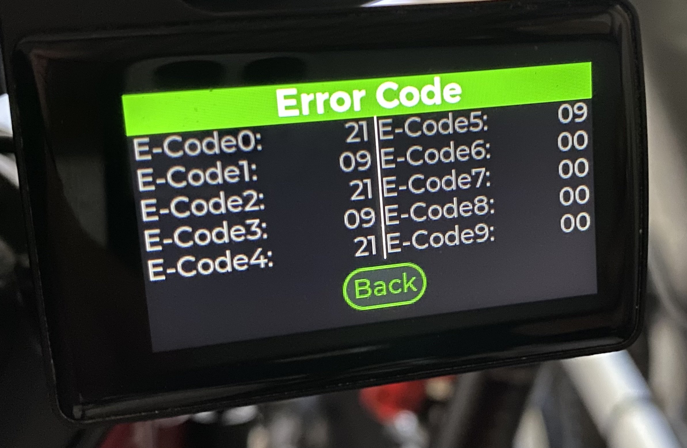

So, I tried to switch on the motor and nothing happened. I plugged in the charger and the motor came on I checked for errors on the display - There were no error codes displayed when I used the best tool, see photo Showing codes, from what I can find these codes relate to brakes and throttle? None of which are attached to my bike. This is frustratin. Any ideas?

Not an expert on this, but that list is error codes you have had. No. 21 is easy, that is speed sensor fault. No. 09 is bad, that would mean motor phase wire failure. Still I have had 09 also, but only for a second or so when I power up the system some time ago. It still remains in that list, even if not active any more. I would guess there is someting wrong with your wiring, you can check all cables, to battery and display. It can also be in the wiring inside the motor.
Maybe check if it is a warranty issue where you bought it, before opening up the motor.
Error code list:
Error codes
Thanks for your response Freda, I had previously checked the cables visually and had checked for continuity on the charging and battery wires with a multimeter, since my last post, I have been able to switch the motor on and off several times and had a short ride locally, there seems to be a pattern, it rides ok for short distances then the next time I take it out it doesn’t work 🤷🏽
