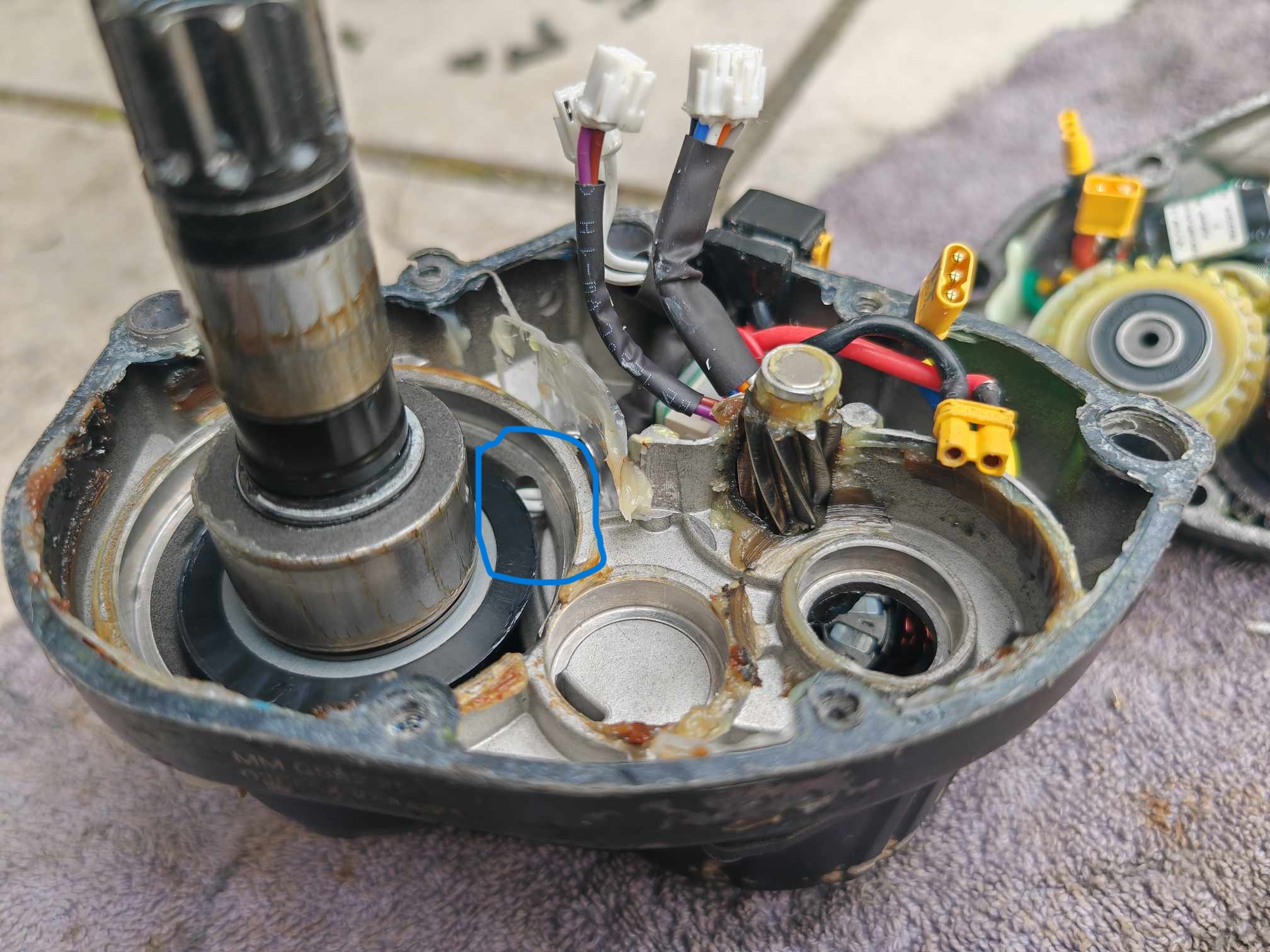

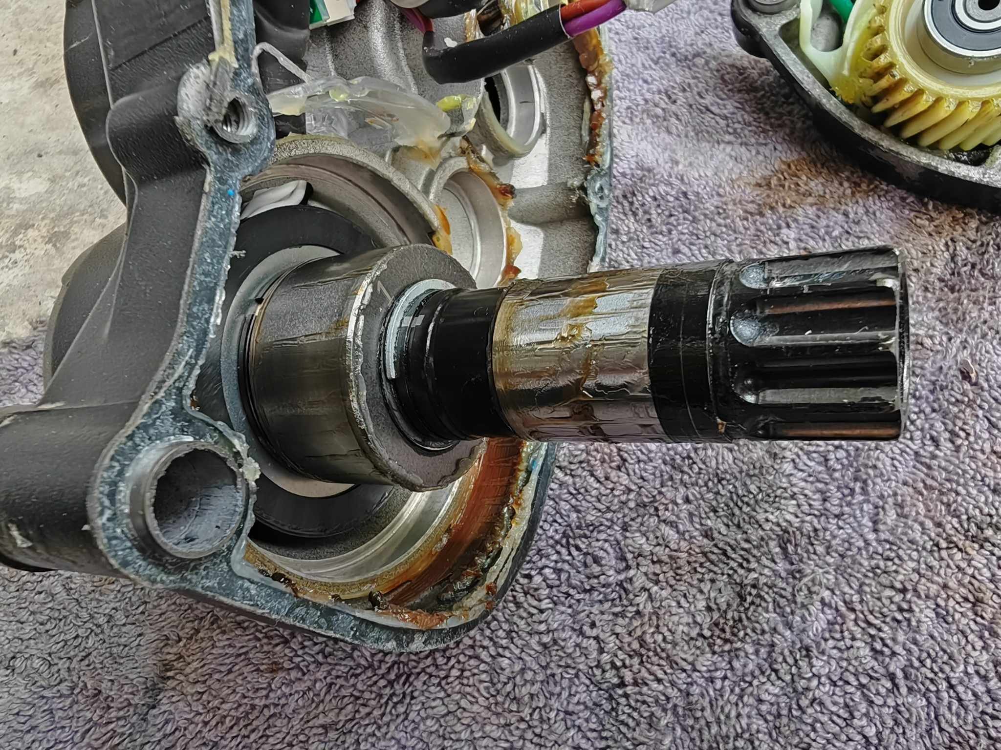

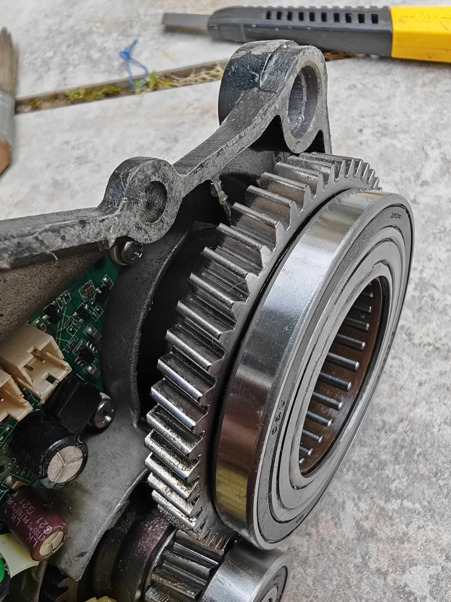

Hi.

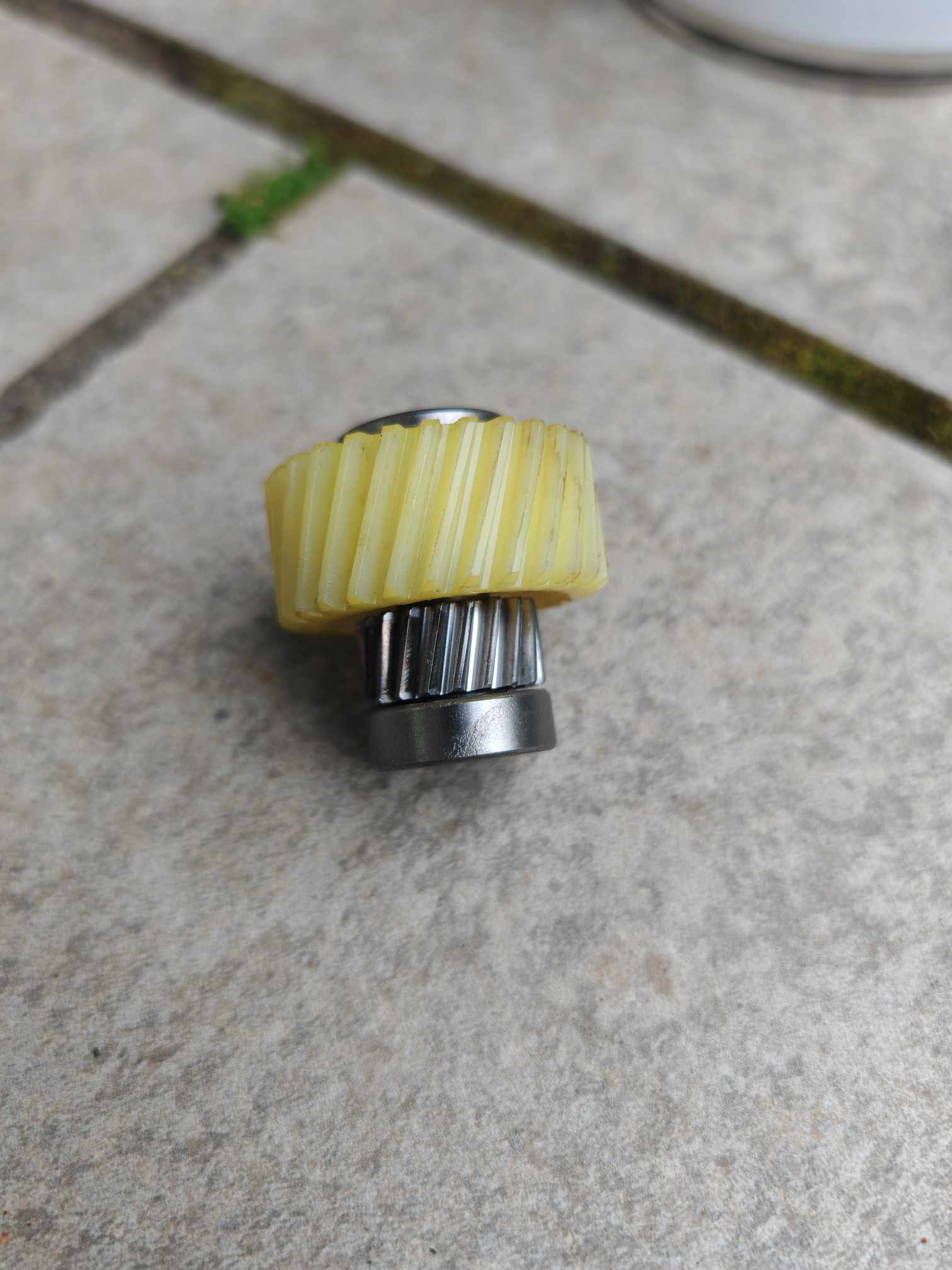

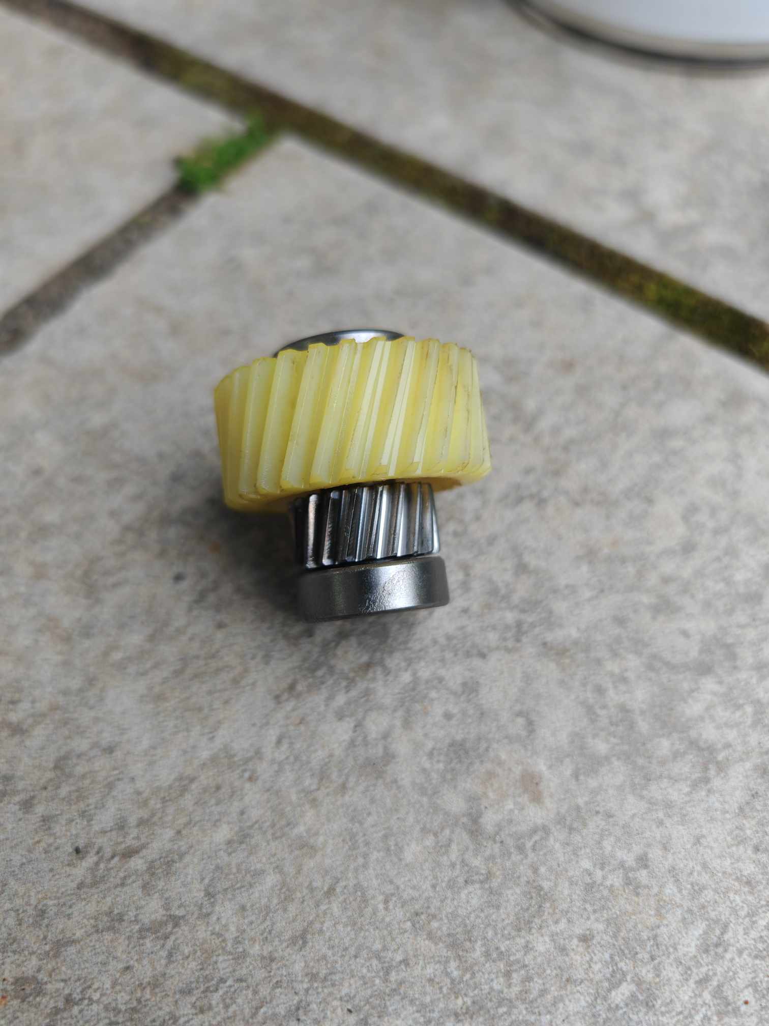

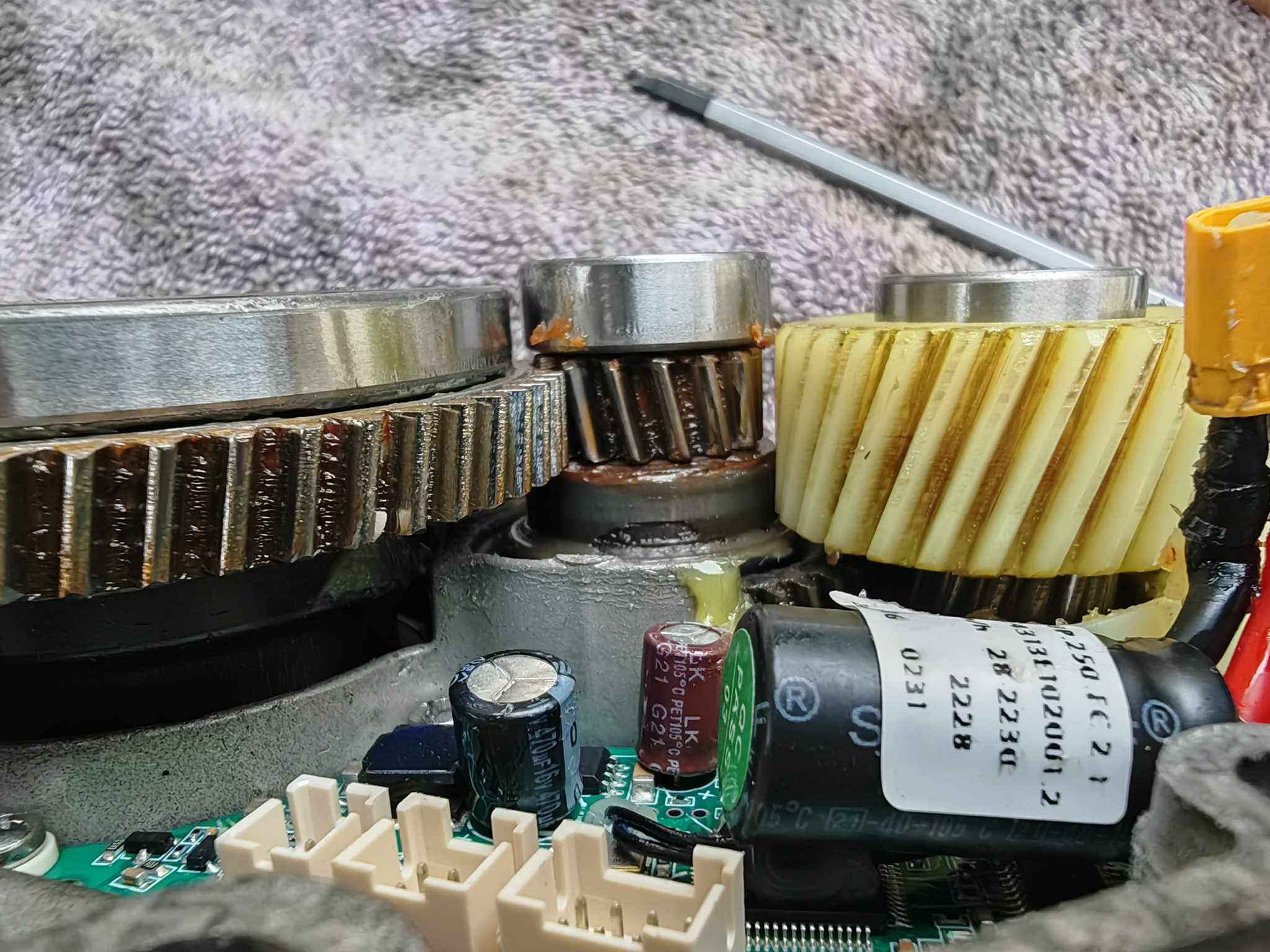

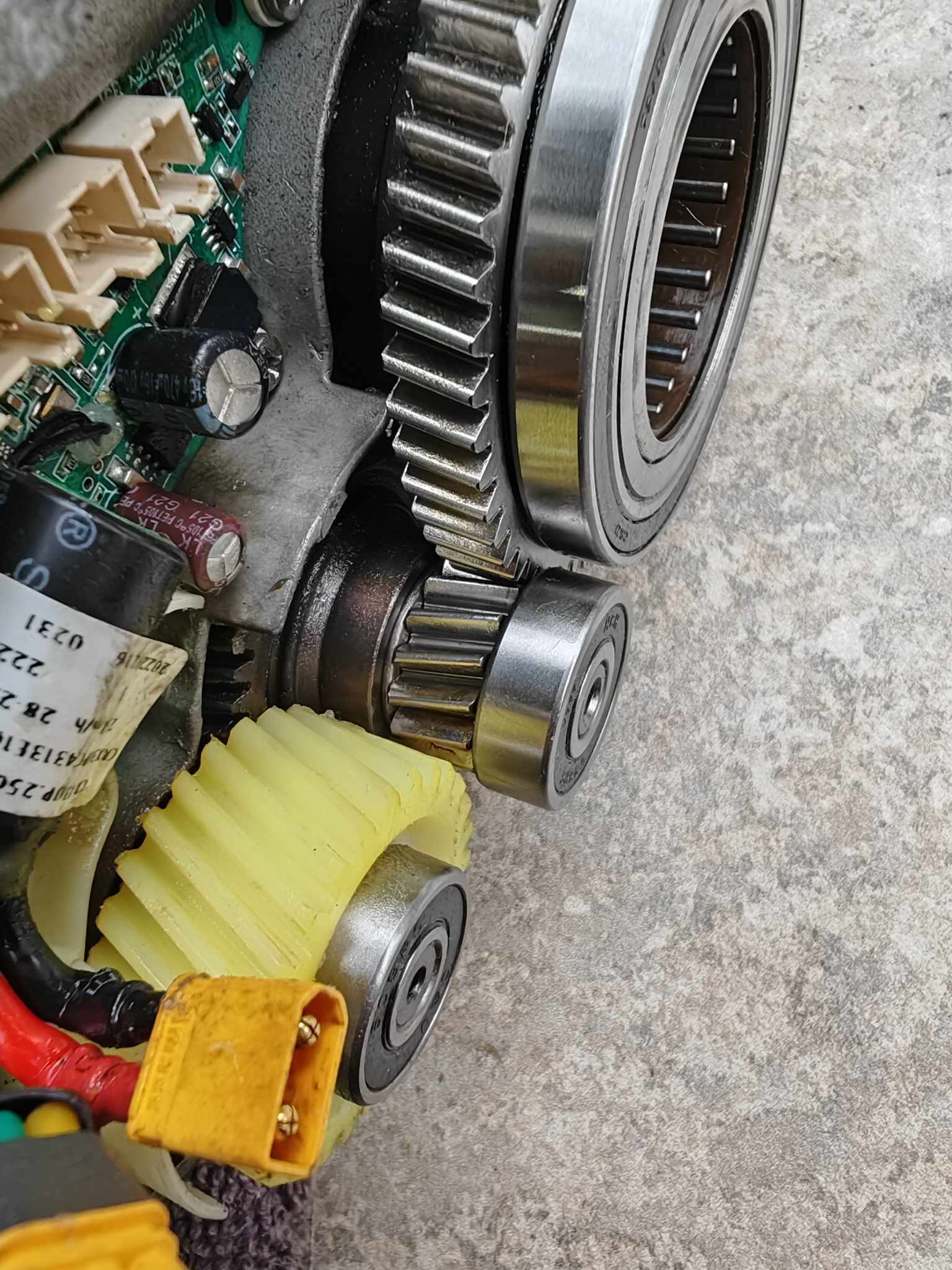

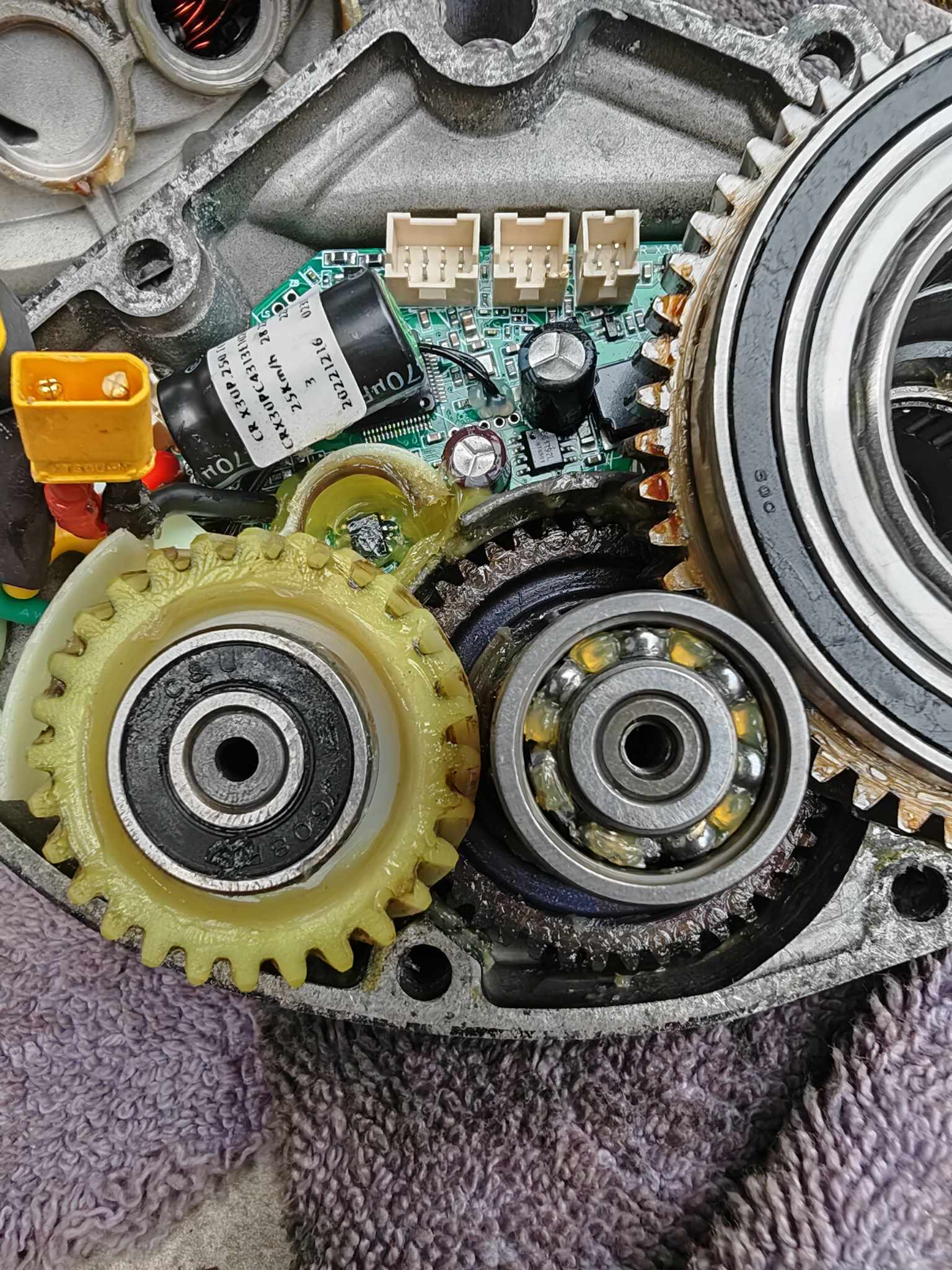

Done 1800km service yesterday. Bellow a few pics after I have opened the motor. Spot with the most discolored grease is the biggest metal gear + it's companion. The rest of the motor, gears, bearings etc - looks absolutely spot on.
After a small clean up there is no visible wear on the gears.
Greased all up with PG75, and the next service in about 2000km.
In my opinion if You do the service at about every 1500km - 2000km the motor will last for a long time.
Regards

I see, i suppose that they are behind this washer. very different item than M510. only 2 cable for those datas ?
Regards
What about noise after service and new grease?
It'd be great if you find some time to write a short post / tutorial how to disassemble, clean, regrease m820.
borysgo2
Feb 1, 2023
122
202
Ireland
Noise - I'll find out at the weekend.
To dismantle the motor You need:
1. Remove cir-clip at the drive side.
2. Unscrew 4 bolts.
3. Separate casings slowly about 2mm. Take the sharp knife and separate gasket from the one of casings. Separate casings further 20-30mm and disconnect wires. That is it.
Clean and re-grease:
1. Grab a towel and can of brake cleaner, clean the bits and pieces. You can push out the gear/clutch assembly by hand.
2. Grease it up with Molykote PG75 grease.
3. Remove bearing seals (with sharp knife tip) and clean + re-grease ball bearings (with bearing grease).
4. Clean up rubber seals and apply lightly PG75 grease on them from inside.
5. I greased clutch needle bearing with Shimano RD+ grease.
Assembly:
1. Same as dismantle but in reverse order.
What to be cautiousness about ?
1. Do not over tight the 4 bolts on the casing, just few Nm is fine.
2. Watch out the plastic shields and brackets inside the motor, they are quite fragile, easy to crack.
3. Use proper greases!!.
