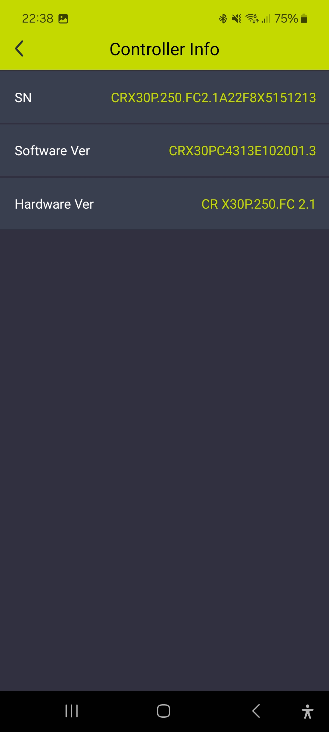

what firmware are you using?
FW attached, but I don't think there is anything wrong with my unit.

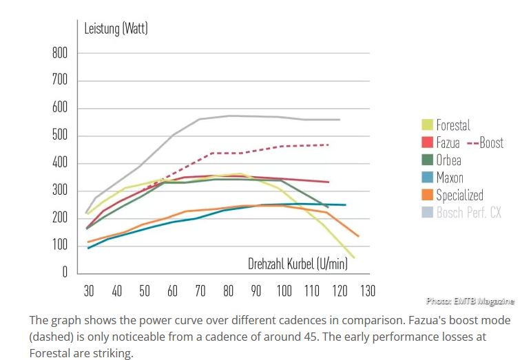

Anyway, here is last years review of different ligthweigth motors. One of them is forestal, that has EON drive, (bafang M820 brother).
https://www.bike-magazin.de/komponenten/e-bike-motoren/leichte-e-bike-motoren-im-test-fazua-tq-forestal-specialized-ep8rs/
Near the bottom of the review, there is power curve:
Few things to note (and some to speculate):
-Forestal uses 52V (14s), battery and BAFANG ligthweigth battery is 43V(12s, this one I also have).
-basicaly, due to the "back E.M.F". and particular motor design(armature design, number of stator poles,..), each motor has max RPM. Also higher the voltage (with the same motor design) higher the max RPM
-most of the people on here are saying, that 36V/43V/48V M820 motors are identical, apart from FW. Then, it would be reasonable to believe, that EON in forestal has the same motor internals. That would indicate, that with 43V battery, M820 higher cadence performance is even sligthly worse than the one in the picture.
-I would also asume this is the reason forestal went with 52V battery, to help with the assistance at higher voltages
-upper graph also corelates quite a bit to my experience with M820. And as the battery drains, voltage is lower, and the performance at higher cadances becomes worse. I also notice this.
so, overall, not a bad motor, but also not the best.

I doubt seriously that the Bafang motors are all the same and it is just firmware. The relationship between rpm and kv is linear. So if you had a constant kv, due to the same motor, a 36v motor would run 36/48=.75 or 25% slower.
You can't change that in firmware.

everything is on paper. but forestal motor is 60nm and m820 is 75nm. I don't think any comparison makes sense here! According to their specifications, the forestal motor weighs 1.95 kg and the m820 weighs 2.3 kg. so there are differences.

the engine from forestal and the m820 look the same from the outside, as I wrote in the post before, the information and the weight alone indicate that the engines are not the same.
@clix I don't know if your FW is road. I tried e-mtb and e-road firmware. in terms of strength equally. and as far as driving characteristics are concerned, the road fw is much lazier in its reactions! there is no overrun either. so maybe that bothers you. maybe you should try 36v emtb fw to see if there is a difference.

@mike_kelly , @ficorama , if someone would actually open different voltage motors, and check the windings and gearing, that would be great. I would be very interested.
I attributed different weight between the EON and M820 to different material being used in the gears, axle(more aluminum and or titanium?), but presumed that mechanically and electronically they are identical.

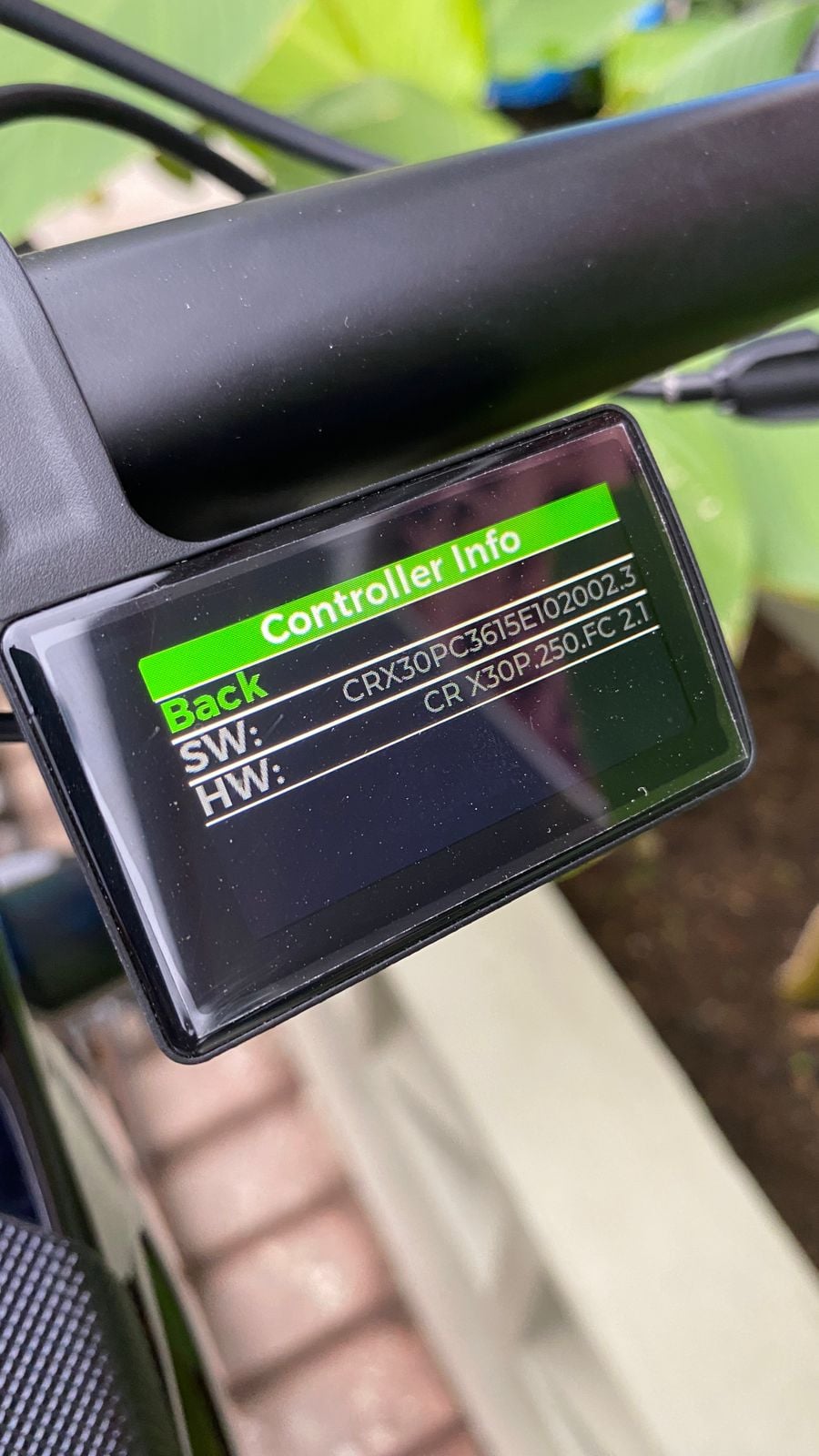

I'm using this 2.3 firmware on my latest build. Seems less battery consumption than my other bike on 3.2 firmware.

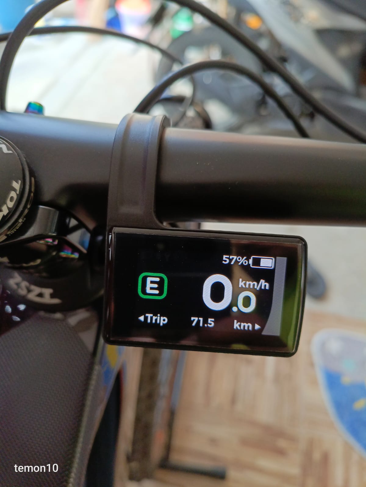

Display shows 70km with 57% battery left. But actual distance on strava about 65km with 1100m elevation gain.

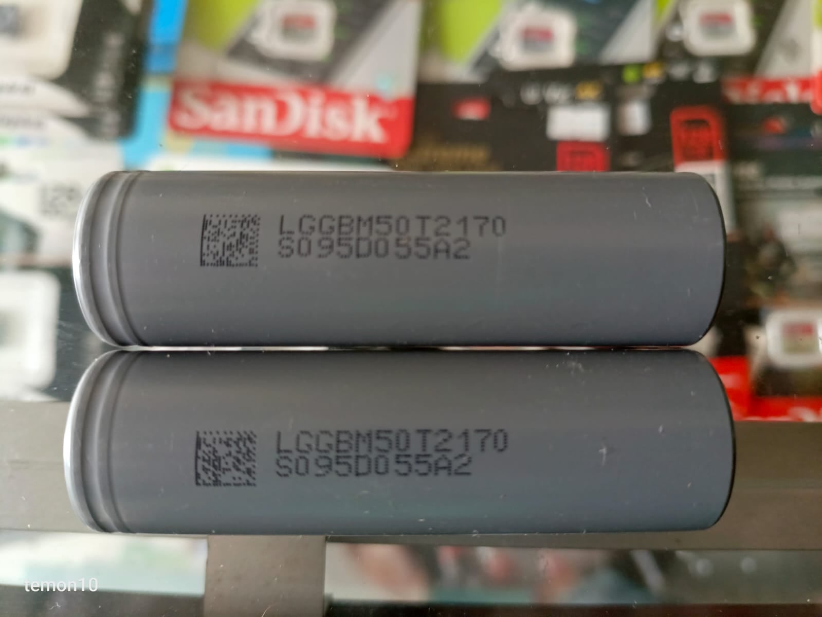

I'm using 21700 5000mah LG Cell

These numbers are beyond my comprehension. I use like 60% of my 480Wh battery to ride 45km with similar elevation, all in E/T mode. How is your 43% even possible, do you have some super strong legs and constantly ride > 25kmph disabling the power assist?
