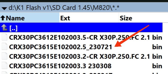

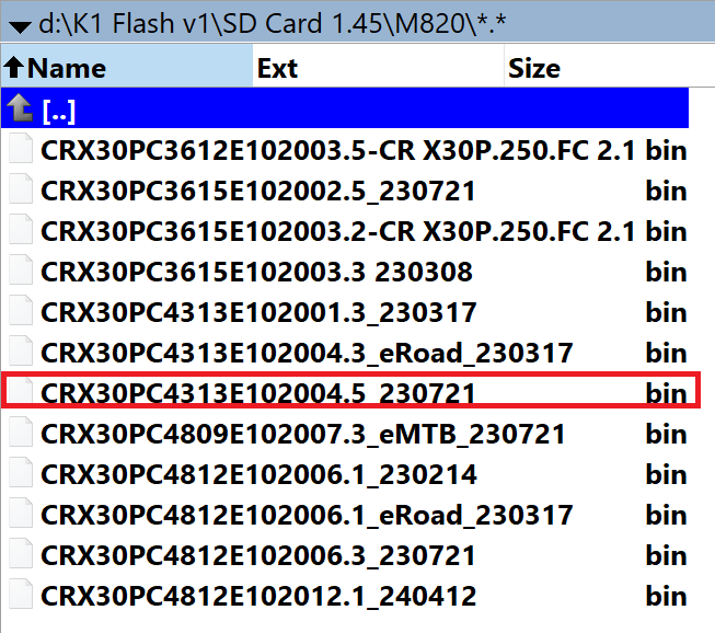

Hi guys
I ordered the beest tools does anyone have any firmware for the m820 36v motor❓
here I only found 1 of course I'm talking about E-mtb not Eroad which would be the one I have thanks
