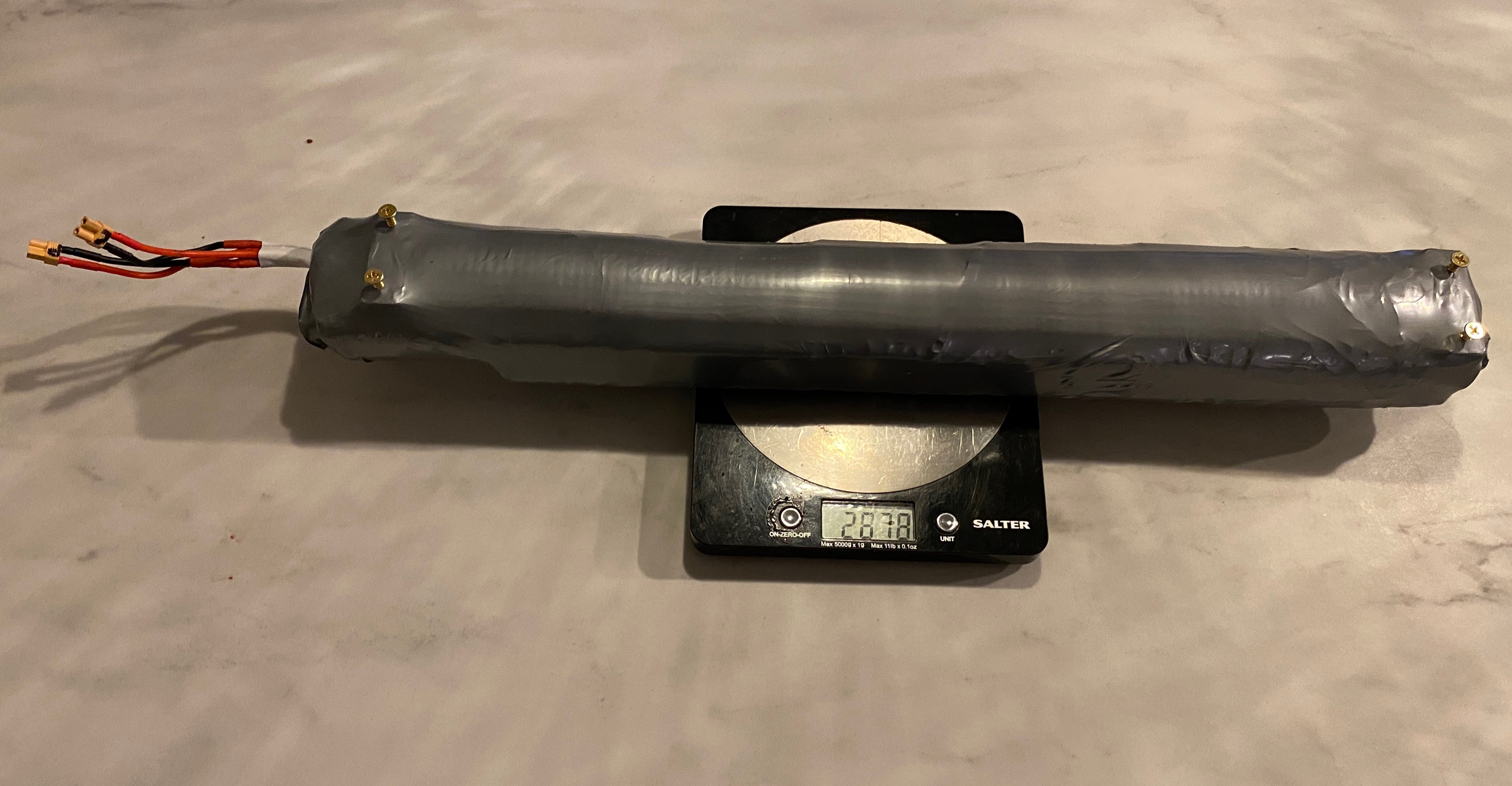

Did you fitt 13S3P battery into the lce930 frame ??
I have done 12S3P and all the battery stuff fits in between the mounting holes. So another 70mm in theory will fit, but it would be very tight.
THX

Freda
THX
Peter
Yes I did, I believe it is maximum. Since this picture I did rebuild it so I now have plastic M6 screws and metal counterpart on battery. Also added a handle to pull it out, since I made it very tight so everything would stay in place. So far has been working very well.
I would make a 13S2P shorter using the second holes for attaching it, it would be about 14-15 cm shorter.

DId U make 3D printing for this battery holder?
Freda
Feb 5, 2023
175
152
Vaasa
For the present 21700 cells I used this, M6 size. I glued and taped the aluminum square nut in place on the battery. And plastic M6 screws. I have cellofoam around the cells to make it a tight fit. It doesn't move at all, even without the screws. That is why I needed a handle to pull it out.
For a 18650 cell battery, normal brackets fit in the frame: Bracket

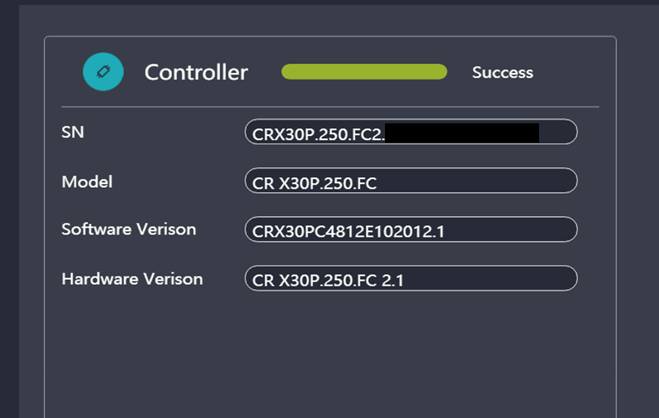

tepe
Nov 22, 2023
21
13
PL
Maybe you could ask Linda if she can share Release Notes for this firmware as well? Would be interesting to know what was changed in this version. If only Bagang publishes this data...
That was first what i asked her... unfortunately they don't get any changelog form Bafang.
But now we see how they code filenames:
CRX30PC4812E102012.1_240412
CRX30PC - model / type ?
48 - V
12 - A
E10 - ?
2012.1 - compilation
240412 - date (YMD)
After updating this FW, when i'm checking online FW update in BESST PRO, there is no new update. Correct me if i wrong, but there was prompt about possible update before, right ?
voigtkampff
Oct 18, 2023
100
104
Poland
48 - V
12 - A
E10 - ?
240412 - date (YMD)
Yup, there was upgrade prompt. With the caveats that the version check relied on engine SN, which in our case led to downloading 36V FW version instead of 48V. Anyway, IDK if Bafang even officially releases 48V FW for M820 or if this is hacked by rewriting some registers with values for 48V in the 36V release.
