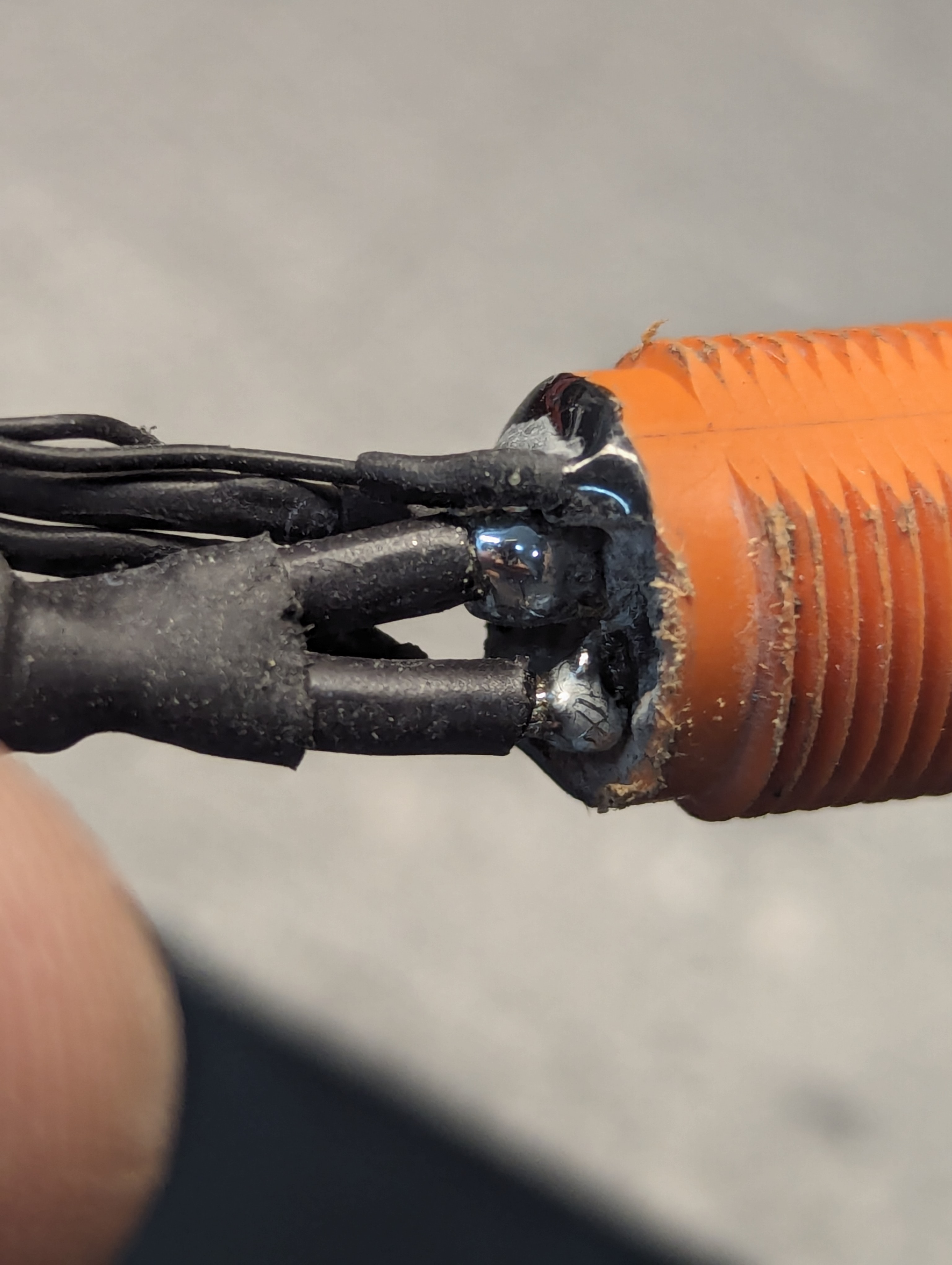

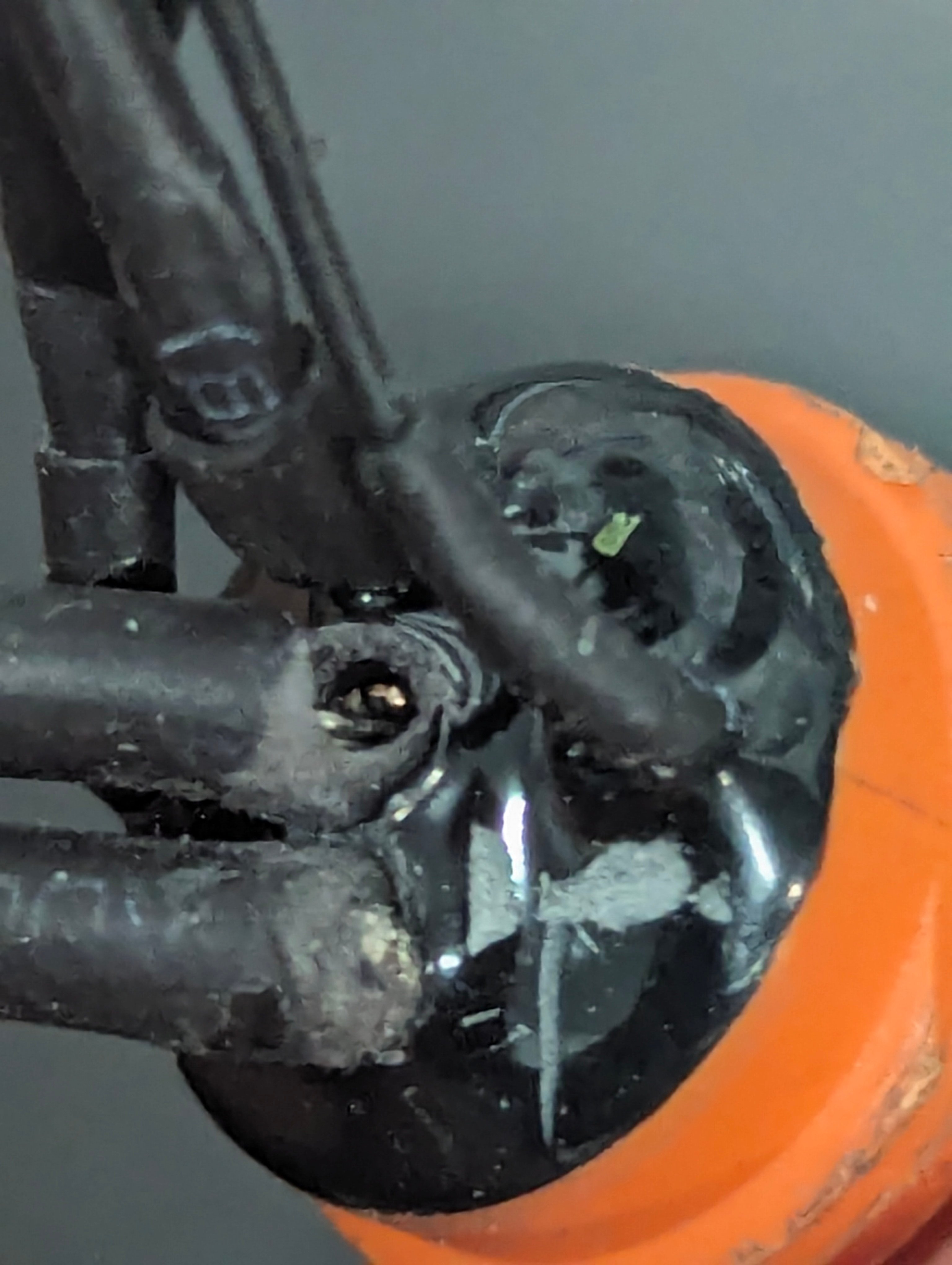

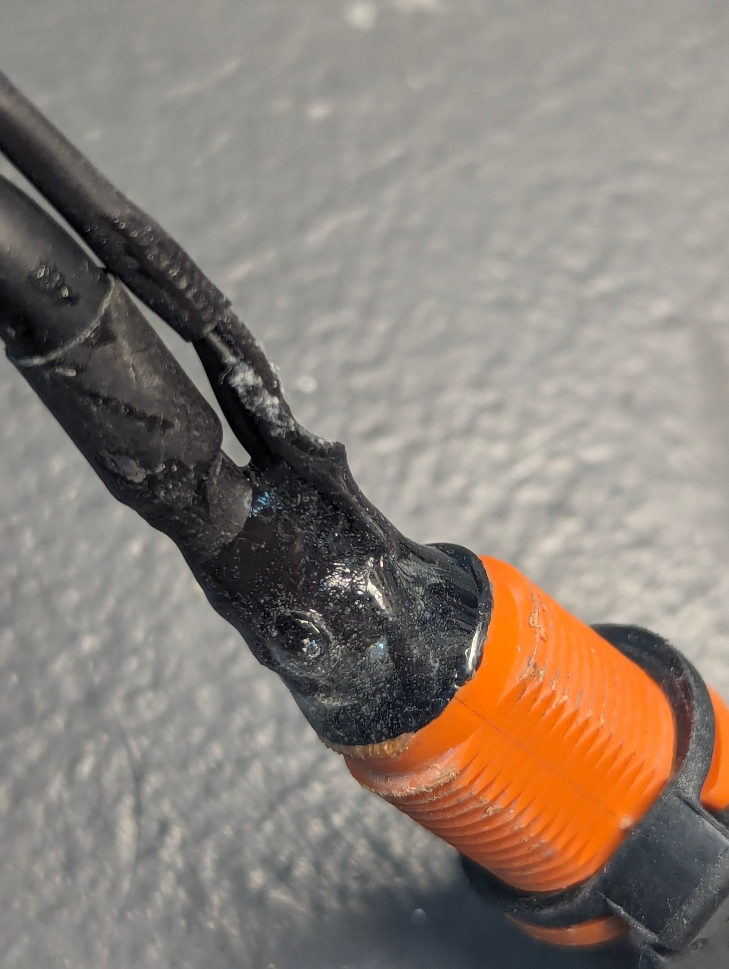

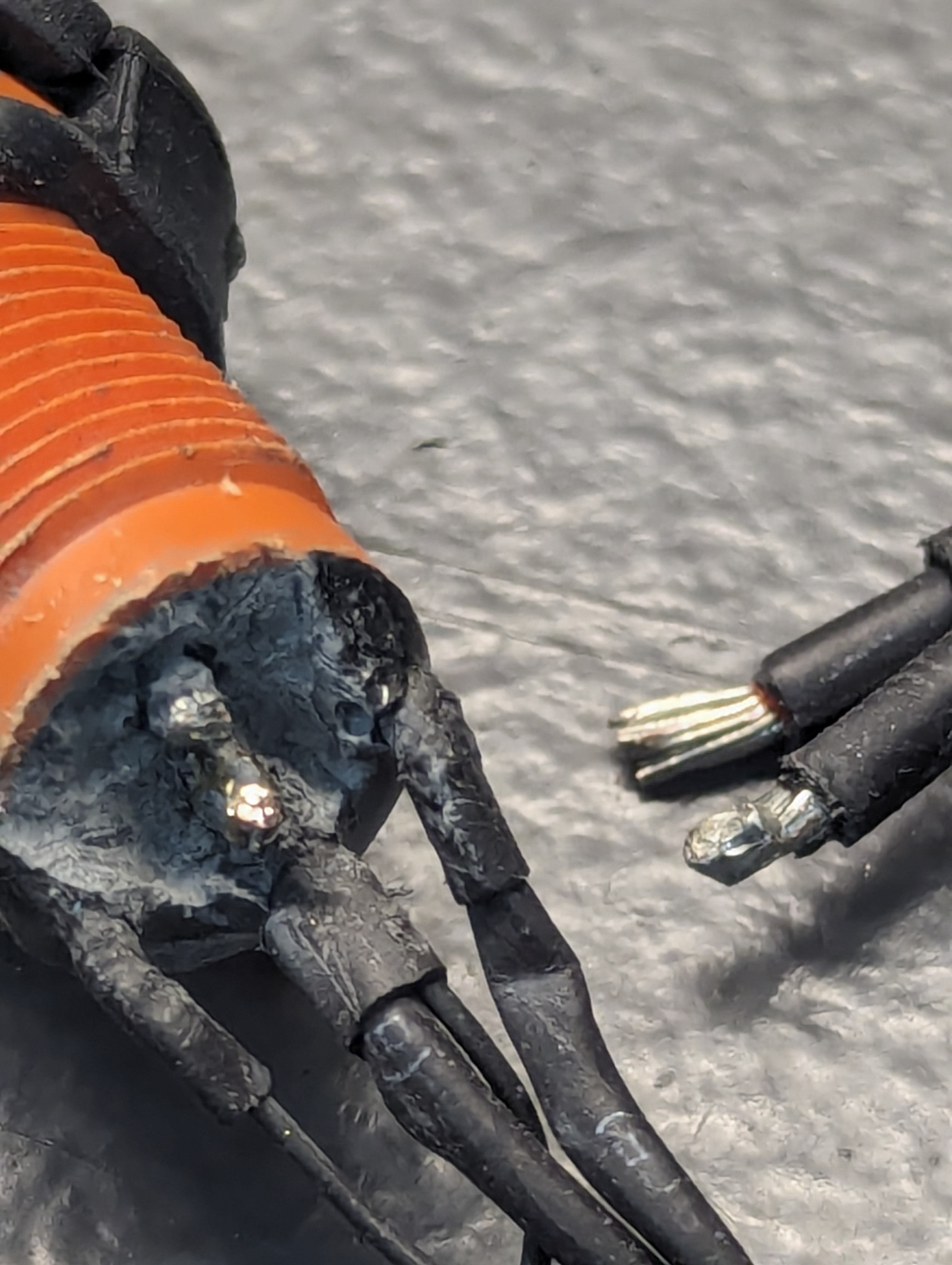

I found the issue. I guess I was being a bit too aggressive when stashing the cables and severed the +/- wires.
Some dremel tool work:
Solder and epoxy:
And it's taking a charge.
Thanks again for all of your help.

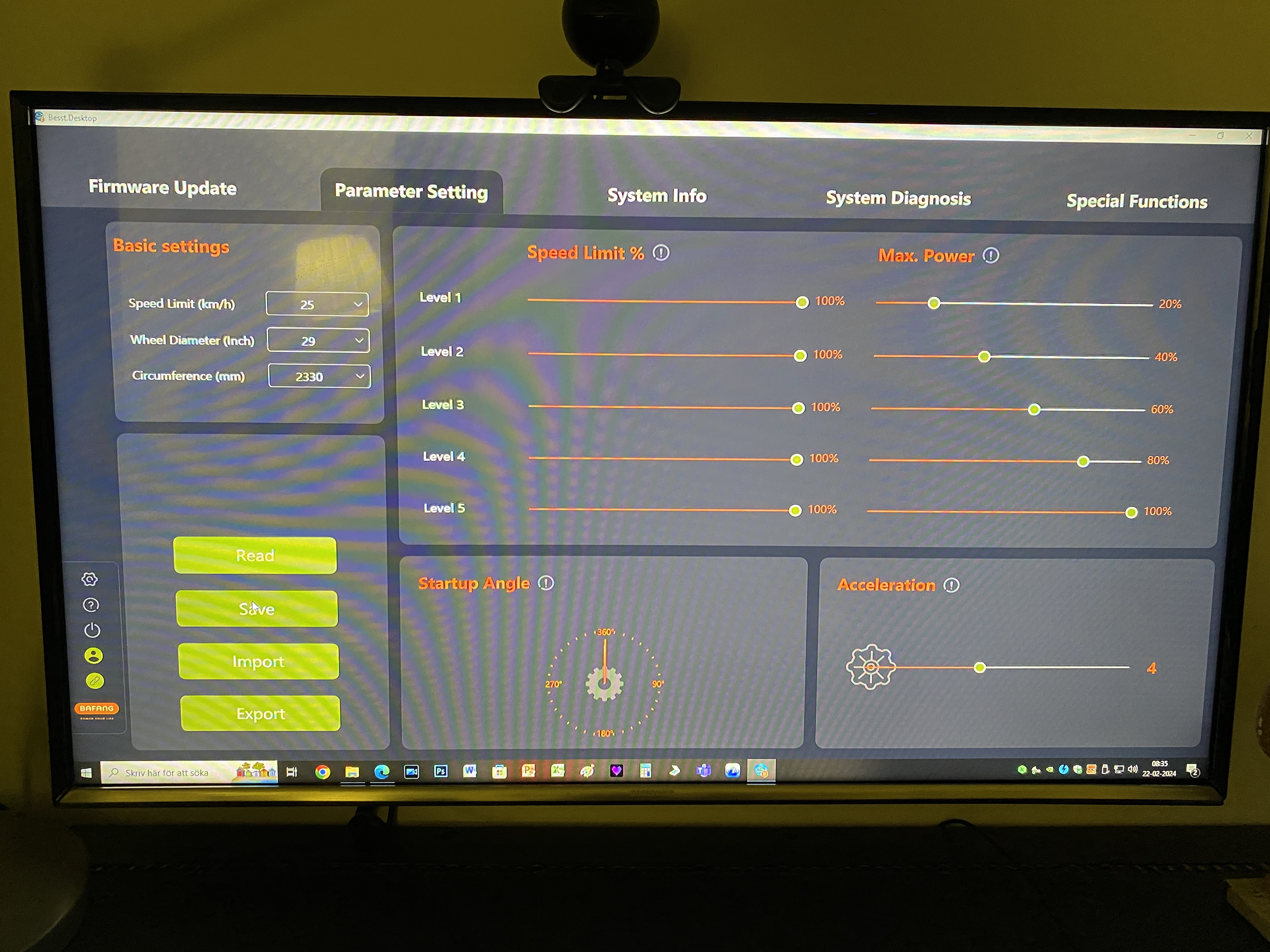

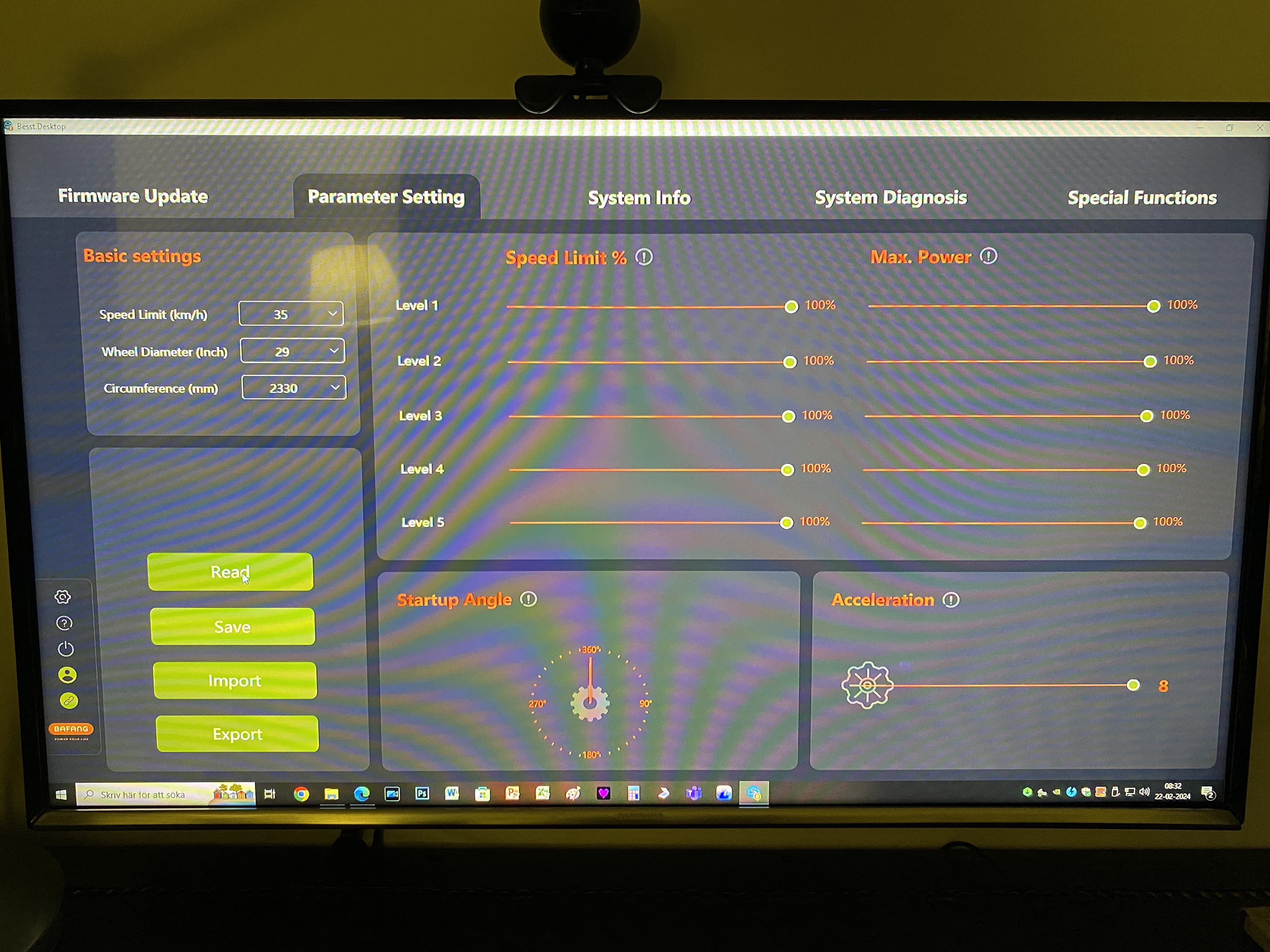

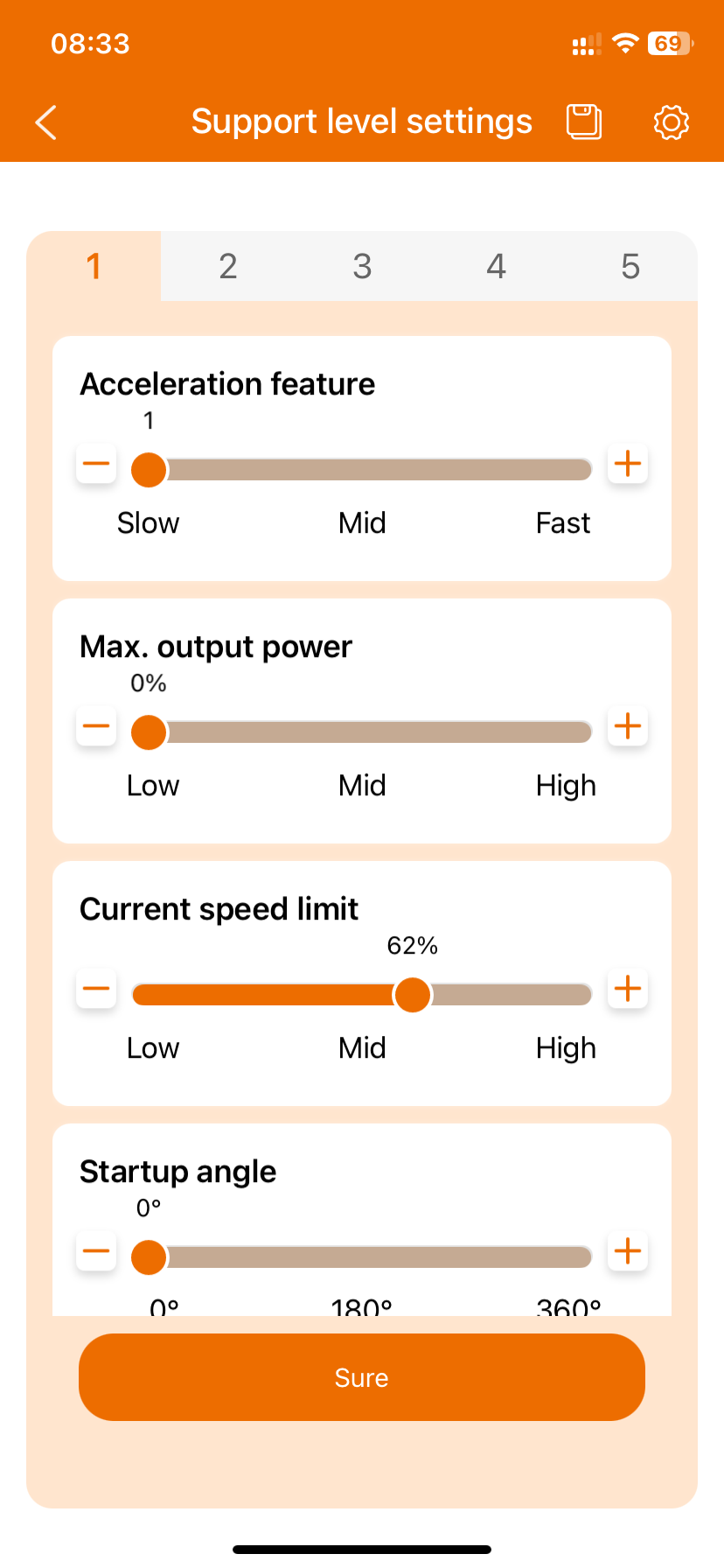

So I checked in Besst Pro, I had all levels on full power:
This means whatever I change in GO+ has no effect on controller. Only speedlimiter seems like it is actually doing something. My GO+ connects fine and everything seems to work, even changes made are "succesful".
I changed the assist levels in Besst Pro, to more or less same as @Neeko DeVinchi had. I went for a ride and now the difference between levels are huge! Still need to test the acceleration setting, what feels best.
On the positive side, this means I have done 3h rides with full power(boost) without overheating the motor or noticing any power drops.

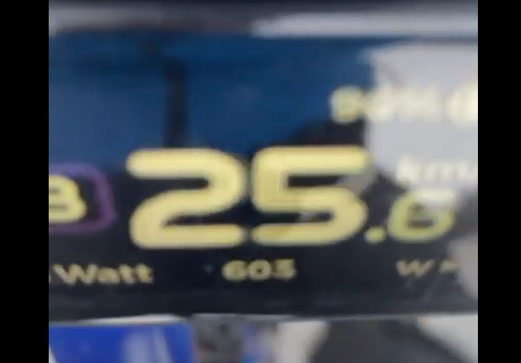

I tried this firmware, thanks! I rigged my camera to film the display since it is hard to watch while riding. I managed 607W maximum on Boost mode, so seems correct, 48V x 12A = 576W. So about 100W more than previous 48V09A.
On other assistlevels it drops about 20% per level as I have put them with Besst Pro.
So now I just need to do some real trail riding to get a better feeling of how it works.

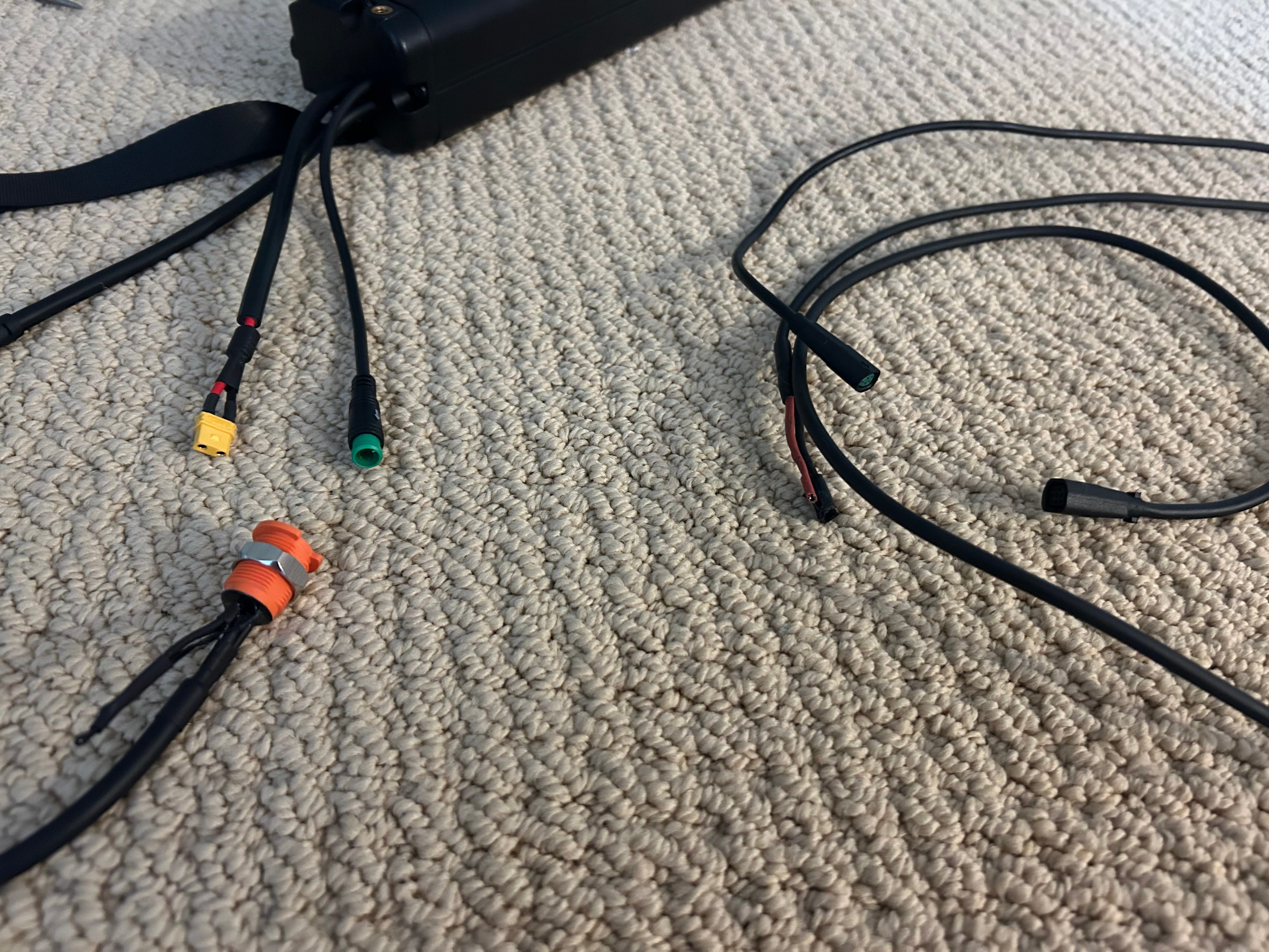

Bafang Battery F014.410 arrived today so I am almost complete with my build but ran into trouble similar to others regarding the wrong cable sent with the motor kit. The wire sent was 1t2 (motor split to display and light). Anyone have the correct wire in the USA? I need the wire from motor to display, light and battery (Round green). Anyone know where to get one as I work with vendor in China? I can for go the light wires with wiring from motor to display and battery…..
