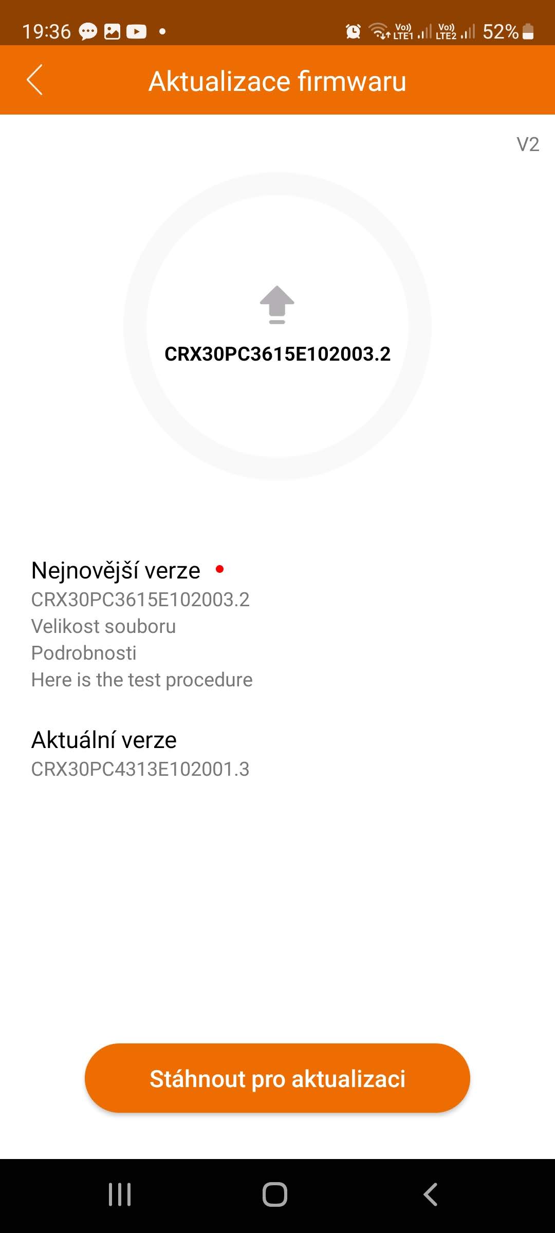

I installed GO+ and it wanted to update my controller. look at the voltage number...

I get this same message every time I start GO+. It wants me to update to a 36V firmware even if I am on 48V firmware.
Dado
Jun 28, 2022
725
487
Bratislava
A bug, and same in Besst. I did get only once an offer to update firmware from server, but also wrong voltage.

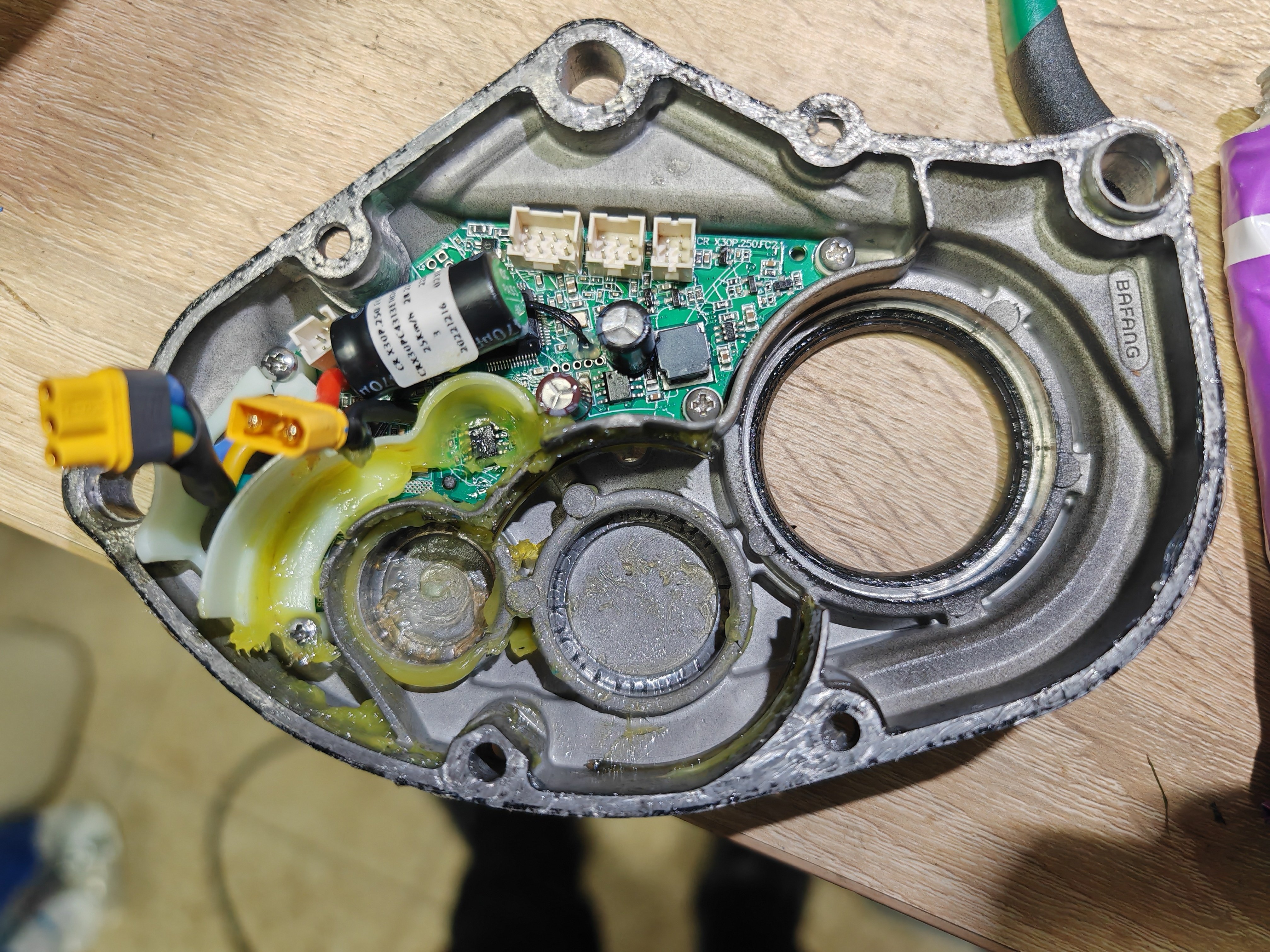

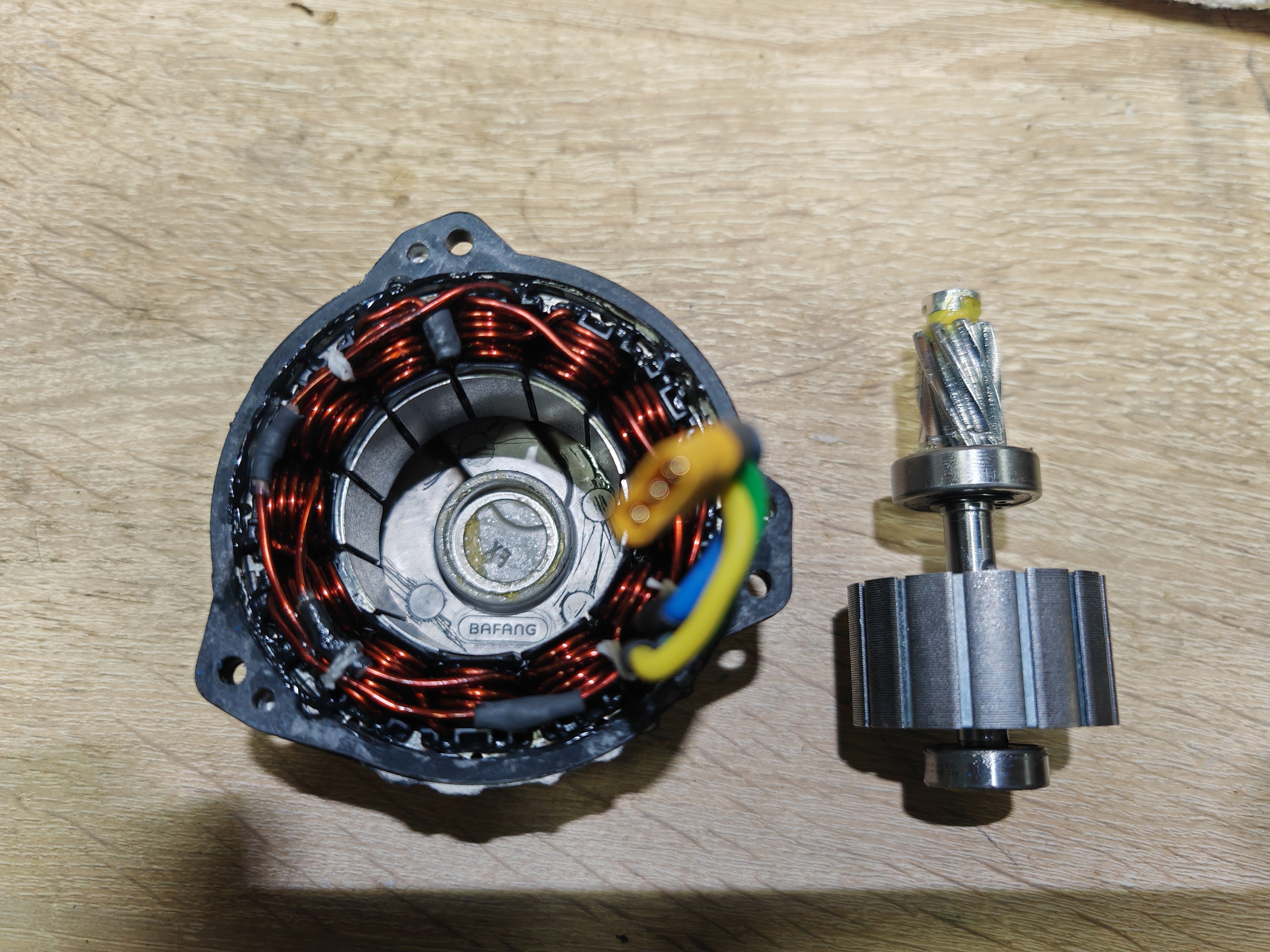

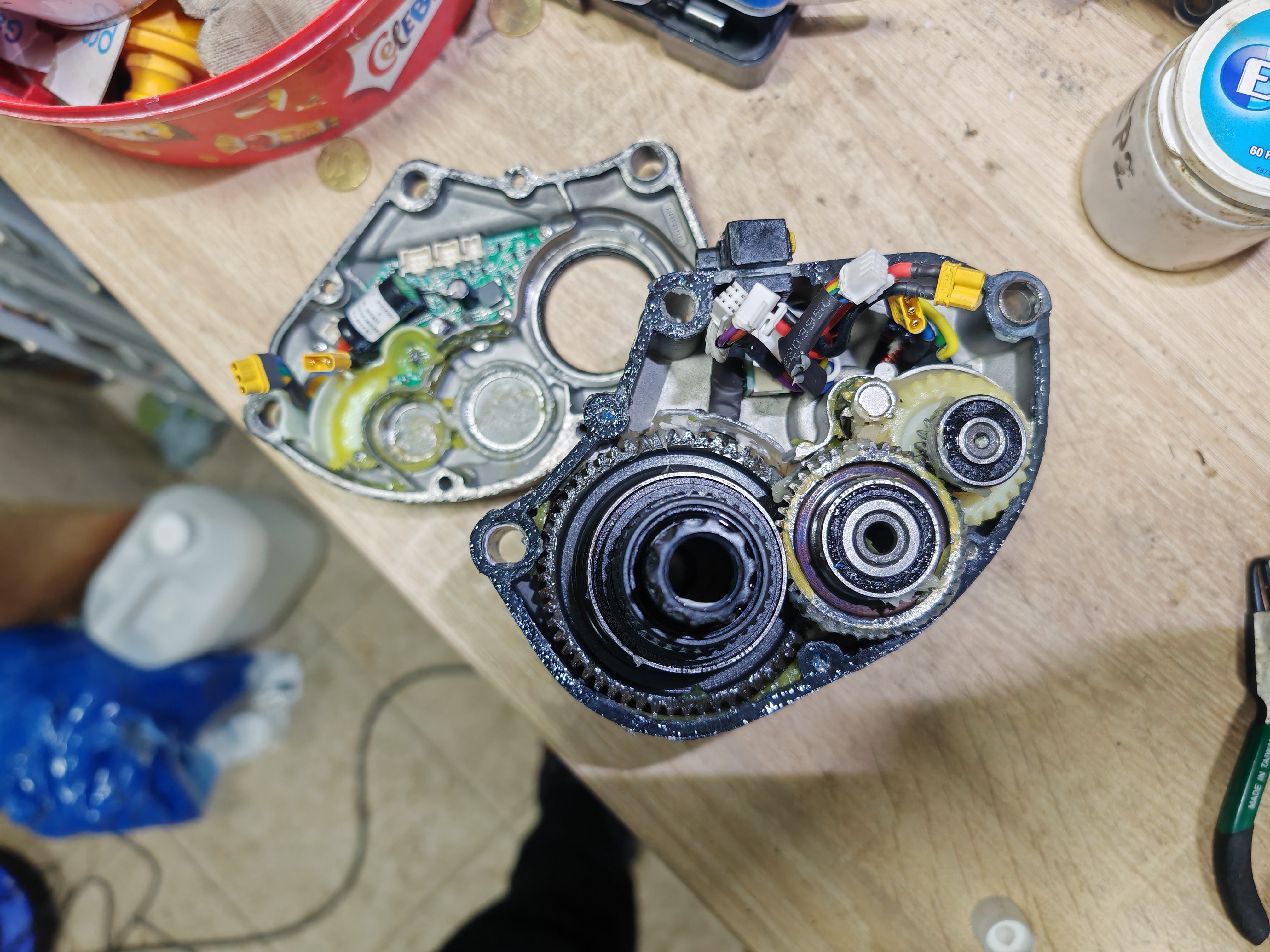

Mod : Copied from another thread as it's useful.
The Motor is easy to open. First remove C clip at the drive side, than unscrew a few bolts around the housing.
There is no need to unscrew 3 bolts from the motor itself at non drive side.
When putting back together do not overtighten the bolts around motor housing.
IMG_20231106_213008_edit_1057215469233891.jpg IMG_20231106_213017_edit_1057203475893062.jpg IMG_20231106_210444_edit_1057231972969145.jpg
14,184
21,098
It's the grease inside (lithium) or you have added it ?
You've not tagged him so he probably won't reply, but in the other thread he said :
Looks like professional work here. Did You already assemble the motor and do a test ride? Reduced noise level / whining?
I have done about 100km after I putt it back together. Noise level I roughly the same. Used molykote pg75 grease.
