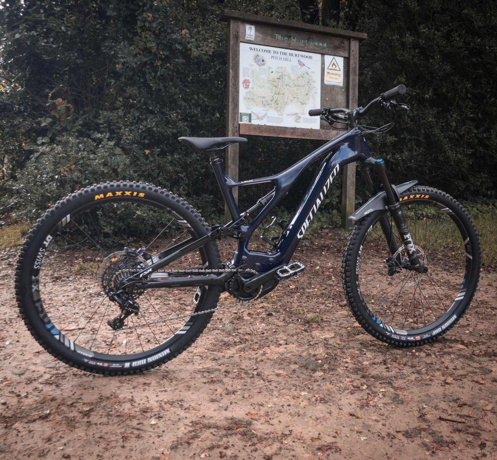

Picked up my Carbon Comp today only ridden about 5 miles but seems to keep lagging when riding especially in turbo mode ???
Demo ‘ed the 2018 Carbon and this didn’t seem to do this , seemed more fluid ? Any ideas ???
But it’s a lovely looking beast ?

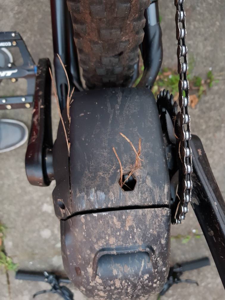

Flipped mine over to remove the battery. It was a dry ride today and on marked trails and it still looked like this. Off piste ride tomorrow. I'll be pleasantly surprised if this survives a UK winter.

Flipped mine over to remove the battery. It was a dry ride today and on marked trails and it still looked like this. Off piste ride tomorrow. I'll be pleasantly surprised if this survives a UK winter. View attachment 6852
I really can't see how this ISN'T going to be a problem. This picture alone is ringing alarm bells with me, I would like to see another one after your off piste ride today. I ride Queen Elizabeth Country Park in Hampshire on a weekly basis and it is notorious for throwing up all types of mud, crud, clay etc. I'm not sure having holes in these areas is going to work for me. Would look forward to you keeping us updated with how you find it.

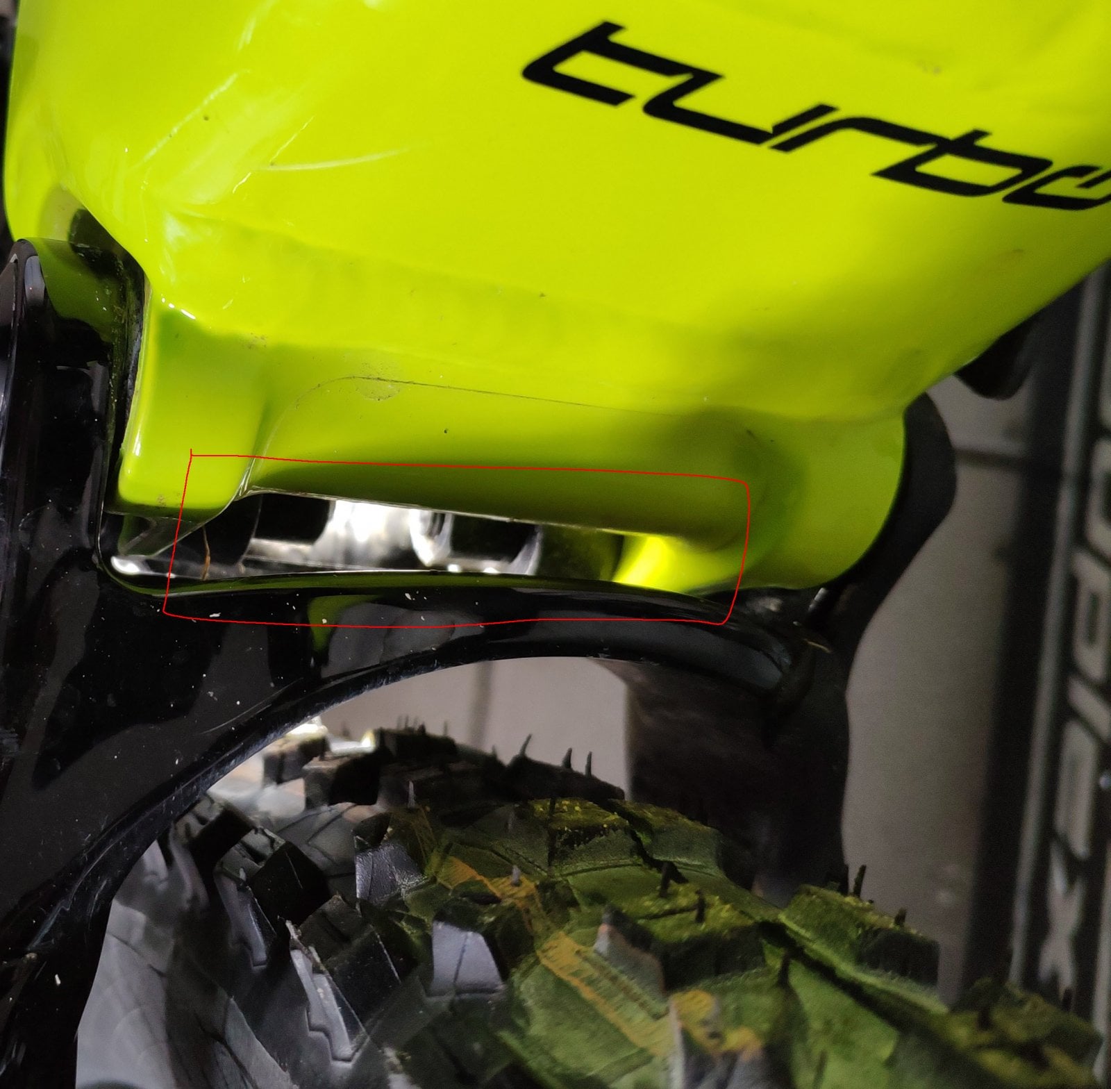

no two
one about 4mm x 50 and the second larger about 8mm by 50mm (you can se the bolts behind)
with a flash light (bike reversed and cover open) it is clearly seen.
Could you take photos of what you are describing and post here please?

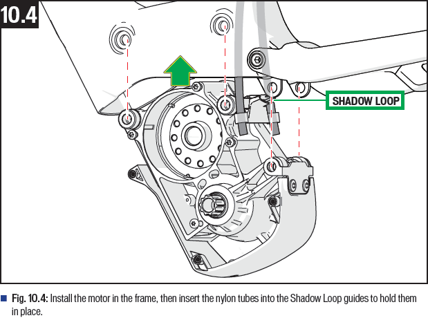

Hi all,
Can someone take a few photos of the hole/slot/gap in question and post it on the forum please?
Unfortunately I do not have access to a 2019 bike and I want to see how big this hole/slot/gap is so I can hopefully work on a temporary/permanent fix in advanced of me getting this bike or if I can’t work out a fix I will probably have to cancel my current order.
I don't have one, but looking at the user manual: Fig 10.4 shows it best, on rear of motor there is a small bracket that joins outer motor casing to the 3rd (rear most) main mounting bolt hole of motor. Solution might be to replace that small bracket with one having a tall crest that extends up inside the frame -- to act as a slide to direct debris to the outside. Should be fairly easy to make yourself out of a piece of scrap sheet metal.

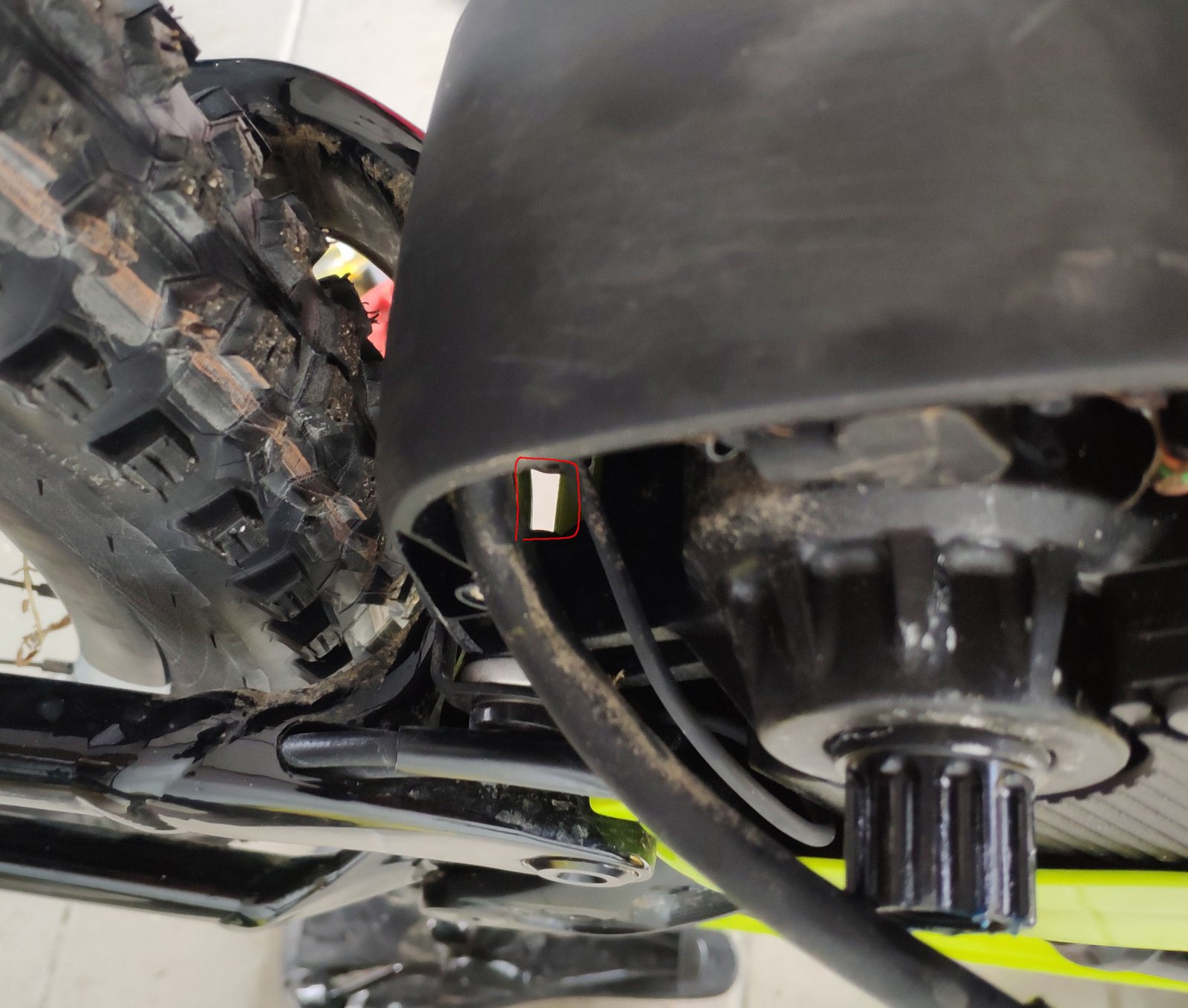

This is the best photo I could take of the largest gap. I would have thought when debris enters from there it doesn't have an easy passage to exit through the bottom drain hole.
Bike upside down
With torch inside motor casing
Bike upside down
Thanks very much for that (y)
Why, why, why would anyone put holes/gaps in a motor casing directly in line with a turning rear wheel......
Where did they think the water, mud, stones, pine needles, leaves and anything else would go that is attached to a spinning rear wheel :rolleyes::rolleyes::rolleyes::rolleyes: this is truly unbelievable and really annoying....
@Specialized Rider Care, could you comment on this please?
same opinion on this...!
9,190
Probably because he is thinking the same as us and has had to go up the food chain for an answer!
I still reckon the gap is there for airflow for the battery/motor.
What i don't get is when developing any ebike, especially with a new motor, surely all the brands take it out in varying conditions, and then take out the motor to insepect and then make the relevant checks and further develop the design based off what they find.
I cant see how Specialized's turbo development centre in the alps didn't pick this up, no way they wouldn't have noticed it, so maybe they made a judgement call that in order to get the cooling, they had to compromise on the containment.

Could you ziptie a piece of innertube so it hangs down over the hole? Some sort of water deflector + MX foam would seem to solve the worst of the problem. I'm a bit dumbfounded they didn't address this in development. That slot is in the #1 place all mtbs collect crap.....

It's all gone very quiet from Specialized Rider Care......
Heard from reliable source, that this problem is already been brought to their attention and there is fix coming out soon. Probably new bracket, that will somehow obstruct debris entering the gap. Fingers crossed that they are really doing something.
