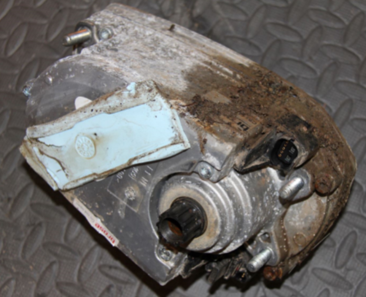

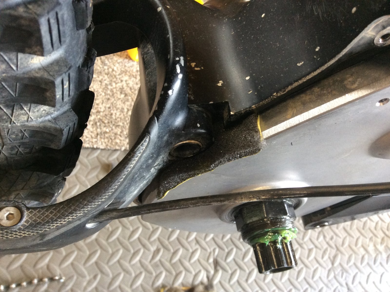

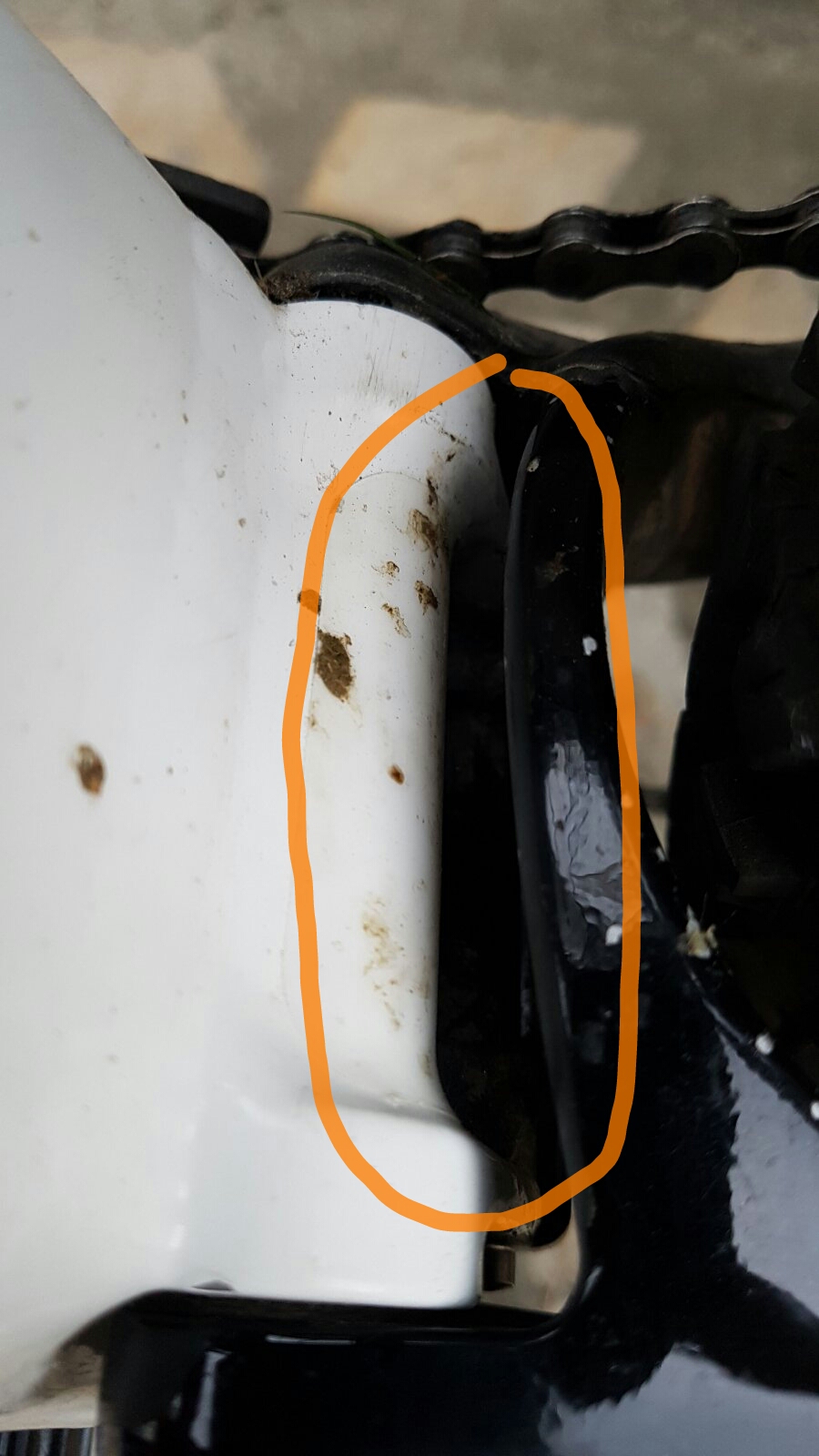

This is really disappointing to see, I thought my 2017 Levo was bad as it had a gap near the rear chainstay pivot that let in pine needles, dirt and mud in. That was the reason my motor had to be replaced.
To resolve this issue I fitted some ‘motocross’ foam over the hole as per the pictures below.
I was really hoping they had fixed this issue but it looks like they have made it worse on the new 2019 model.... ?

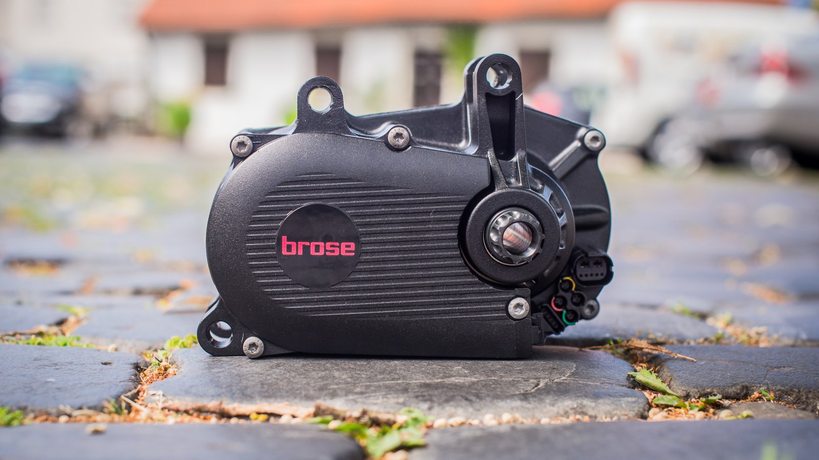

What i don't get (aside from maybe weight, or cooling) is why they don't use the generic casing under the Levo covers? Correct me if i am wrong, but the motor is essentially naked under the Levo covers, which to me look cosmetically driven rather than performance?
The covers dont seem to be keeping much out so I'm wondering now if you could just remove the levo covers and create your own bashguard to protect the bottom (without trapping muck). Maybe they do serve another purpose?

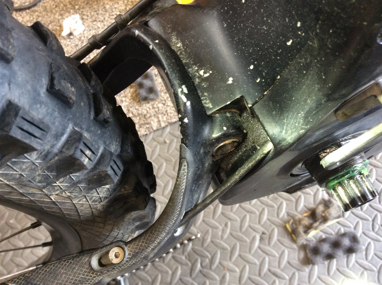

This isnt the hole. Its on the hole between frame and rear tire where the dirt gets in.
Can anyone take a picture of this gap with a proper light shining on the hole/gap so we can see how big the hole/gap actually is please?
Or can you measure the hole for us with width and height measurements? I guess it must be a really big hole/gap to allow entire leaves in :eek::eek::eek::eek::eek:

As I was looking at the shops bike today. There are two bolts that hold some kinda plate where the gap is. It is quite big around 6-7mm wide.

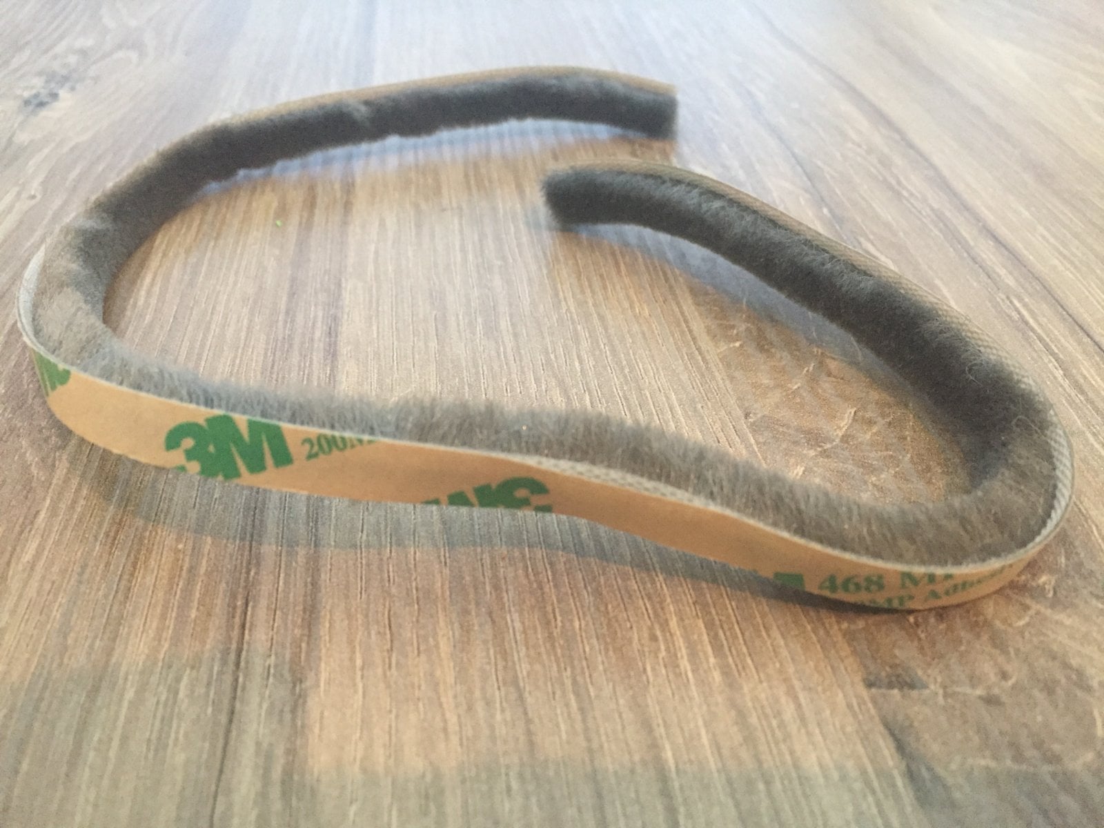

I Was thinking, that it could be covered with one or two layers of mosquito net and attached on both sides( Frame and plate), with some good transparent film.

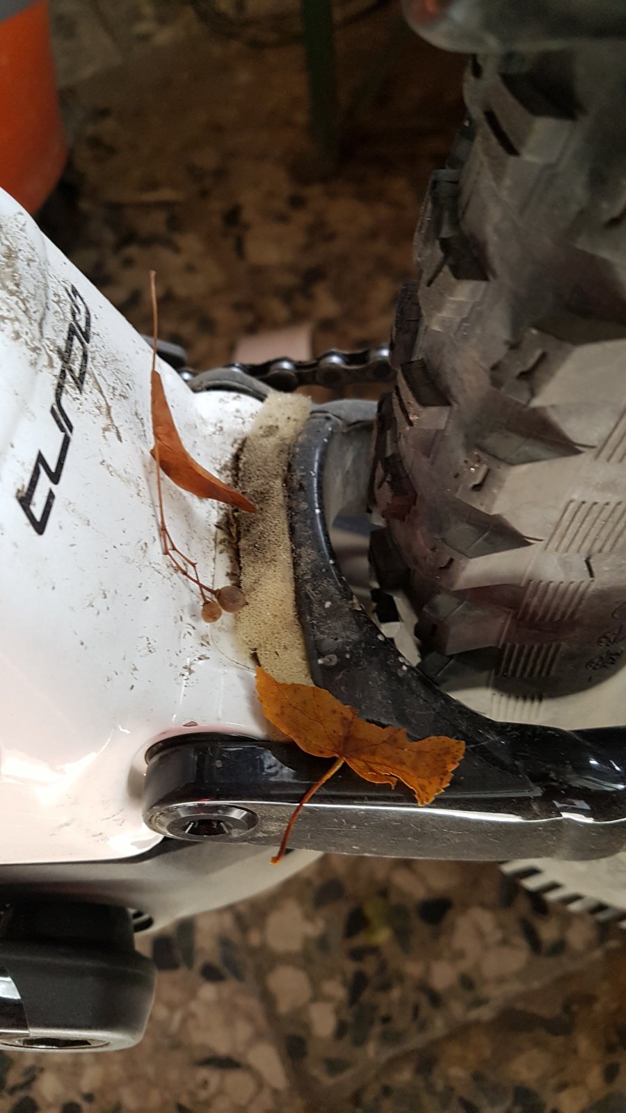

For now I have solved this way: it seems that it works!
I think the solution is more complex than what has been said and showed until now.
Same issue on my S-Works Carbon.
Plenty of leaves dirt and even stones after only 300 km.
Took me a while but found there is not one there are two openings. Considering the engineers from Spec to be far from dumm I assume this is a kind of cooling fender for the motor. So the first question would be " do we risk overheating of the motor if we close the openings?"
If not the foam that will solve the issue would be a foam that close both openings.
I closed both now since my Spec dealer has a new motor (loud) coming for begin of December.
Site tricky. Best would be to remove the rear wheel and the chain stay to get easy access.
The foam I used is a (viscoelastic foam) that was on my R&D shelf (not as I know on market). This foam can be pressed from 10mm to 2 without much effort and takes the volume available shortly after. Thus filling the gap available.
I will monitor the accumulation of dirt over the next few weeks and latest in December when the bike is in for motor replacement I will be able to see the difference.
If the openings are for cooling than the engineering should be such that a "schikane" would avoid any dirt to get in the motor housing.

I completely share your thoughts. It would be nice if Spesh would be able to confirm to their customers why they have choosen for these openings or should I say vents. I asked the question at my LBS as well. They have a dealer meeting November 5th. I hope they can bring it to the table if it's not explained and solved before that time.
Can you maybe share a picture of the 2nd opening?
I think the foam you are refering is a kind of foam which you would normally use between a window frame and a brick wall as well, right?
