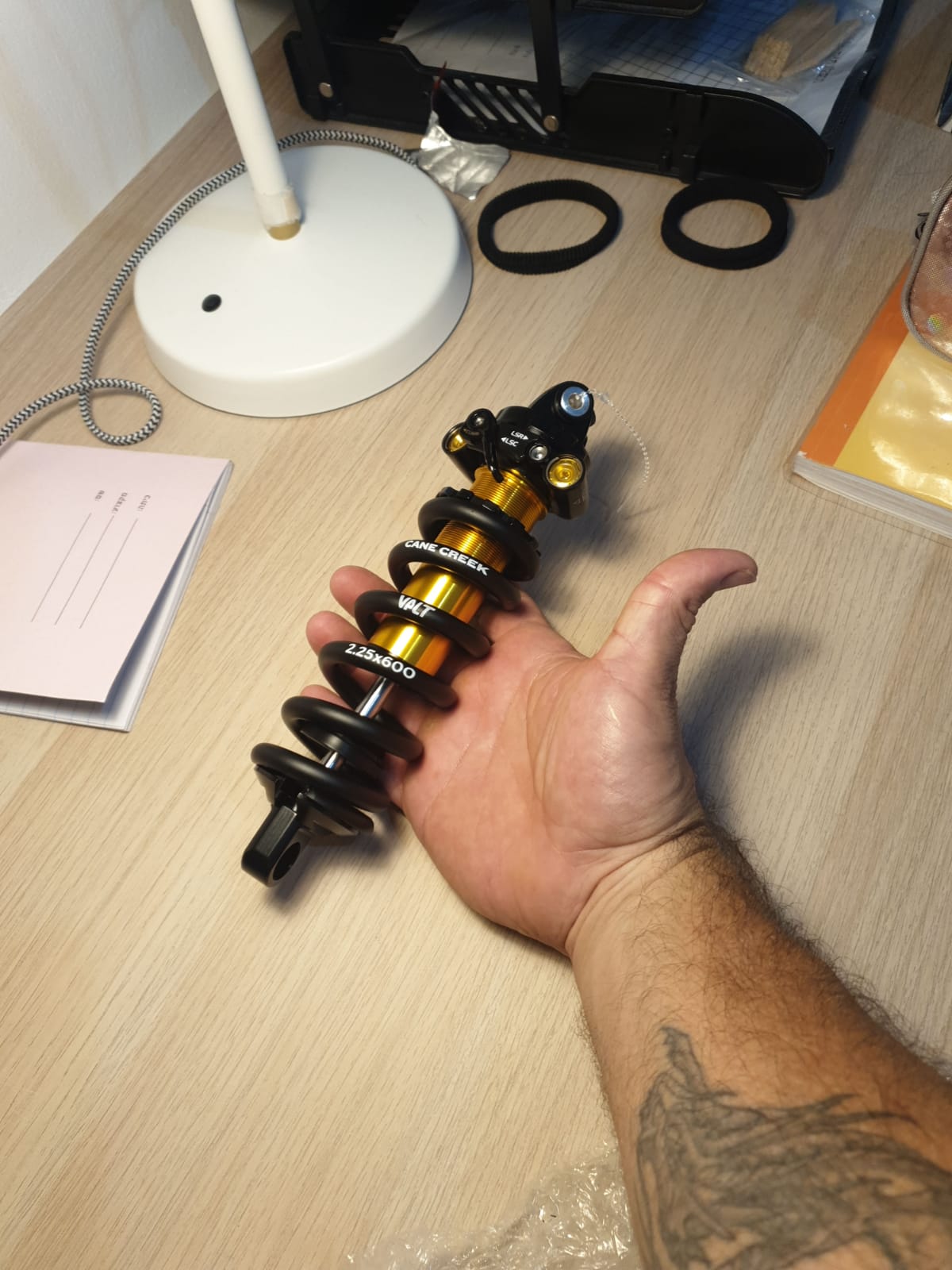

On a positive note, now I have my new warranty battery. I have been able to give my upgrades a proper work out up here in the Scottish hills.
Upgrades:
Lyriks 160mm
Crane Creek Coil Shock
SamHill Pedals
Schwalbe E typres
Riminserts front and rear
Wow, the difference the suspension makes is fantastic, the bike is much better balanced and settles nicely into the support of the suspension. It feels very plush but supportive. Previous eBikes I have tried where front-heavy making jumps and drops tricky but the now the bike is a lot more neutral and a couple of turbo pedals I am dropping and jumping everything I do on my Capra.
The pedals are doing what good pedals should do, just getting on with it without being noticed. The tyres are a massive improvement over the stock rubber, especially with the rim0-inserts allowing lower pressures with no damage to the rim just yet.
Going to swap out the grips and more than likely Zee brakes at some point (just prefer Shimano brakes).

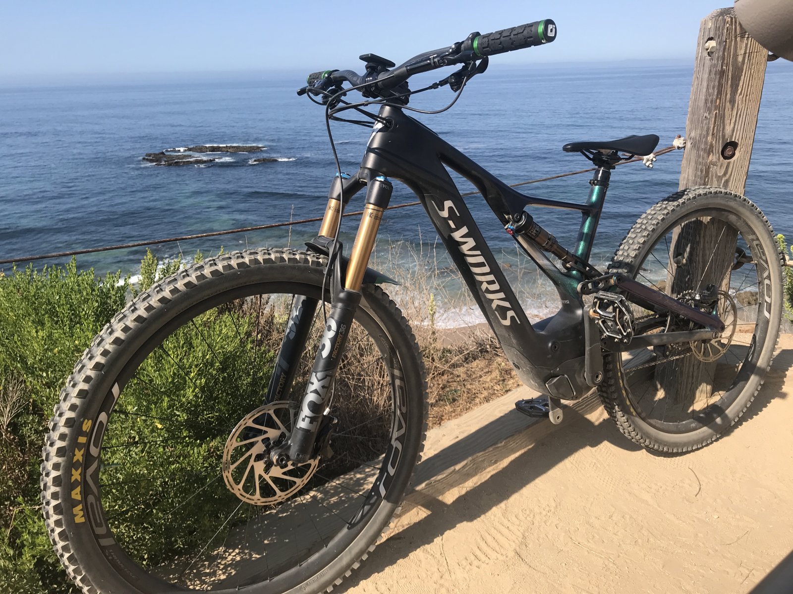

SWORKSLOVER
Aug 20, 2020
20
17
Southern California
artzicat1
Mar 3, 2019
65
108
israel

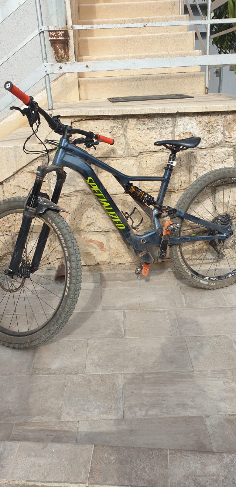

first ride as a mullet had no choice as the rear rovel wheel died twice switched from sram gx to XTR 11 speed plus revelation fork extended to 160 with new 2020 debonair plus rct3 cartridge plus DSD runt feels like a glove more playful

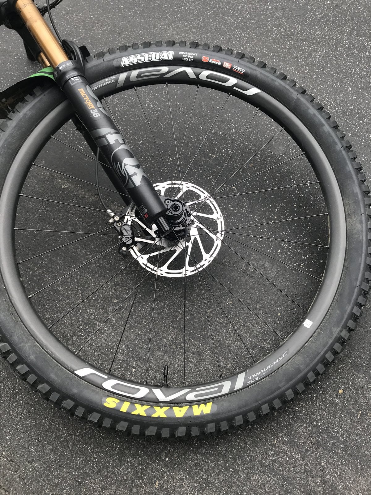

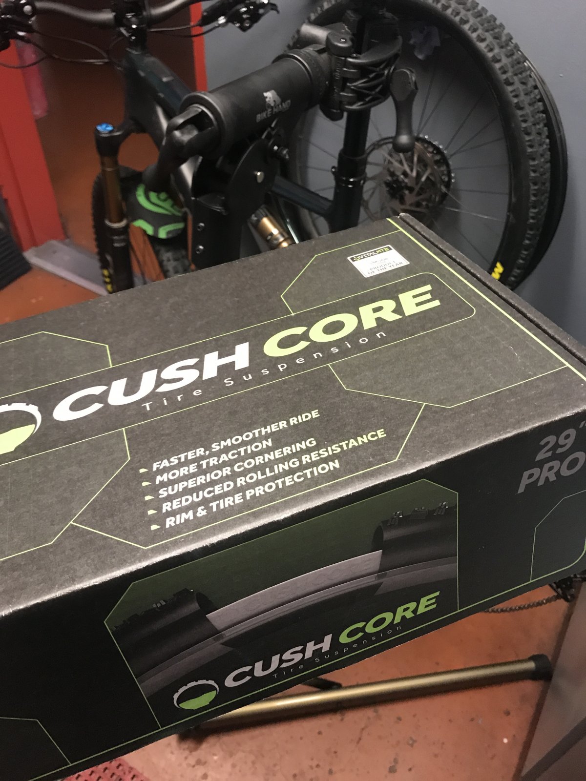

just got my Levo. Trying to decide on inserts like cushcore and/or carbon rims...thoughts?
Defo not carbon rims....stupidly expensive for no substantial gain and a higher risk of terminal damage. As far as inserts are concerned I have never seen a need provided you match the tyre and pressure to the terrain you ride.
High Rock Ruti
May 13, 2019
439
341
Massachusetts
High Rock Ruti
I bent an aluminum rim and straightened it with a pair of pliers.
I doubt a carbon rim would've survived. Weight does not seem to be a consideration at 43-55 pounds some claim they can feel the stiffness of carbon, I can't. I've installed cushcore in two out of three bikes, the new bike got a pinch (without) flat on the second ride. I yet to have flat since installing cushcore on the other two bikes. The ability to run very low pressures is also great for highly technical riding, I'm a fan.

latest edition blew a seal on my rock shox monarch so a good excuse i think don't you ?
just need to ride now see how it feels,have a feeling i'll need a stiffer coil :rolleyes:
