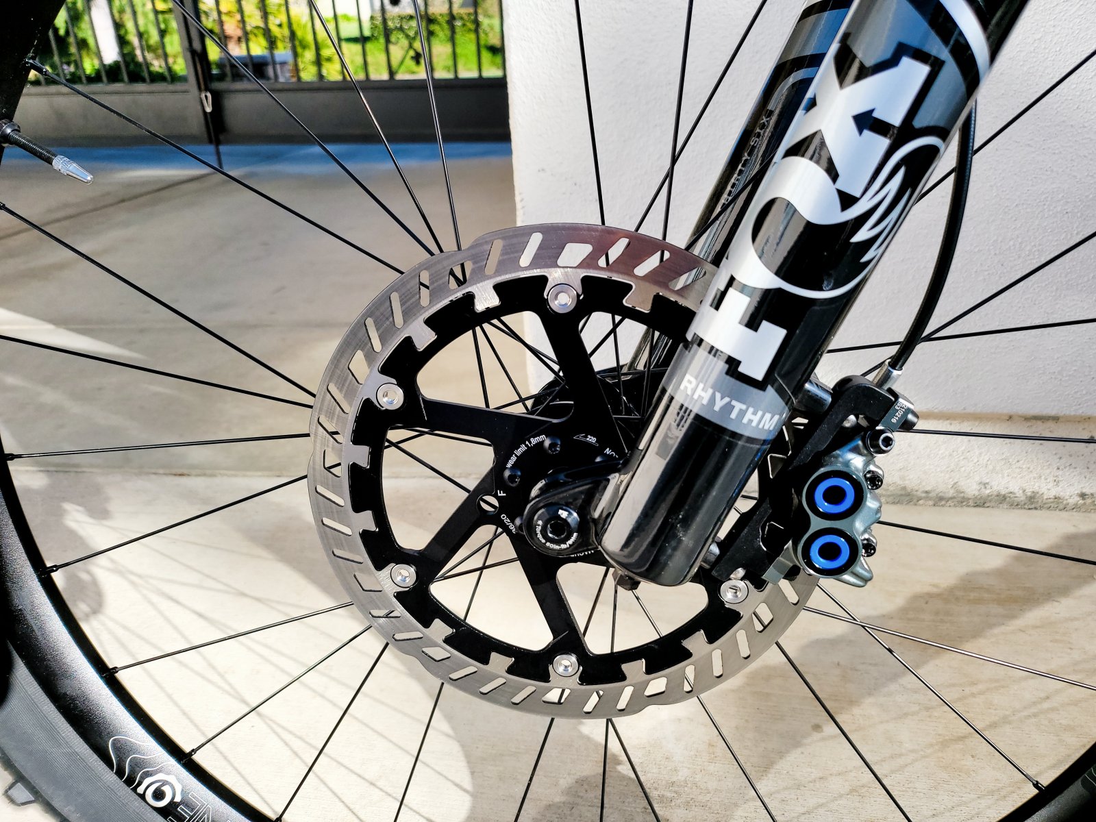

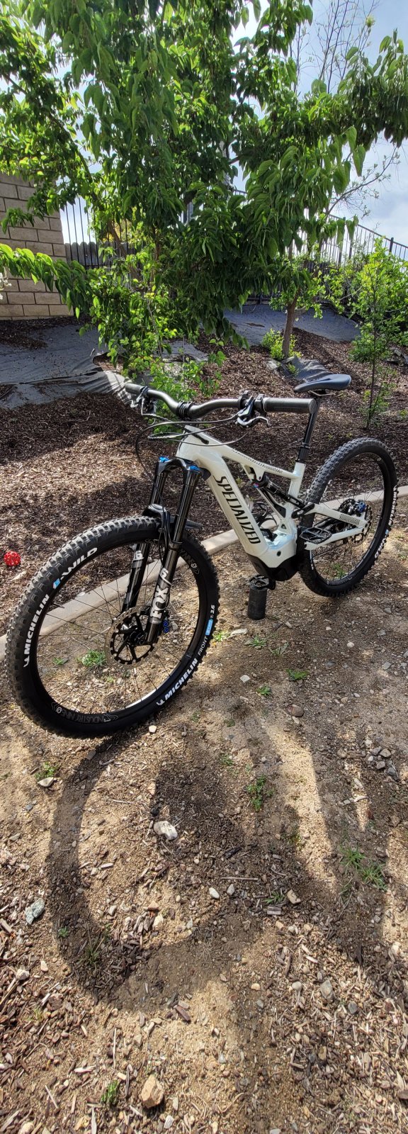

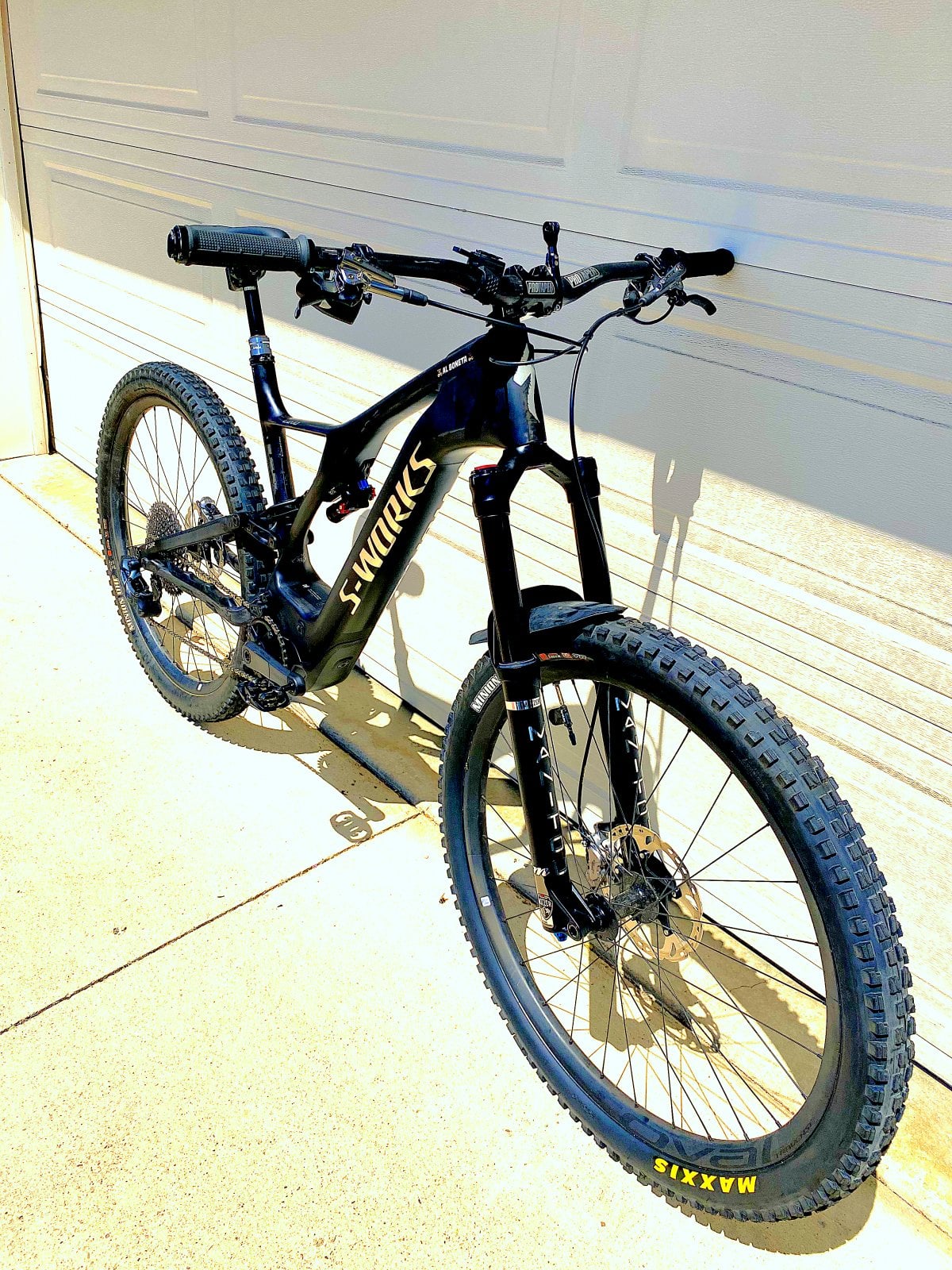

I think the fox 36 comes factory with this bike, what made you decide to swap them to the 38?
I am a heavy/aggressive rider so the stiffness will be helpful. Also the 38 is about 6-7mm taller axel to crown than the previous year 36. By going up 10mm in travel plus the extra height the front end is raised about 16-17mm. That works out to about what I lose by putting the 650b wheel on it. Basically keeps the front end and geo around the stock height.
Also its fox36 rhythm, which is a good fork but has no adjustments other than a compression switch - open, med, firm. If you like to tune your suspension you will want an upgrade for sure.
DtEW
Dec 8, 2020
206
190
Bay Area, California
Actually, the compression adjustment on the 36 Rhythm's GRIP damper is detent-less, so theoretically has an infinite number of settings within its adjustment range. But no, it is effectively not as adjustable as the de-coupled low/high-speed compression adjustments available on the GRIP2 damper of the non-Rhythm forks.
(You might be extrapolating from the '21 Levo Comp's rear shock, which does have a compression adjustment of only open/medium/firm settings.)
It does also need to be noted that the GRIP damper has a rebound adjustment (22 detents, FYI) as well. Did you miss it under the knob cover at the bottom of the right leg?
And the air spring is tunable with a combination of air pressure and spacers. I believe the 36 Rhythm as it comes from Spesh for the Levo Comp is equipped with two spacers already installed.
So... plenty to tune, but obviously not as much as that of the GRIP2 forks.

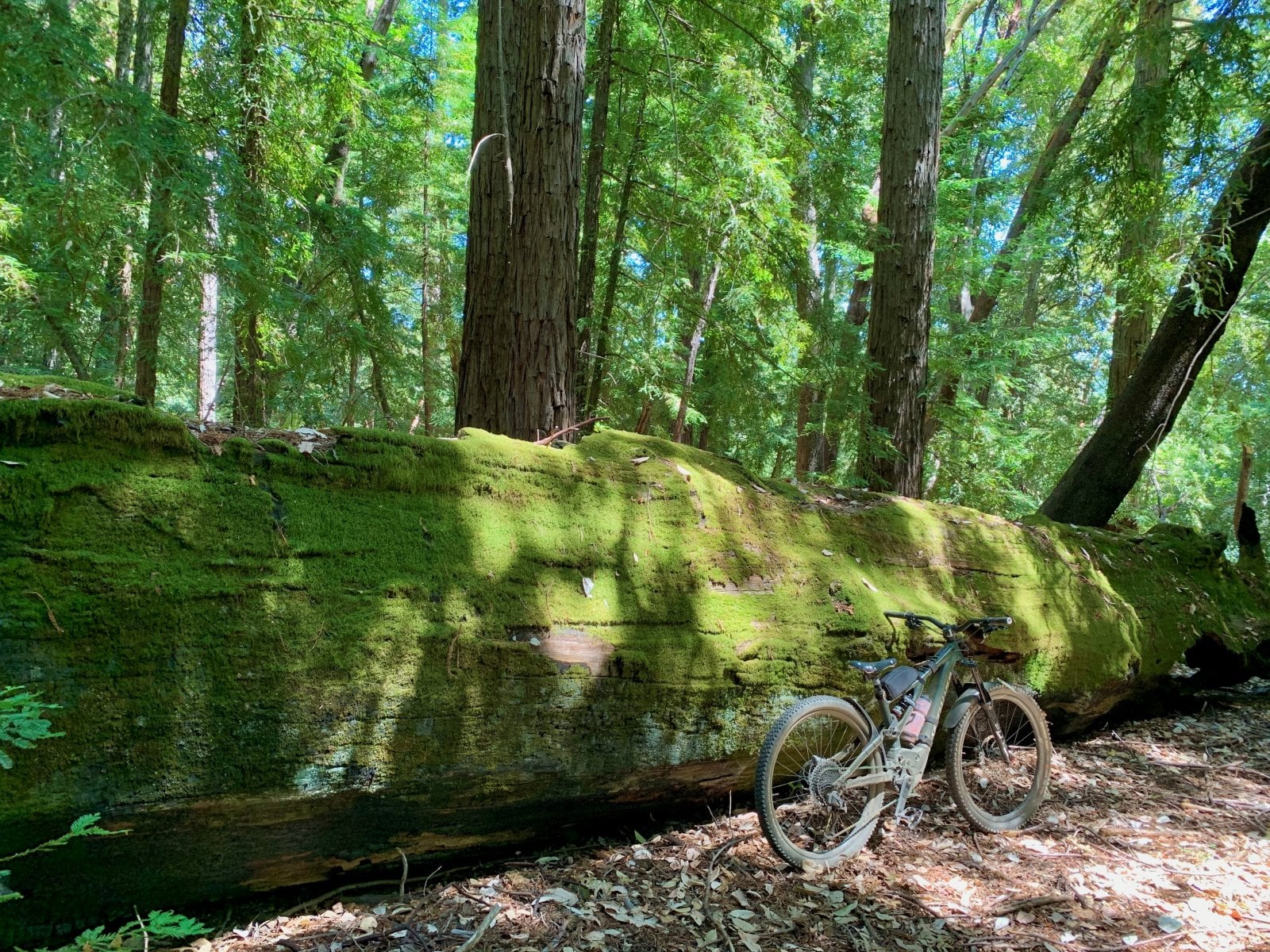

cleoent
Aug 25, 2020
82
84
NorCal

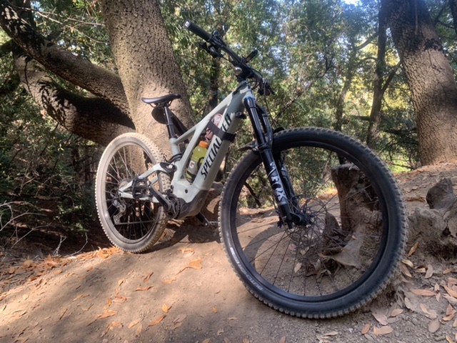

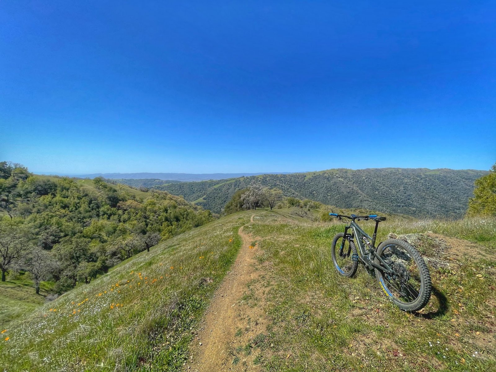

A gorgeous spring day in NorCal.

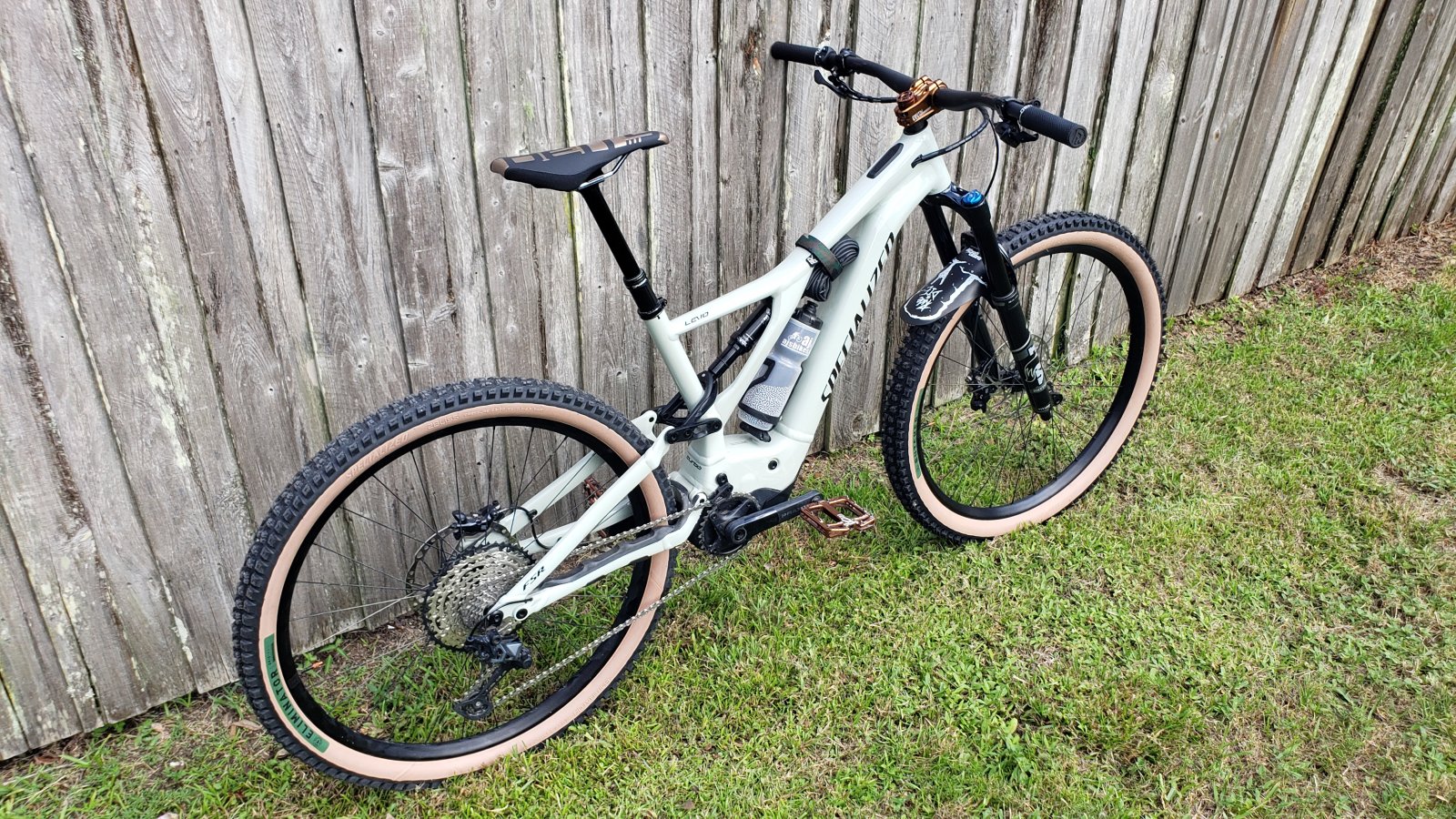

h.grenade
Feb 13, 2021
65
43
PNW
@congerball Any of the newer motors should have the upgrades. I have no idea about build dates but the dude mentioned the 2021 bikes have the same motor with all of the changes.

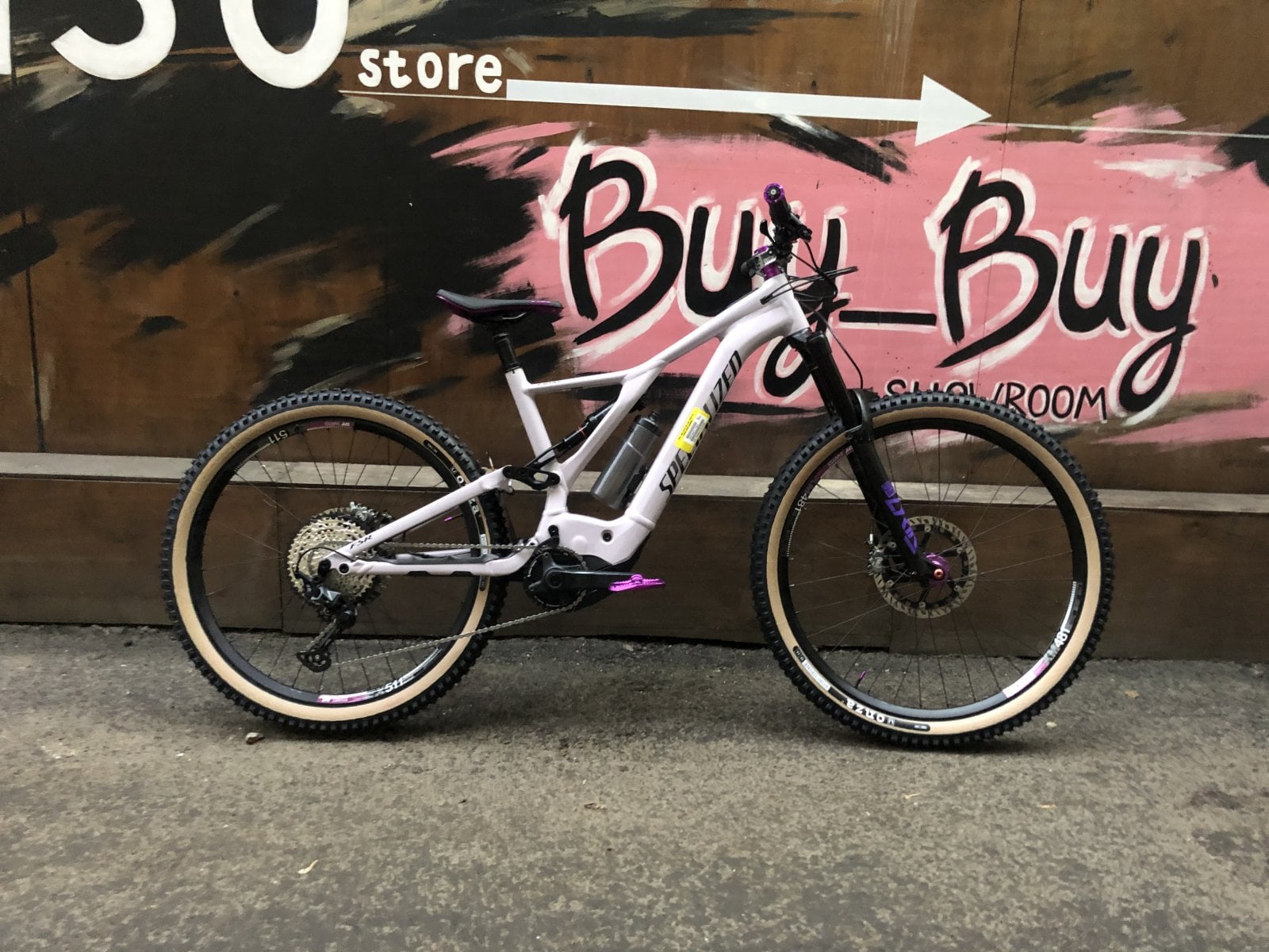

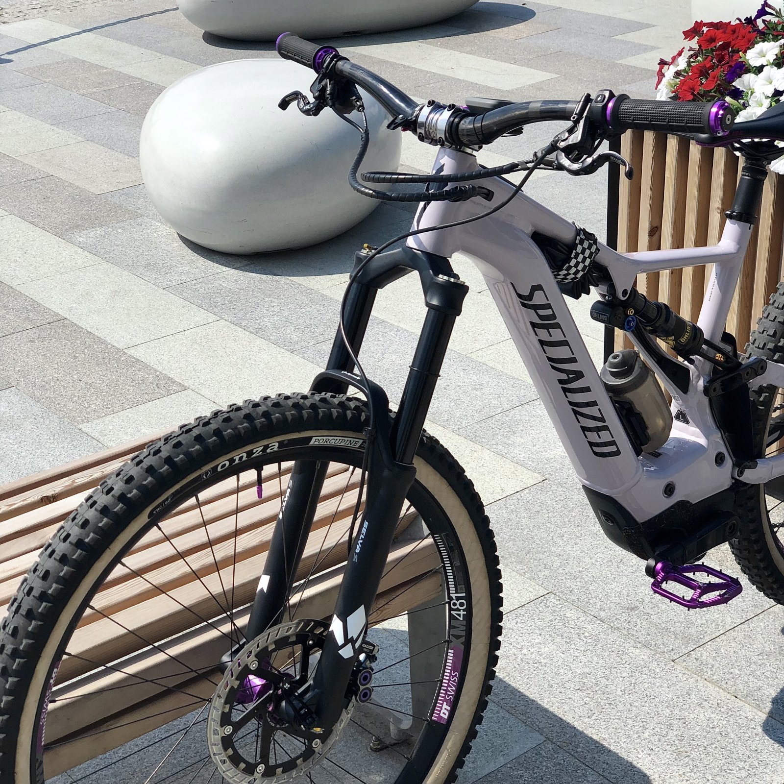

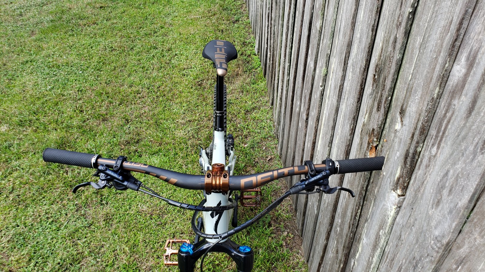

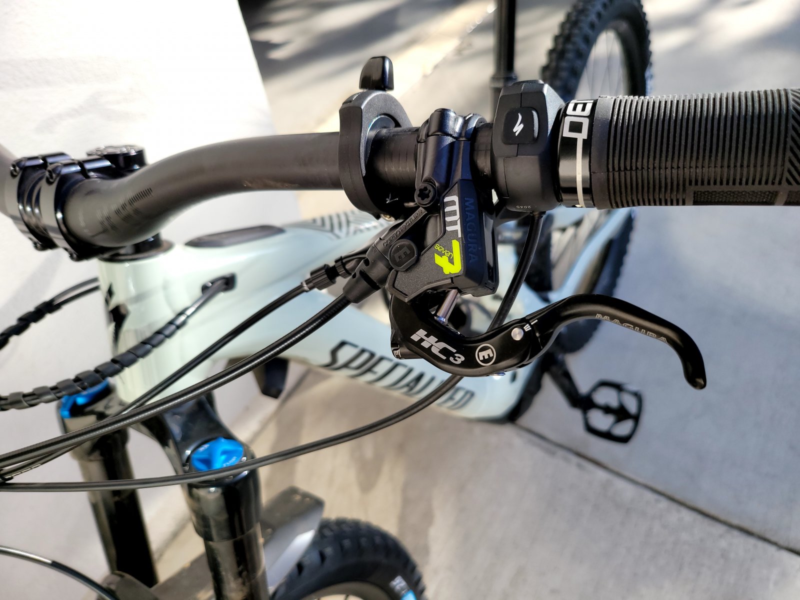

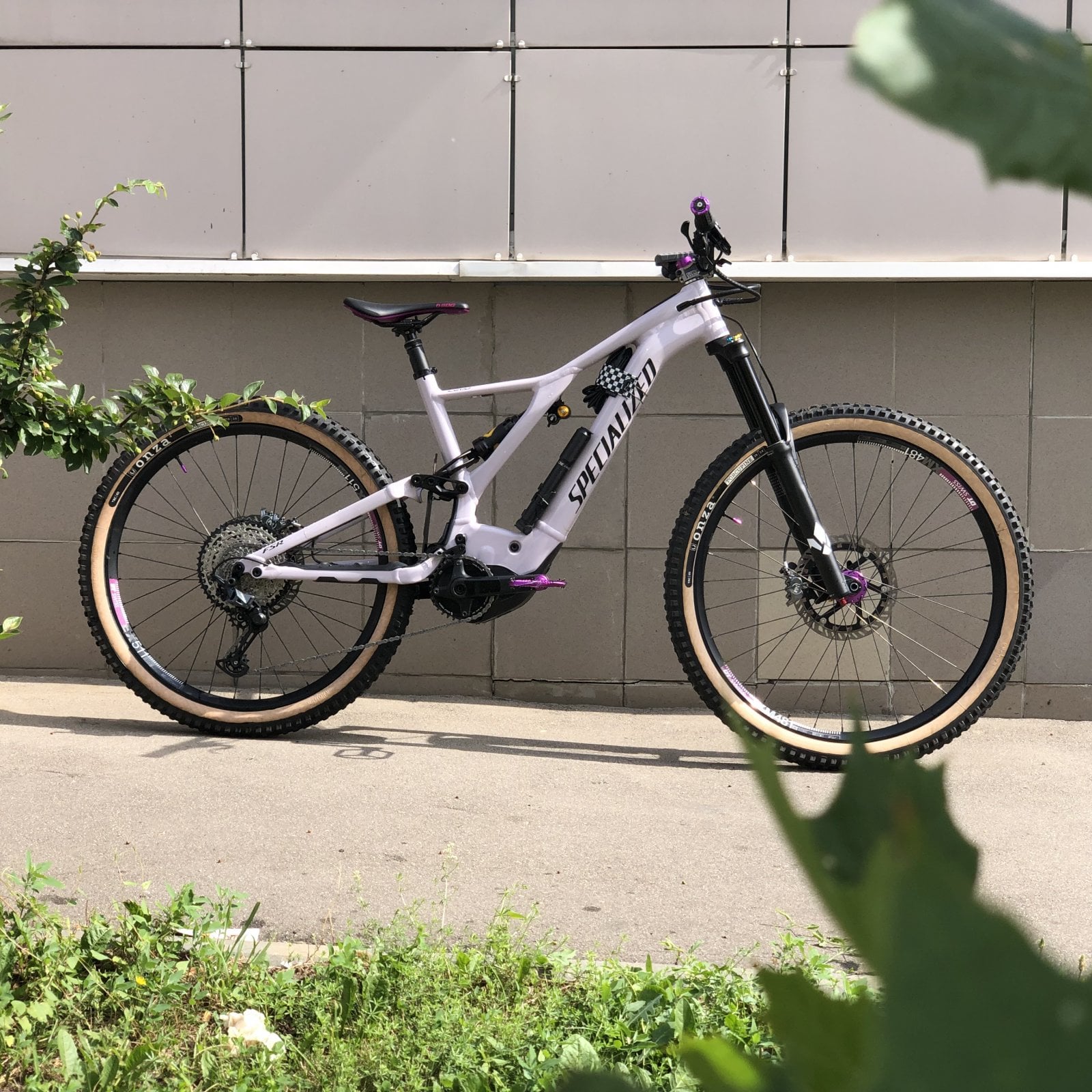

It finally arrived! Most of customization already done, but Öhlins TTX Air is on the way plus 180 mm dropper.
• Lyrik Ultimate + DSD Runt
• Öhlins TTX Air (waiting)
• Magura MT7 + HC3 levers
• Shimano SLX + XTR shifter
• Hope Pro 4 on DT Swiss rims
• RevGrips, Nukeproof bars, OneUp pedals, SDG Bell Air III and lots of other small tweaks.
2021 Turbo Levo

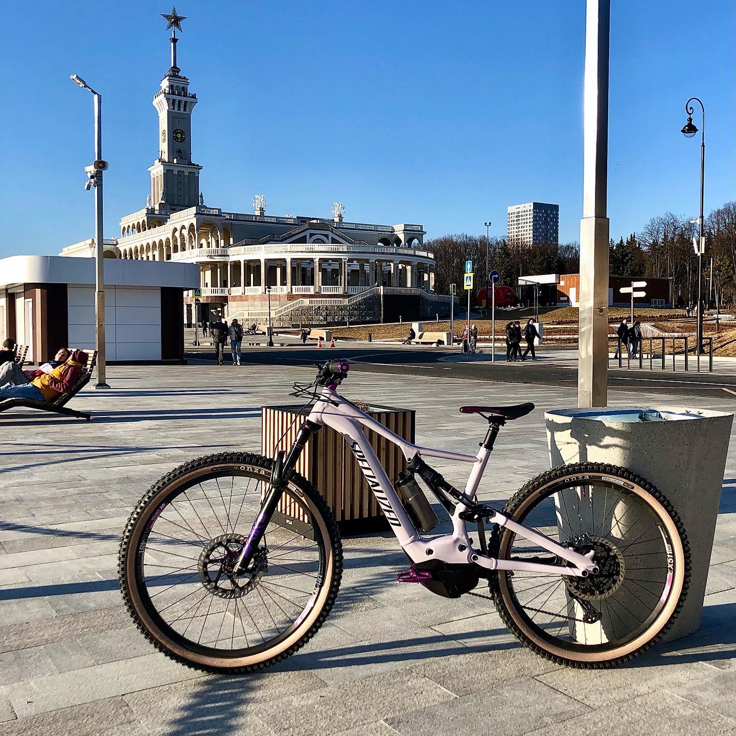

Latest upgrade: amazing Formula Selva S (or R, depending on the mood, I just installed R air spring for a comparison).
I didn't realise that something could perform better than custom tuned Lyrik Ultimate with DSD Runt and Fox 38 I recently compared to Selva Selva is a MUCH better performer! So, if are looking for superb performing fork, I strongly suggest to try Formula Selva (S, R or C). As a side note, you should spare a lot of time and go through different CTS tunes to find what works for you (I tested 5 of 7), Blue is my favourite now.

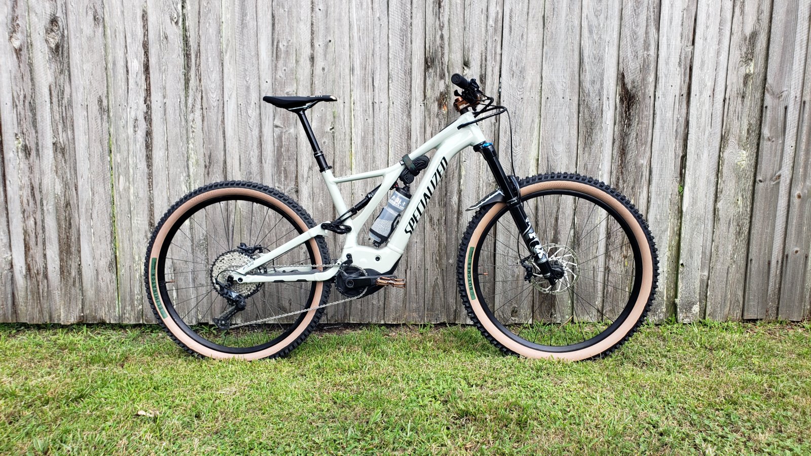

Here's my 21 Turbo Levo, in Clay.
To my eyes, this color changes from off-white toward having a slightly reddish hue depending upon how the light hits it.
Already broke a tooth off the 22T in the cassette after about 100 miles on the bike. Now investigating one of the Kindernay options (7 or 14 speed) to eliminate ongoing costs of buying a whole cassette every time this happens.

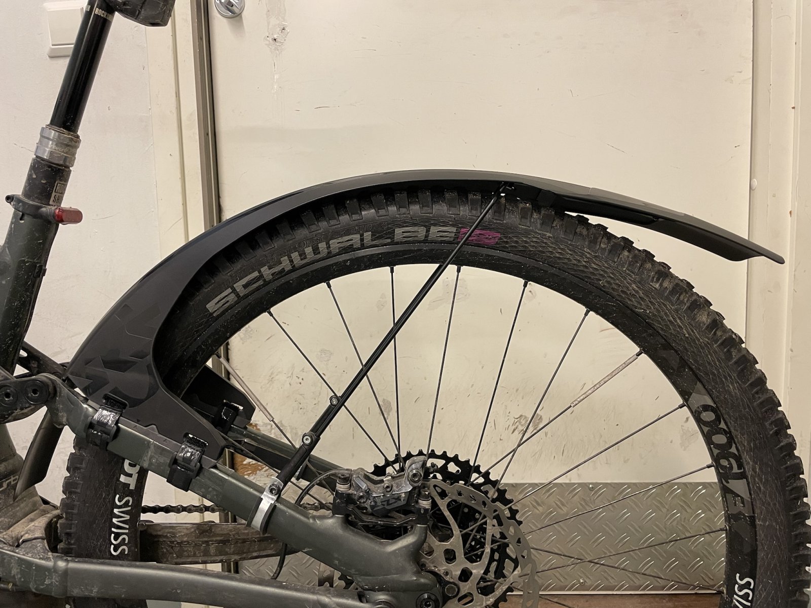

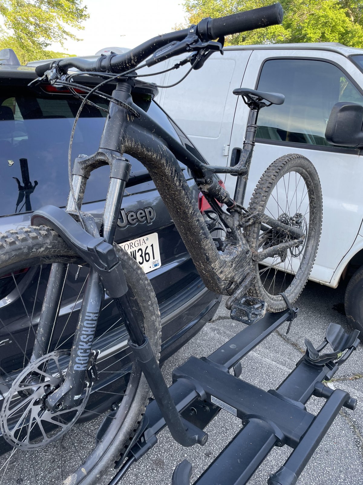

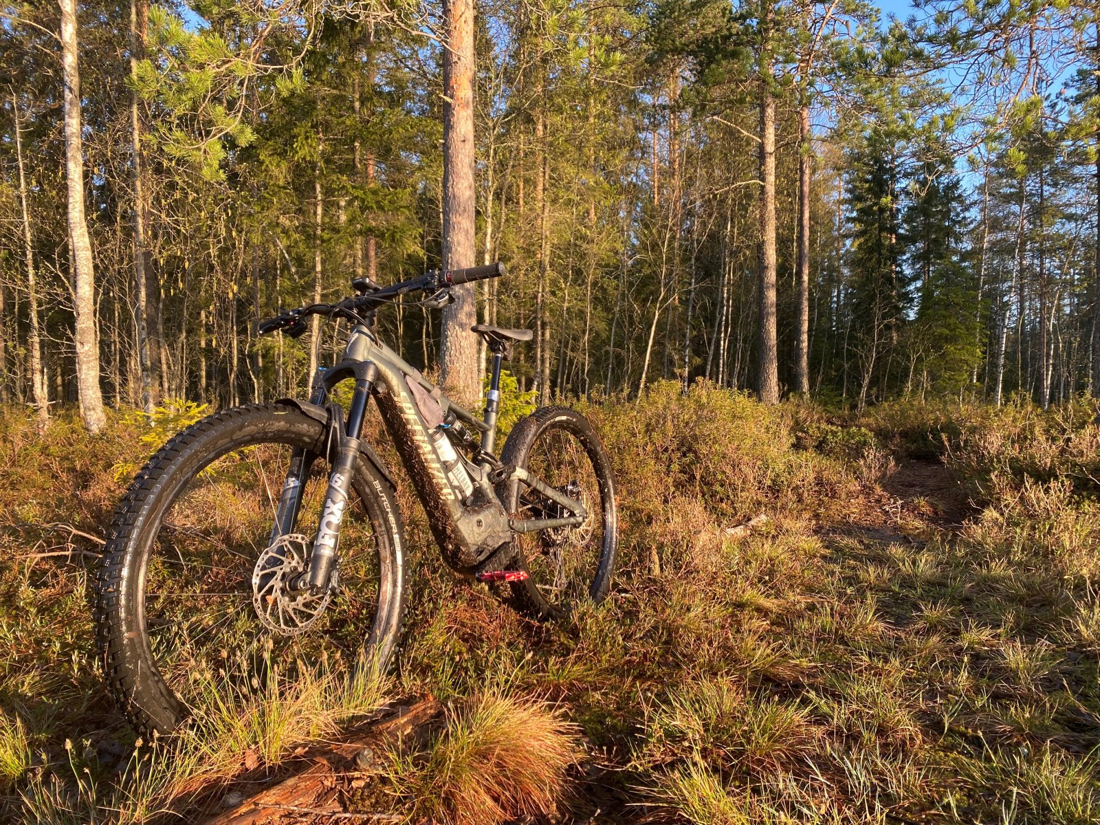

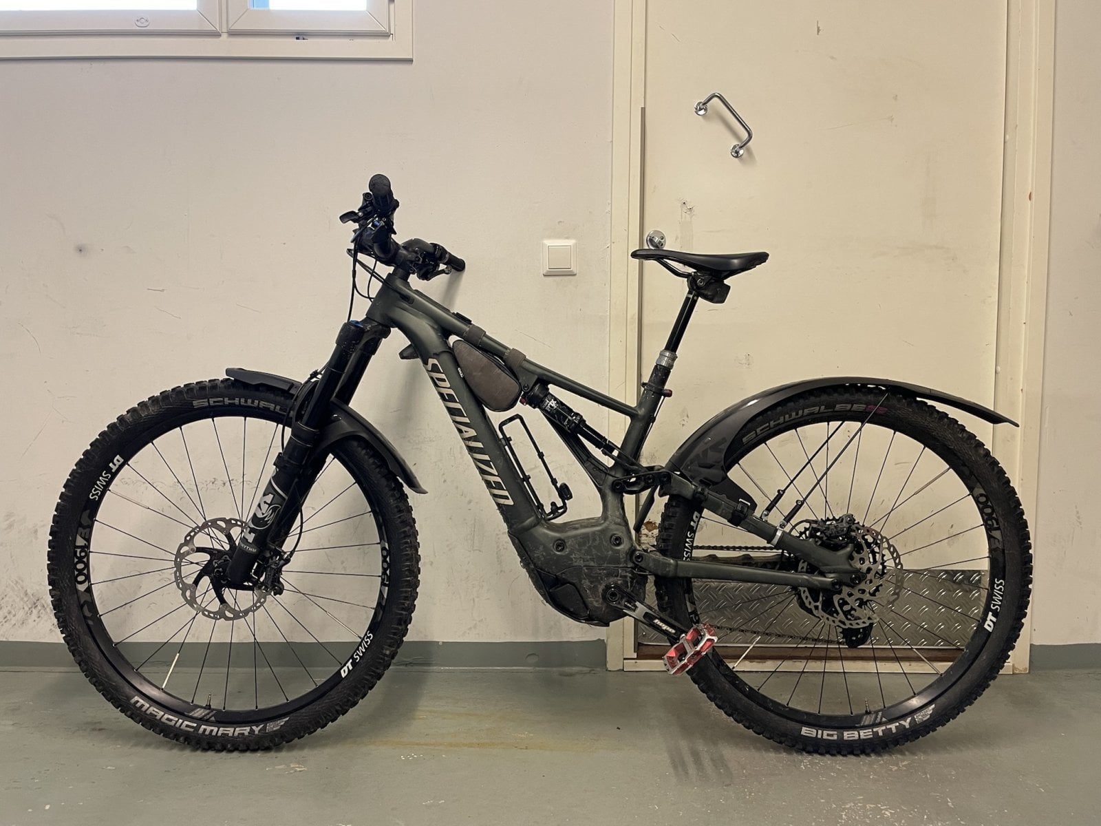

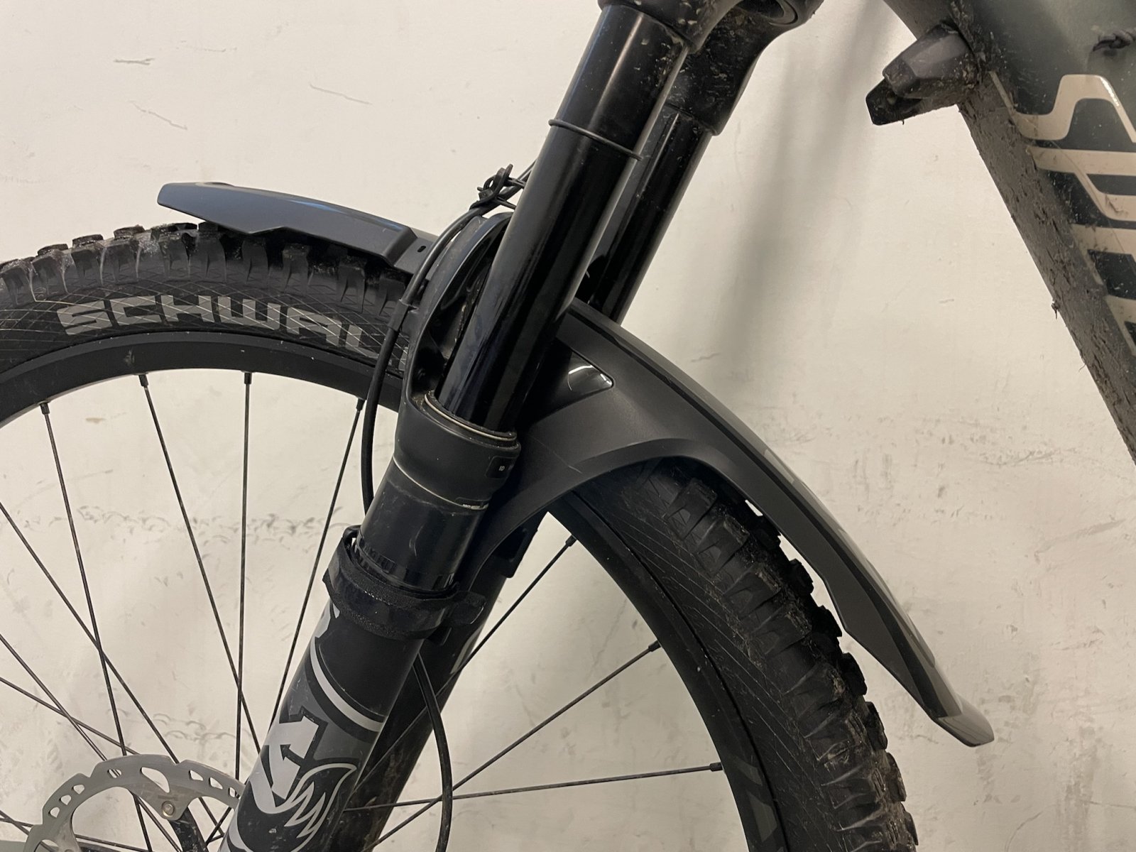

Now when i'm old farth enough i finally did it; mud guards for older dude!
Those short rear "mudguards" were waste of time. Backpack, back and ass was always covered of mud. Or wet anyways.
I finally got it: guards are for the biker, not for a bike. ;)
