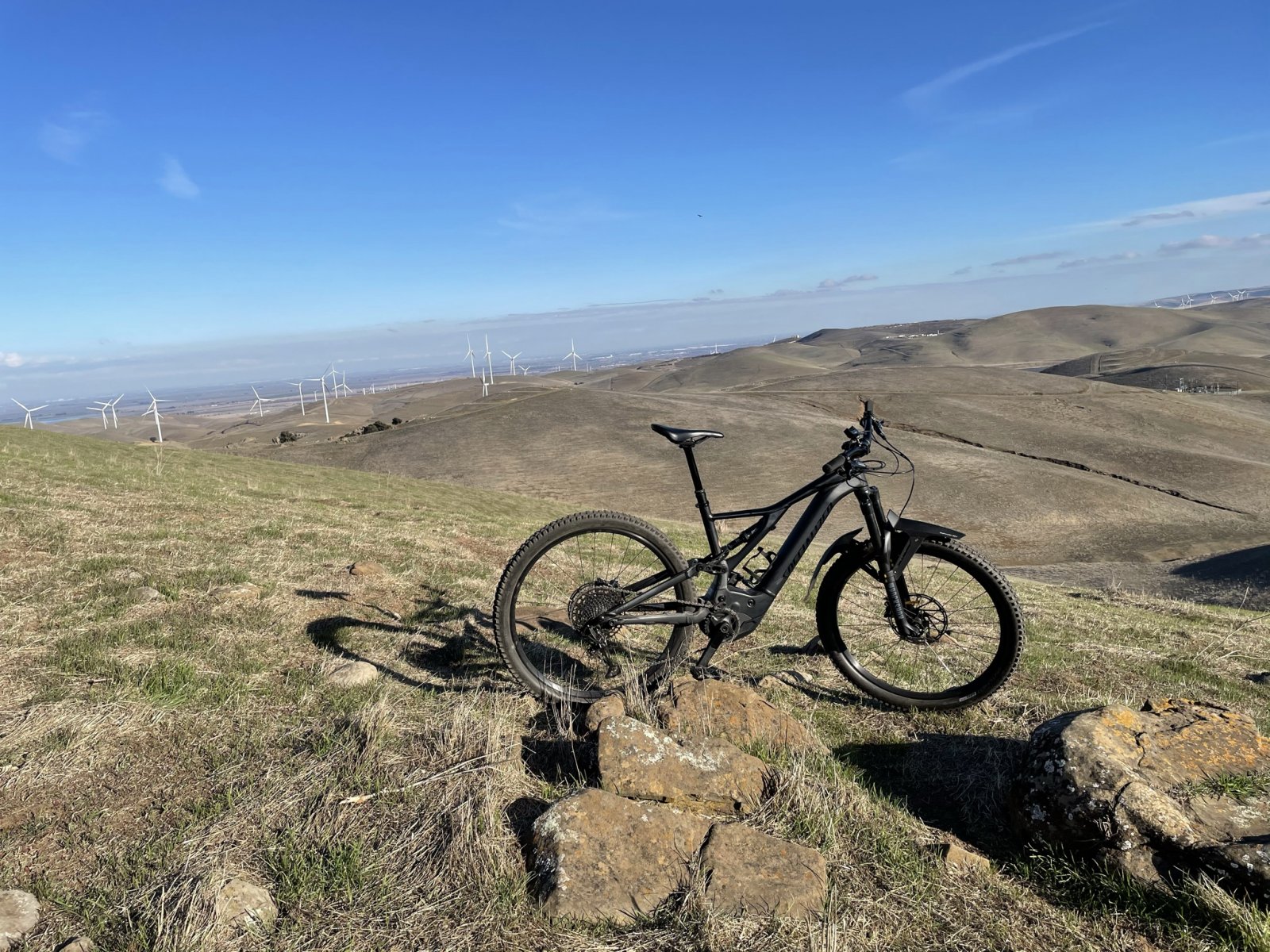

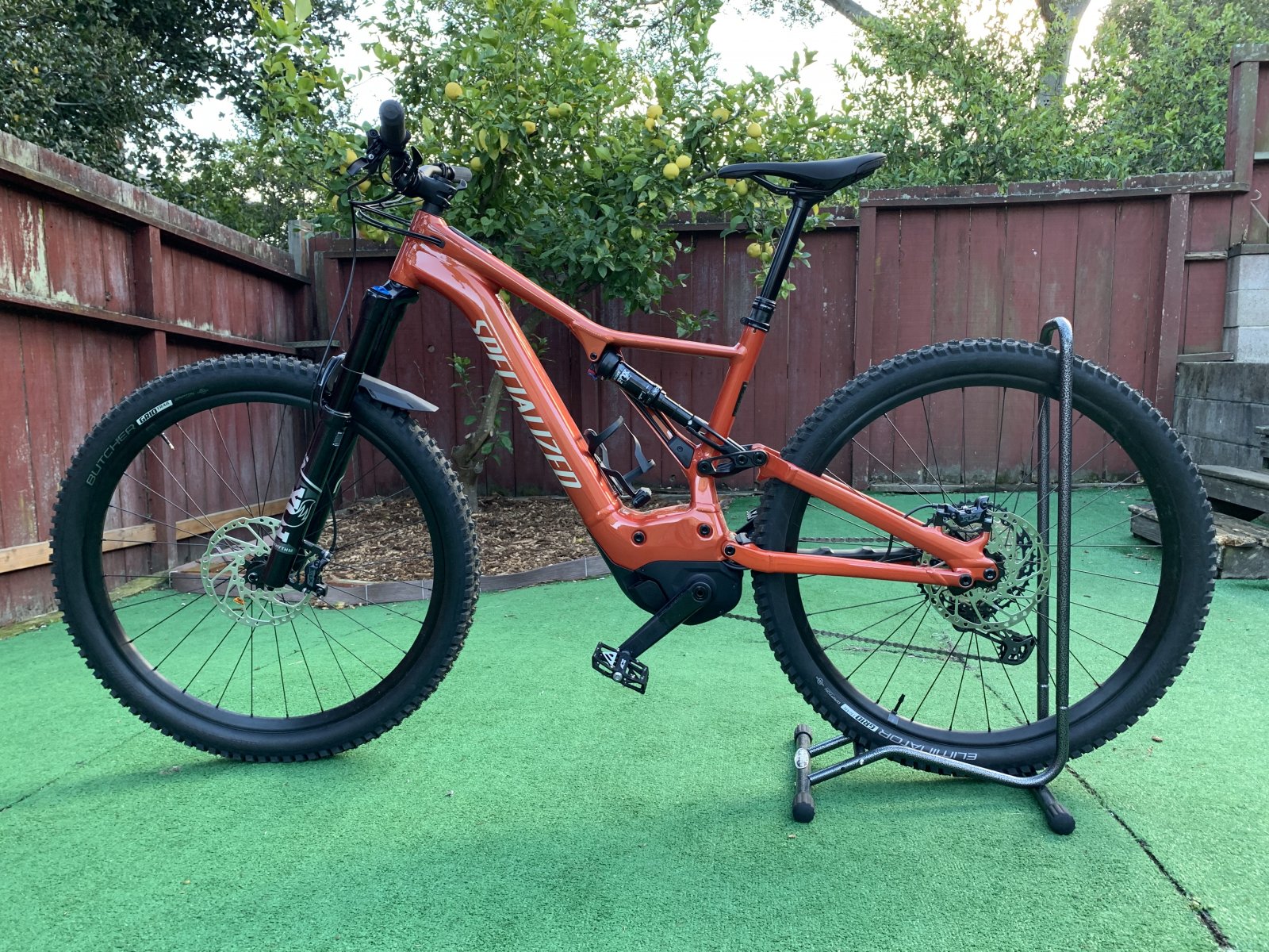

Hello all, I just wanted to say Hi and introduce my new 2021 Specialized Turbo Levo to the group. I have had the bike for a few months and just wanted to say how much I love it. I have put a few hundred miles on it thus far and it has been all smiles. I made some minor adjustments like changing out the pedals, and adding front and rear fenders as well as a 50mm Vibrocore handlebar. It rides like a dream once I took it to a local bike shop and had them add air to adjust the front suspension and rear suspension to handle my weight. It glides down hills like cloud. If you can get your hands on one I highly recommend it.

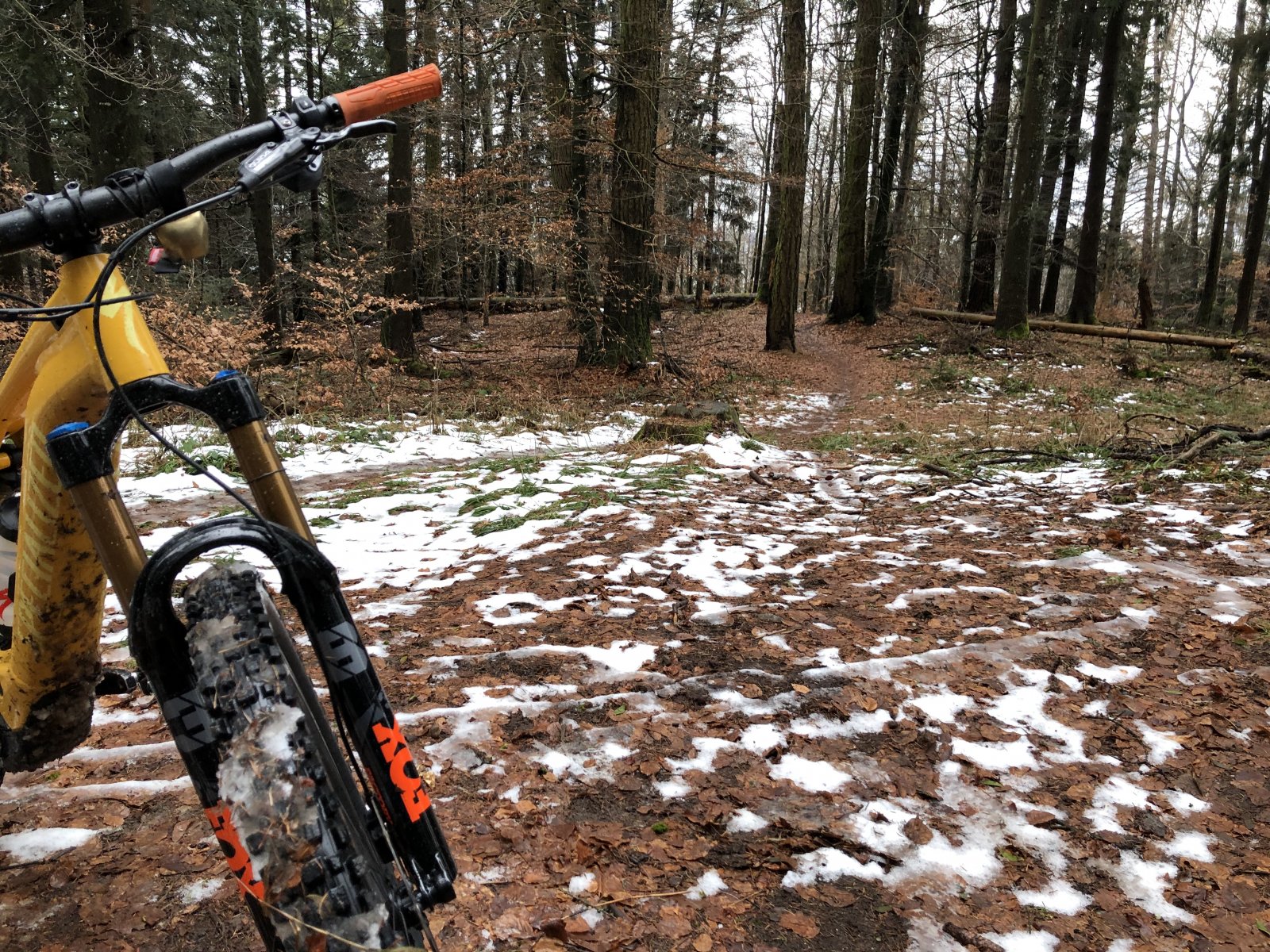

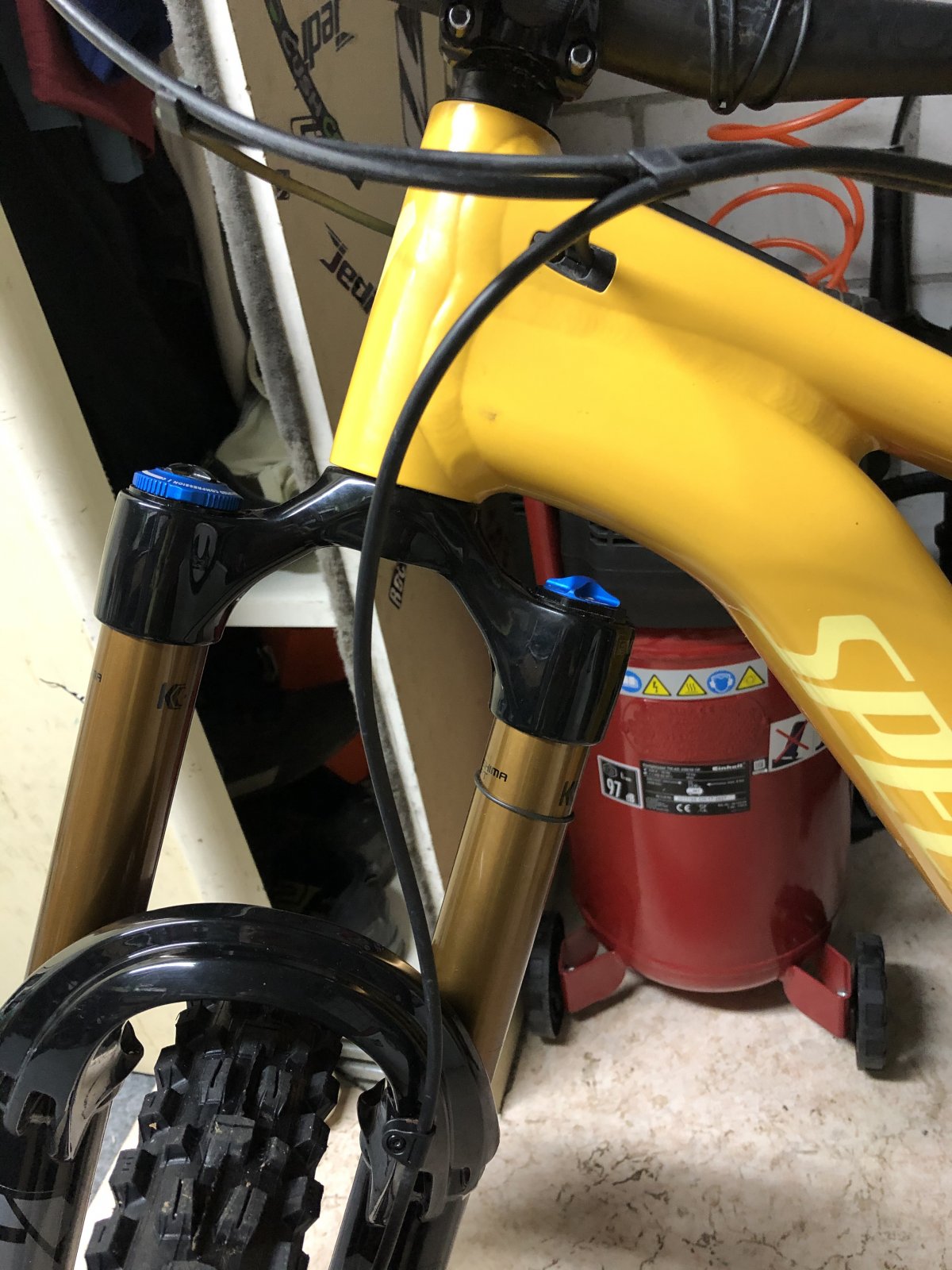

update , fox 38 29“ 160mm 44mm offset, wight 2.4KG.
this baby is badass . exact like the two videos say!!
i never think that the difference from a fox36 160mm and a RS lyrik ultimate 170mm is so much big.
setup: 86kg ready to rumble, 97psi 3 token hsr4 lsr5 hsc5 lsc8

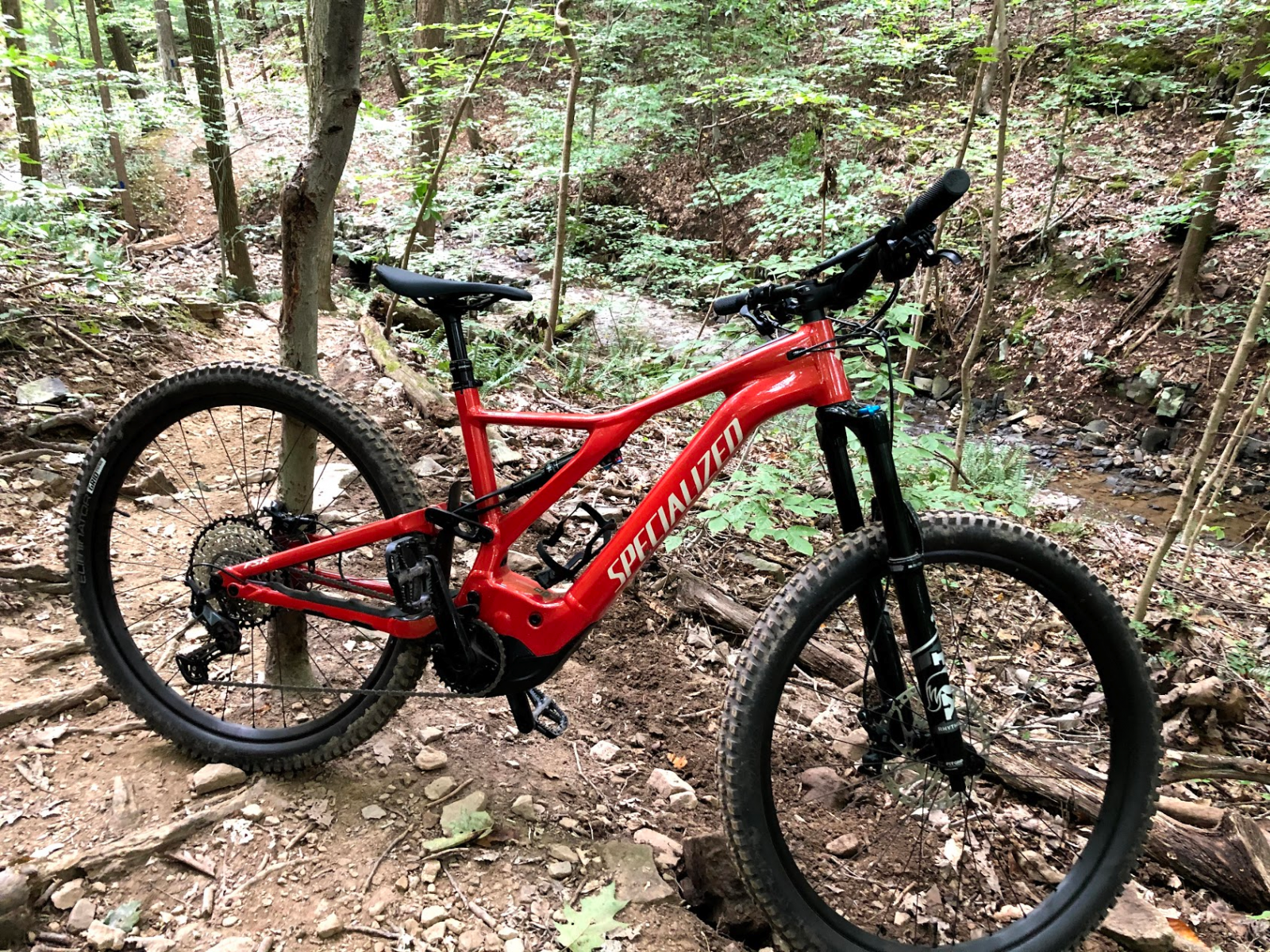

Here is my cobalt blue 2021 Turbo Levo Expert. Does ANYONE else have one? Has anyone else even seen one?? Am I the only one who has one??. Also thanks for all the counsel I got on my levo. I listened and OFF went the stem riser. O am keeping my deity 80 mm bars though. ,??????

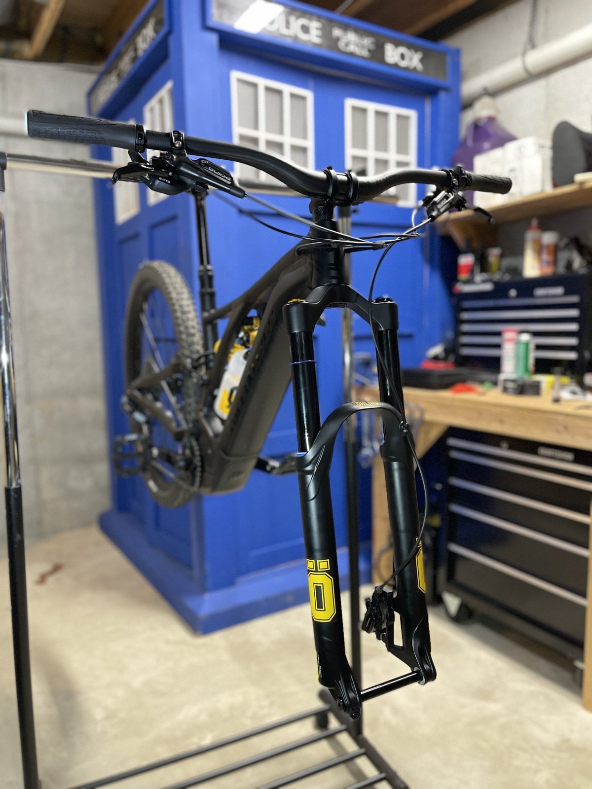

Just installed my new Öhlins m.2 fork... can’t use it yet as my front wheel won’t fit ?
I have the base model which came with the Rockshox 35 fork. On this fork it seems Specialized used the Rockshox specific 31mm torque caps on the hubs which don’t fit. Spoke to Specialized and they helped me out with the new part to adapt my existing front wheel.

There are many seemingly good options for forks, i dont know what ill replace the 36 rhythms with when the time comes. @JhnRX7 what helped You decide to go with the ohlins?
JhnRX7
Sep 14, 2020
19
17
I like the Öhlins multi chamber air spring design. However the other driving decision was based on my experience with their products in the automotive world.
