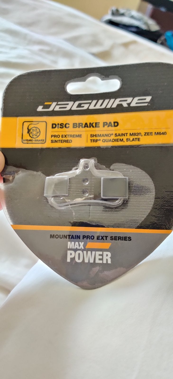

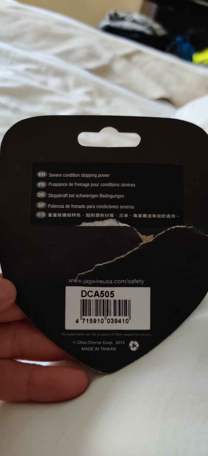

My 21 comp is in the shop for brake howl. Thought I fixed it with sanding pads and cleaning rotors but nope. Comes back immediately as soon as I point downhill. I’m talking 5-6seconds both front and rear now are howling
Got fed up with noise and tried Jagwire MAX POWER brake pads DCA505. No more noise!!!!. Pads are a little bit more progressive too.
Also my rear Shimano hub needed bearing preload adjustment. That took care of vibration when braking

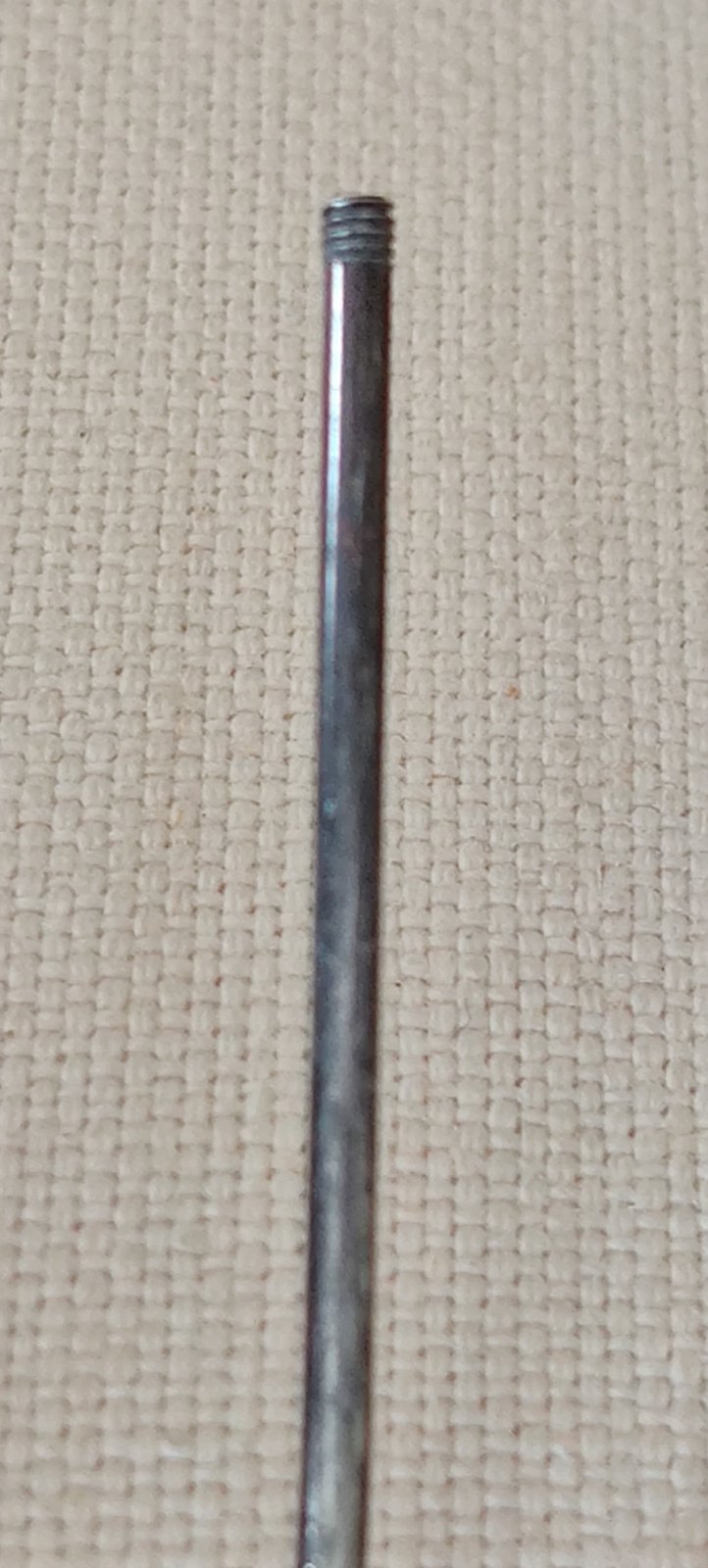

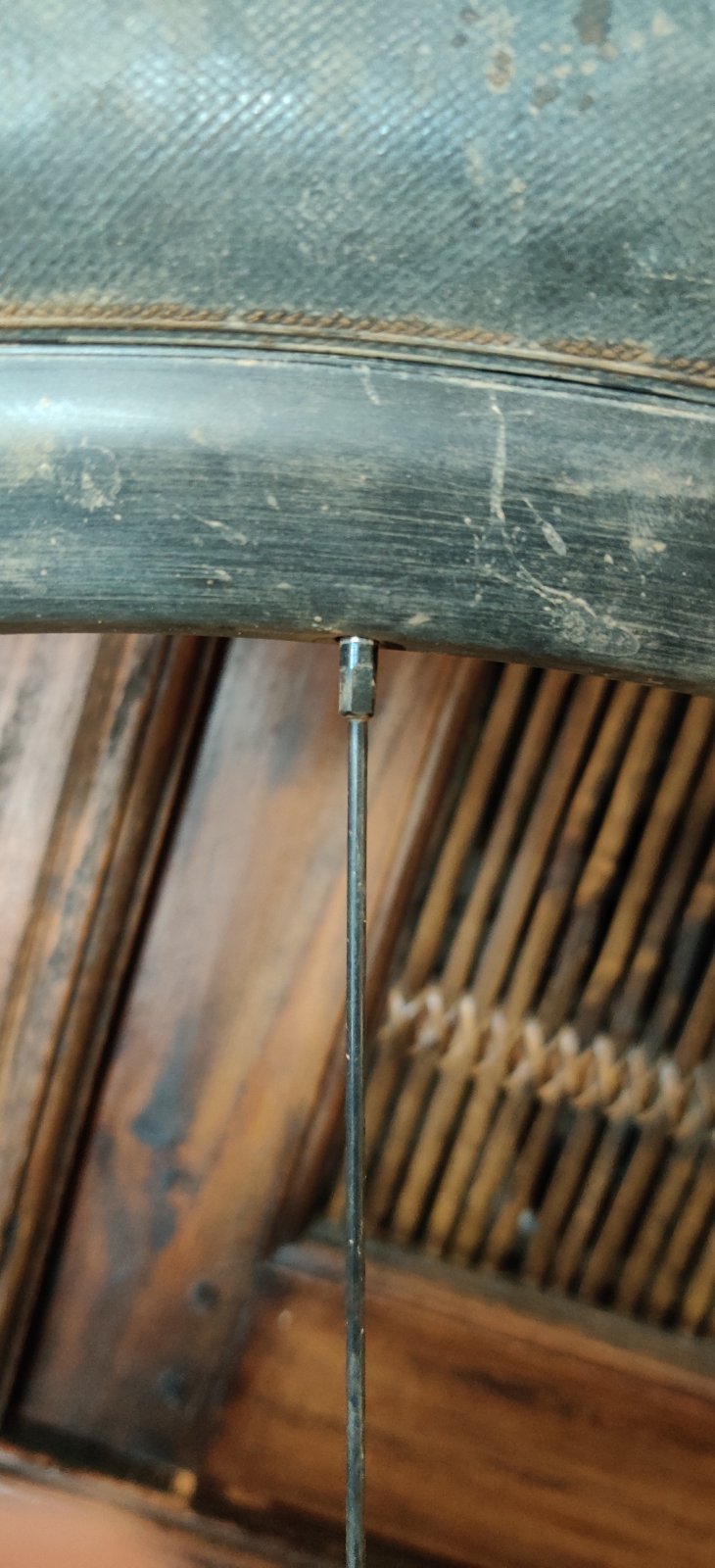

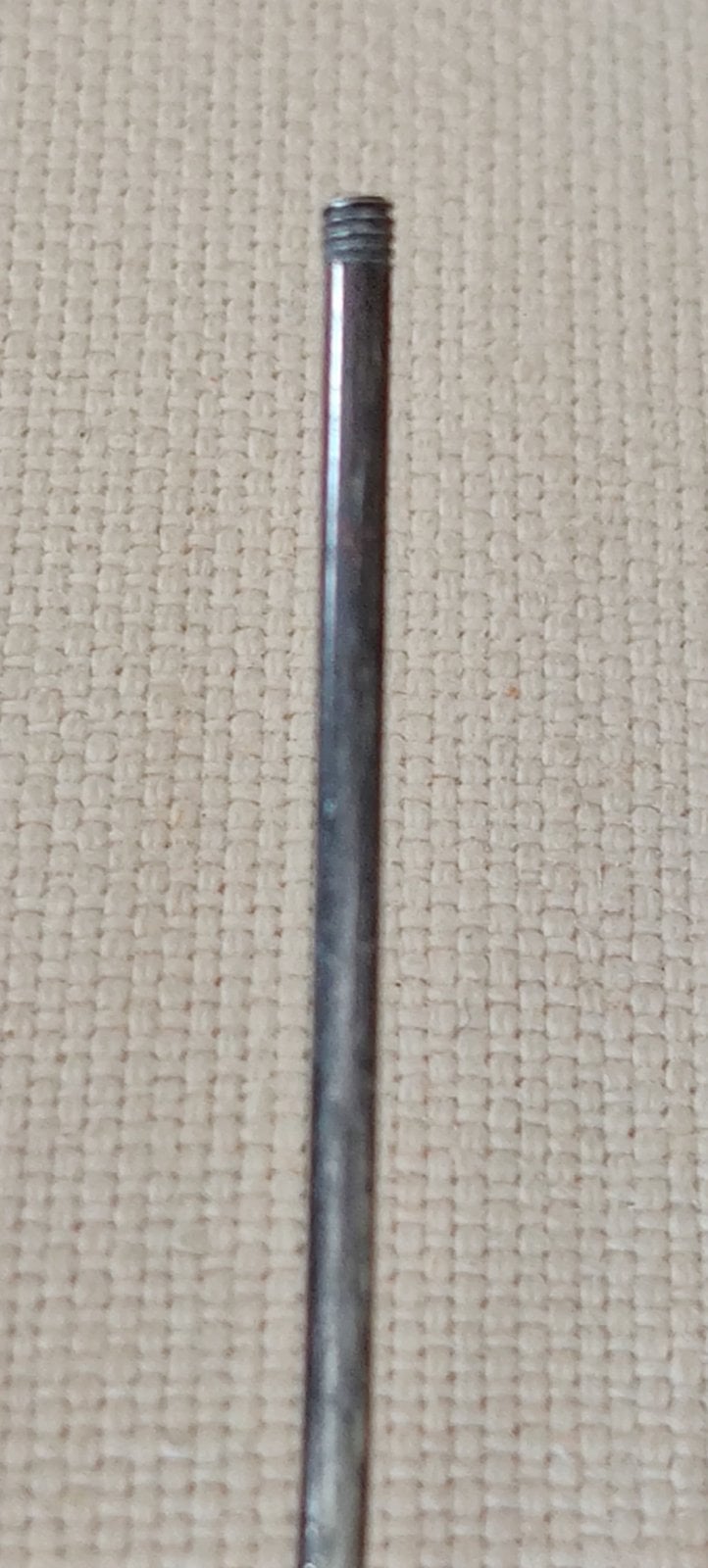

Any one had problems with the Comp wheels. Ive broken 5 spokes so far, 4 in the back and 1 in the front. Thehave all broken in exactly the same spot at the threads. I even heard one pop with me off of the bike.
Ive replaced the 5 with DT Competition, but I know I'm gonna have to replace them all to get it right.
I can see some nipples and spokes are not even aligned properly. Maybe the seat in the rim is not aligned properly and this is the problem as is the cheap nipples.

How is your bike running so far?
Any problems with the motor / control system? Got my new 2021 model 2 weeks ago, they run great.
The motor/battery parts runs great. The bike has great performance too.
Ive had problems with the SLX brake pad noise, the nuts and other hardware on the bike are cheap (broken nut on the chain guide, lost both screws that hold the brake hose) and so are the spokes with 5 broken so far.
I had six broken spokes on my rear wheel in the first month or so. Specialized swapped out my wheels for a new set (different brand/model). No broken spokes since then.
I’m also getting some brake squeal and might give these a try. Are “sintered” pads the same as metallic, or are they different? Are you still getting good results with these?

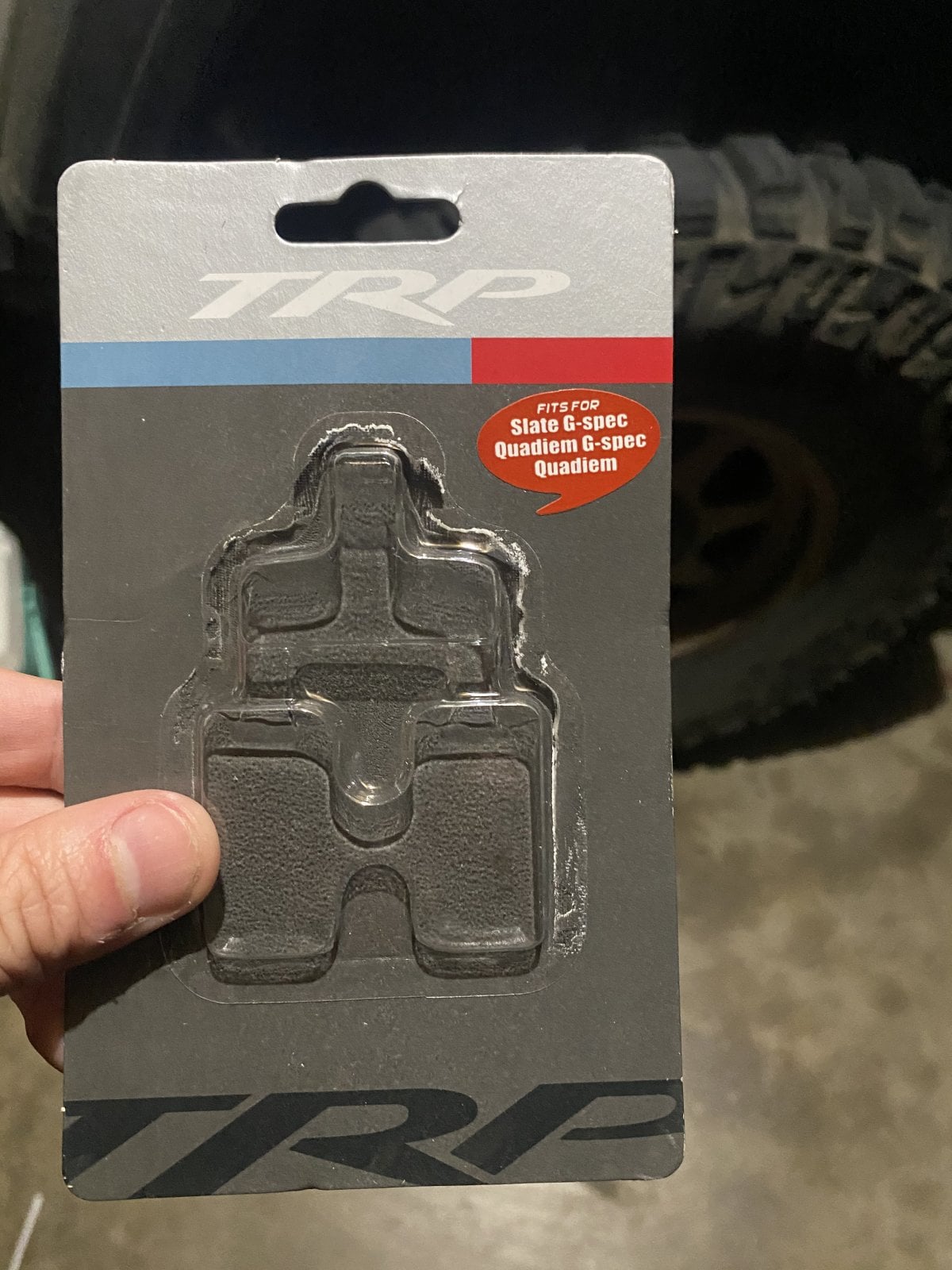

Greeting everyone, first post here on the forum. I Picked up a turbo levo comp November 1st (a birthday gift to myself) and have been having a blast! Its mostly stock, but i did convert it to tubliss.I've been riding solo mostly in the dark on single track, i have a 4200L gemini bike light and a oxbow voyager helmet light, so ive got plenty of light. Im happy with most everything so far. My one issue is the brake howl...This seems to be a common topic. Im interested in changing pads, would anybody share a link to pads they have been happy with, or can recommend?
I have Magura MT7's on my YT Decoy Elite and run MTX pads (gold in the front/red in the rear). No brake squeal and the work awesome! Front has insane stopping power and awesome modulation on the rear.
