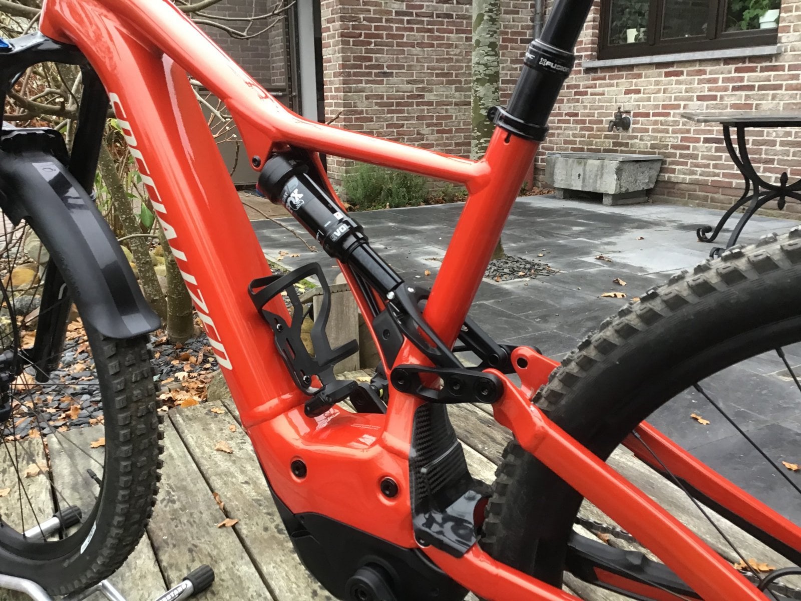

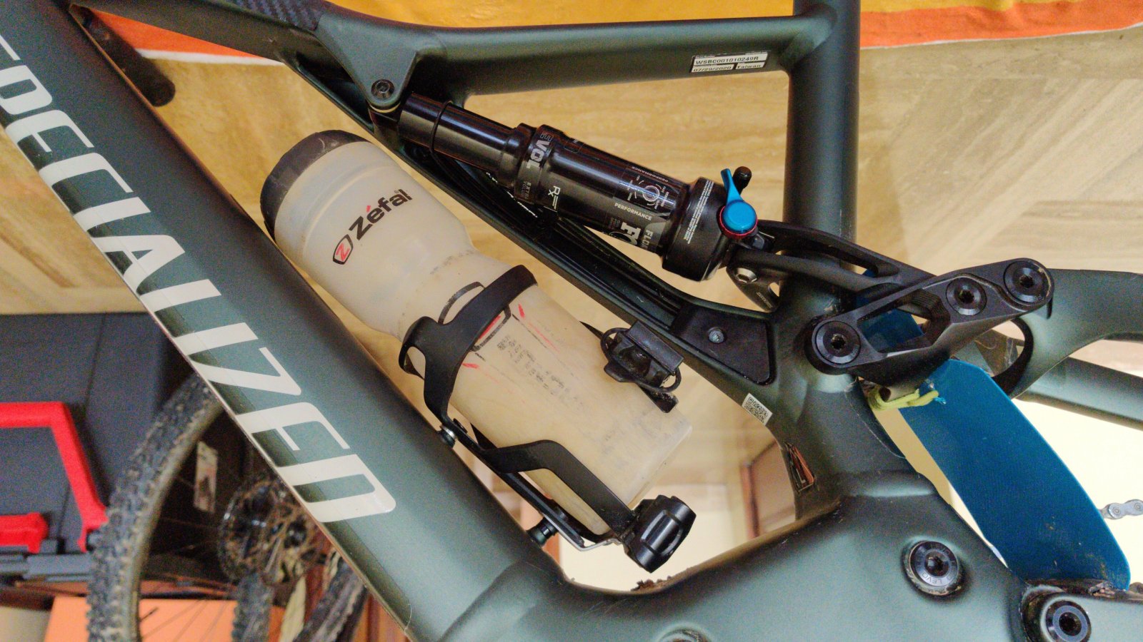

Hi all. I moved the flip chip to the high position just because of too many crank strikes.
I also flipped the shock around so that an extra large 1 liter water bottle now fits properly. This extra space could also work for those adding an extended battery

There are some kits out there from Levo-range-extender.com or trailwatts.com that could work. At least on the aluminum large with the shock upside down seems like both the small 250wh and the large 378wh bottle battery might fit.
Oh wow I had no idea these existed. Thanks!
Mine is a Large Aluminum Levo
Interesting idea to flip the shock. (y) I might try that when I rotate the flip chip after moving from 150 to 160 mm Debonair.

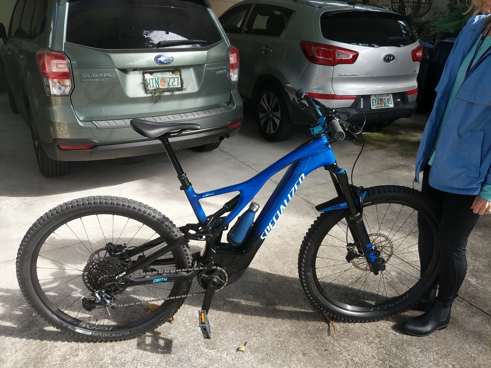

Here is my cobalt blue 2021 Turbo Levo Expert. Does ANYONE else have one? Has anyone else even seen one?? Am I the only one who has one??. Also thanks for all the counsel I got on my levo. I listened and OFF went the stem riser. O am keeping my deity 80 mm bars though. ,??????
