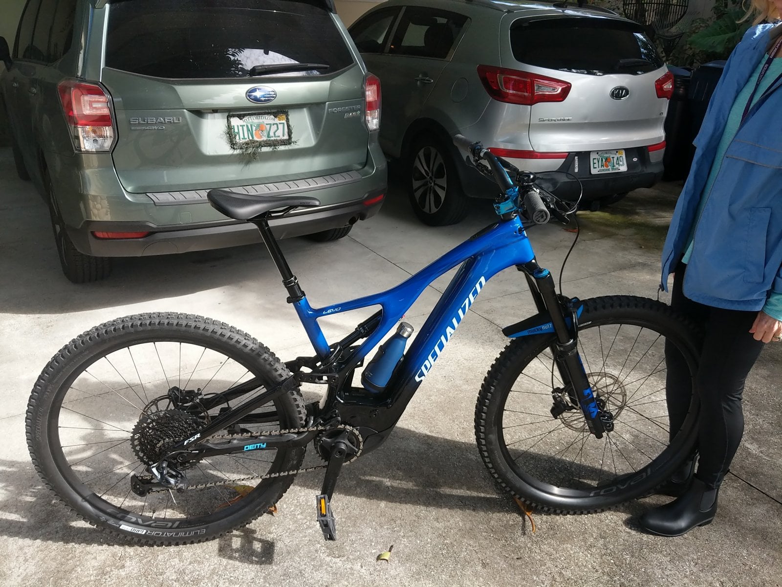

Is that not a base model?
Here is my 2021 expert in cobalt blue. Anyone ever seen one. I've not . Maybe I'm the only guy who scored one??

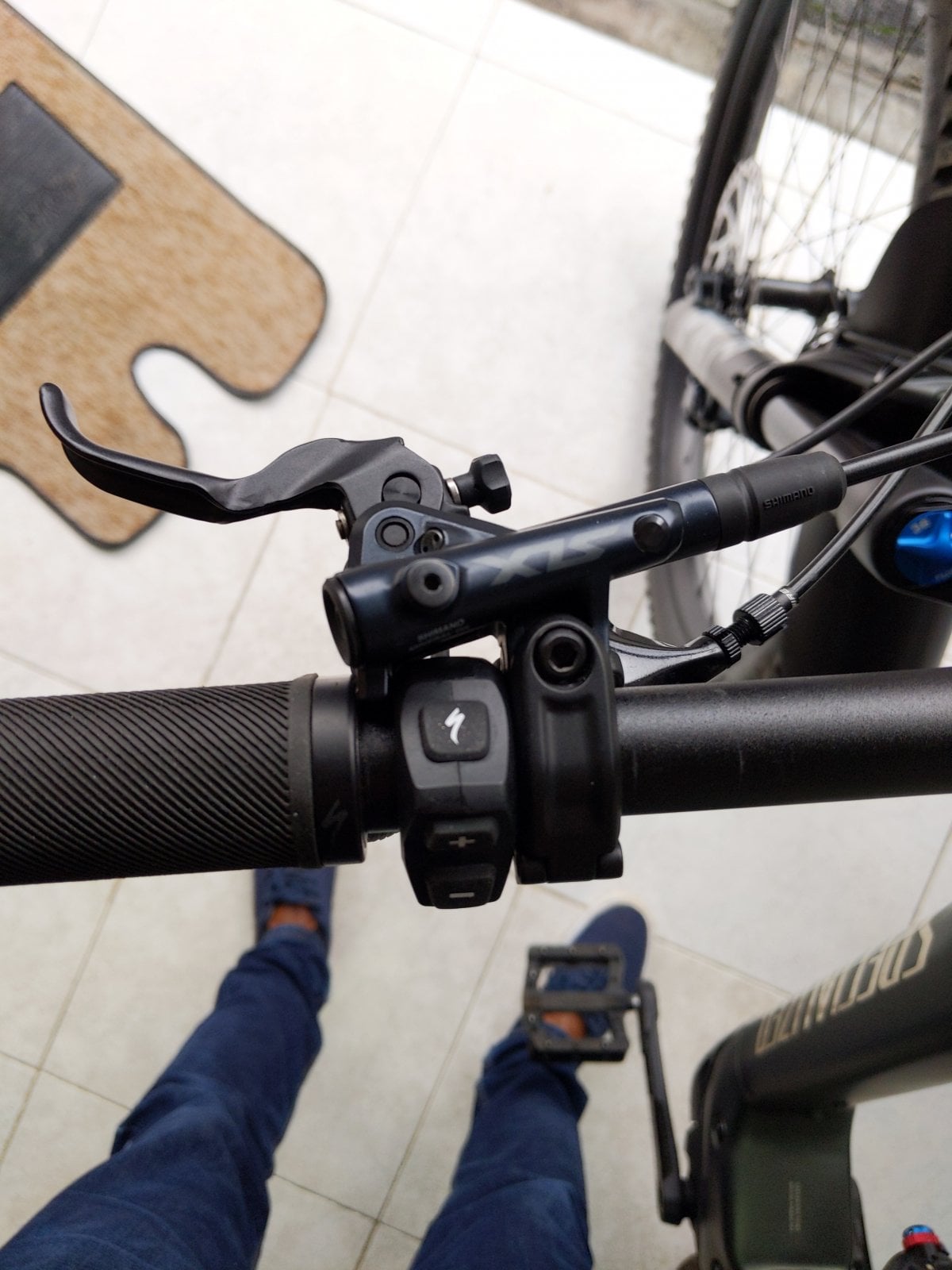

2) did u know you can fit the control switch INSIDE the SLX Brakes? I too felt the levers were too far away and figured it out.
Dude! No, I didn't, but thanks a lot for the tip! Feel stupid not seeing before that there's a second smaller screw you can loosen to move the dropper remote so there is enough space. Best tip i have gotten all year, thanks!

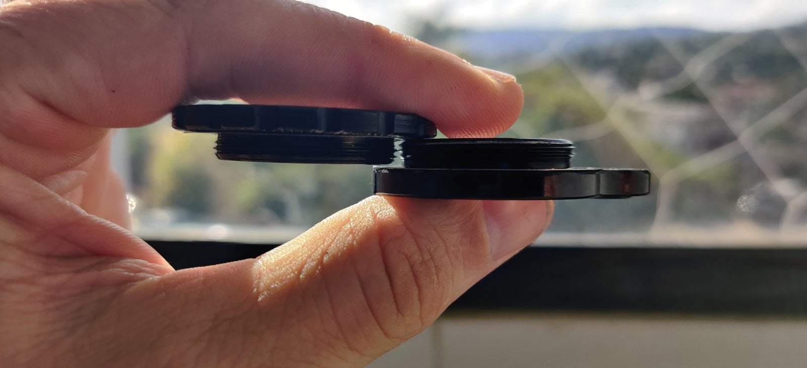

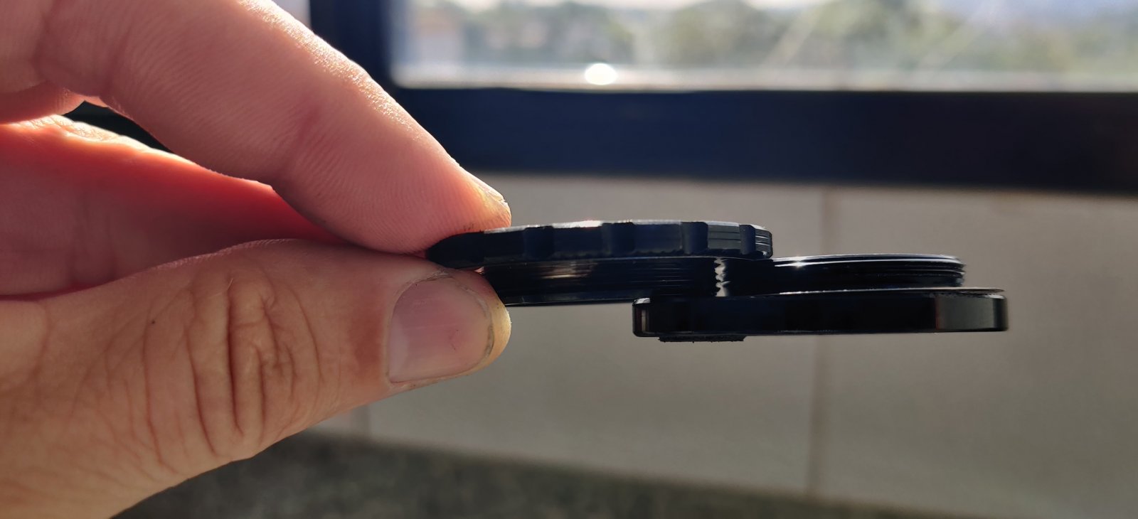

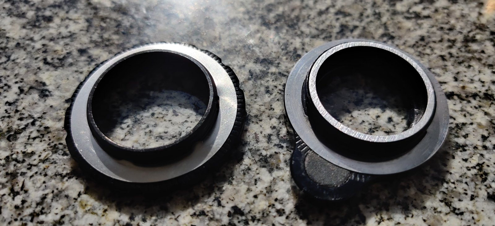

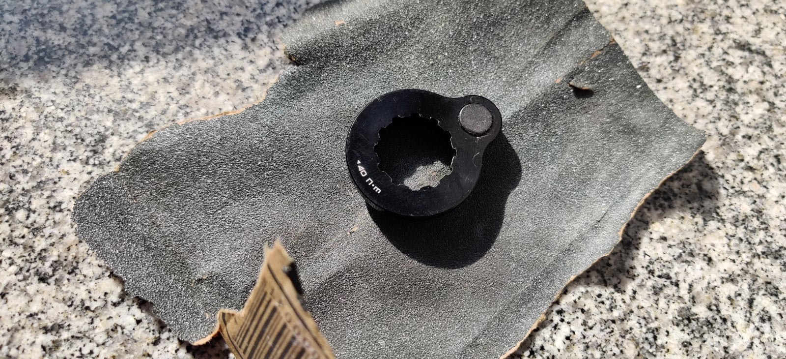

My Specialized centerlock magnet nut was bottoming out on the Shimano Hub so it wouldn't tighten the disc properly. Seems like there are more threads than the standard Shimano Nut on the Specialized Magent Nut. I just sanded it down against a flat surface with sanding paper.
My rear brake still howls but at least the vibration is down 90%, but I still think there is another problem with the nut (see bellow)
If you look at this picture you can see the magnet actually protrudes the flat surface where the Nut tightens the disk. I wonder if this uneven tightening of the disc is what's causing the vibration or noise. You can even see the marks from the disk on it and on the flange
Im gonna try Dremel it down to see if it helps.

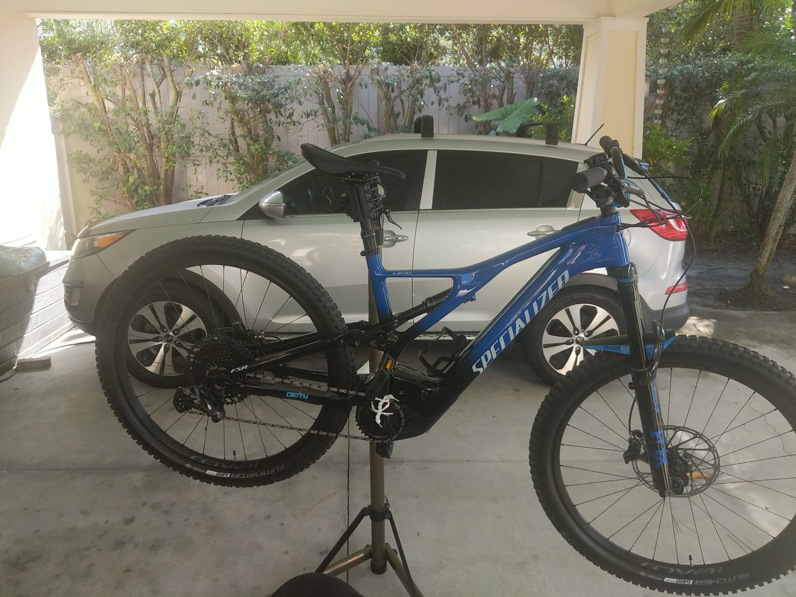

Just got my bike back Did the custom bike wrap at my local bike shop didn't even know it existed I wish I had done it when I first got the bike looks great I highly recommend it
