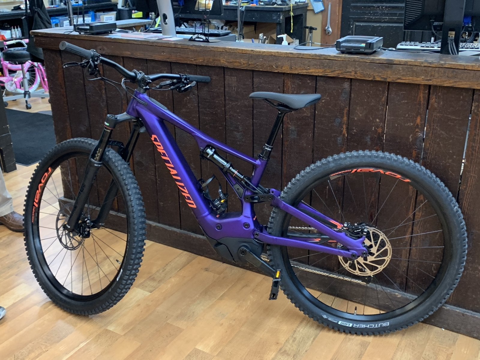

Picking this up tomorrow, will report my take on noise but being my first EMTB I will only have the single experience as a point of reference. Super Excited!!

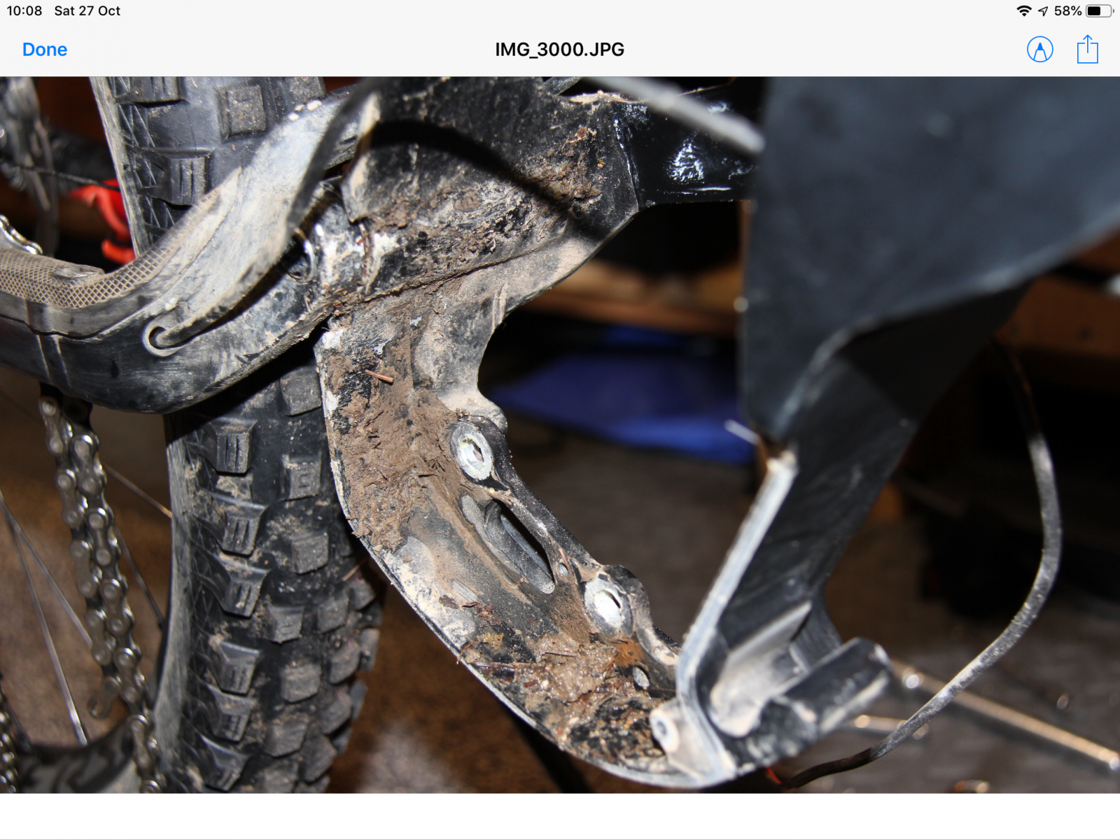

Flipped mine over to check and there looks like a load of shit in there already after a ride. It's not looking good for a UK winter ahead

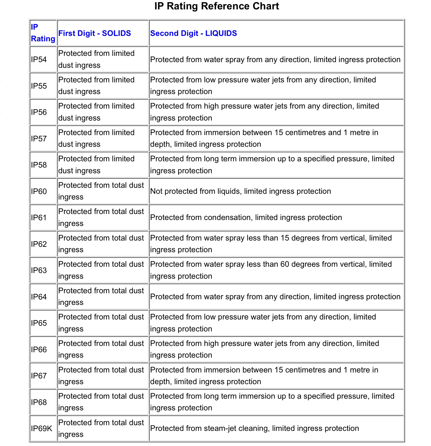

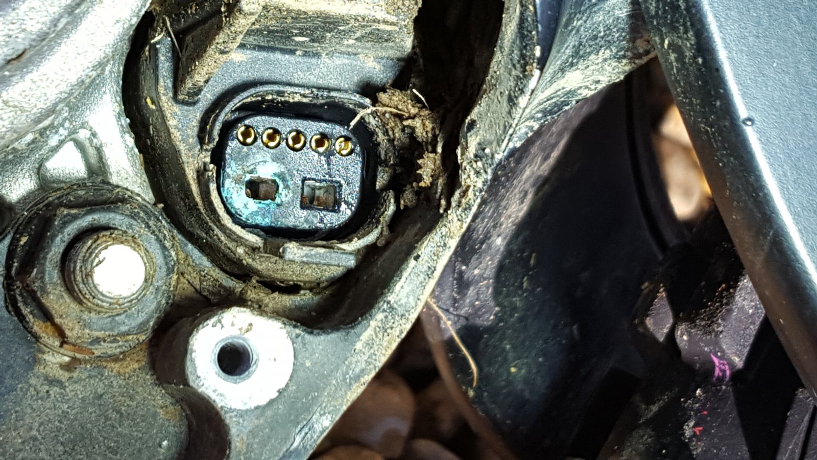

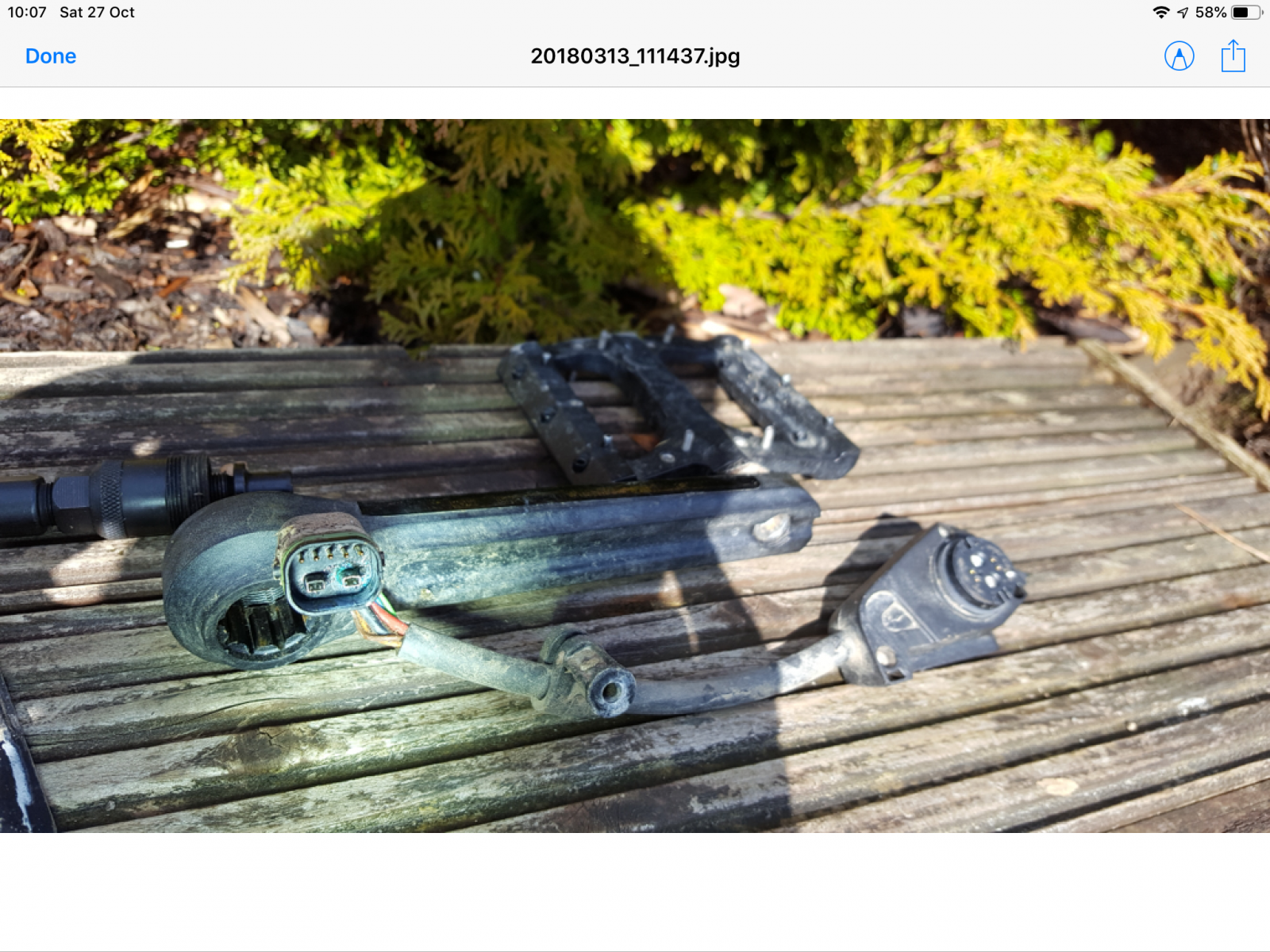

Please be aware 2019 owners, the motor may be sealed but the IP rating is not very high (IP57) so water will eventually get in (like it did with my 2017) if exposed to water/damp over a period of time (3 months for my 2017). I kid you not, this is a serious issue and it would be good to get some feedback on this new problem from @Specialized Rider Care.

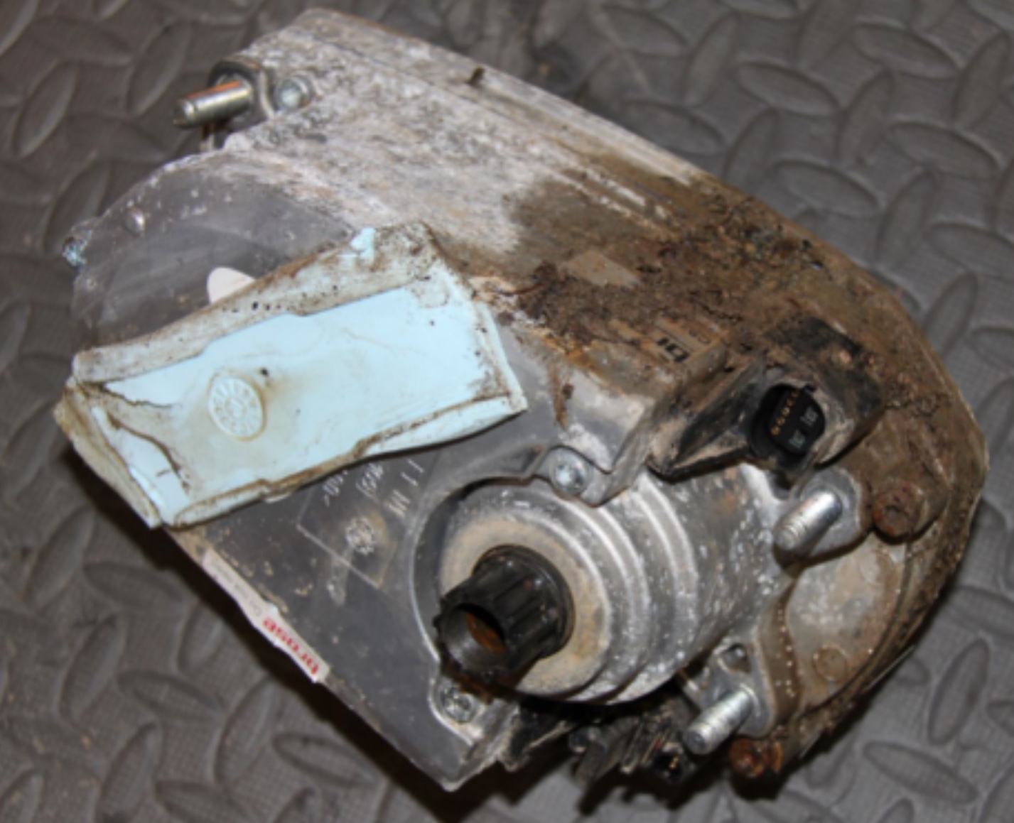

The picture below is my previous dead motor. The water got in via the plug socket attached to the motor.

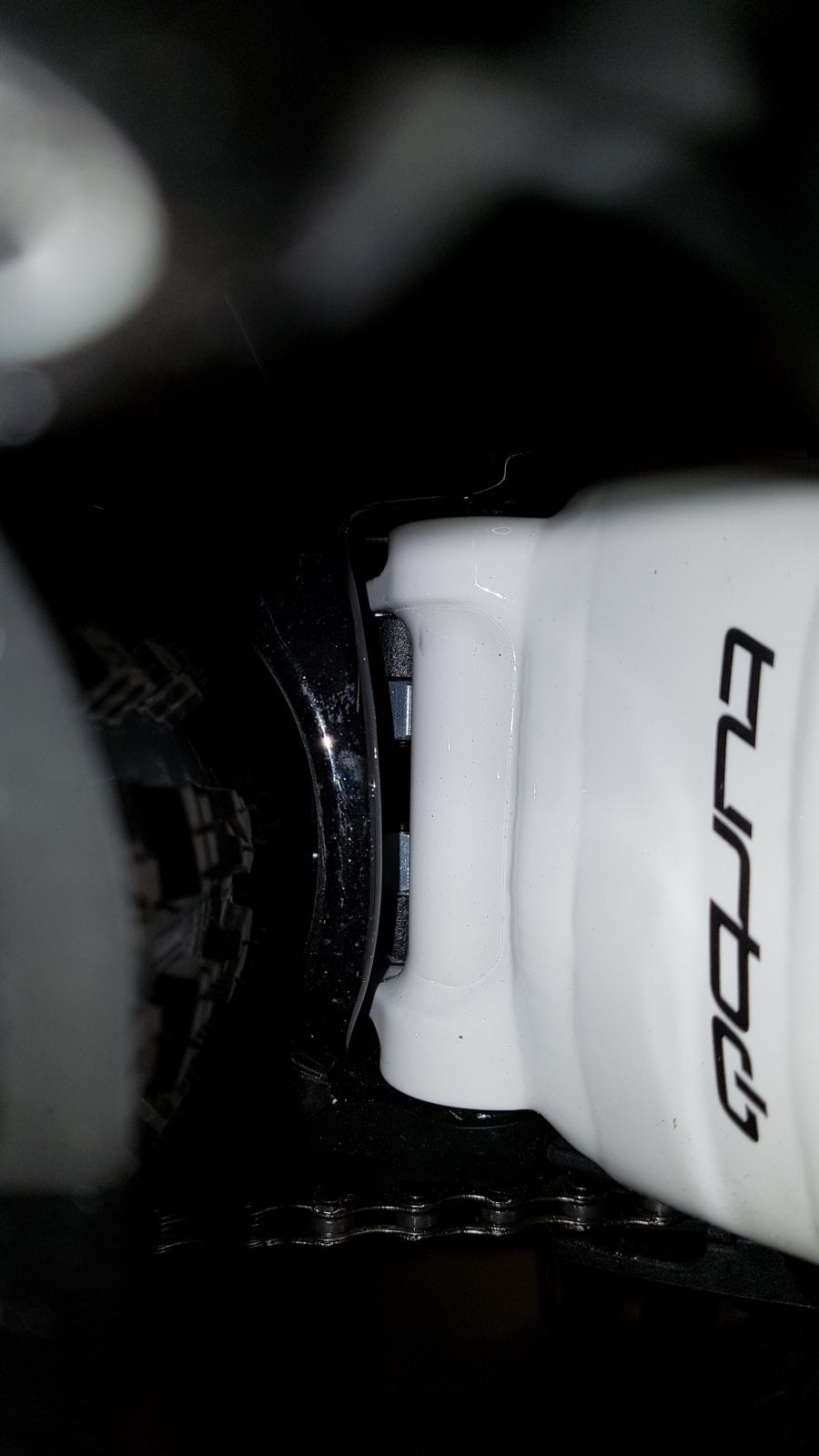

This is the photo of the hole. A small sponge can fix things to prevent dirt from entering the engine compartment. Waiting for Specialized to do its duty ...

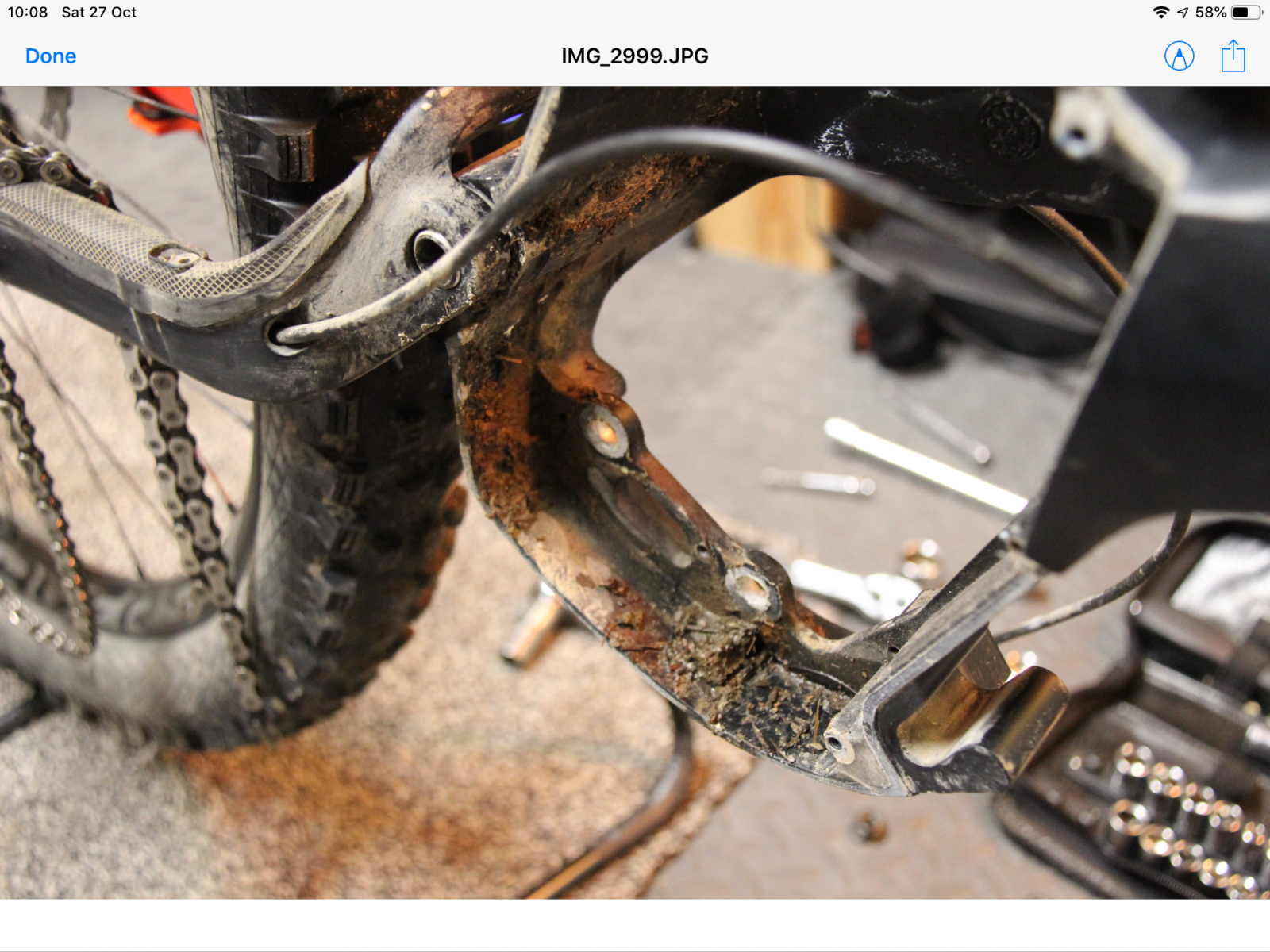

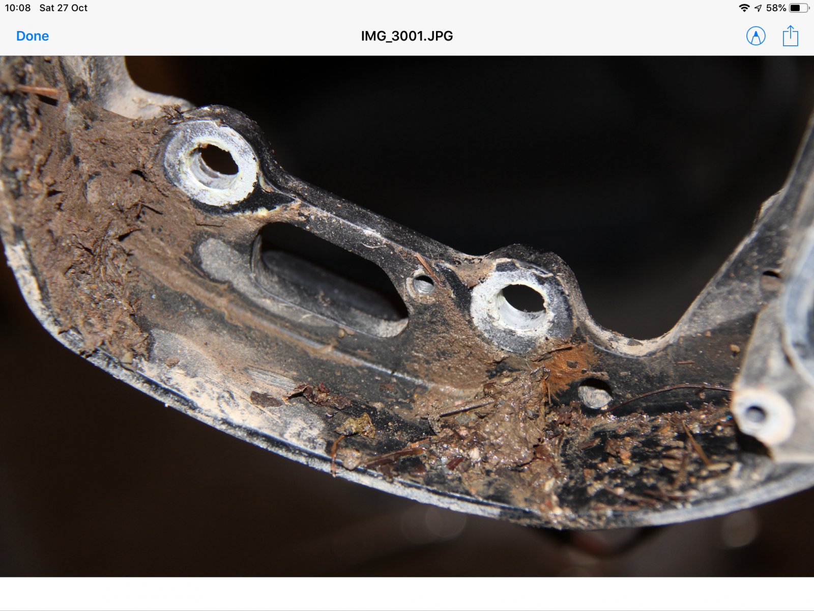

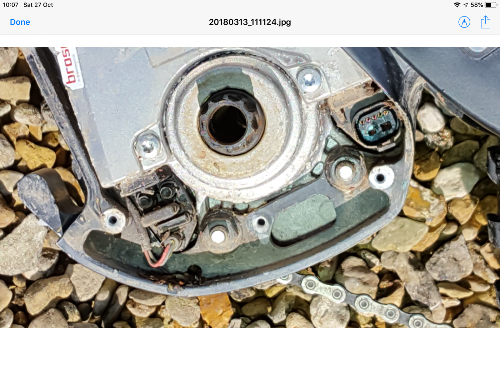

Thanks for the photo, how big is the hole roughly? It must be fairly big if an object like an entire leaf can make its way into the engine compartment area :eek:

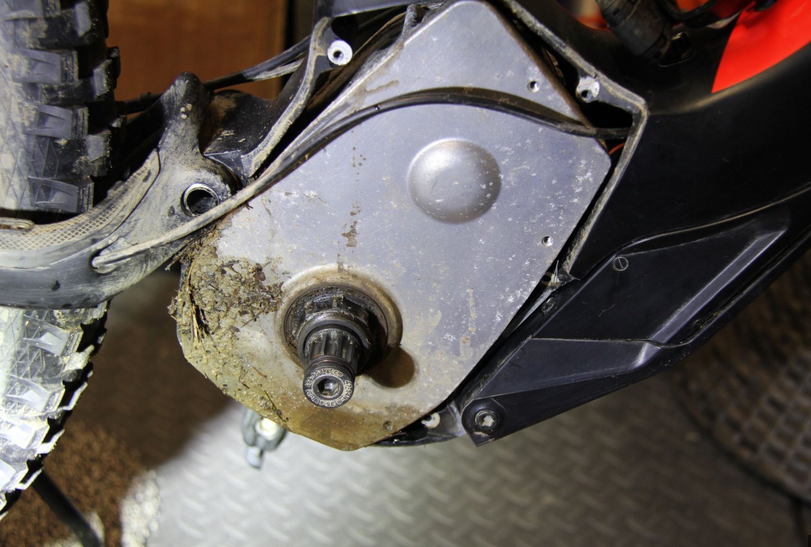

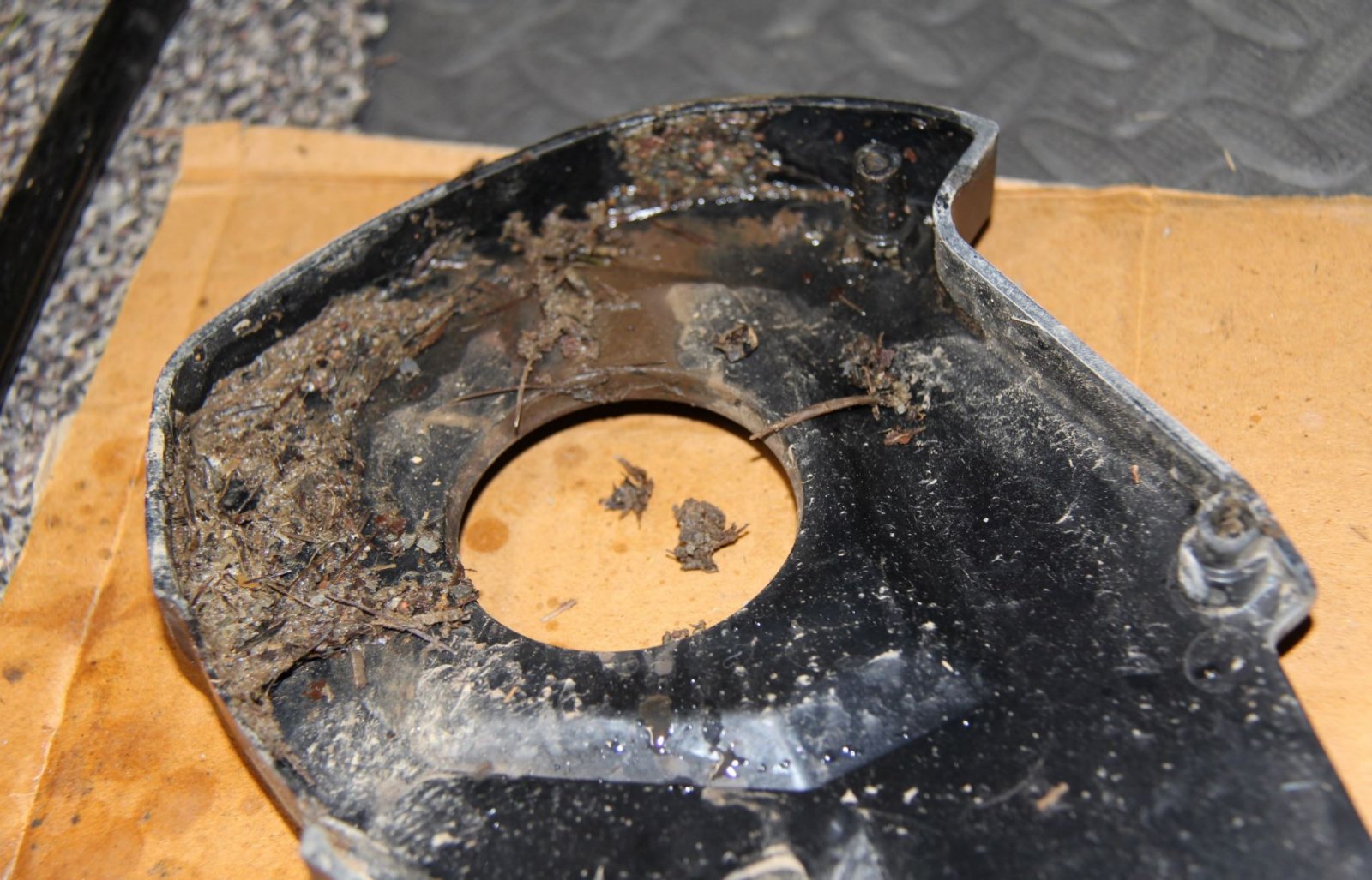

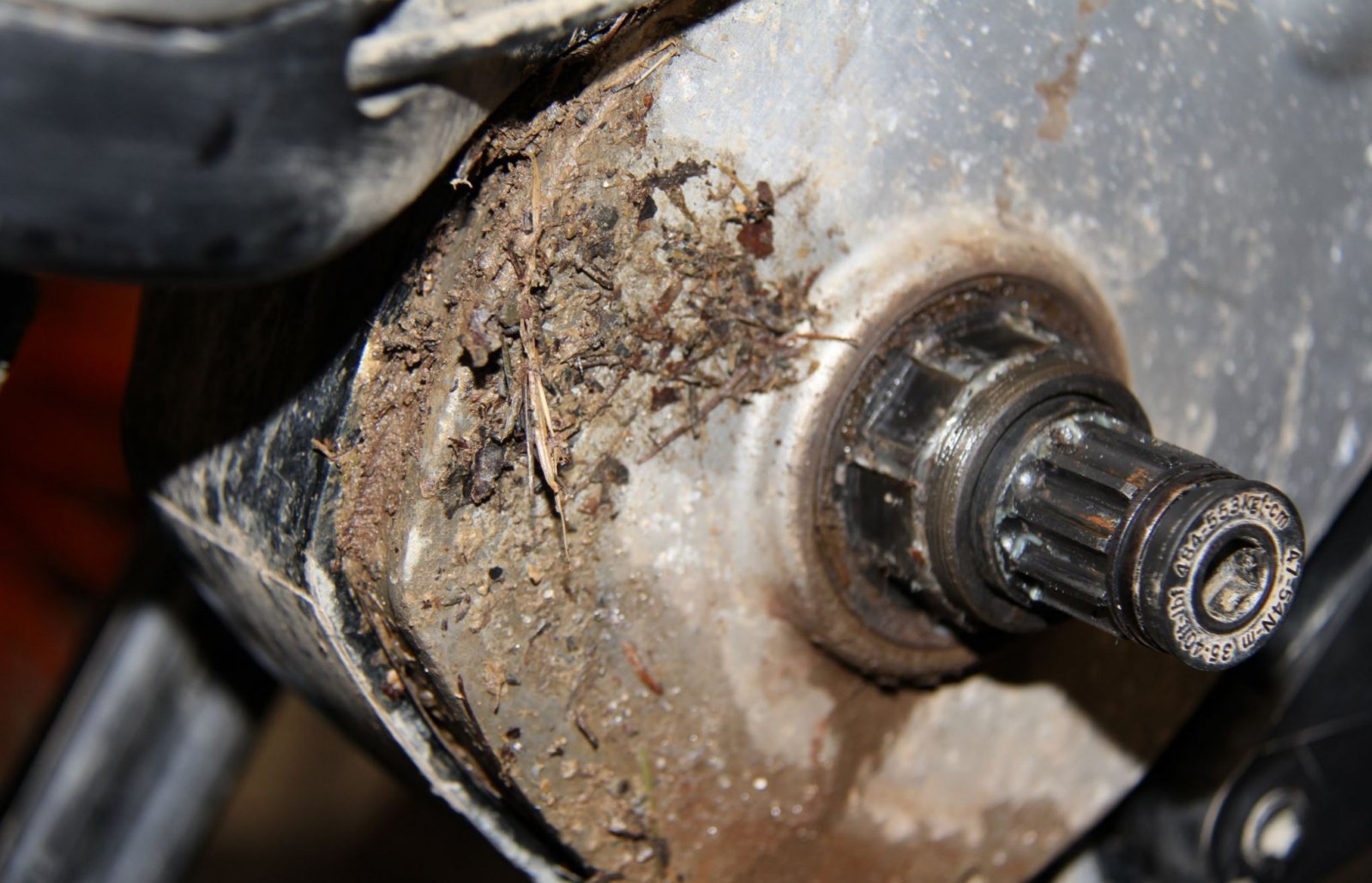

The hole in my 2017 model is in a similar position but to the side and is only about 2cm x 2cm. You can see in the photos below what got in after just a few weeks of winter riding in my local forest. I believe the hole in the 2019 is much bigger so as you can image, I am really worried about this situation.
My current winter/wet riding maintenance procedure (with the fix of mx foam inserted) is that I still have to to pull the motor covers off every 2-3 rides/once a week and check what has got in and remove anything that has got in. I figured that the ‘new 2019 design’ would have taken water, mud, etc ingress into account and the new design would remove any holes....Clearly it has not..... which is why I am really disappointed because I thought the new model would require NO or very little water, mud, pine needles, leaves ‘removal maintenance’ :(
Without some sort of fix, owners of the 2019 models are in for much more than what you can see below in the wetter parts of the UK and globally due to I believe, a much bigger hole in the 2019 models....
PLEASE NOTE:
The photos below are all before I put the mx foam in place. The only thing that gets in now is ‘thinned out’ muddy water that mostly drains out through the sump hole ?

Looking at this picture. I don't think that this hole will do any good for the cooling of the motor.
https://www.emtbforums.com/attachments/1a5a7ec8-6a0c-45e4-a9dd-7deb3ea522d1-jpeg.6793/
Motor have enough around and side contact point for passive cooling. Don't see that that 5x0.5 cm gap is that crucial for cooling. We might just use the tape and cover the damn thing.
From computer case experience you would need some kinda want to push hot air out of this gap.
In my opinion this gap doesn't do s...hit regarding cooling the motor, might just seal it up completely.
If they got it wrong regarding debris entering the compartment, they probably get it wrong if they meant that this will help hot air escaping the compartment.

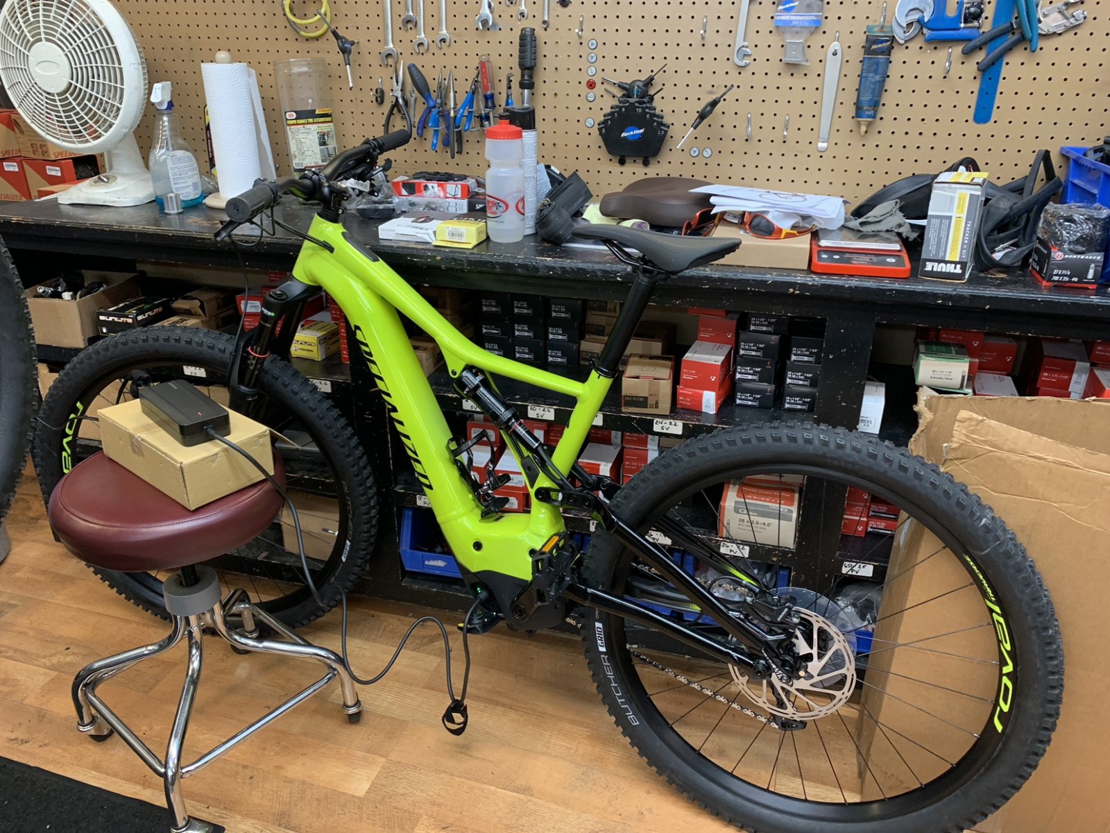

Today I received my new 2019 Levo Comp at my LBS in The Netherlands. It took about three weeks to supply the bike from Specialized to my dealer. I was worried it would take longer due to the noise issue delivery stop. It now seems the dealer supply has started again.
Regarding the noise, in eco mode you hardly are able to hear the motor at all. When the motor has to supply more power (trail or turbo for example) you will hear the motor but certainly not screaming or as loud as a Bosch motor. I think it's comparable with the 2018 model maybe slightly louder. Speaking for myself, the more quiet the better, but it's certainly on an acceptable level.
Regarding the hole where we have been talking about, I showed the forum pictures to my LBS. They were highly surprised. They told me that they have a dealer meeting at Specialized November 5th. I have forwarded them all the pictures and they promissed me to bring this topic to the table during the dealer meeting. I will keep you all posted.
Speaking about the bike itself, I was kind of surprised due to the size of the bike. I am 1,93m and required an XL frame. It's much longer then my previous Cube. (non assisted mtb) It is even so long that I wasn't able to fix it with the normal Thule bike carrier straps. Also the tyres where much wider then I expected. (almost fatty width) I rides completely different then my previous Cube it's really stable, quick and the power is really unbelievable. At some very steep rock garden hills I even needed to brake a few times where I normally hardly come to the top of these hills with a few km/h.
Tomorrow I am going for a longer ride.
