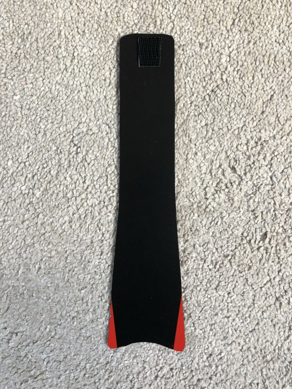

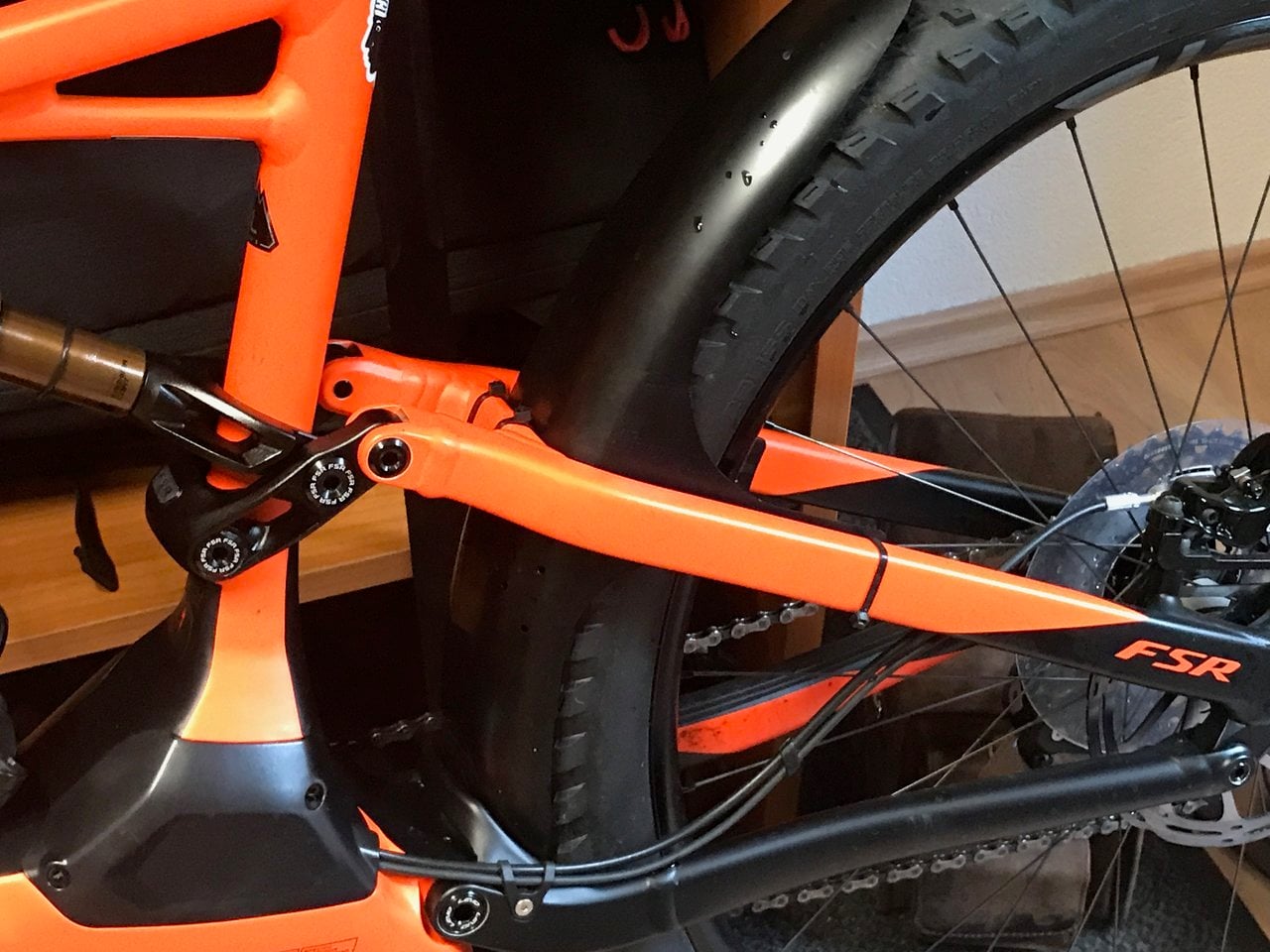

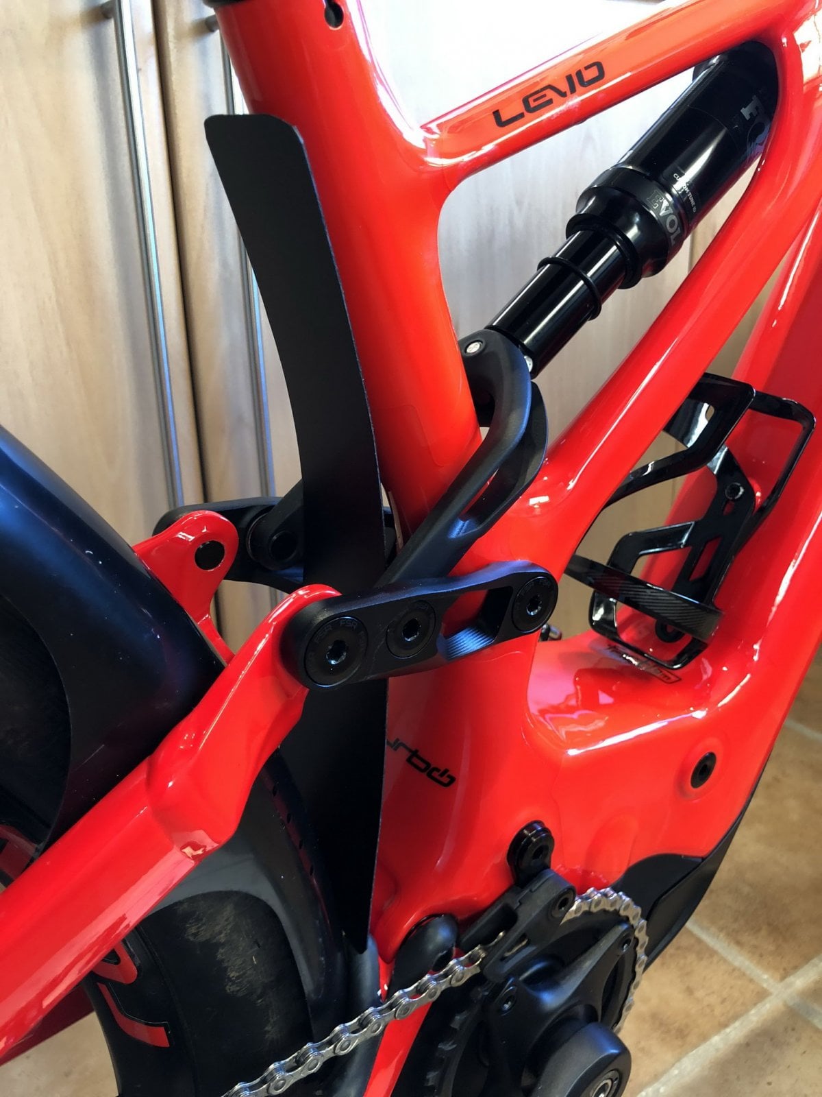

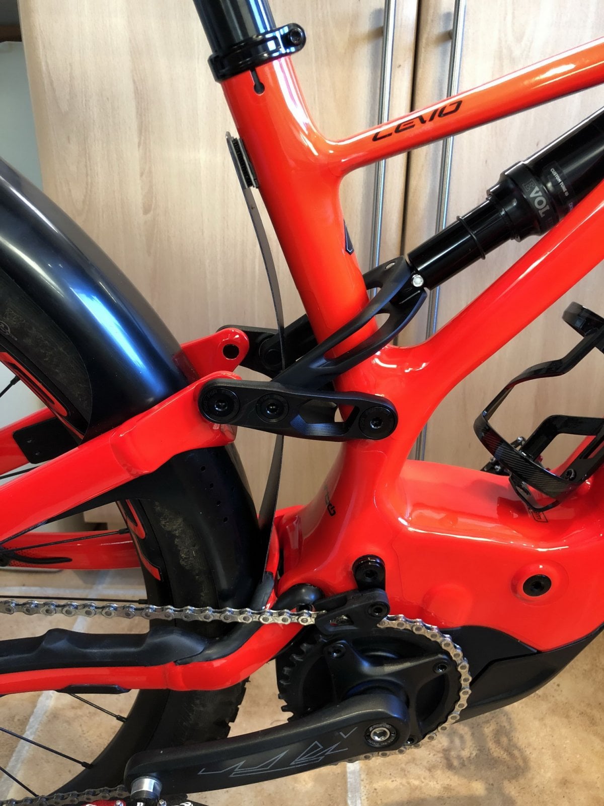

simply install mudhugger guard (small version) and no more dirt come into this whole :)
Also works on 19er levo !!!
Furthermore, Speci is currently working on a separate cover

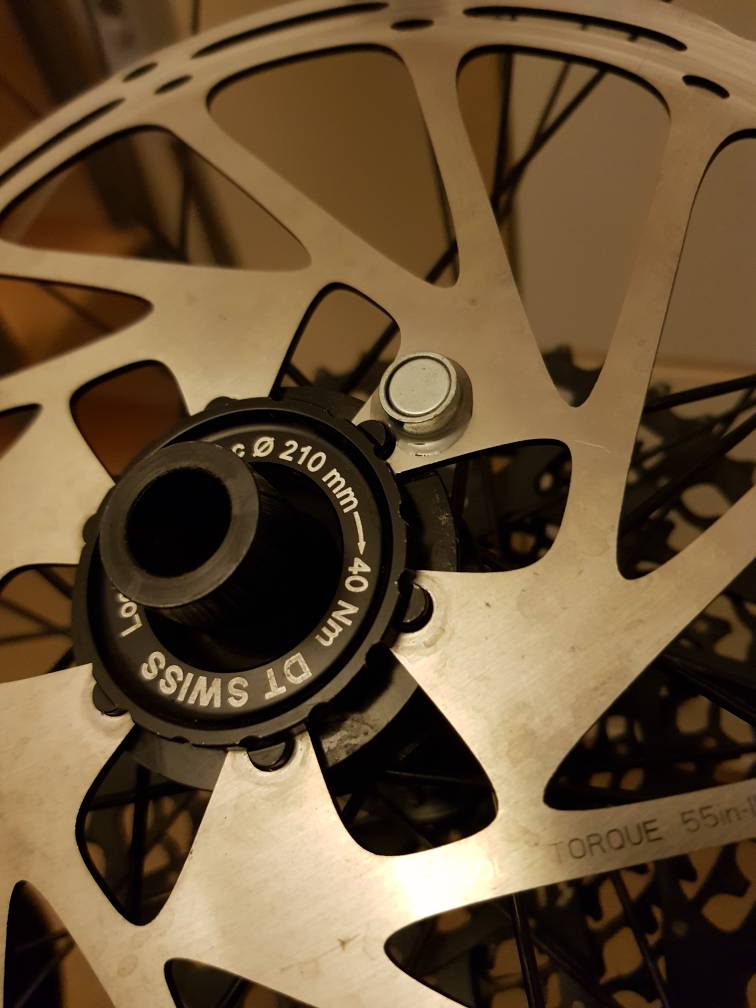

Rob, quick question, how did you attach the magnet of the speed sensor to the DT Swiss wheels. I assume you used the DT Swiss "Centerlock IS adapters" to attach the SRAM 6 bolt discs to the DT Swiss wheels. But I don't see how this could work with the original magnet...
If you found a solution please let me know :) Thx !!
Buy a good magnet and glue it on. I've had a right game going through adapter and new rotor when it wasn't needed.
Check out my thread and game I had. Now I'm the wiser

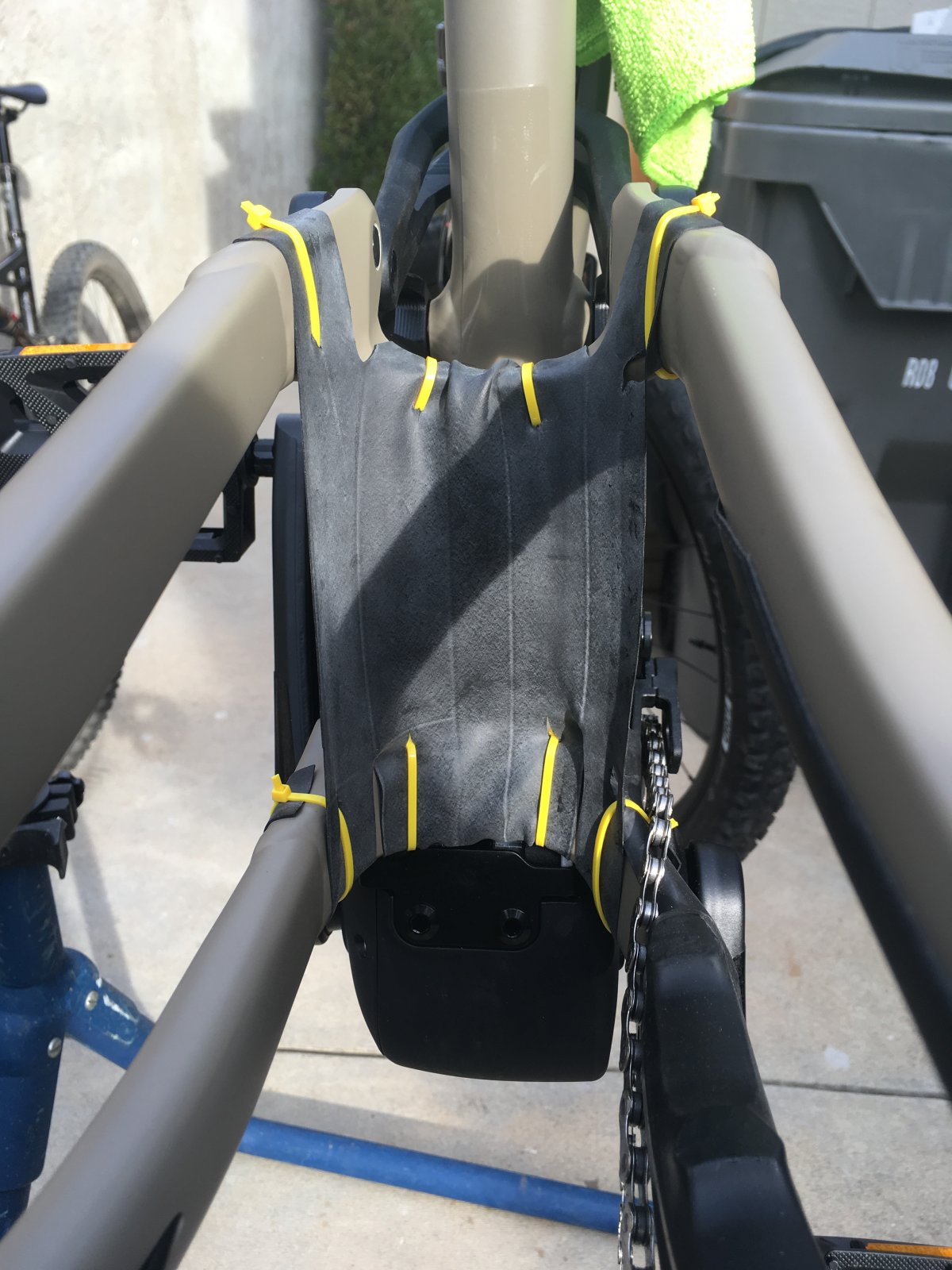

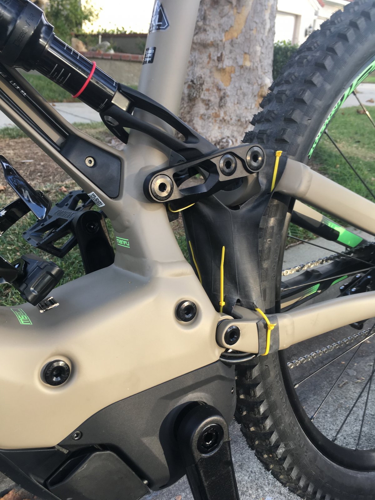

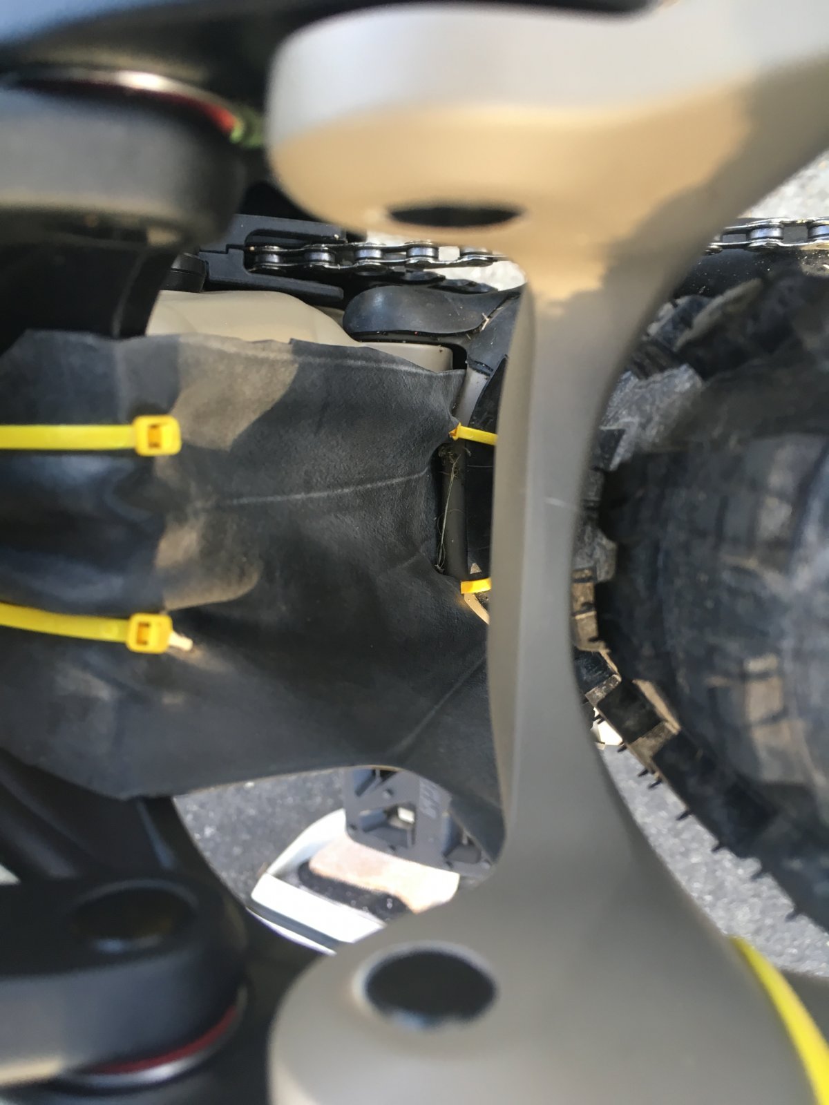

I live in dry Southern California but longevity of the bike is key for me. Am much as I love how specialized stands behind their warranty I would rather spend time on the trail as opposed to the shop with warranty problems.
I took an old tube (as I see someone suggested above) and mounted it to the rear triangle to divert debris from entering the motor. As a more permanent fix I have ordered a mudhugger front fender long (thanks @Kiwi in Wales). I don't know if it will fit, as the 2019 29ers have much less space compared to my 2017 27.5+ but is worth a try.
Apologize for the yellow zip ties, that is all I had on this Sunday night! I Side note, I ended up rerouting the DIY tube to the rear shock mount to avoid the tube rubbing against the tire.
Very DIY but I am trying to stay on the trail through the winter!
Another note, for those in Southern Californa, I picked up my bike today and my dealer checked their system and it shows they are not getting another order of 2019 Levo bikes till January, from S-Works to non comp, so if you see one get it while you can.
View attachment 6896 View attachment 6898 View attachment 6897
Hope the mudhugger fits ?
My concern like yours is there is definitely less clearance space available with the 29er 2.6 tyres/tires compared to the 27.5 set up on the 2017 and 2018 models. Please let us know how you get on with the mudhugger and clearance ?
The rubber tube and also foam option looks like a good combined ‘temp’ fix but having to do this on a new bike seems crazy ? However, if it resolves the issue for now it makes sense ?
This would me nice BODGE for GCN.... :)(y)
I was thinking of from the seat tube to the chainstay, that'll keep all the goop from spinning off the tire and running down the seatube into the gap. Or just dangle it from the seatube down past the chainstays and over the gap, it really doesn't have to be attached on the bottom if it hangs down far enough like a mudflap.

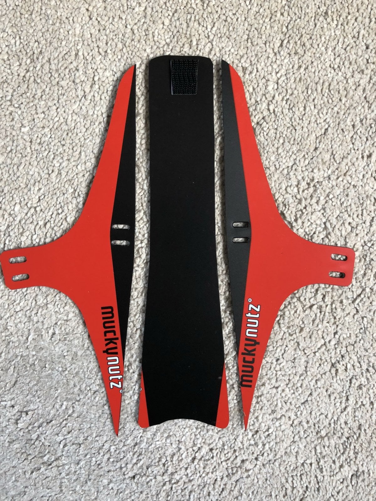

That's what I did. I cut up a Mucky Nutz to make a seat tube barrier..

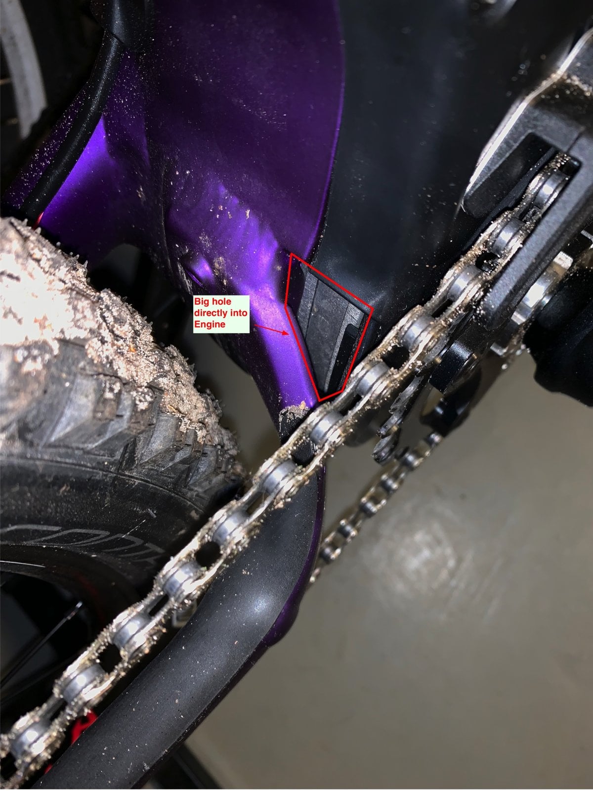

Its not only the 2019 FSR that have a severe design flaw with regards to direct access into the motor area, take a closer look at my wife's 2019 HT. Now see that's a BIG hole directly into the holy grail and at the worst possible location just in front of the rear wheel. I know it is a very hask statement but I must say that there are a few Specialized engineers that should look for another job - A 10 year old can see that this is just to wait for a disaster to happen, the next 6 months here in Denmark is a good combination of mud, debris and snow and I have no idea how this poor motor is going to survive that treatment:(
This is what you can look forward to but on a much bigger scale as the holes are bigger :eek:
