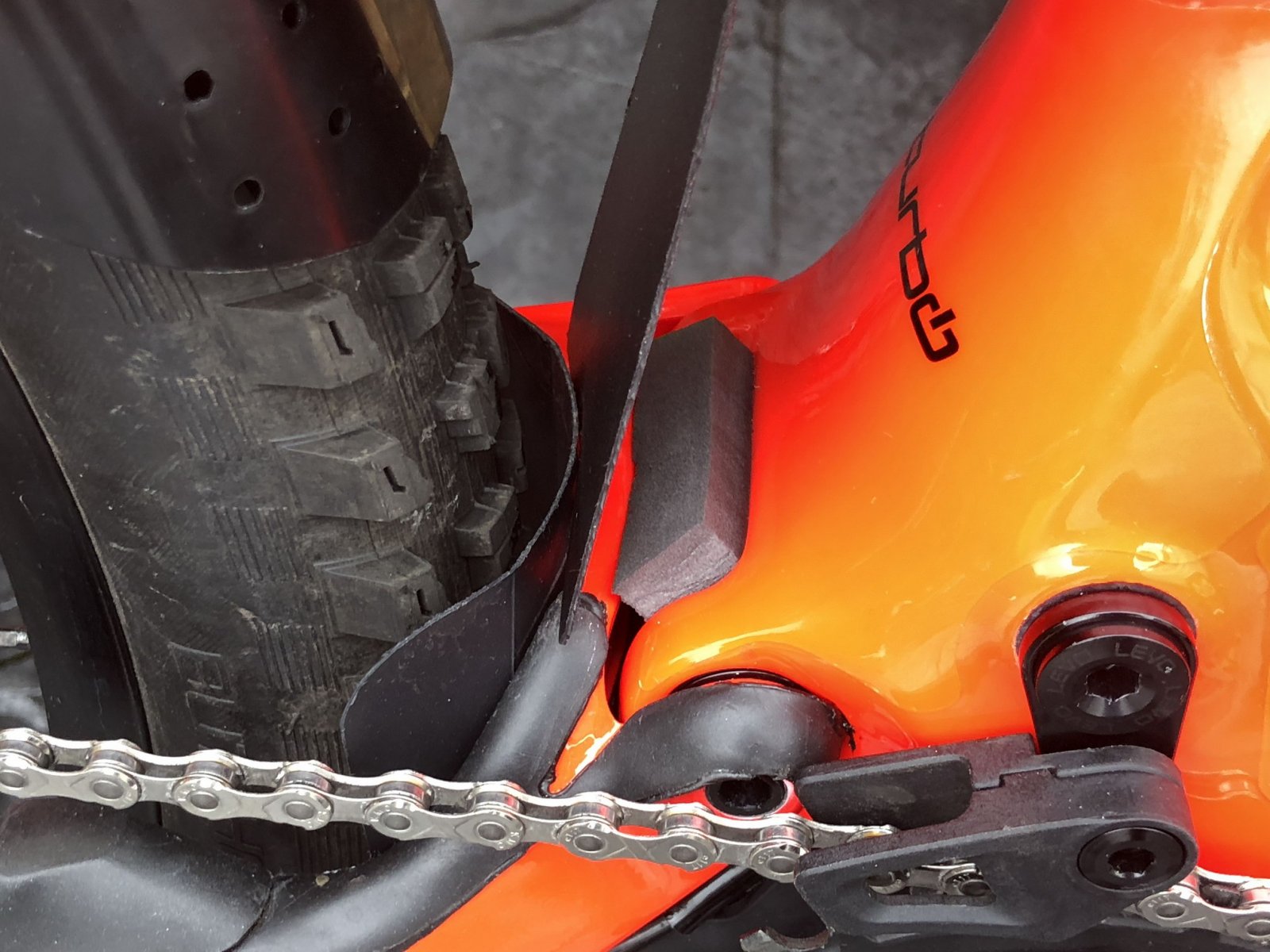

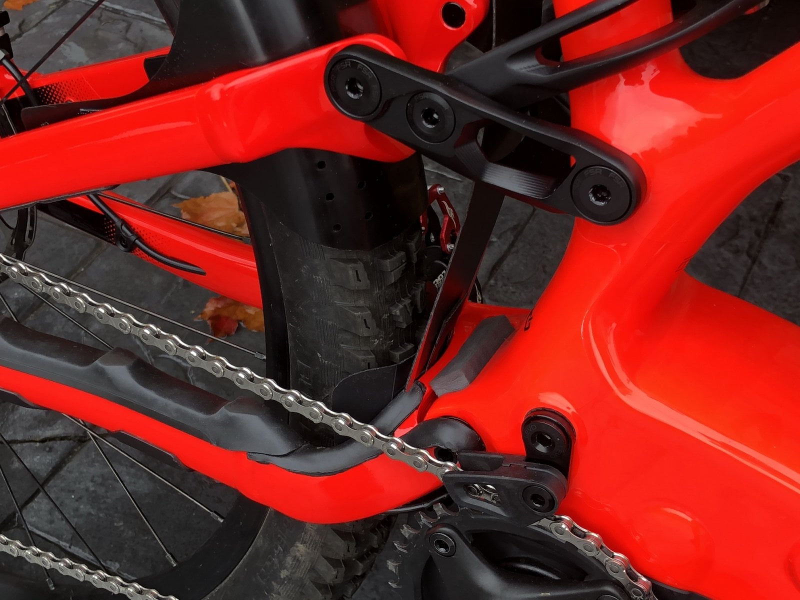

The shield is between the "hole" and the tyre! Look at the pictures. It also prevents stone damage to the seat tube. The hole is still open to the air, and I may also block it with foam, but any debris flying off the tyre will hit the shield and fall to the ground.
Yeah. I did look. and did see that. Thanks.
So just as I thought. Your guard is mainly sheilding the rear of the seat tube which looks to be smooth with no awkward nooks or crannies to collect any more mud than the guard will. I honestly don't really see the point. I've never seen a single MTB seat tube damaged seriously by stones flung from the tyre, just cosmetic damage/chips to the paint and if you're worried about that protective clear tape would do. but fair enough I've seen far worse much more pointless mudguards stuck all over bikes.
Yeah, that shield is a bit over the top, I admit! However, if you look at my post #405 (page 14) in this thread, you'll see why I am a bit concerned by stone chip damage.
My local rides are predominately very gravelly fire roads, and the tyres seem very efficient at picking up sharp pebbles and flinging them at the paint.

Yep - I've put InvisifFrame on it. Excellent stuff, and covers a lot of the bike, but sharp stones can go through it or deform it.
One of the smaller pieces on the rear triangle cross members did get marked by a stone, so I removed it. It brought some of the paint off! WTF!!! This paint is worse than I thought.

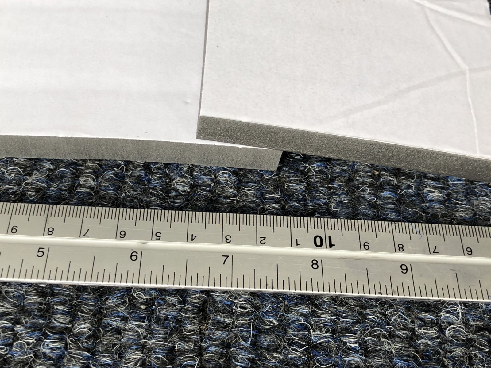

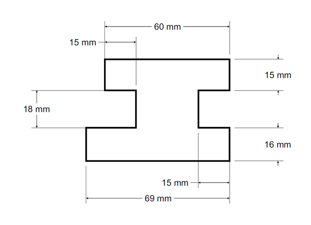

A template using 10mm thick foam is shown below along with fitting instructions.
1) Remove left crank-arm and motor cover
2) Place foam between the rear motor mounts
3) Replace motor cover and torque M4 fasteners to 1Nm
4) Replace left crank-arm and torque to 40Nm

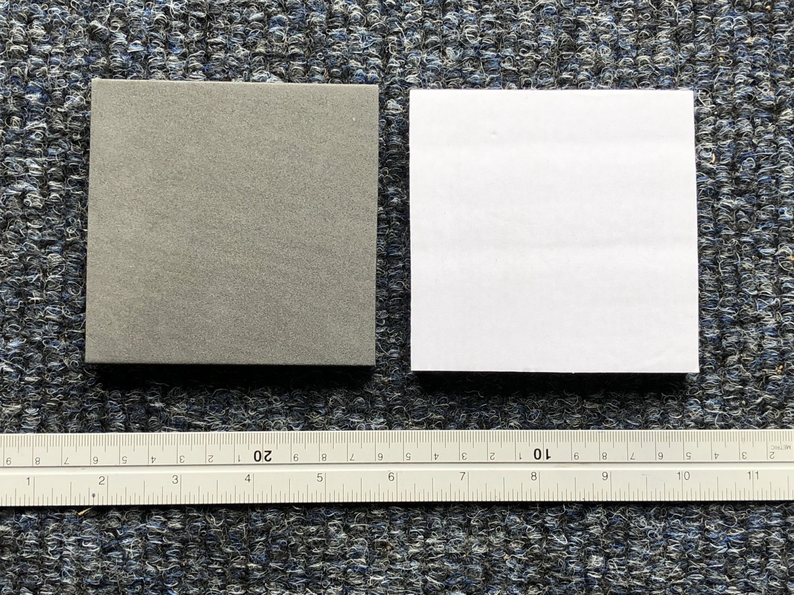

Thank you for the answers. For our temporary home foam fixed, do you have a recommended foam PPI? 30, 65, etc? What are you folks using in your foam?
Looking for the best results for protection without overheating.
