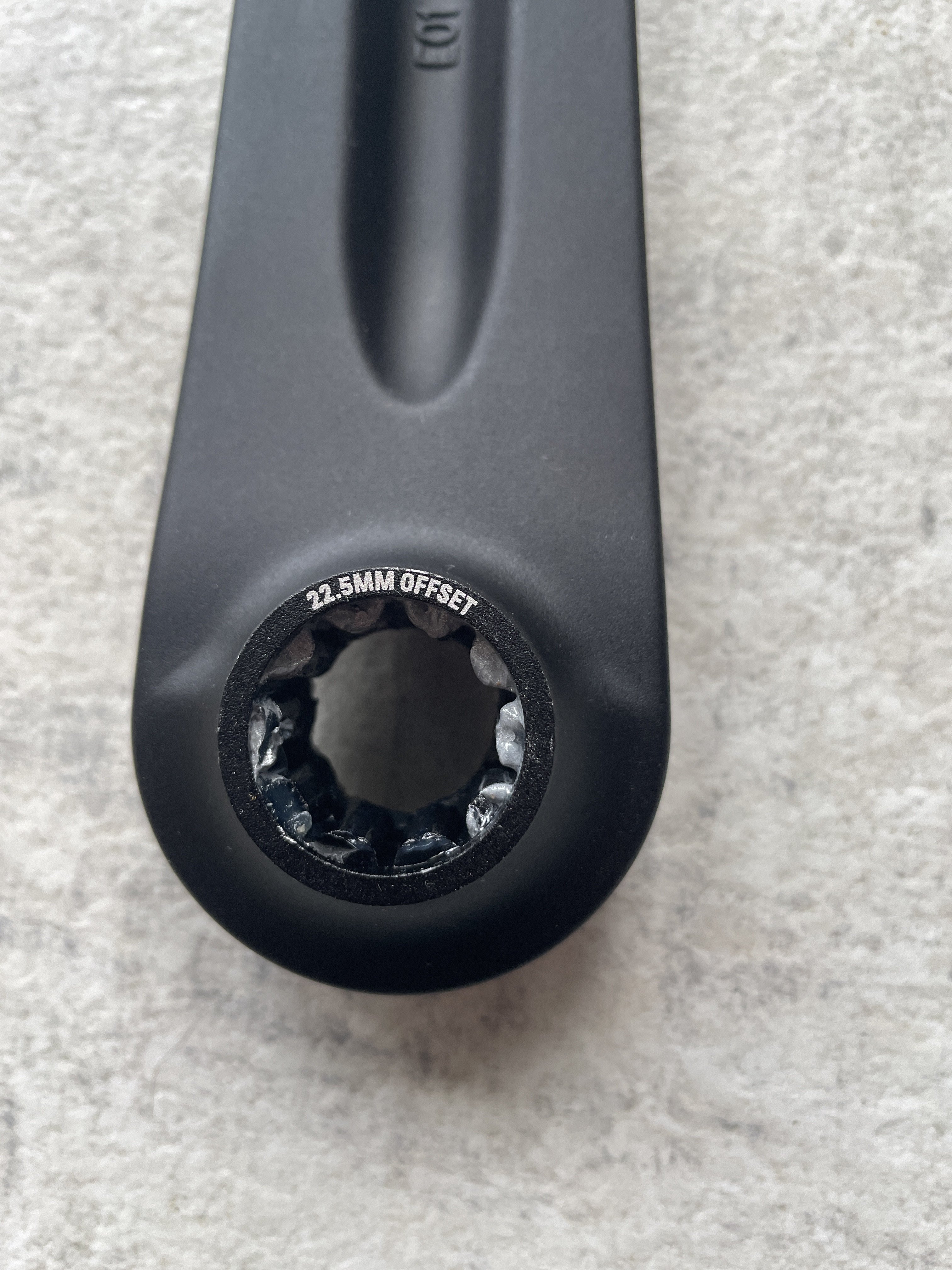

This is the offset for the E13 alloy pedals
Dave_B
Aug 29, 2020
1,470
1,601
Newquay
Hope standard offset +5mm compared to E13 and Hope narrow offset is -1.5mm compared to E13.
I’ve ordered standard offset.
Won’t be fitting the Spesh Hope cranks because they are not equal width about the centre line. As a friend of ours says…Wonky…..

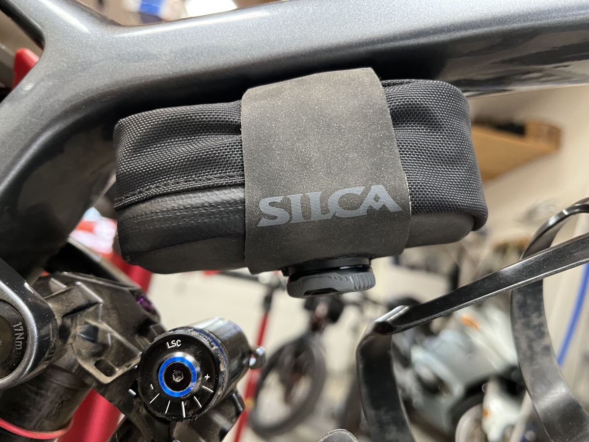

On my Large EXe:
OneUp EDC Lite in stem
Custom Dynaplug bar ends
Granite Design Portalege under top tube mount (I use a Silca strap, but the stock strap works fine.)
76 Projects .3l bag with:
OneUp Inflator
25gm+Gorilla Tape, 20gm Co2
Clever flatout lever tool+ PowerLink
OneUp chain breaker V2 (mounts to lever)
6mm L-key for wheels
CR2032 battery
Park tire boot
$20, nitrile gloves, compressed towel
Tubolito Tube and 8 zip tires stored under the lower motor cover.
