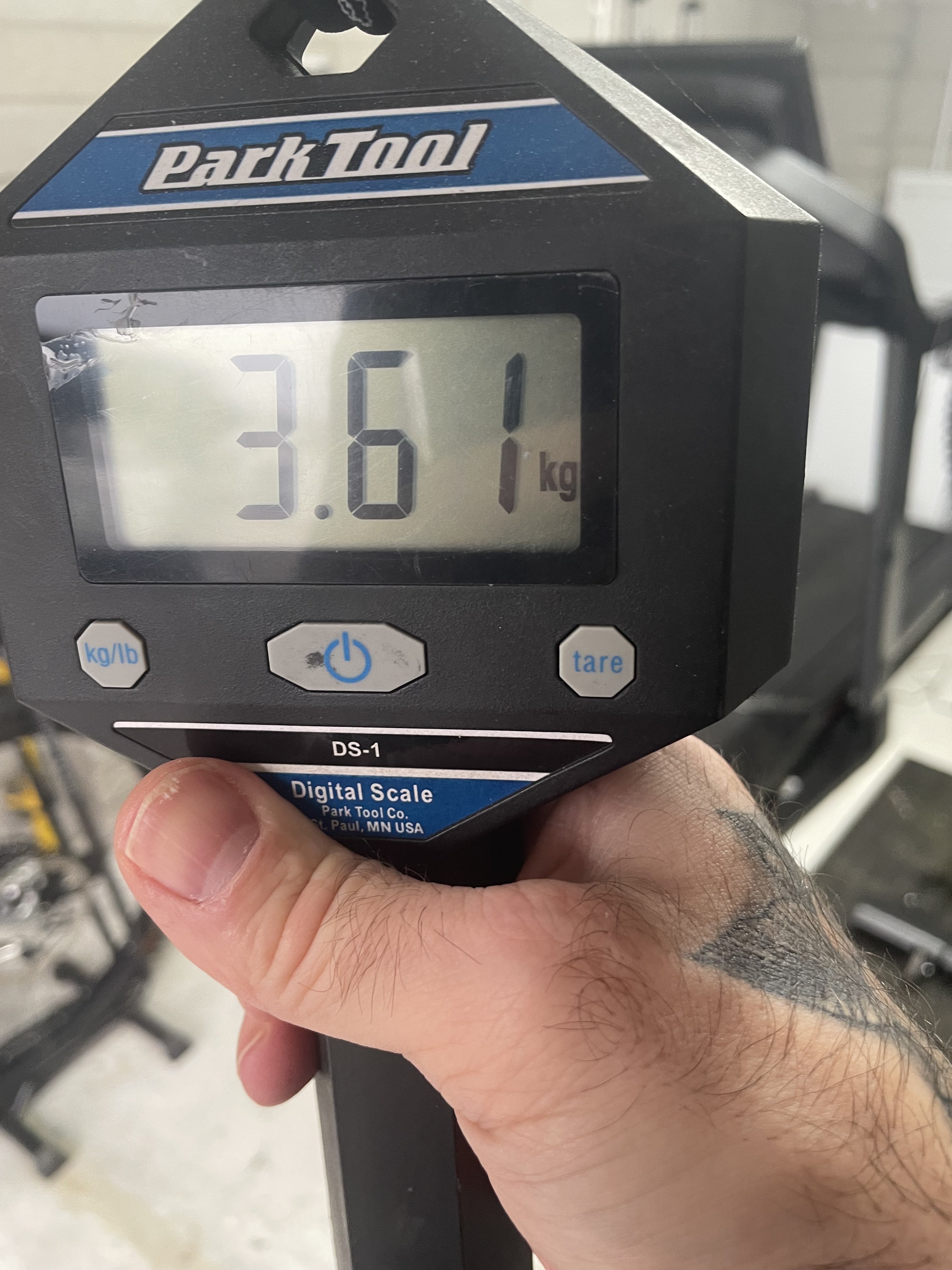

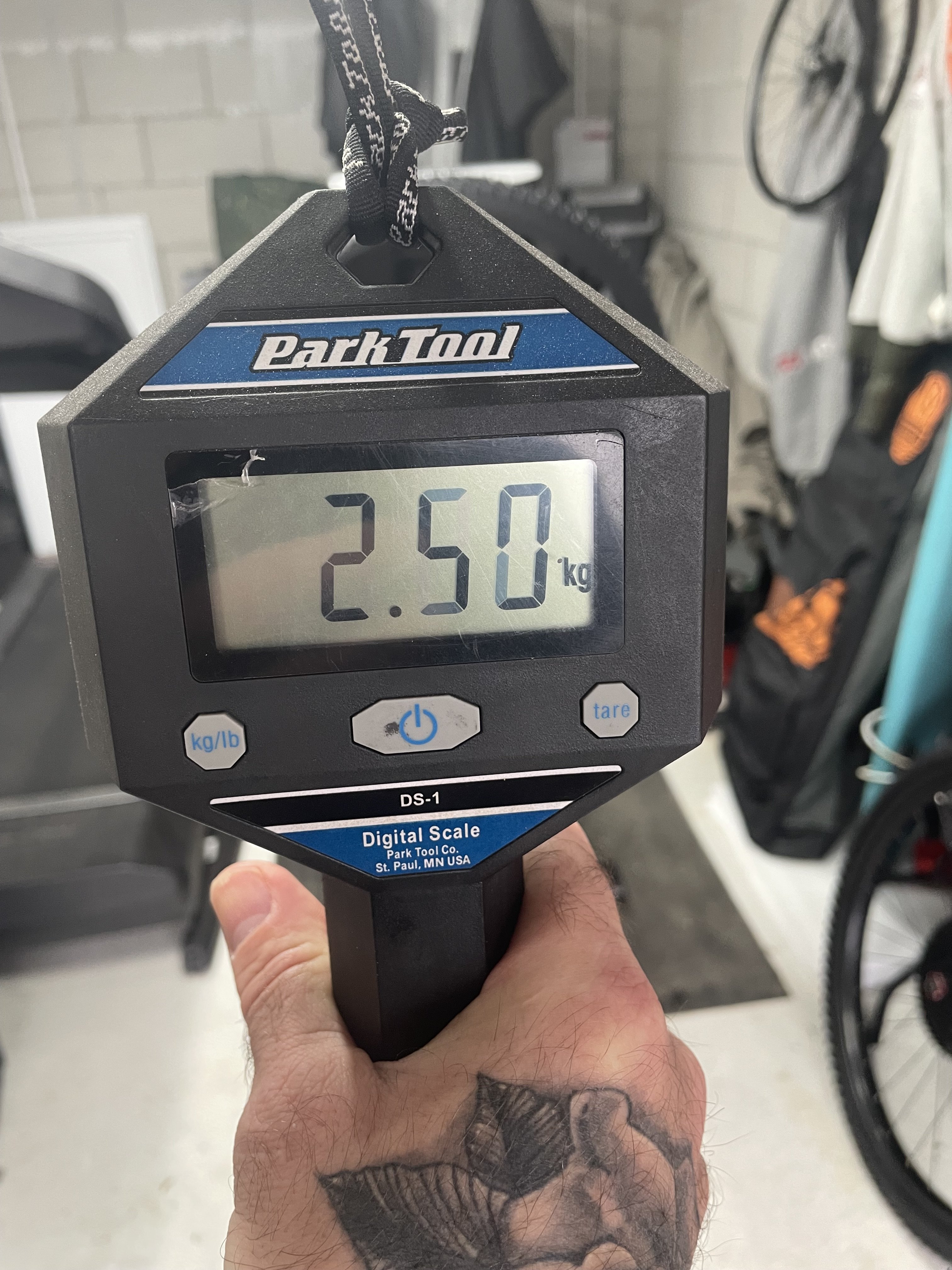

Wheel weights from the 9.5, with tyres tubes etc.

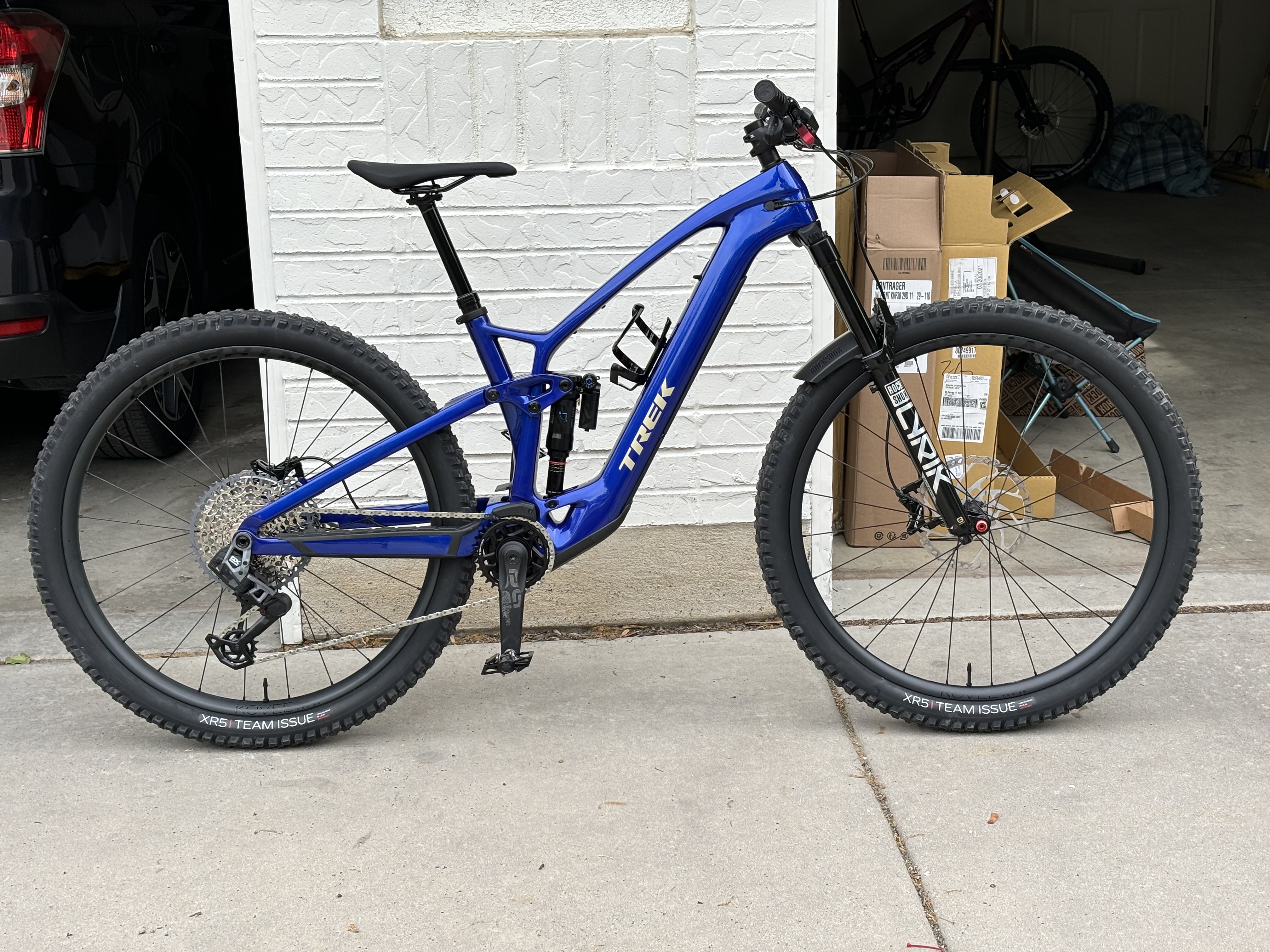

Bike build is complete.
Lyrik Ultimate 160mm
Ultimate shock
GX Drivetrain
Kovee Pro 30 Wheels
OneUp carbon bar
Wolf Tooth front chainring
OneUp dropper post lever
TRP Trail brakes

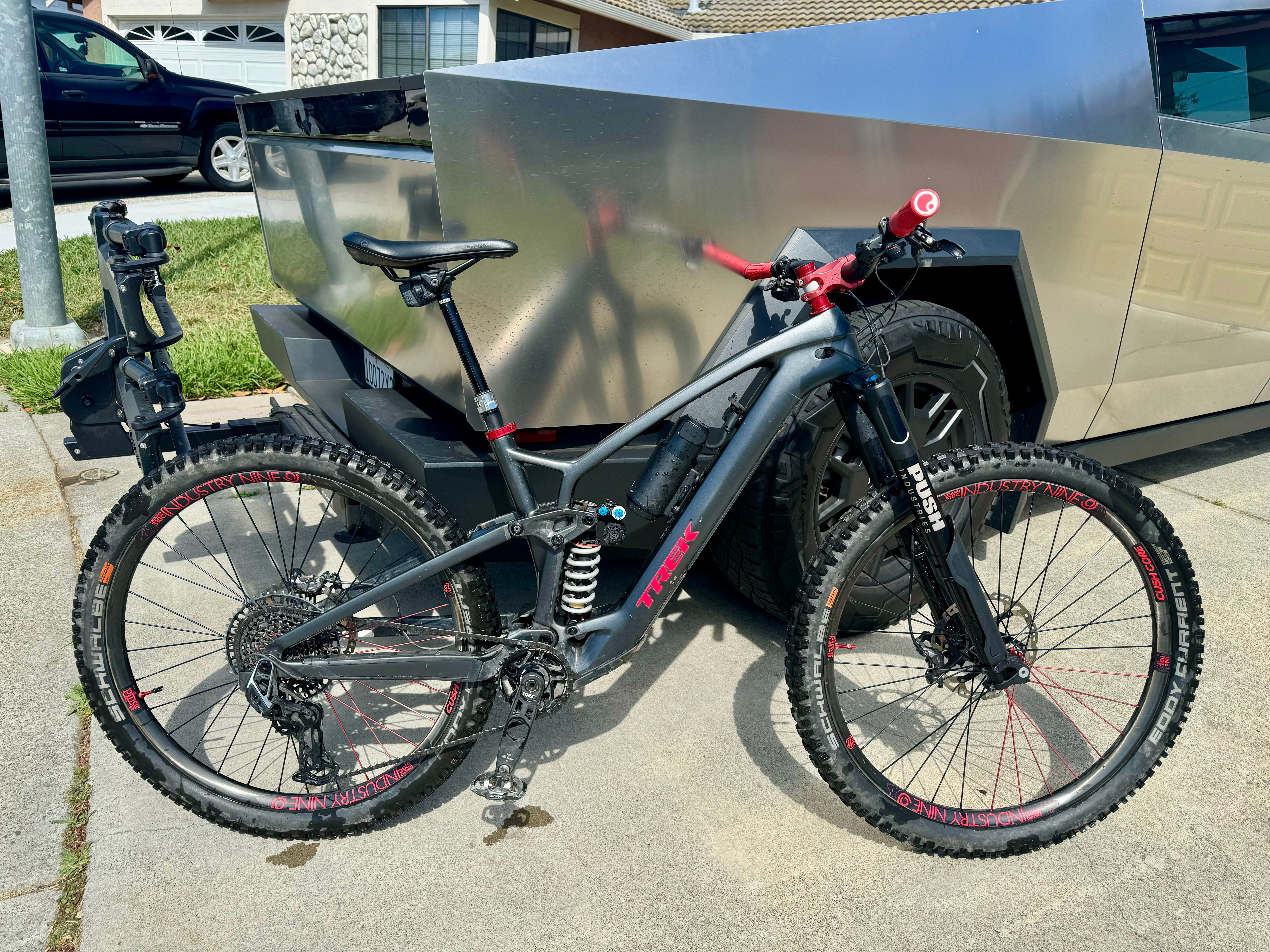

My 9.5 Build is finally complete today:
Fuel EX-e Matte Dnister Black Frame
Fork: Push Industries Nine One 160mm
Rear Shock: Push Industries 11-6
Wheels: i9 Enduro Carbon 310 Hydra Hubs with Cush Core EMTB Inserts
Tires: Schwalbe Eddy Current Front & Rear
Drivetrain: SRAM XO Transmission with Magic Pulley Wheel Upgrade
Brakes: Shimano XT 4 Piston 8120
Rotors: Shimano Ice Tech 203 Front & Rear
Dropper: Reverb AXS
Saddle: Ergon SM E-Mountain Core Prime
Handlebars: Deity Speedway
Grips: Ergon GA2
Stem: I9 A35
Headset: i9 RIX
Cranks: FORK HEX 2 155mm
Chainring: Wolf Tooth Drop Stop B 32 Tooth(TQ Direct Mount)
Seat post clamp: Wolf Tooth 39.7
TQ Smart Box
Garmin Power Edge Mount: powered by the TQ Smart Box
XO Transmission Power Block: powered by the TQ Smart Box
TQ Range Extender X 2
Fidlock Range Extender Mount X 2
Silk Graphics
InvisiFRAME Matte Finish
Anyone interested in doing the SmartBox/AXS mod I wouldn’t recommend it. The only reason I was able to source this part was from a Trek Rail AXS owner in Australia that upgraded to the GX Transmission. Which uses a different battery type. Fortunately for me he was willing to sell/ship it. Trek/SRAM are not willing to sell this part directly to customers so I wish anyone luck in the middle of this modification trying to source it.
