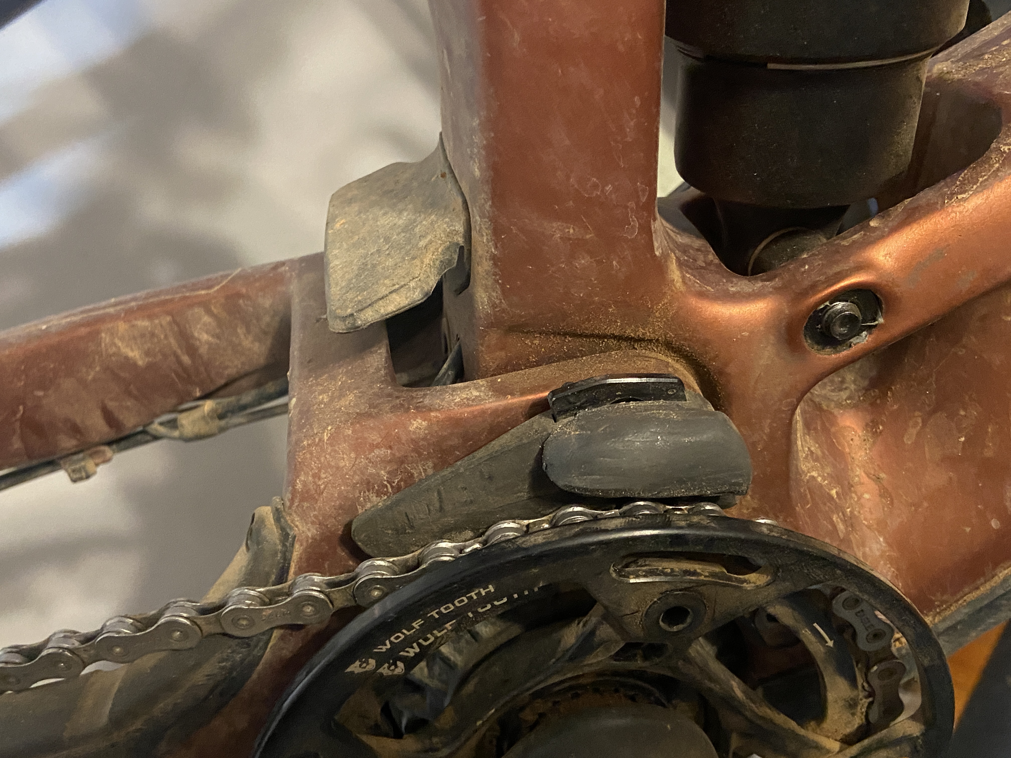

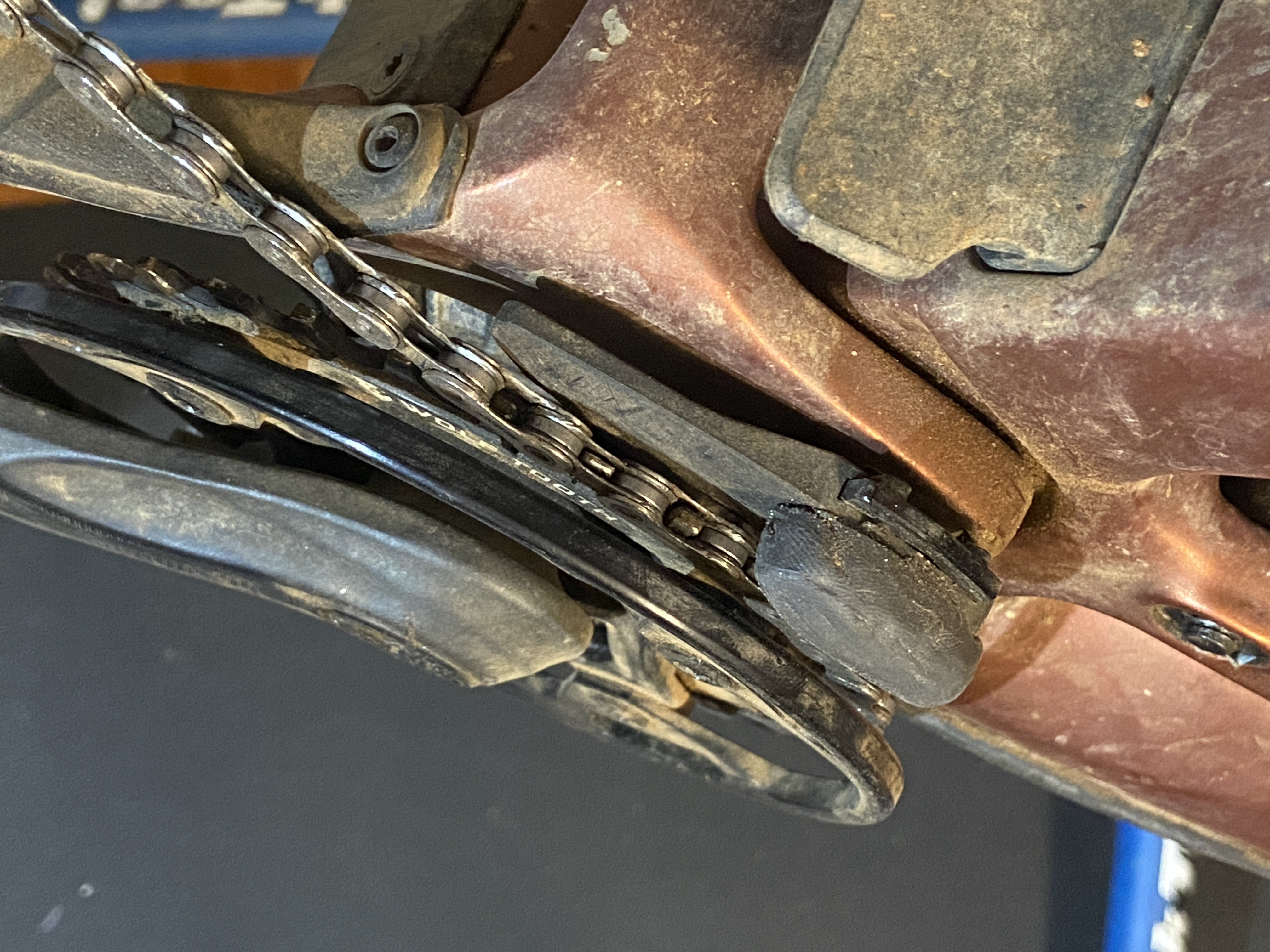

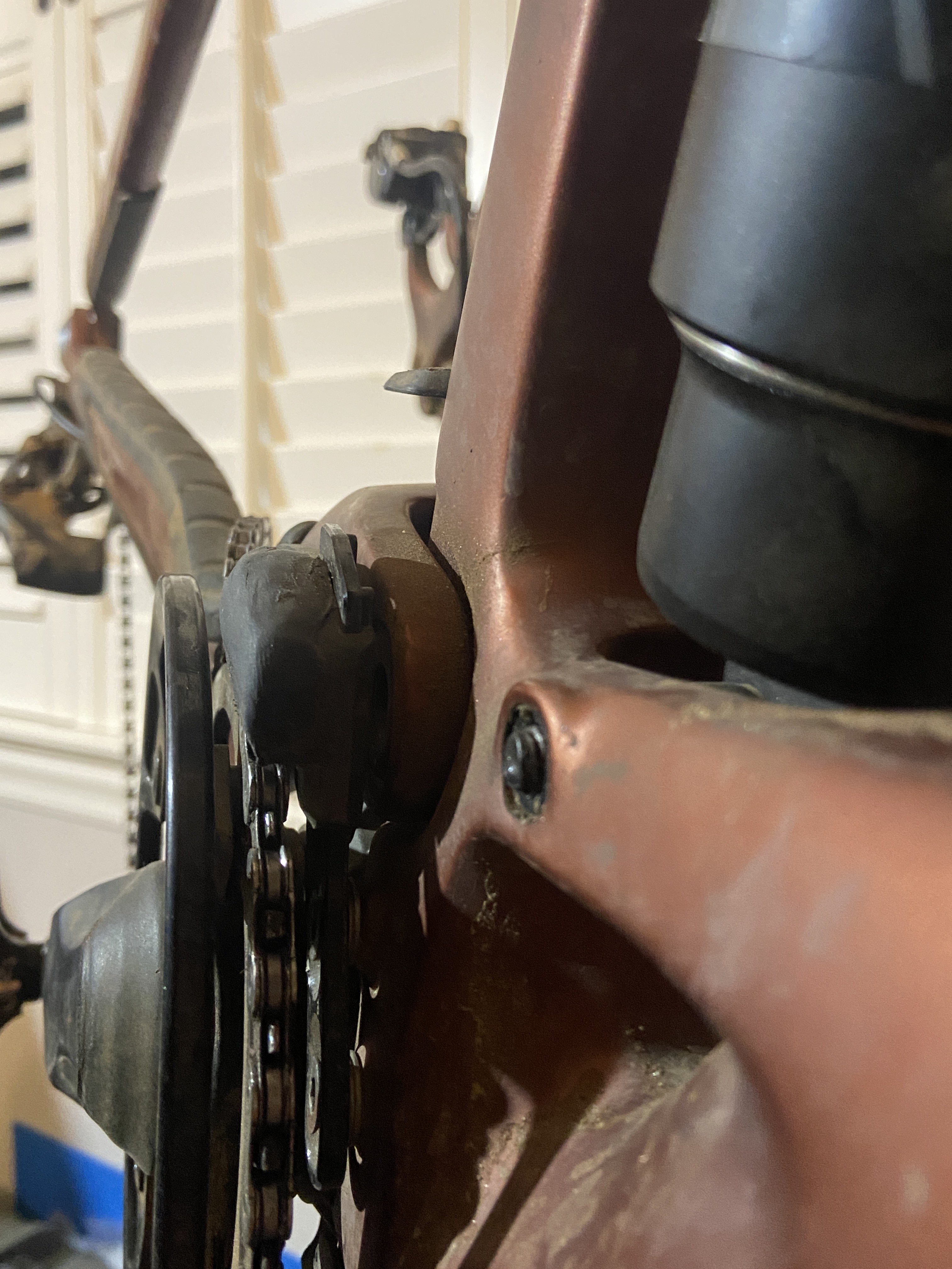

For the good of the order:
I fitted a Wolf Tooth bash ring with a WT 32 ring and I'm really pleased with how the setup turned out (other than there was a mix up with LBS on ring and it was supposed to be SS). Running X01 drivetrain, and this setup moved my chain line a couple mm inboard to 53mm, which I think is better if you're not running Transmission.
The outer plate of the chain guide no longer fits, but with the bash ring you really don't need it. However, it did look kind of janky, so I took some Sugru and added it to what was left of the chain guide. Cleaned up the appearance and helped get back complete coverage from the standpoint of chain guide functionality.
I used these bolts with dual hex ends of different sizes: Problem Solvers 10mm Double Chainring Bash Guard, Dual Hex, Black Alloy Chainring Bolts Set CR1478.
(Have to note that X2 spare on while Hazzard with progressive coil being serviced. Don't run an X2 normally)
Hope this is helpful to someone.
