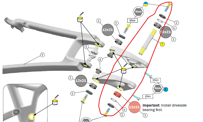

Hi, doing a bearing replacement and have completed all except I have no idea what to do with the 'rocker pivot axle'. Does anyone know how to remove etc. It's just spins around and I can't work out how to remove so I can add the new bearings. Any help appreciated.
if your talking about this one, give it a tap-tap-tap from one side, the bearing and rocker pivot axle will pop out. then I just reinserted the axle to pop out the other side.
I'm actually in the middle of doing this right now, the bearings feel rough while they are inserted, but weirdly when I get them out they run smooth. Bought new ones anyway.
Thanks so much, I'll give that a go! Fingers crossed.

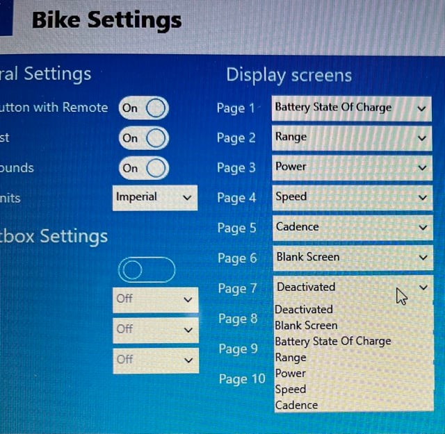

Thats not an option. Perhaps use the Trek Central app or garmin/strava, etc.
Here are all the display options available in the dealer service tool.
You don't need the dealer service tool to change the screens, you can use the tq android /iPhone app to configure them as well. but you're right that you can't configure the display to show distance
