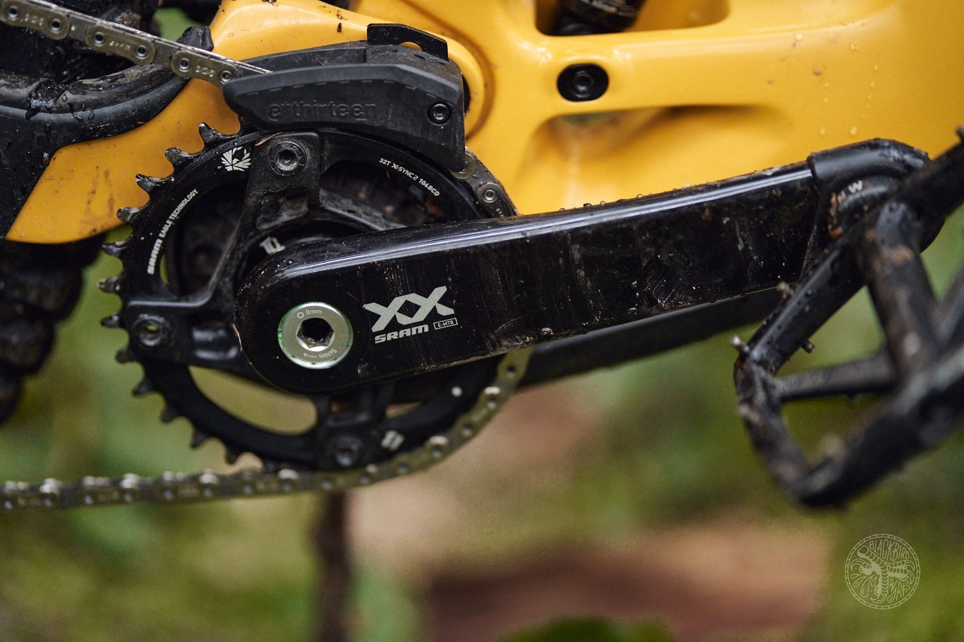

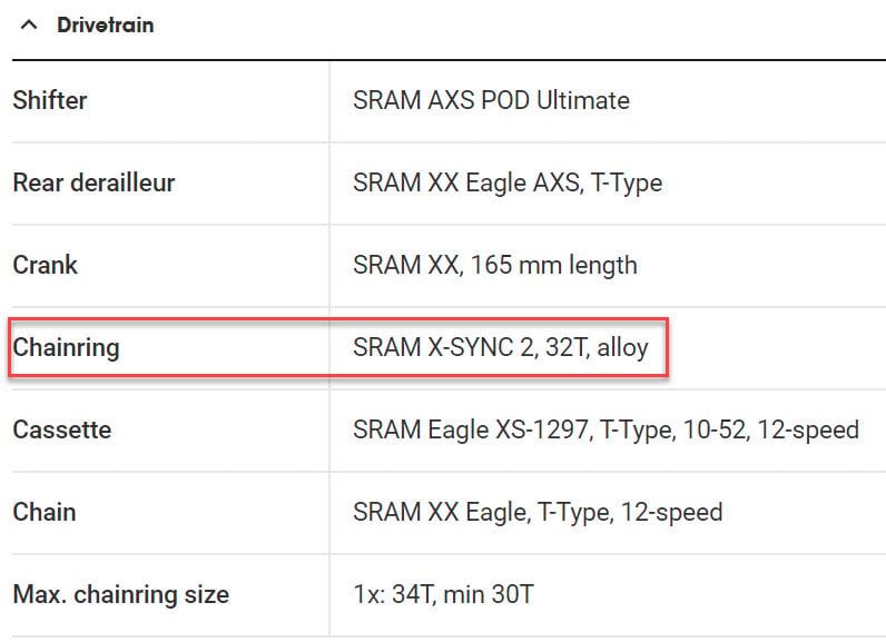

Has anyone purchased the AXS T-Type build? I note Trek are putting the XSYNC 2 chainrings on these bikes, but they are not compatible with the Transmission system...

I’m guessing there isn’t too much difference. Even if x-sync2 chainrings say they aren’t compatible with t-type, t-type chain rings do appear to be compatible with eagle.
I’m upgraded my new 9.9 Axs to xx t -type and am using the standard 32t x-sync 2 chainring and it works perfectly.
i have a wolftooth t type compatible chainring to put on but haven’t bothered yet.

I think it’ll come down to chain line as either normal eagle xsync 2 or t-type chainrings work with the rest of the eagle transmission group. Chain line is 55mm so you’d need to find a crank and appropriate spacing to accommodate.

From what I have discussed with my local shop, the FSA spider takes care of the offset, the chainring Trek are using is the r normal x-sync 2 104 BCD which has zero offset.

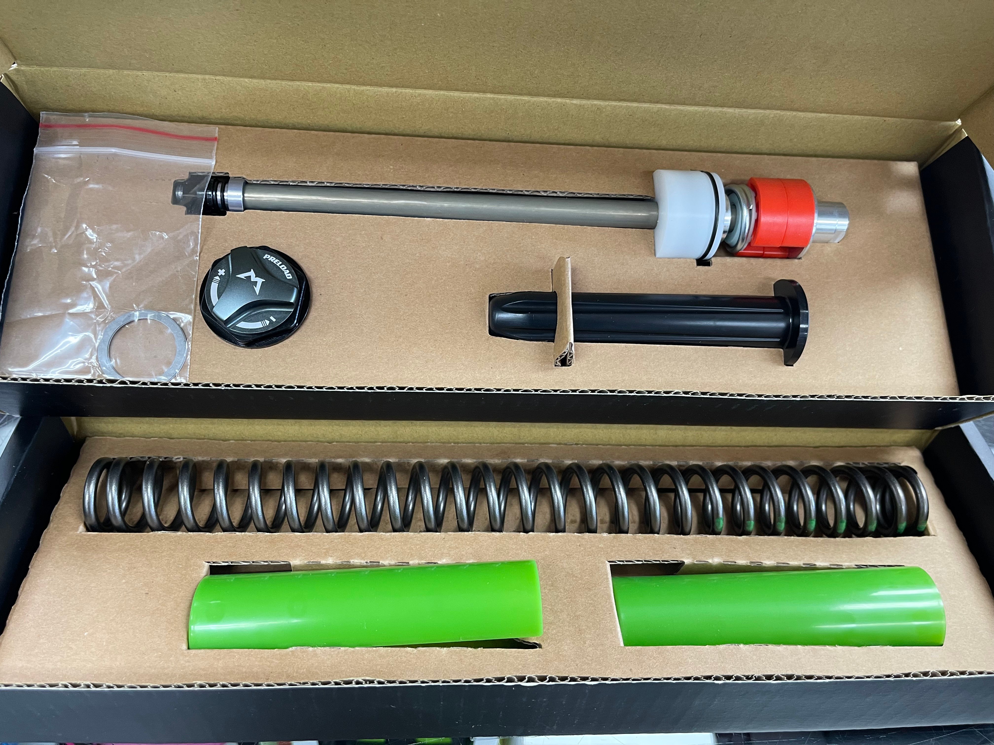

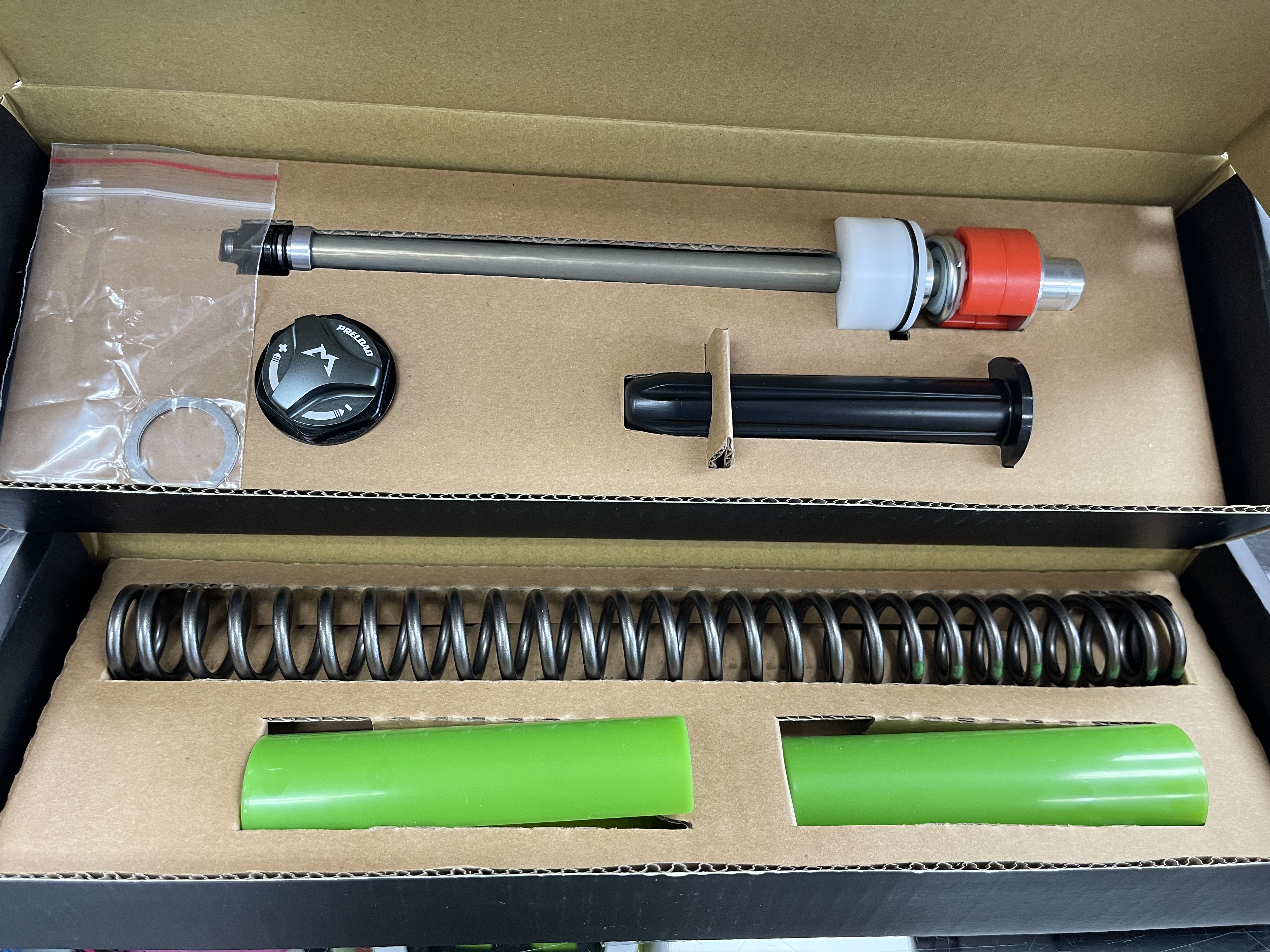

Oh nice! Did you have to make a rebound and compression adjuster change?
Used the Marzocchi recommended rebound settings for my coil rate and seems perfect... Compression wide open which what I usually run being light weight. My sag is about 17% with about 1/2 turn preload just enough to take up any play with the spring.
Got it, thanks. I’m 180 pounds ready to ride. I ordered the green spring. I figured that would be best with the heavier Ebike. We’ll see how it goes.

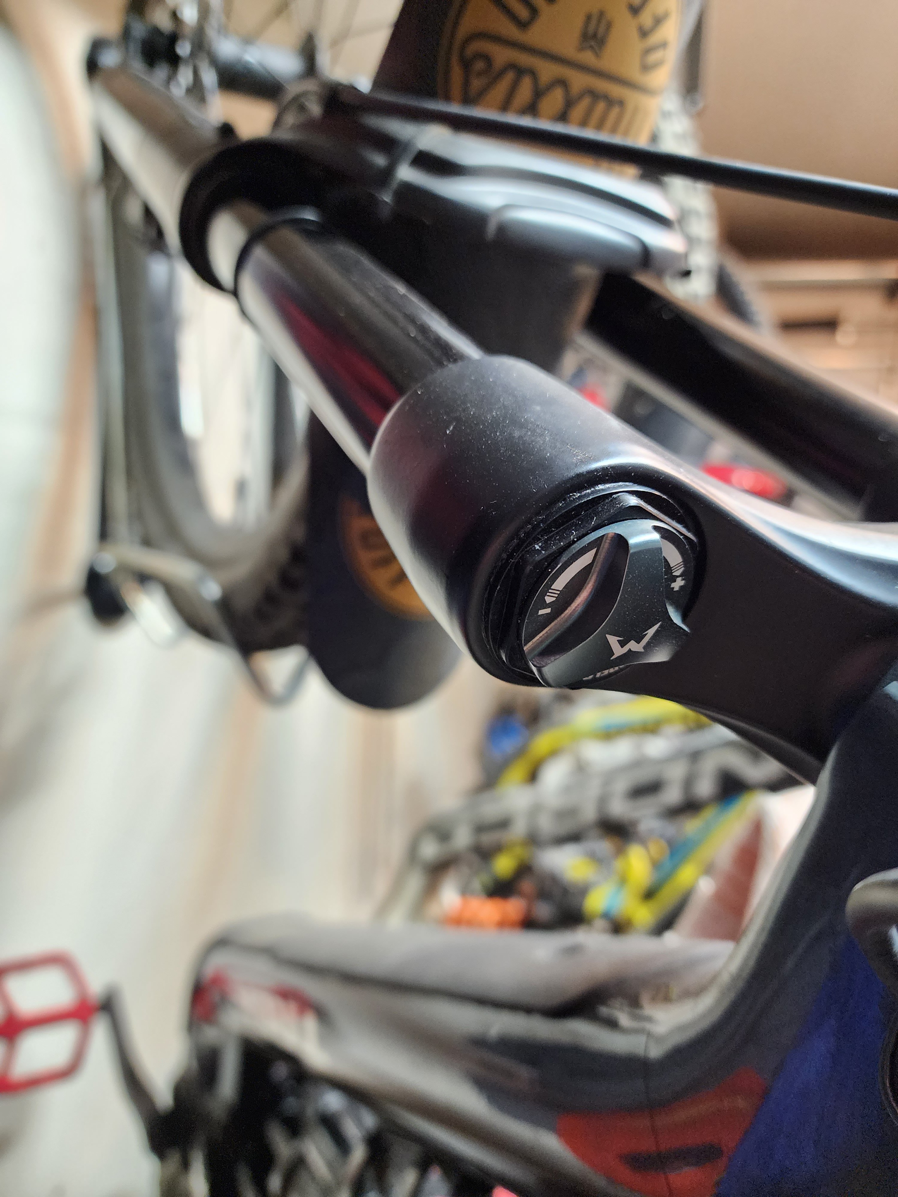

Oh, hell yeah, again! The Marzocchi coil kit for my Fox Rhythm 36 has done the same for my front as the X2 did for the rear. Anytime I make a big change to my bike, I take it on the same, about 17 mile ride with some good flowy up and down single track with a couple technical steep climbs. Nothing super difficult, but challenging enough to give me a good feel for the changes I’ve made. And, I know this trial like the back of my hand. The coil kit definitely allows me to keep up more speed with better traction everywhere. I didn’t feel any increased weight. I think because it lets you keep your speed up easier. It’s really amazing. I’m 180 pounds ready to ride and I’m running it at 160mm with zero preload and the compression dial wide open. I’m getting 20% sag. Which is ok with me. I’ve never been able to get 25% or 30% sag on an air fork, unless I was running insanely low pressure. I set rebound at the recommend setting for my green firm spring and weight. That’s 5-7 turns out. So, I set it at 6 turns out. I didn’t feel that the front end was any higher. I think it just settles in a little more than the air setup. But, mid stroke support felt good. I really noticed an improvement when climbing short climbs, where you’re trying to keep your speed up to get over it, to a flat section or downhill section. It just allows you to keep that speed up easier, so I’m shifting less. Longer steep technical climbs were no harder and I didn’t notice any difference here. Going down chunky downhill sections, it gives me more control and I can just relax my arms more. I feel more comfortable turning and just letting that front wheel hang out to the outside a little more. I hit an embedded basketball sized rock at just over 20 mph. I know I was going at least 20, because I was in high mode and I wasn’t getting any motor power anymore. Before I hit it, I said to myself, “oh, that’s going to be a hard hit. But, I didn’t feel anything. It felt like my front tire was half flat, but no jolt or shock to my arms at all. I used all but 10mm of the travel on this ride. Which is ok with me. It was a shorter ride and I didn’t go down the steeper, faster and chunkier downhills that I usually ride on. And, I didn’t get anything over a foot off the ground. I did use more travel than I usually use on that ride with the air setup. So, I feel 100% confident that it’s not to progressive. And to my surprise, my air setup had three purple tokens in it. I’ve included a picture of that. I did feel some bob under hard, out of the saddle mashing. So, I’m going to slow the rebound one click and run the compression knob to 1:00 instead of fully open, which is about 10:00. With the air setup, I used to run that at 3:00. I noticed with the coil kit, the compression adjuster has a lot more adjustability. Full closed is almost locked out now. With the air setup it wouldn't come close to locked out. My guy did a complete service when he put the coil kit in. So, I don’t know if it’s because of that or if the coil kit causes that. While writing this I was thinking that, I usually get one or two tire pings on my ride. I didn’t get any today. I just went out and checked and both tires were 5 psi higher than what I usually run. I topped them off at the shop. But, their dial gauge must be way off. So, I think on tomorrow’s ride, it’ll feel even better. So, I have to say that the Marzocchi coil kit and the X2 shock is a very good combination. Both ends are just like melted butter now. Even my installation guy commented that both ends just feel very balanced. I’m very happy with this setup. The only drawback is now more than ever, I’m up to the 20 mph where the motor cuts out and I feel like I can go faster if I had the motor working. That’s not that bad of a negative though. I can live with that.
That's awesome to hear that you're liking the changes. I'm so sold on feel of the coil fork that I'm running it on all of my bikes. 2 marz coil kits and 1 smashpot. Also I find the mid stroke support is way better than air which is really noticeable on the steep jank

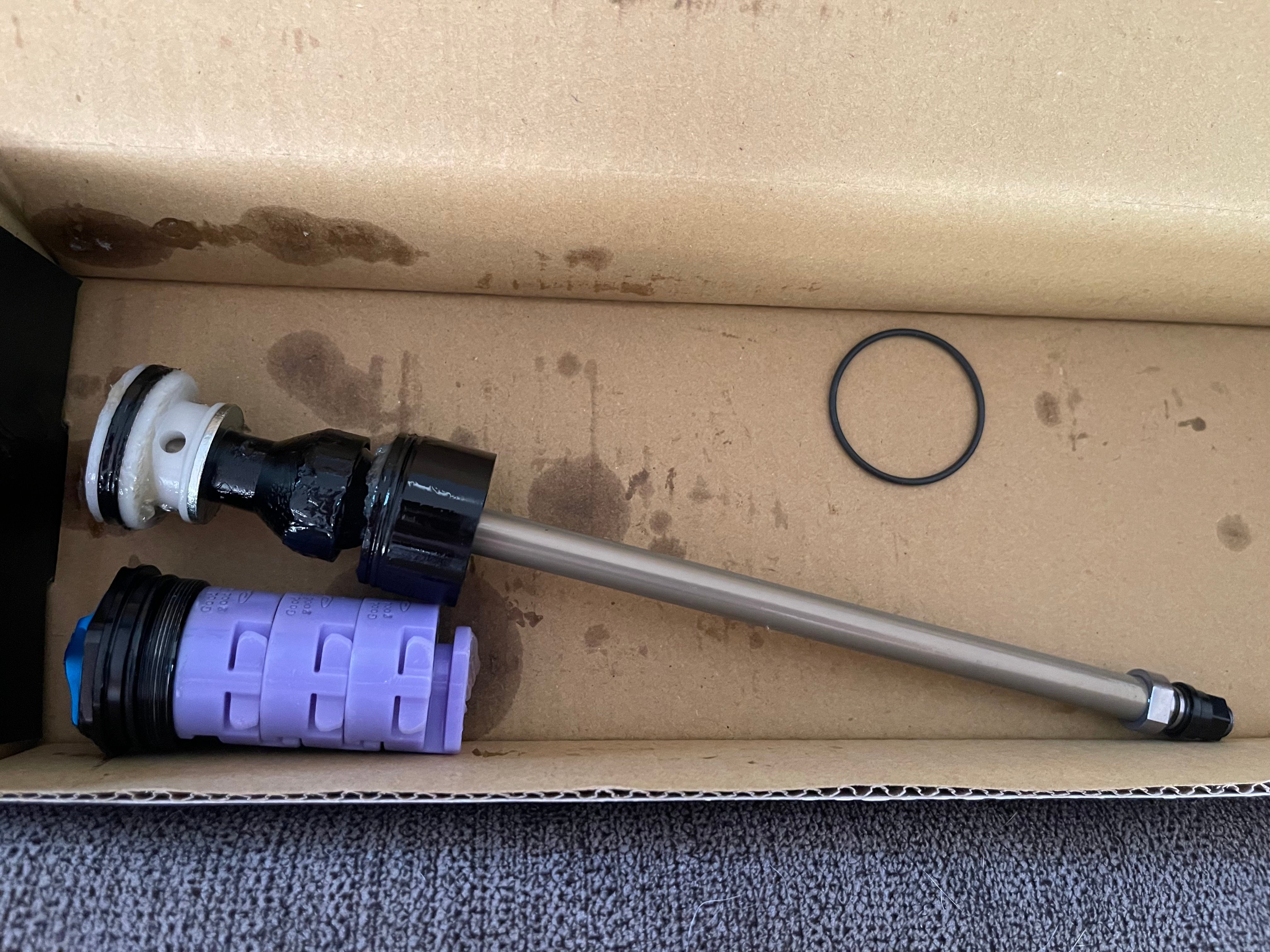

No issues with clearance. It is VERY close though. I can only say that I am confident it fits a large size frame.
The biggest thing for me has been getting anywhere near full travel. So far, the Vivid is working better. I was very happy with the Float X on my Ripley and Ripmos. The large air spring of the vivid is helping with getting more travel. I installed a shock wiz over the weekend and am on my first round of tuning. Removed the 1 stock volume reducer, increase air pressure, less rebound and less LSC. I made all those changes and will ride tomorrow morning.
Because I could, I installed the compression adjuster on the stock Float X. In the process, I discovered that it was set to -4 of 10 from the factory. That could be why I was not getting full travel. Too much compression damping. Once the Vivid is Dialed, I may through the Float X back on and see if that was the case.
Where exactly is the shock close to the the frame? Is it the reservoir close to the downtube on full compression of is it close to the range extender?

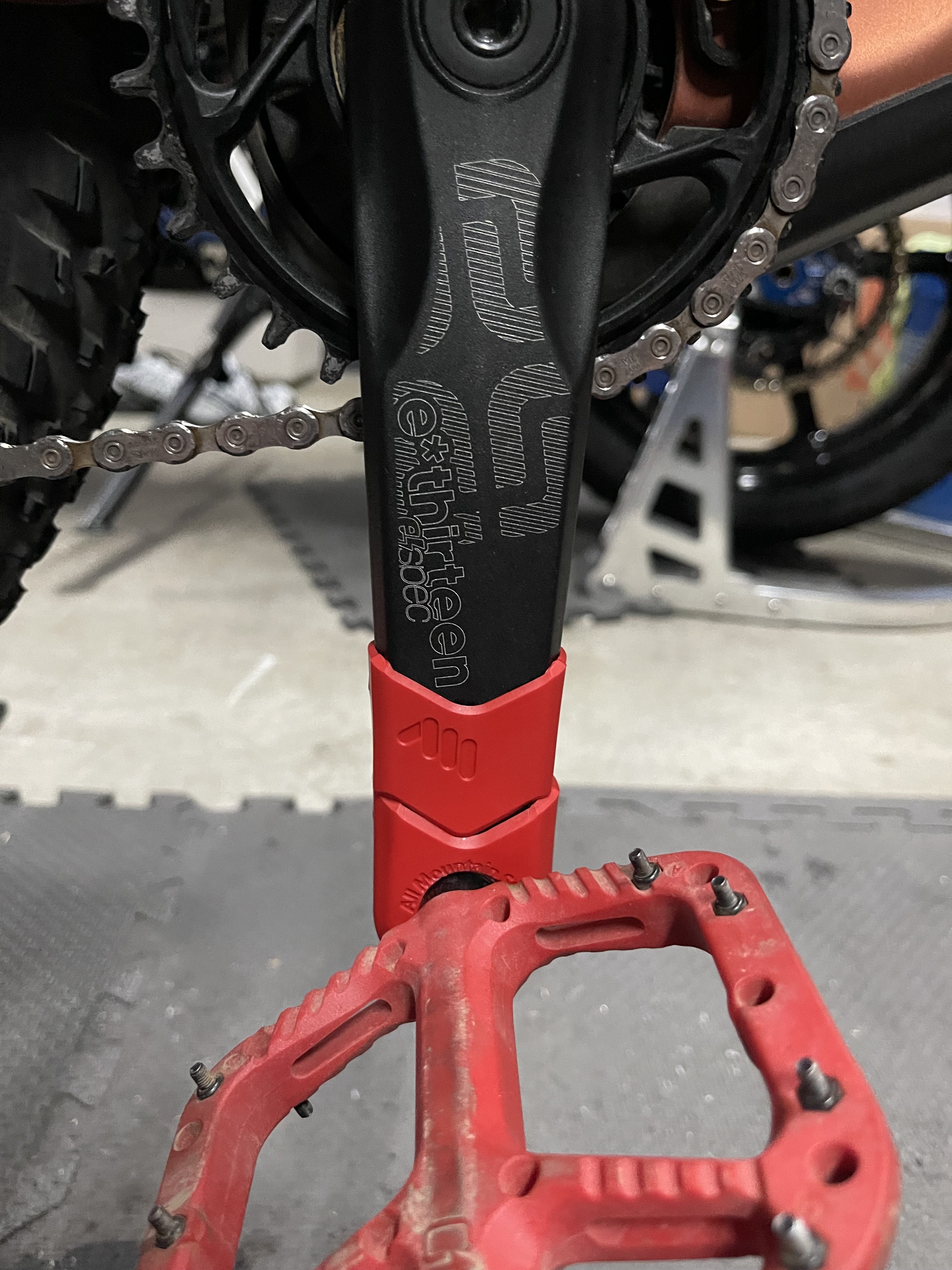

I’ve stripped the threads on the E13 cranks, the threads that the crank remover threads onto.
Any tips for getting the cranks off?
levity
Feb 15, 2018
524
1,569
SoCal
Sorry to heat that, @Dave_B :oops:
Curious as to how it happened. It might help other to know what model bike and what type of removal tool. I use a Park CCP-4 tool on my model 9.7 crank arms. Easy, breezy.
Did the damage occur during tightening the crank puller or during the actual crank arm removal? The puller just needs to be fully inserted but not tight, and there should be enough threads engaged to hold it securely enough to dislodge the crank arm when turning the removal tool.
Unfortunately, no tips than using some type of gear puller as suggested by @Emailsucks98
I have the two piece E13 crank tool, I didn’t screw one piece in sufficiently so it stripped the threads rather than pulling the crank.

Got the cranks off with the proper tool 👍
