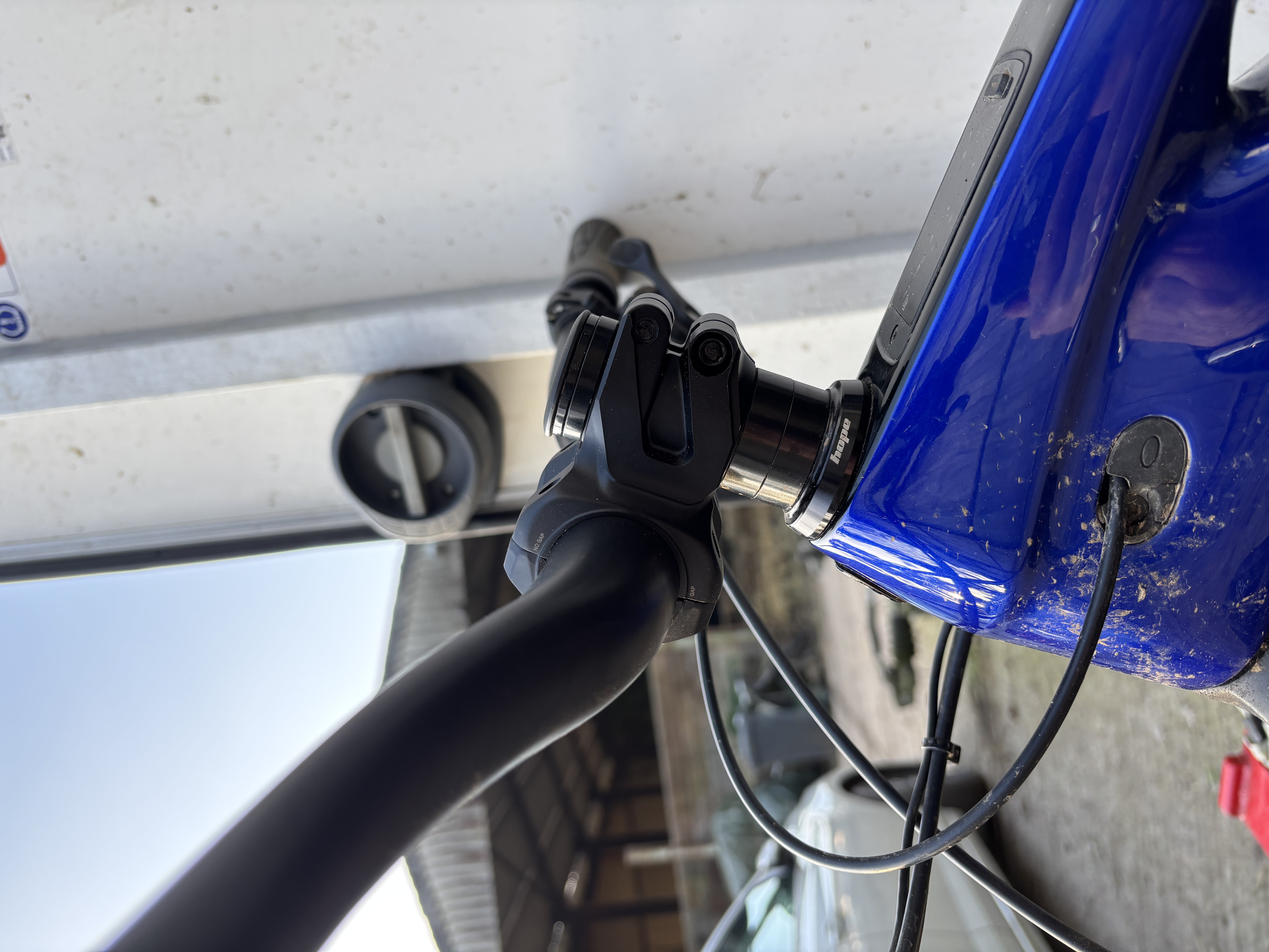

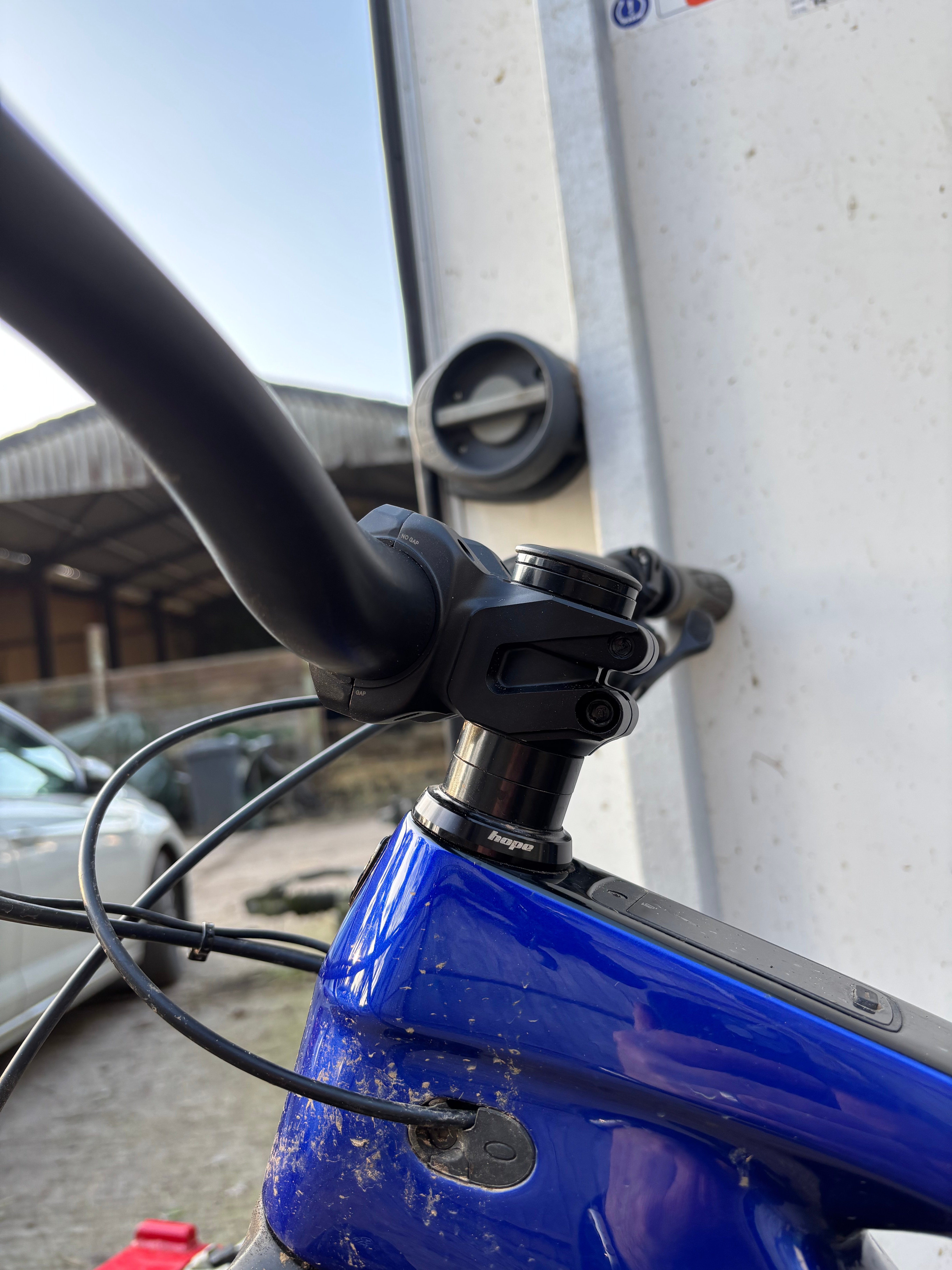

So today had some time so had a bit of experimenting. Firstly my bars were 20mm rise running 2x10, 1x5 and 1x3 spacers.
Borrowed my mates OneUp 760mm 35mm rise bars with 42mm stem. Made no changes to spacers and it still feel a bit too high and too narrow.
Moved the grips and controls out a cm each side to make it feel like 780mm. Experimented with spacers and felt best with 2x10 under the stem.
Only issue is the random top spacers having to use. Going to ride over the weekend with this set up and if it feels right with order some 35mm rise bars and chop em to 780. Also will chop the steerer down to make it nice and tidy once I definitely know the right set up!

Give it some time to feel right. Don’t chop the steer tube. You can’t put it back. Put the spacers under the stem and again give it sometime to feel good. It will given time.

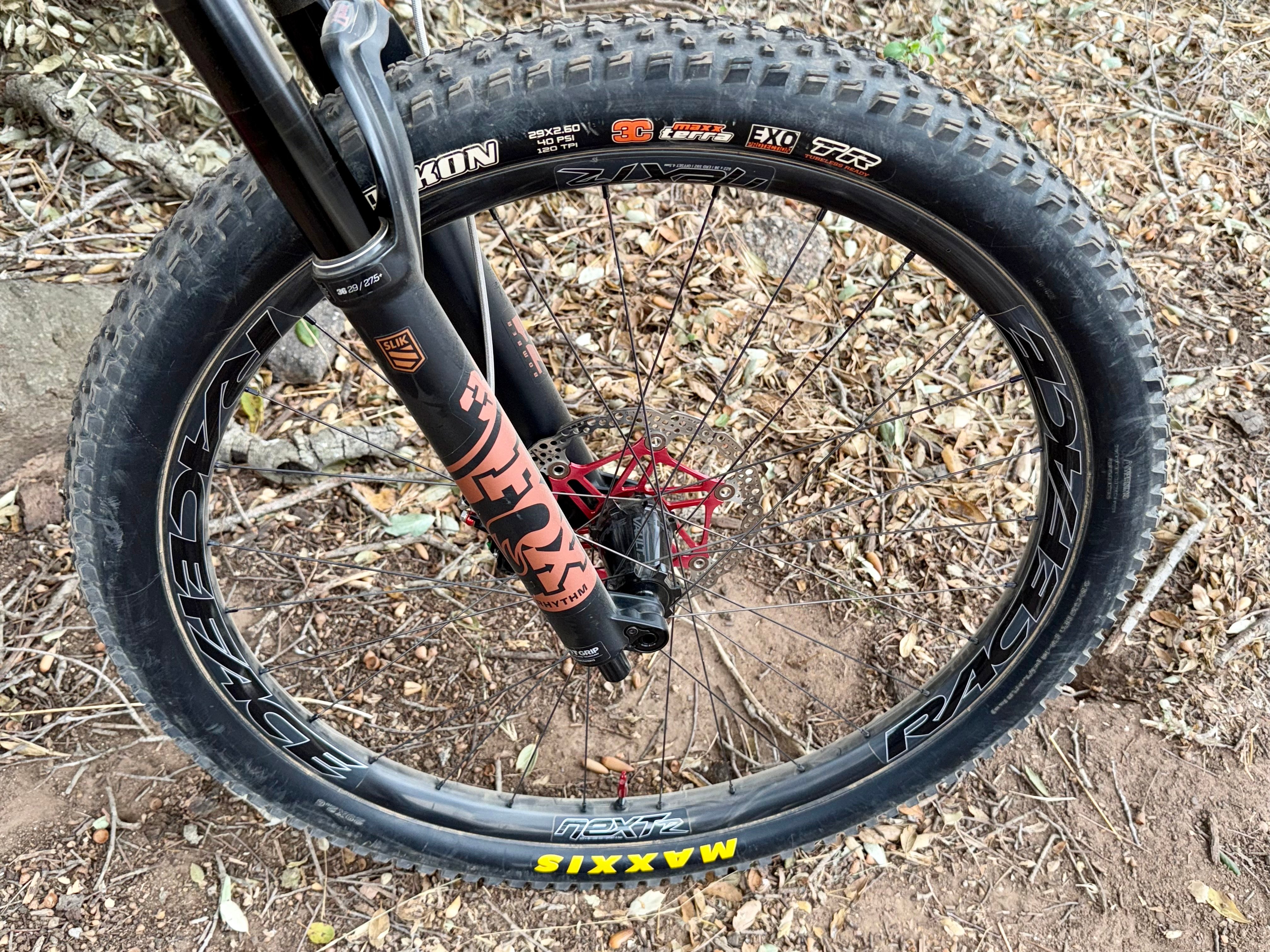

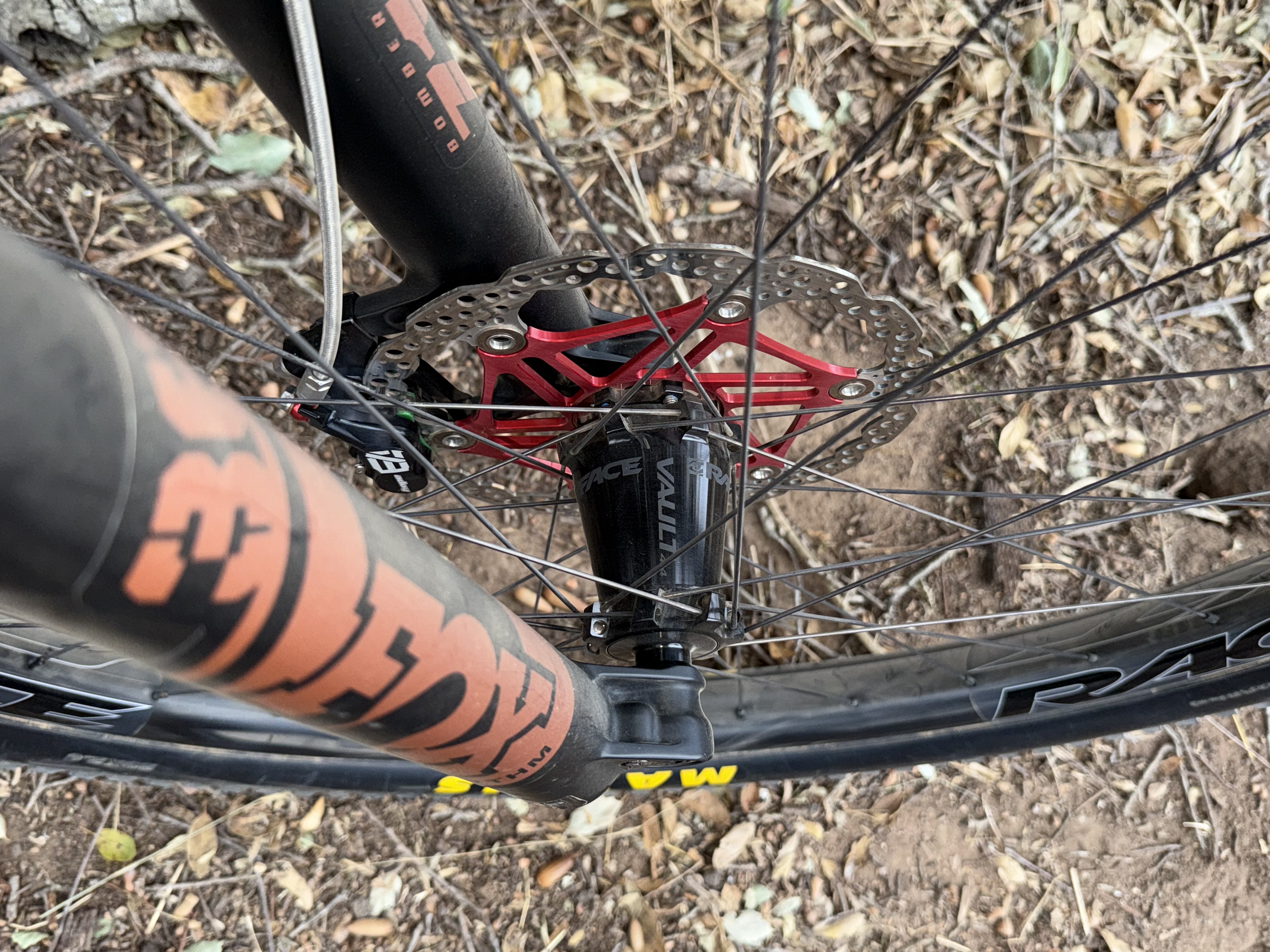

What size tyres people running? Got some 2.4s on and they seem super narrow on the bontrager rims
2.6 Recons front and rear on Race Face Next R 36 wheels. PSI is 17 front 19 rear. I love it!
