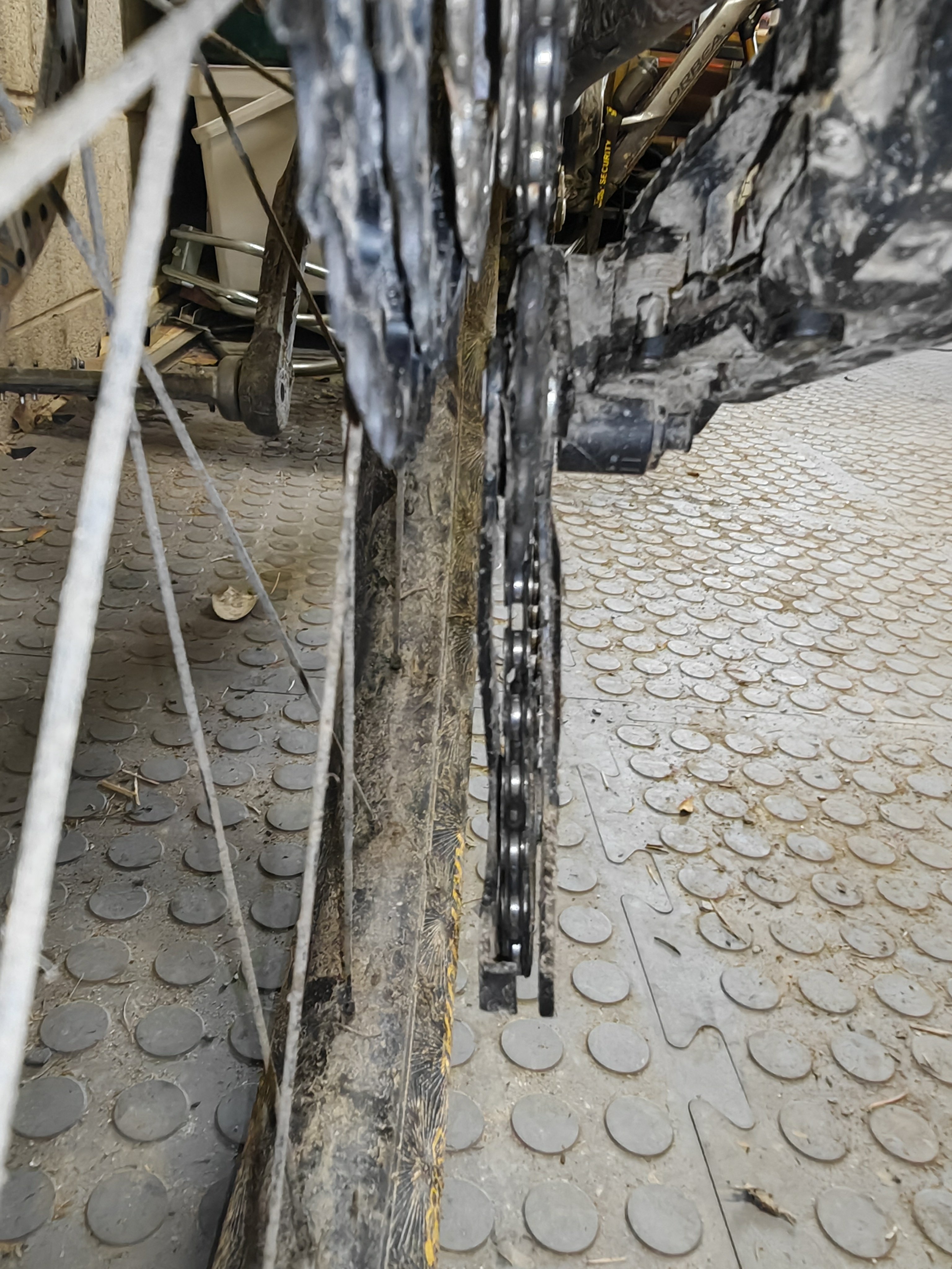

Absolutely right. I forgot, since I've only been living in the SRAM world since 2017 ;)
The thing with the jockey wheels is a great idea 👍
You have to shim on the right side to go further to the left..?
How many spacers do you use and by how many millimeters do you move them?
You probably also used a longer bolt screw. How long is it?
Actually you only need to shim the upper jockey wheel. Did you shim the lower one too?
Do you have any photos?
Here's a picture, you can just see the silver washers on the right hand side of the jockey wheels

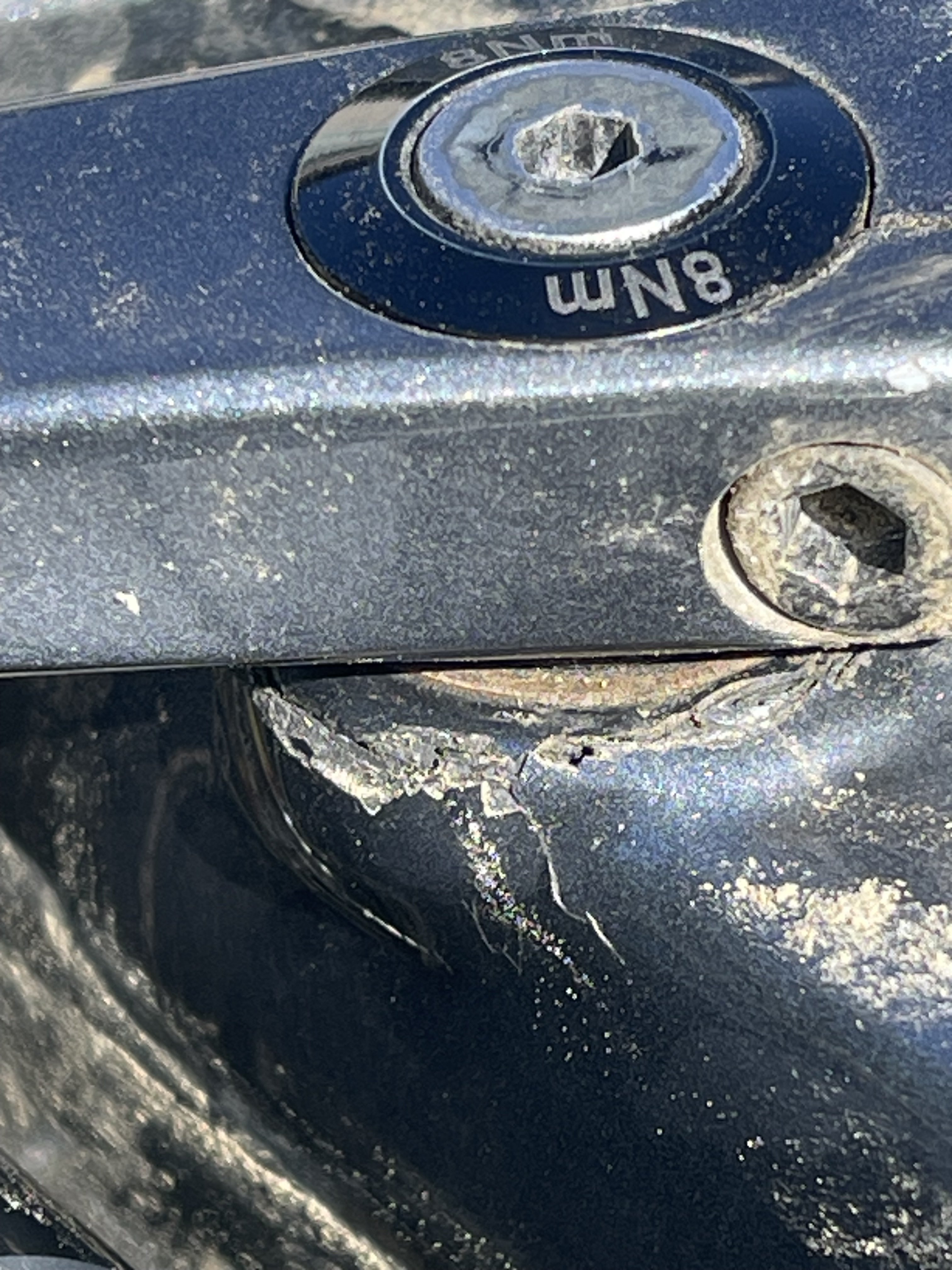

Discovered a knocking noise in the suspension of my 9.7. Upon further investigation I tracked it down to a cracked seat tube pivot bearing housing. Will need a new front triangle. Bike is with Trek dealer for warranty claim. Will update as things progress IMG_2150.jpeg

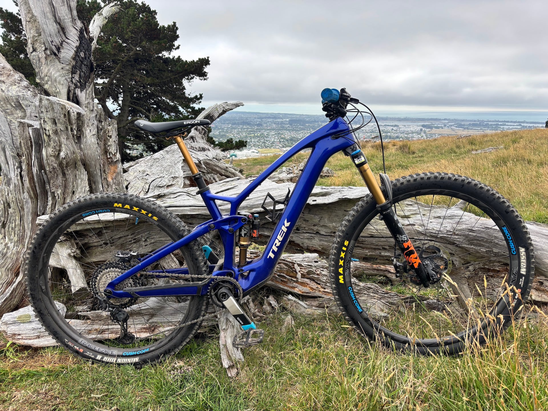

I’m now the proud owner of an EX-e. Look forward to posting some pics and details soon.
Started life as a 9.5 frame
Fox 36 factory
Fox Float X factory
Fox Transfer factory 175mm dropper
Shimano XT 12 speed drivetrain
Shimano XT M8120 brakes
Raceface Next R 31 carbon rims
Raceface Era carbon cranks 165mm
Ergon SME Pro team Ti rails
Trail one Rockville stem - Ti hardware
Trail one Crockett carbon bars
Trail one hells gate grips

Discovered a knocking noise in the suspension of my 9.7. Upon further investigation I tracked it down to a cracked seat tube pivot bearing housing. Will need a new front triangle. Bike is with Trek dealer for warranty claim. Will update as things progress View attachment 153416
Update. Trek are replacing the frame. I was told it could be a 3-4 week wait as the replacement is coming from the US.
