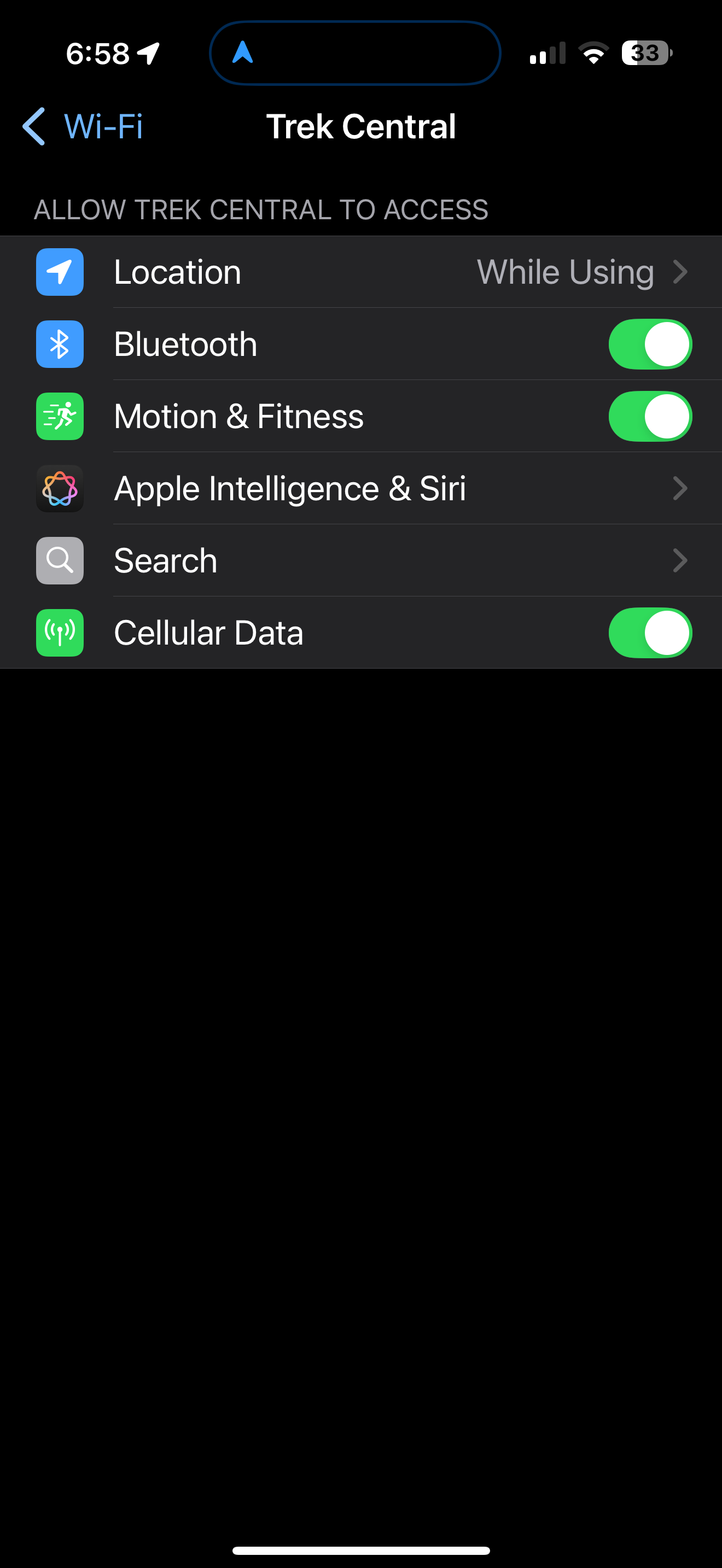

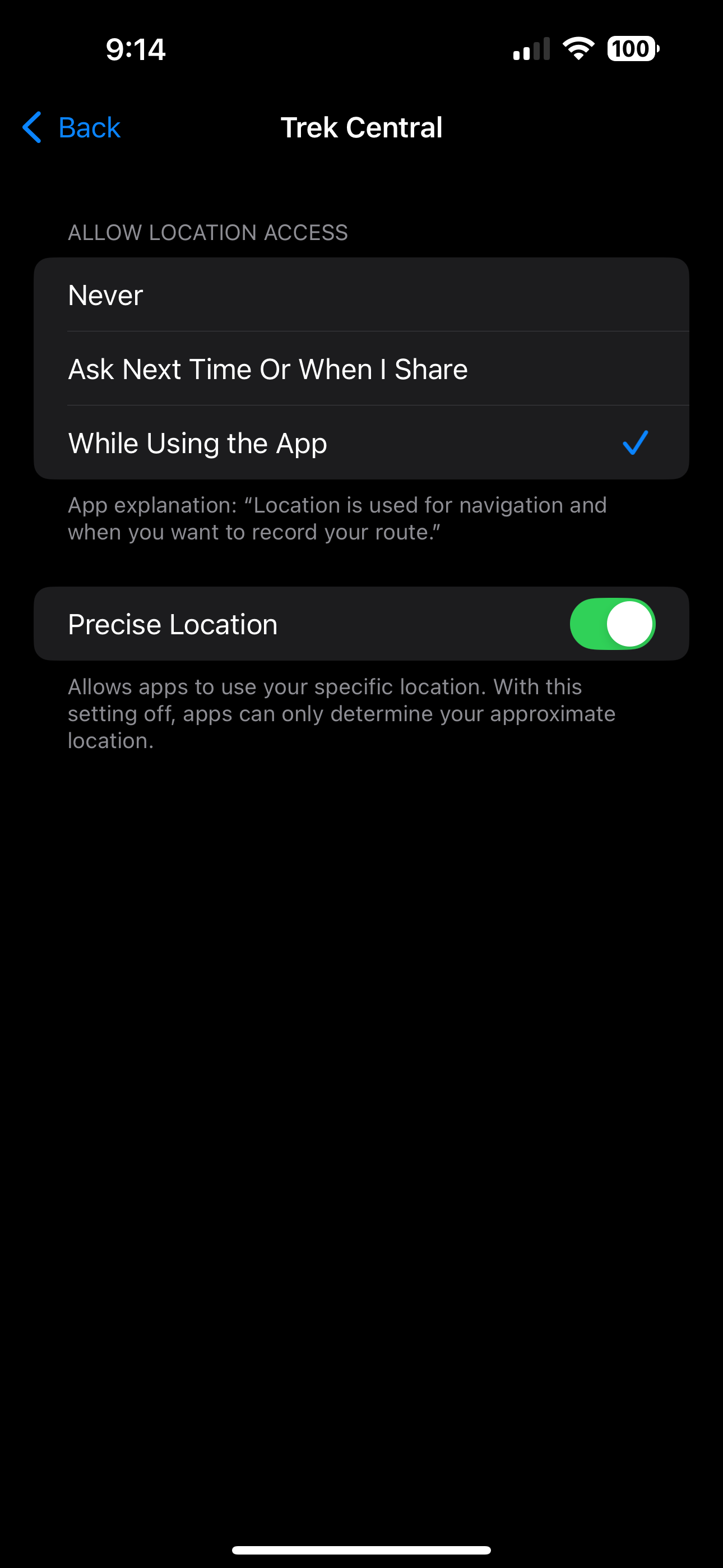

Has anyone out there had the Trek Central app stop recording your rides? I’ve tried everything to get it to work. My software is up-to-date, I deleted the app and reinstall it on my iPhone, I deleted its Bluetooth from my iPhone and reconnected it, I’ve reset the bike and I keep the app open and connected while I’m riding. When I stop a ride on the app that is being recorded, it says something like, insufficient data. Everything else works, along with the odometer and hour meter, just not the ride tracking.
Check the cache is empty after reloading. You could also try deleting all data but you will lose your recorded rides.
JP-NZ
Feb 17, 2022
1,321
1,034
Christchurch - New Zealand
Have you checked under privacy, allow precise location?
