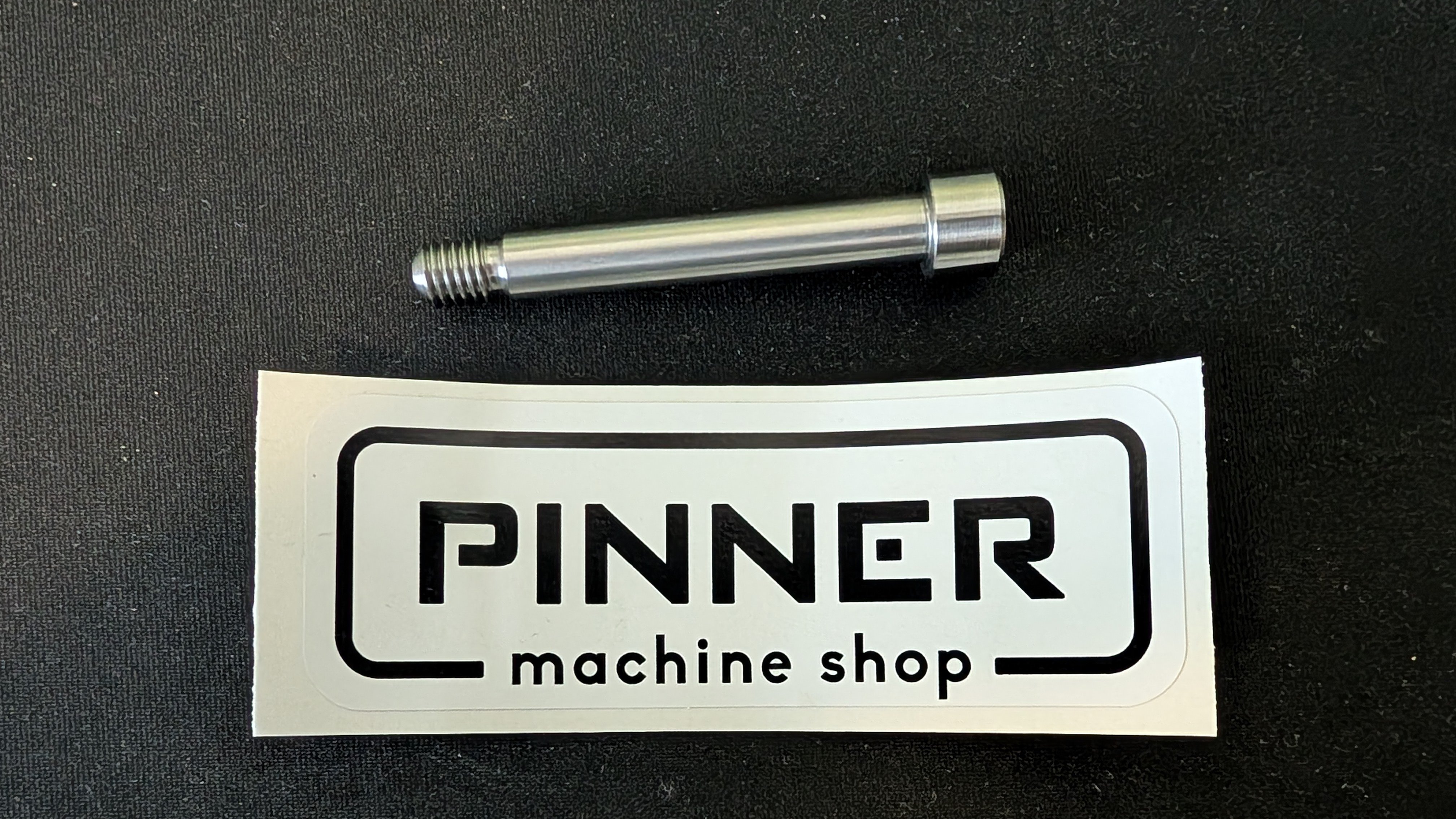

Shock bolt solution in Canada !

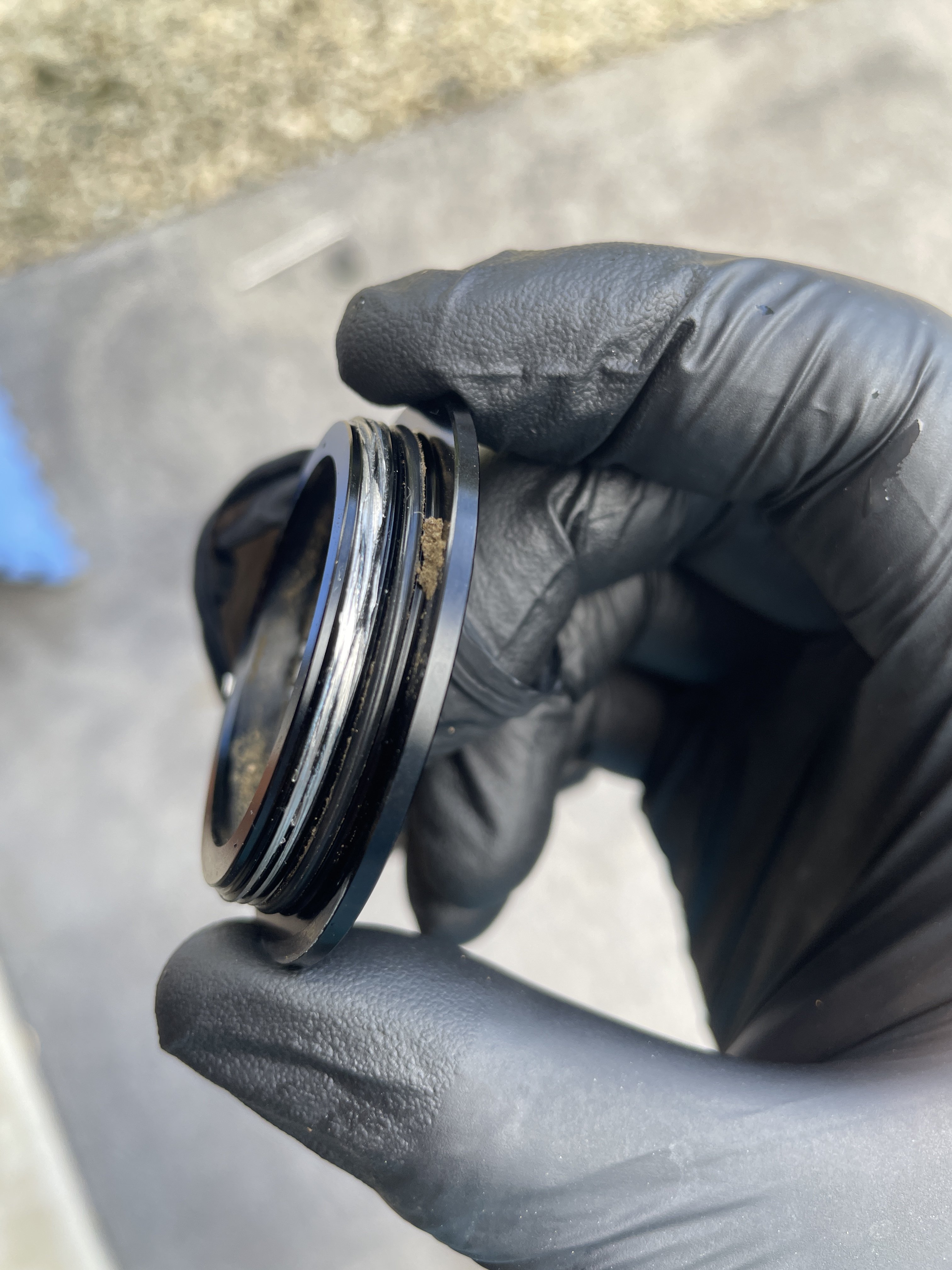

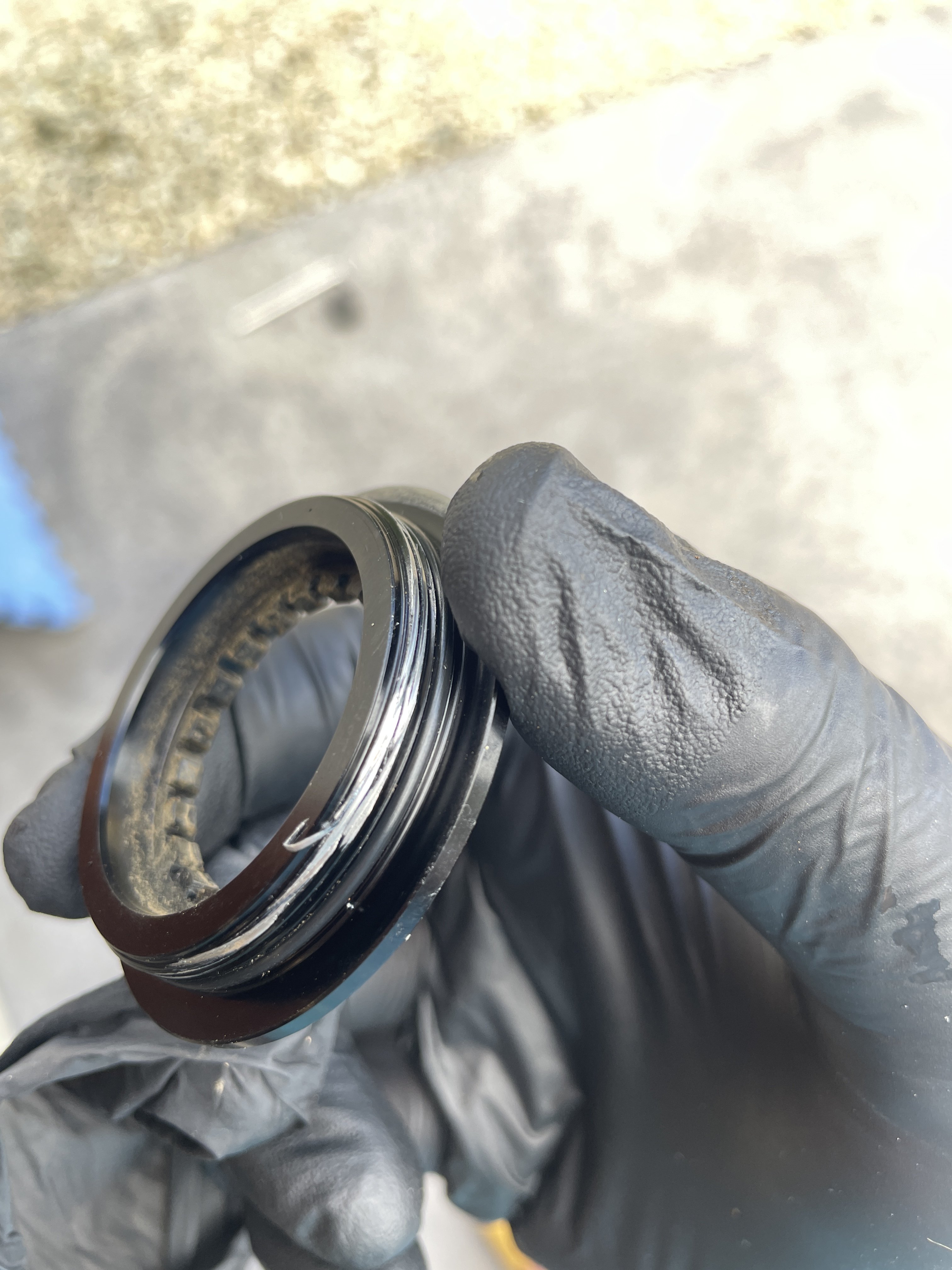

So my Fuel Exe has been clicking around the motor area. Based on other comments I dropped the motor out of the frame to see if there was any play between the motor and frame. It seemed pretty snug (btw I do t actually have motor compensation screws). Put the motor back in and torqued the motor bolts to be one as spec’d. Clicking worse than before.
So I just removed the cranks and chainring. The chainring locknut had been crossed threaded. Pretty pissed off.
Who would have fitted this part? Factory or bike shop?
Cheers
Johannes
Aug 13, 2024
9
7
I had the same happen to mine. As far as I remember the crankset was mountedin the box from the factory. So I assumed that mistake happened at the factory. The lockring got replaced by Trek with no issues.
But that thread pitch is so small that is easy to crossthread.
mctubster
Jul 18, 2023
12
Nelson, NZ
Thanks. They are warranty processing it, 2 week wait :(

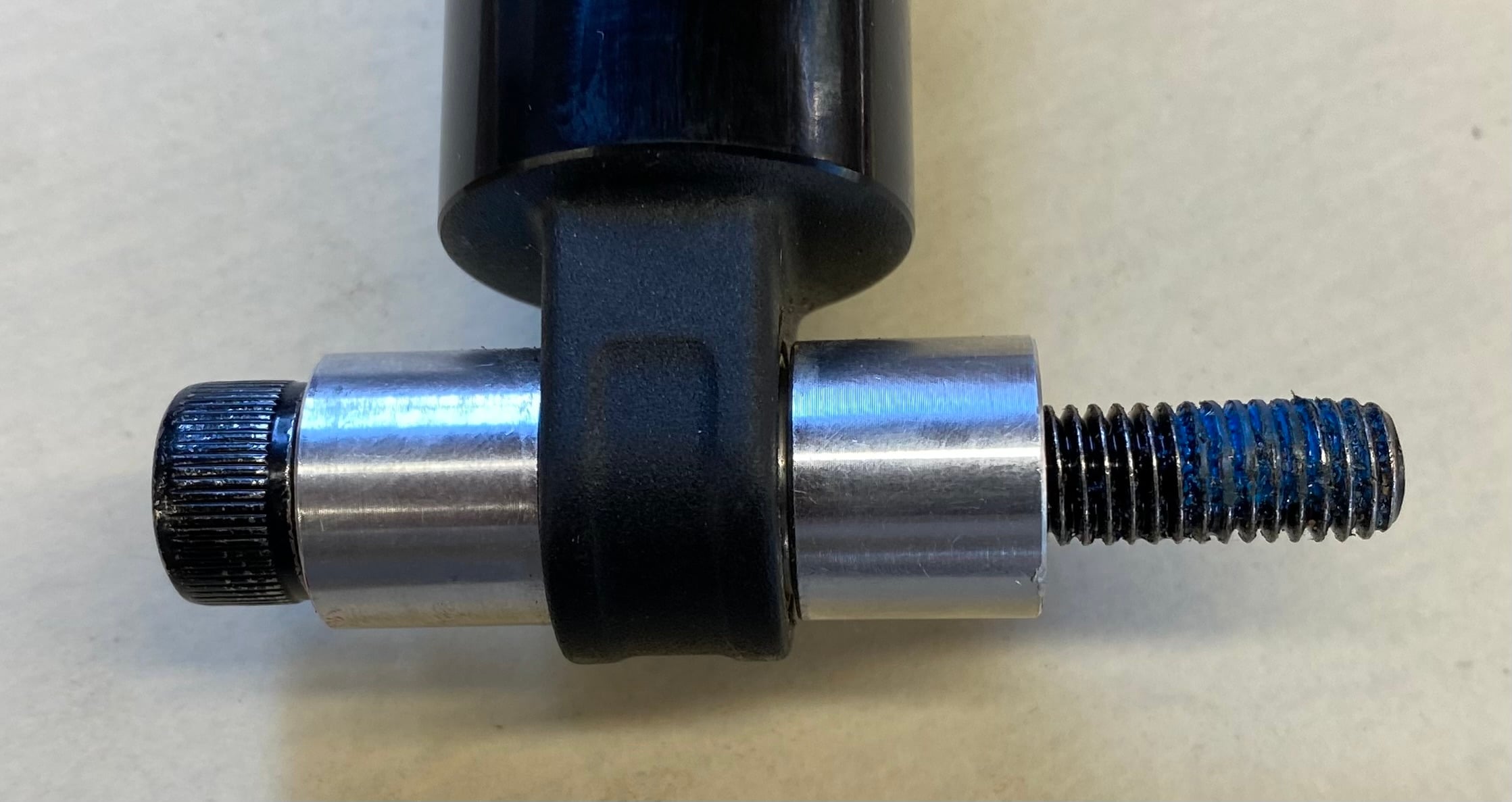

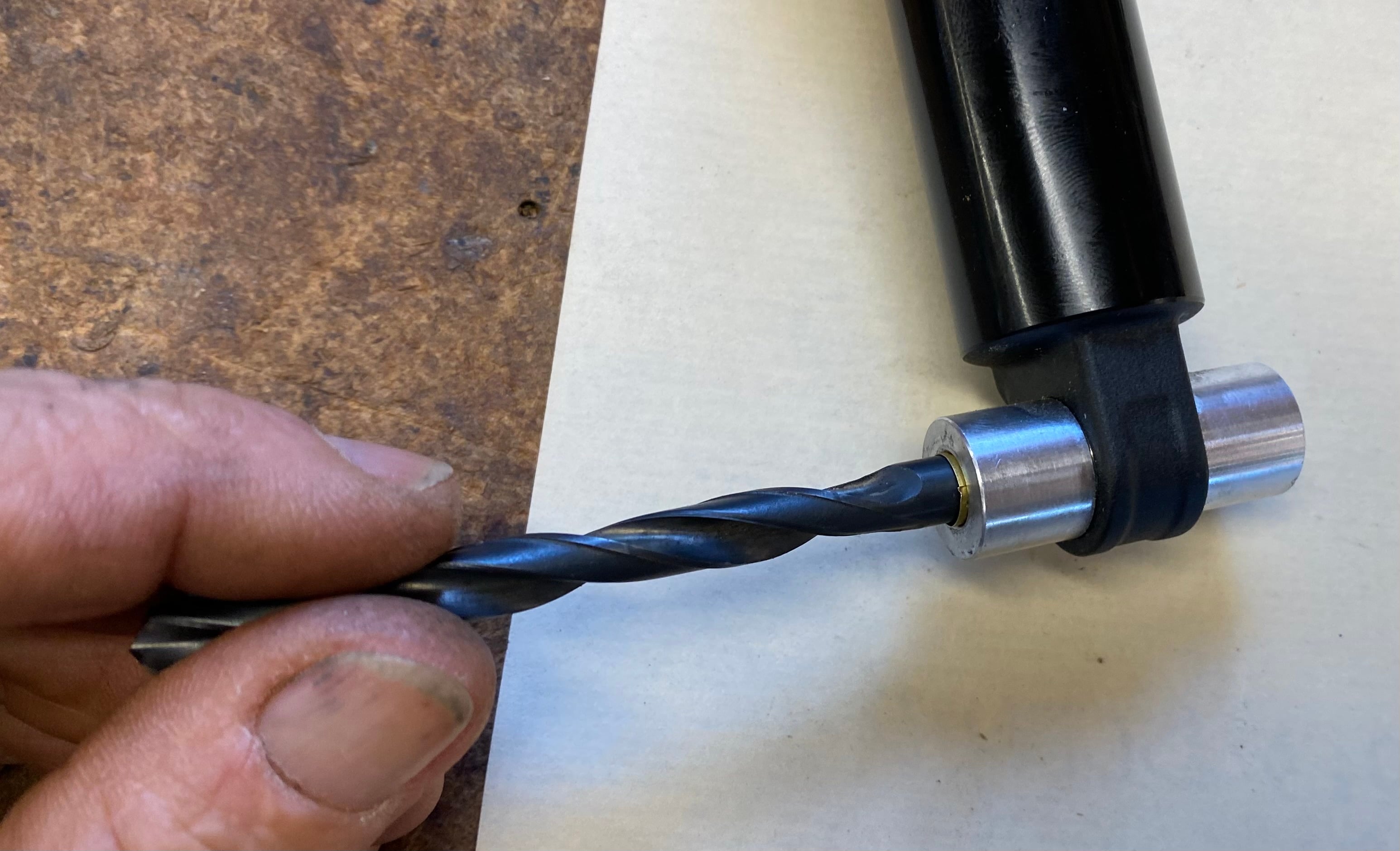

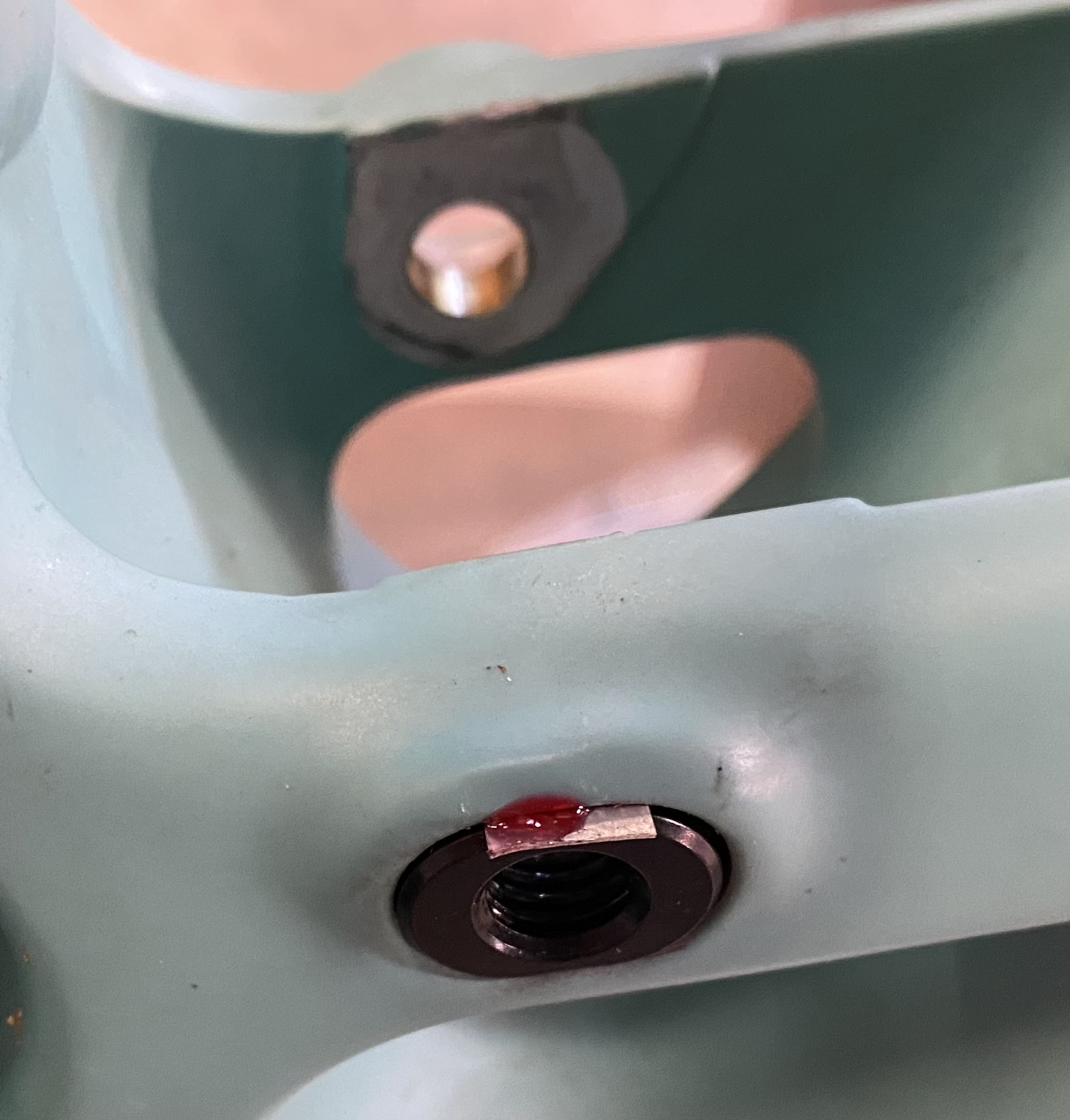

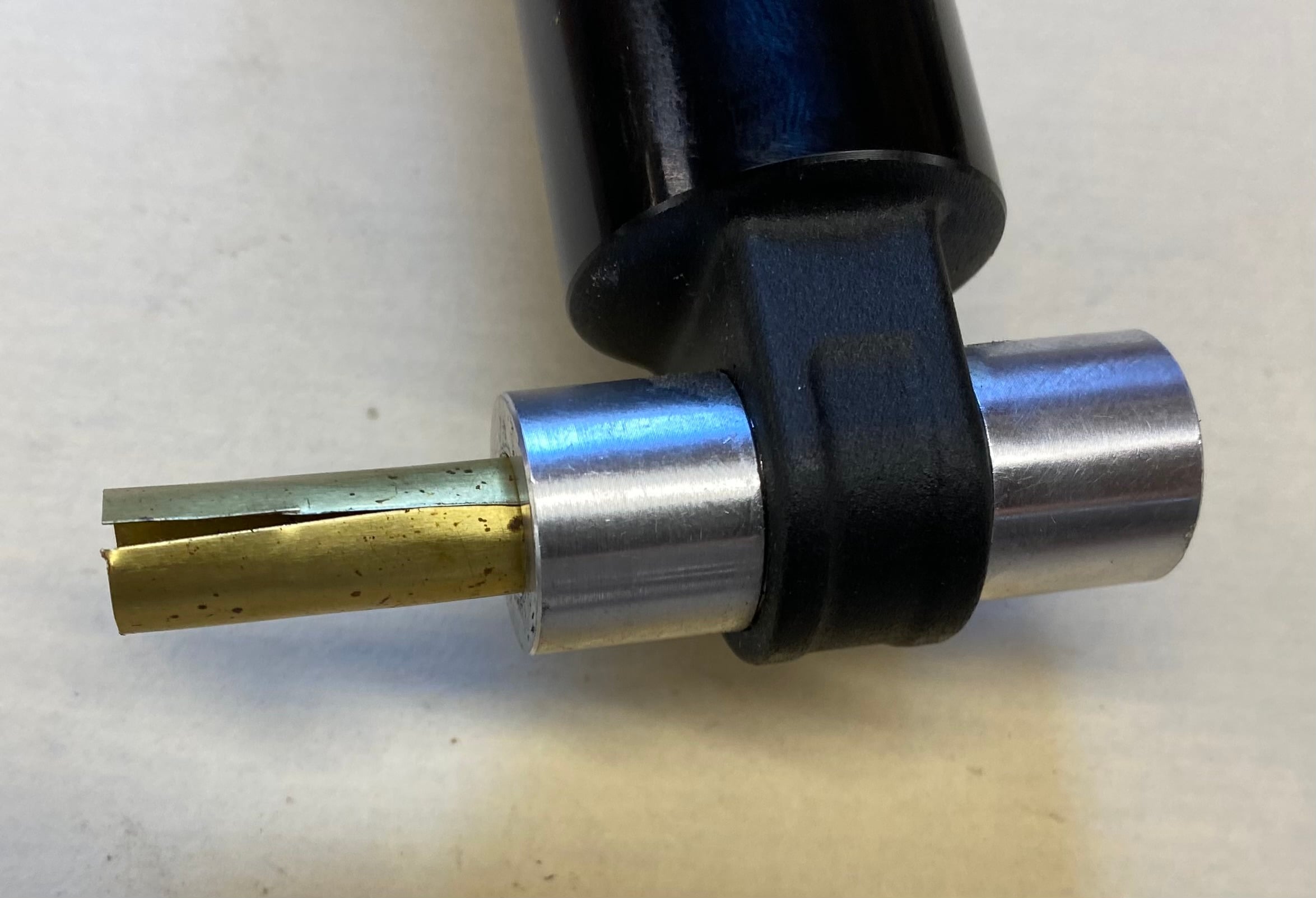

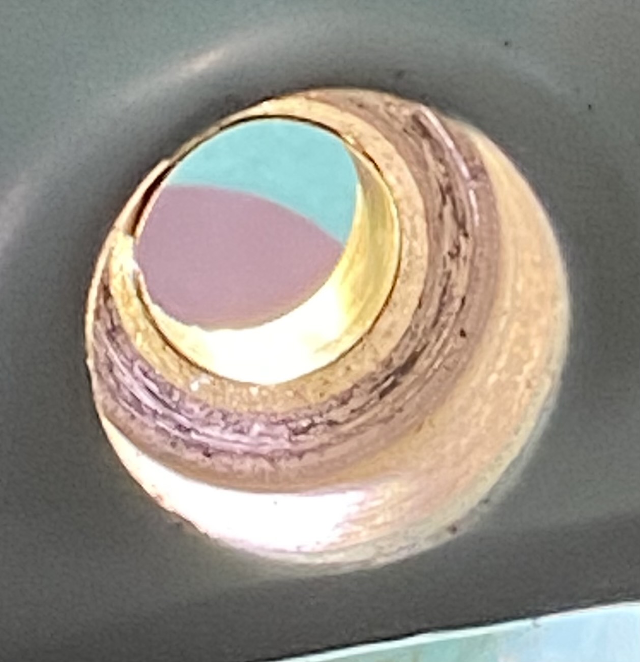

New member here and I've just finished reading/skimming this entire thread. I recently bought a new Fuel EXe 5 alloy which I love, and after reading all the comments about play in the lower shock mounting I decided to check my bike. I found there was a whopping 0.013" difference between the bolt and the left frame hole, about the same between the oval nut and the right frame hole, and 0.008" between the bolt and the shock bushings. Even with a custom bolt of full 8mm diameter, I would still end up with 0.006" clearance in the frame holes. While I don't have enough miles on my bike to have seen a problem develop, I like to tinker so for fun I addressed the sloppy fit using brass shim stock. First I cut a small strip of 0.006" brass to line the left frame hole, first wrapping it around a small rod to form the circle then sliding it into the frame with a bit of red Loctite on the outside surface and pressing in place with a wooden dowel sized to match the shock bolt.
Next I cut some 0.004" brass and formed a sleeve for inside the shock bushings, again anchoring it with red Loctite and keeping the Loctite away from the joint in the brass so it would not lock the bolt in place. I first pressed the brass into place with a letter N drill which is a little smaller than the shock bolt, then carefully pressed the shock bolt in place and let it sit a couple of hours while the Loctite cured.
Lastly I used a thin aluminum shim to take up the gap between the oval nut and frame on the right side. The photo shows it before pressing all the way in.
This may seem like a bit of a barnyard repair but it was a fun little project and the shock bolt ended up with a precision fit to both frame and bushings.
