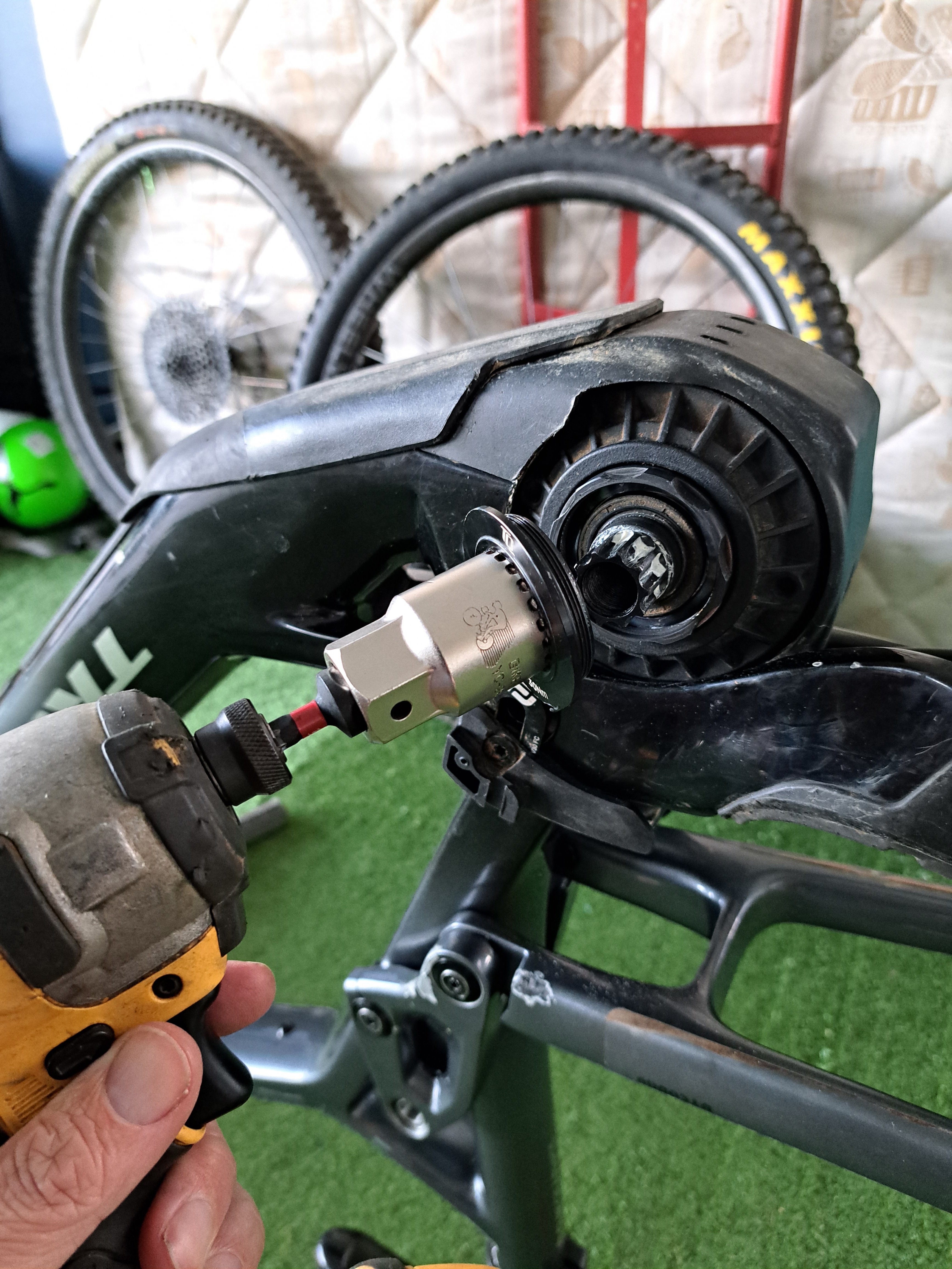

Newsflash! The impact driver works perfectly to remove the locking when you do it up to 50NM with no chairing on community. Thx to all who shared their thoughts to solve this. Without you mob I'd still be cursing my misadventure so thanks a bunch! View attachment 117055
Hope nothing else rattled loose. Congrats on the fix, glad it worked out for you. If something else goes wrong.....Just don't tell Trek about the impact driver and warranty will be perfect.

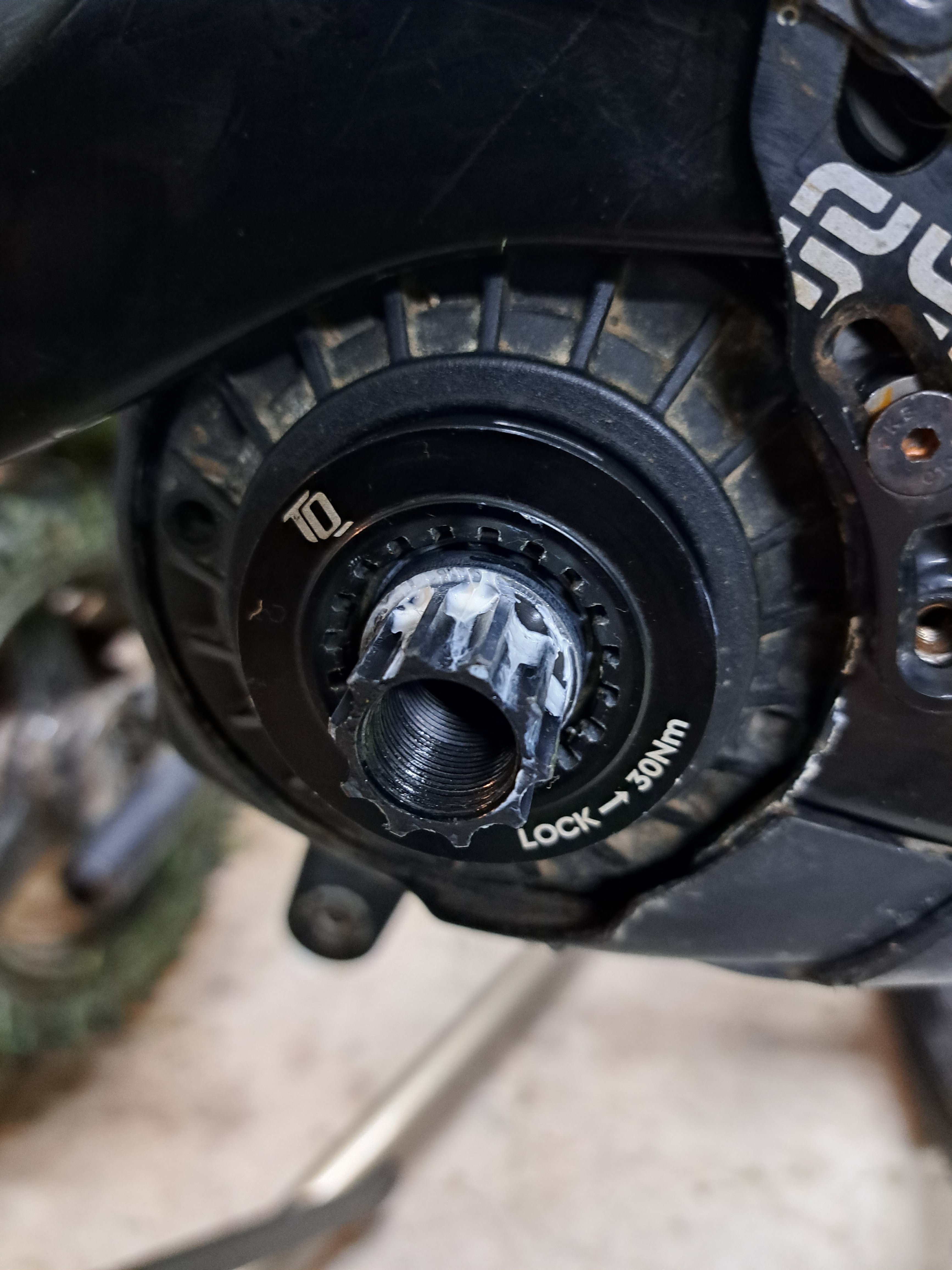

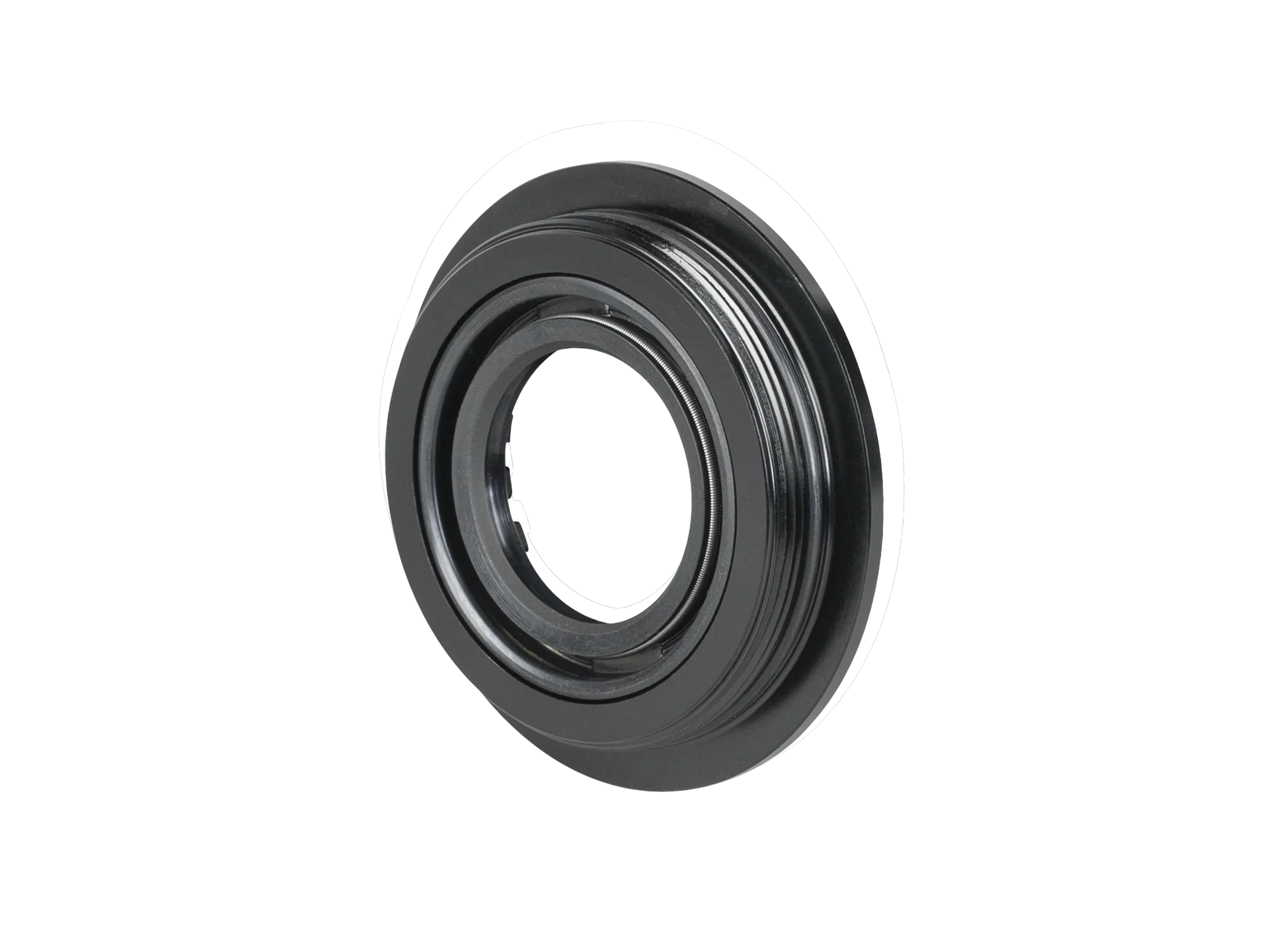

I'm noticing you have dirt or dust in there. Since you have the older lockring with the 30nm stamp on it, you might want to check you are not missing the rubber seal inside the lockring. I remember someone posted here they were missing the seal.
Here's a picture of the seal:
