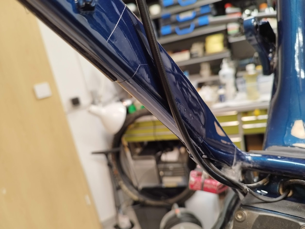

A quick update from my EXe:
Since I take very care of the frame, I used a protection film.
After my first long tour, I checked again for chafing spots. And found some:
I placed some slapper tape on the main frame, between the link.
The sensor cable was chafing.

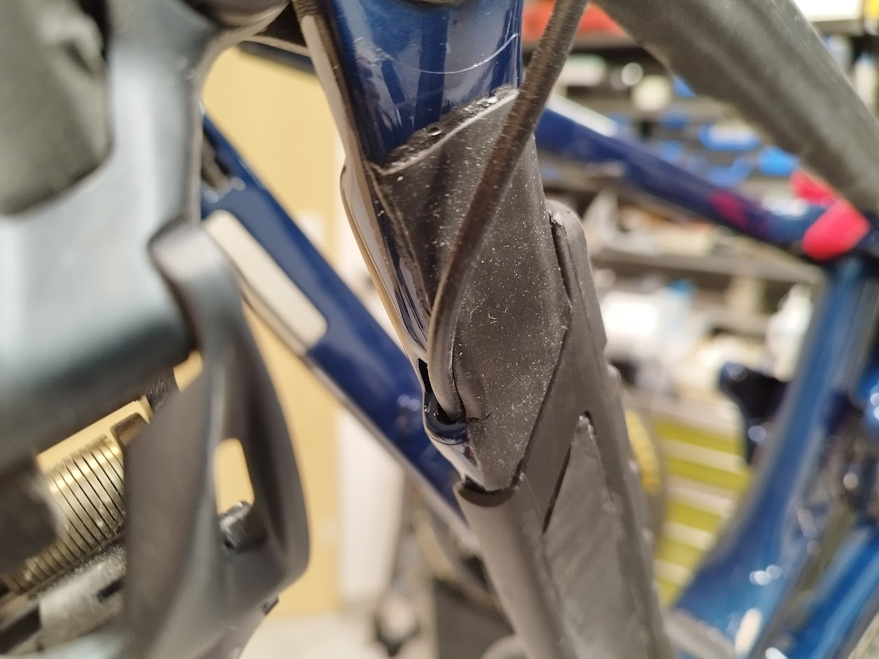

Second charf spot is the rear brake line:

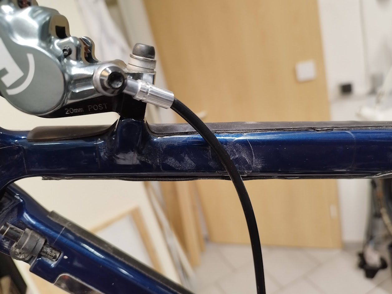

Charing spots on the lower and upper chainstay.
I used a second layer film. Should last a while.
(of corse I used cable ties, the pic is done without and then tied up again)

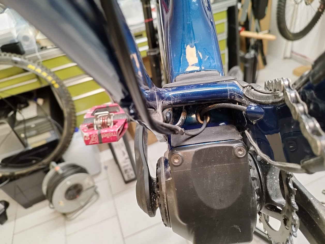

Third is the AXS Cable:
This is not a mayor problem.
I used some more slaper tape....

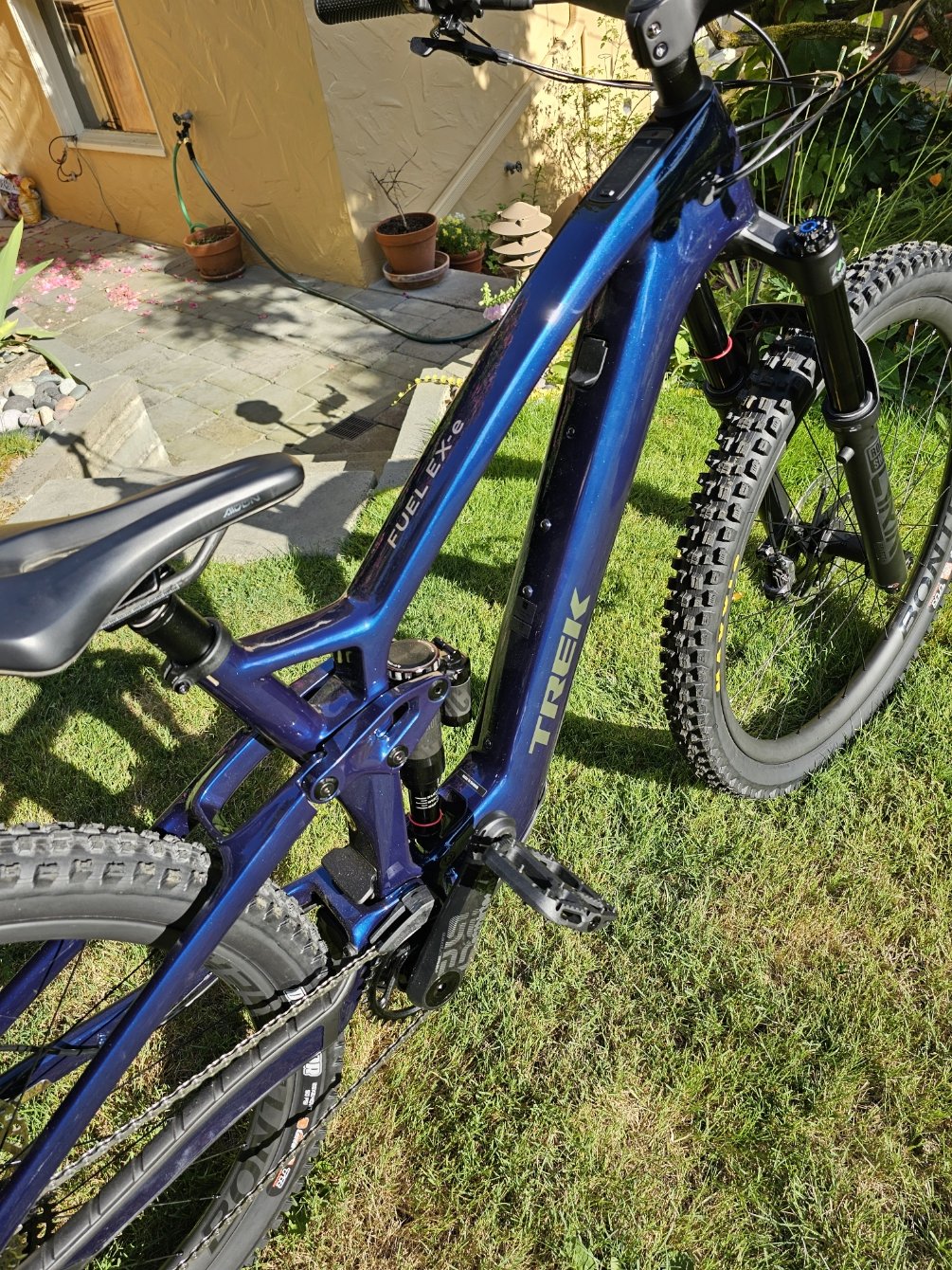

Picked up my Fuel EXe 9.8XT in beautiful Mulsanne blue on the 11th!
Demoed an EXe 9.5 a few weeks ago and did a 3000 ft day on Tiger Mountain near Seattle, took it down a bunch of super chunky black trails with a few jumps and flowy sections. Absolutely loved it even with the base model spec. The power delivery of the TQ is stunningly natural and it really did feel like I just had superpowers climbing instead of a loud motor with lots of overrun pushing me up the mountain.
The next weekend I demoed a Transition Relay on Galbraith and hated it - it was too heavy (like 50 lb in the PNW mullet/Fox 38/coil build), the Fazua motor is super clunky with unrefined power delivery and terrible controls, and the bike rattled really bad. After only a short amount of time on that bike I had made my decision on the Trek. The PNW build was $11k and had alloy bars, cranks, and wheels compared to the carbon on the 9.8XT build for $2300 less. Sure it had the new Sram transmission but it did not feel revolutionary enough for the additional cost.
As soon as I got the new EXe home I swapped the dropper for a 180mm OneUp which is significantly improved over the 150mm Bontrager, and swapped the SE5 tires for an Assegai 3C MaxxGrip front and Dissector 3C MaxxTerra rear tires with a Cush Core XC in the rear. Currently waiting on a full tailored Ride Wrap to be shipped so I can worry a little less about scratching/chipping the new paint. Already ordered a 160mm air spring for the Lyrik so I can try out the bike with 160mm front and possibly 150mm overstroked rear travel (that voids the warranty right? Not that they have to know...).
Only issue I've had is creaking from the motor/bottom bracket when pedaling - something I've seen mentioned earlier in this thread so I'll be bringing it to the Trek shop nearby to have them go through the motor mounts. Oh and that I had a pretty bad OTB on my first ride when an unexpected drop came up and got a mild concussion so now I can't ride for a bit 😂

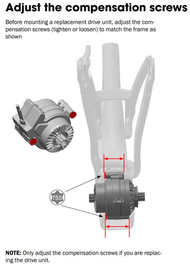

I had to adjust the compensation screws on the motor mounts. Once I adjusted the compensation screws then torqued the motor back to spec, the noise is gone entirely.
See illustration below from the owner's manual:

My 9.8xt does not have compensation screws, it has machined black aluminium inserts that are not adjustable.

Sure did, had it out a few times. I have had my bike since August last year so maybe they have since changed to the adjustment bolts. Would be great if anyone could post a picture of them so I can confirm. I am currently away on business but will post a picture of my setup when I get back for comparison
They look like machined black aluminium inserts😄
I'm pretty sure you have them. You use a torx bit in one side to adjust,I think there's only 1mm max of adjustment so they don't move by much
