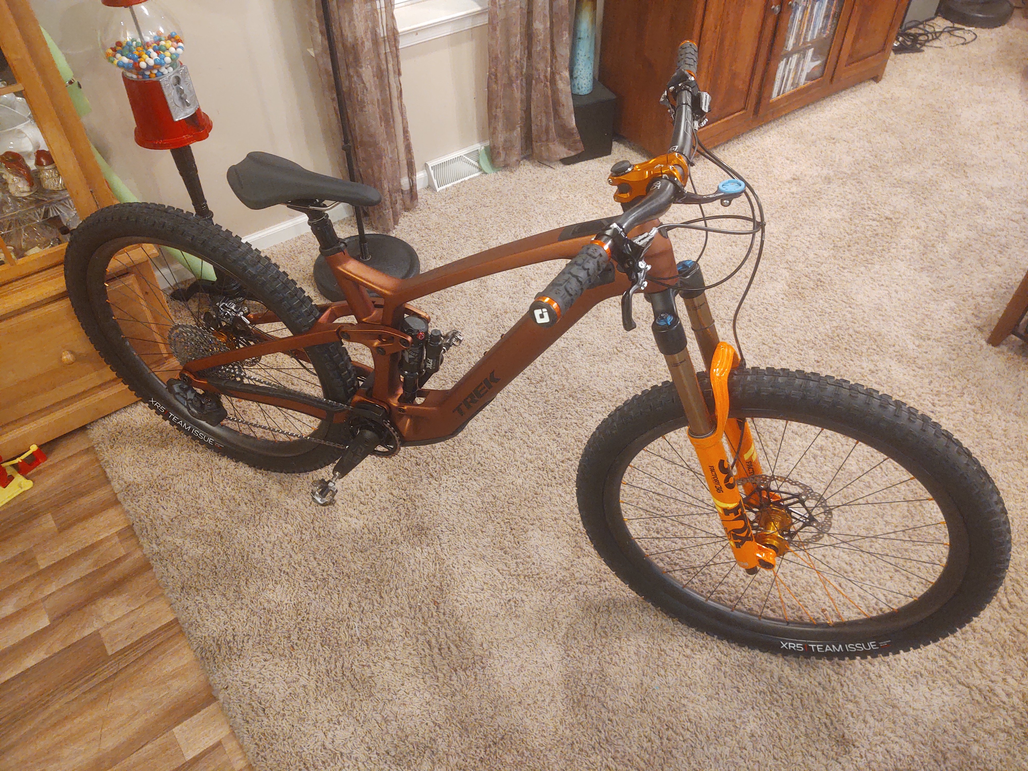

Looking to finally get out on mine tomorrow. Had no motor functionality, found it was assembled improperly from the factory!

I planned on removing all components and using the parts from my other build. Seat post, saddle, and crank arms are they only "OE" parts still on it

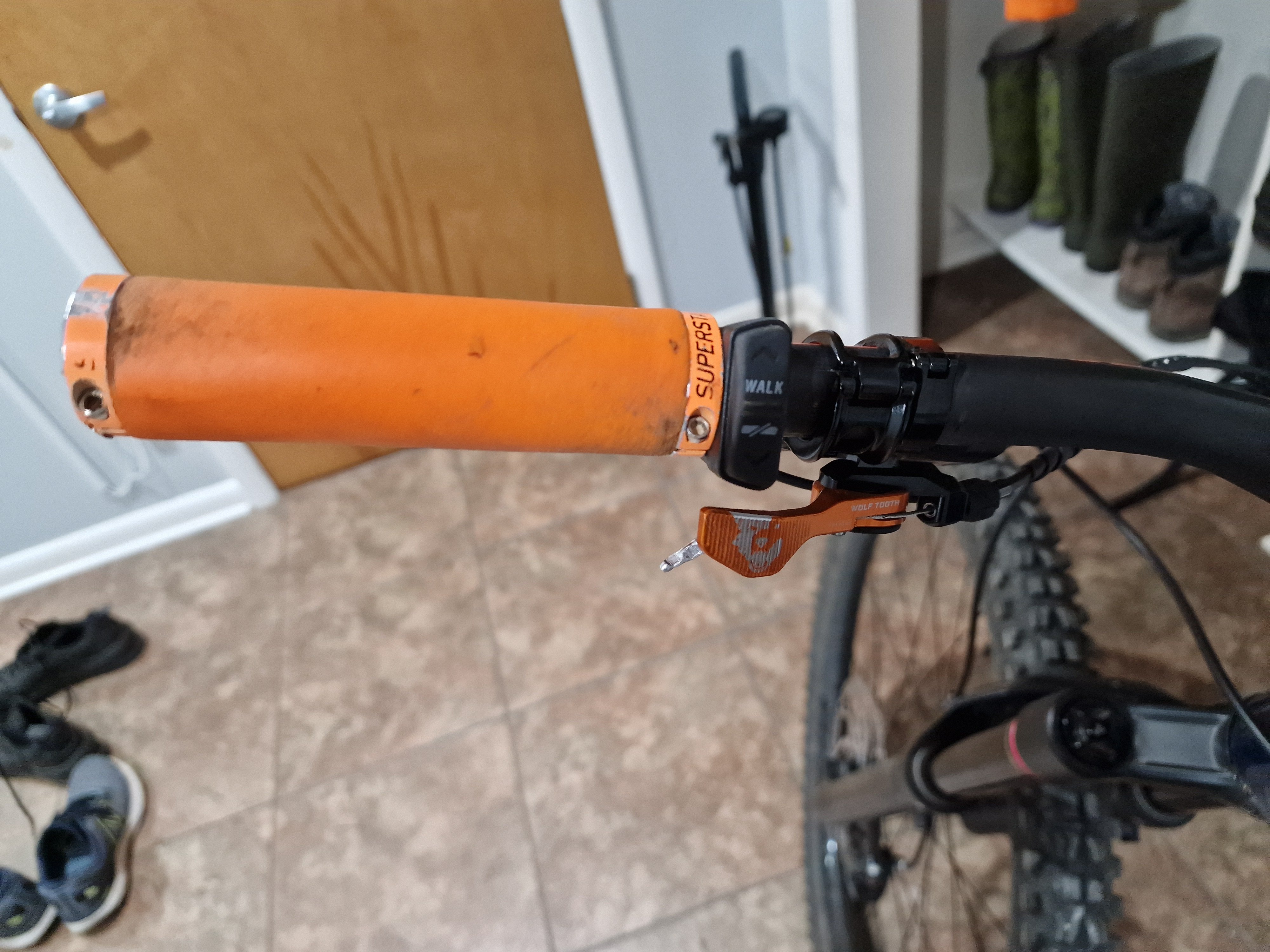

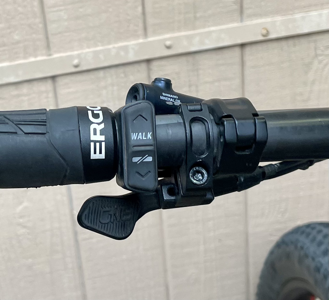

Another thing I noticed while making some adjustments yesterday - the TransX dropper post is very , very difficult to compress the release valve until you completely remove your body weight.
All of my Transfers - I can just push the lever, and they move. This one, I can feel the lever flexing, until I get take weight off the saddle, then I can feel the lever "pop" the valve. Its a Wolf Tooth lever. I wish Transfer was made in in the 34.9. Not sure if I want to shim it...

The OneUp lever works well with the TransX dropper post

One up 210 with a Wolf Tooth high leverage lever for me. The TransX worked fine but the lever is trash and the release force is too high.
Agree, oem dropper works ok but lever was real bad. I went with a Wolftooth although I wish the new Hope had been out when I was buying.

Agree, oem dropper works ok but lever was real bad. I went with a Wolftooth although I wish the new Hope had been out when I was buying. View attachment 119063
I have a Wolf Tooth installed. It's not a lever issue. If I push the dropper lever with my weight on the saddle, the lever will not activate the dropper. If I hold pressure on the lever, but then take my weight off, I can feel the actuator pop, and then I can lower the seat.
Weight off, it's just like any other dropper.

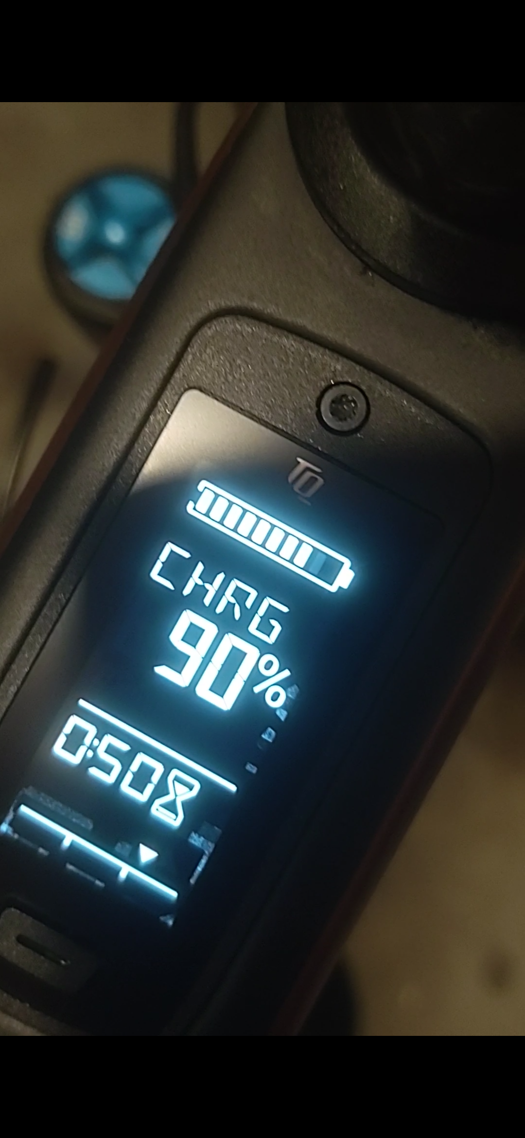

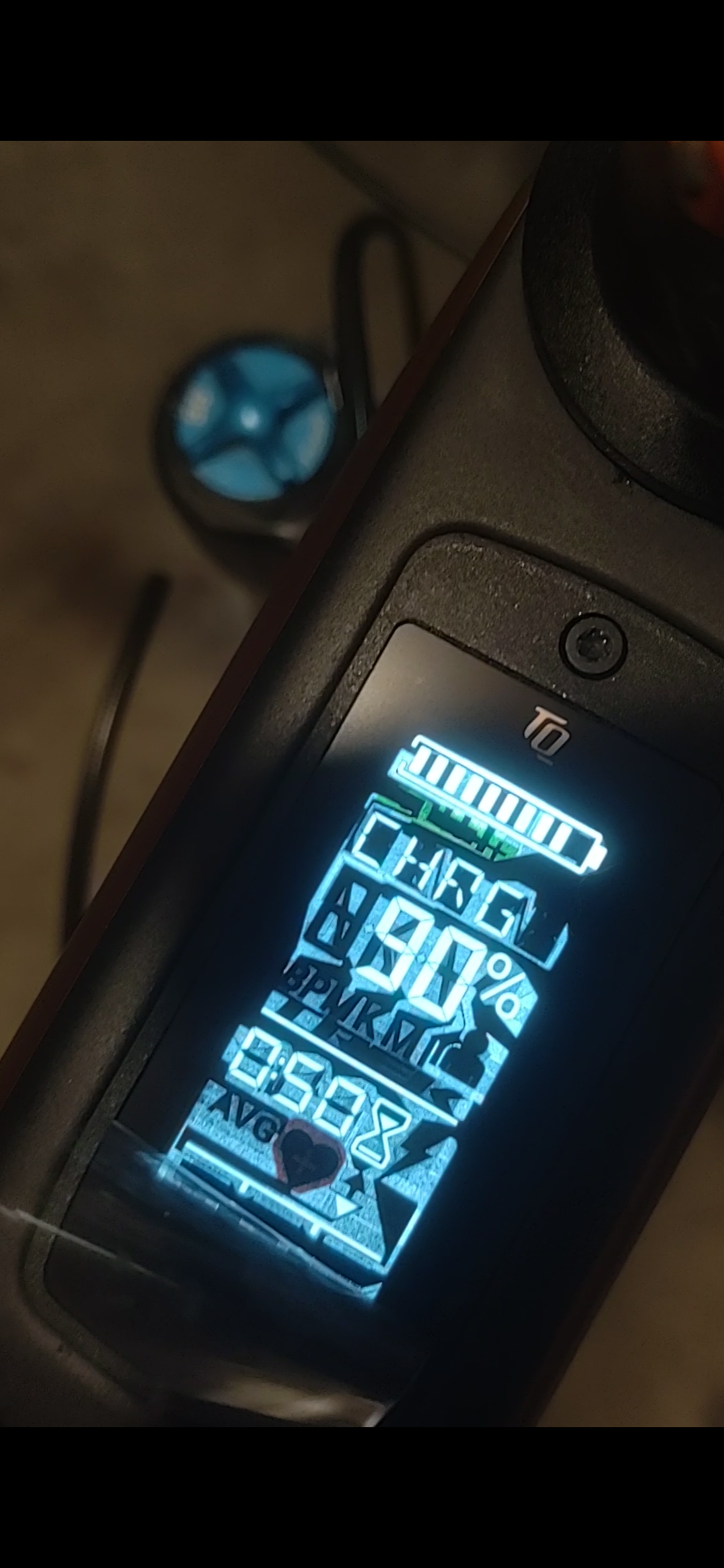

I wonder what else the system can do. I think I'd like to get the AXS power cord, and if the system can detect heart rate....that would be great.
When I was removing my screen protector cover, the screen went bonkers, and showed all sorts of symbols!
