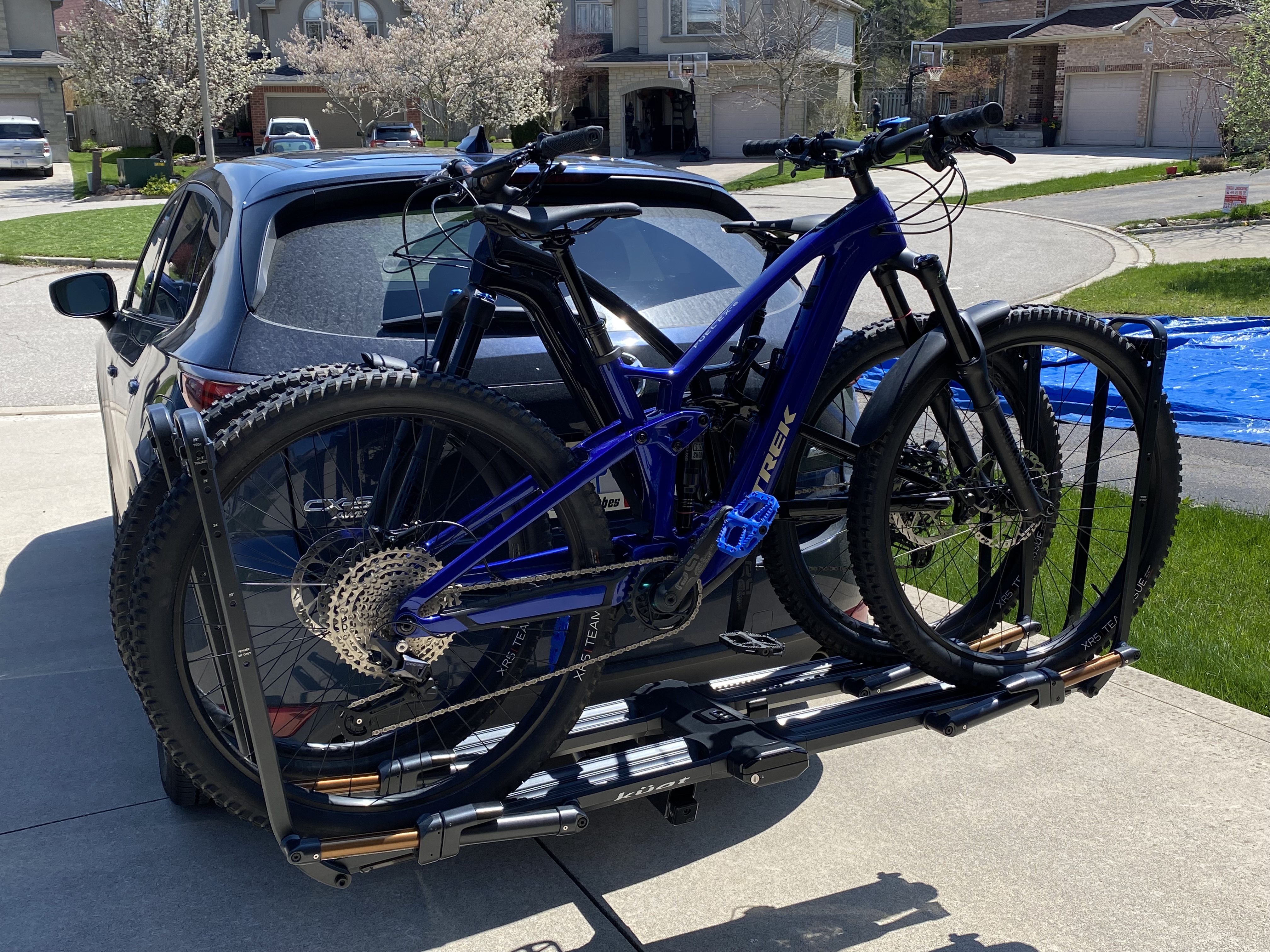

Kuat Piston Pro X bike rack:
We also bought a new rack, the Kuat Piston Pro X, when we got our EXe’s. So far, it’s been a fantastic rack - so easy to load and unload the bikes, and very stable on the rack while travelling.
