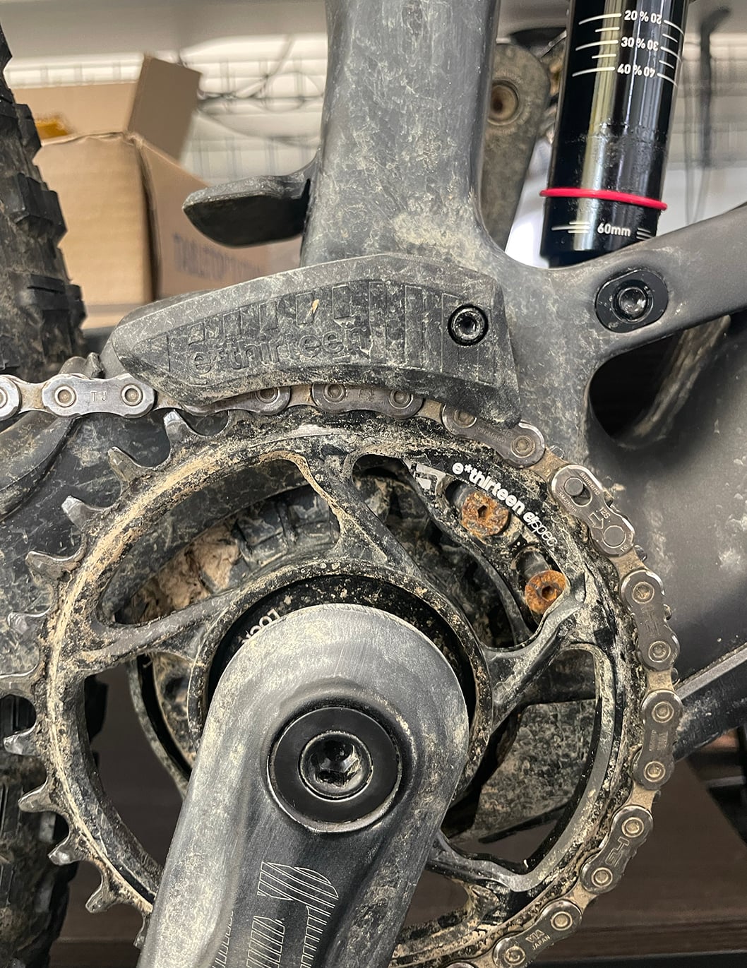

Still figuring out the creaking on my bike :(. I regressed and torqued to spec all frame bolts including motor bolts. Only bolt I didn’t get to is the main pivot bolt on drive train side cause i don’t want to screw anything up. Not sure how to remove cranks and chain guide, are there any special tools I need? Don’t want to screw anything up. Couldn’t find any videos that showed how to access and remove main pivot bolt on drive train side
Big Mac
Mar 9, 2023
US
I would suggest looking at the service manual for the Fuel EXe, which I attached. Or you can easily find it on Trek’s website. It shows what needs to be greased and the proper torque specs. As for special tools you will need a 20-notch bottom bracket tool to remove the chainring, which is required to remove the main pivot bolt.
Note that it’s very important to reinstall the crank in the proper orientation, apply grease to the right places and torque the lockring to 50Nm as stated in the service manual (even though the lockring may show 30Nm on it).
Hope this helps and please respond back if you find the source of the creak.
I'm in exactly this situation as well. Been hesitant to pull off the chain ring, but not much choice now.
This is very helpful. Thank you! I’m a little hesitant to start removing the drivetrain components so I might go to a LBS and have them do it. I have a torque wrench that goes to 20nM so nothing close to 50nm. I could go on feel but would rather be safe and have a professional make sure the lock ring is torqued to spec.

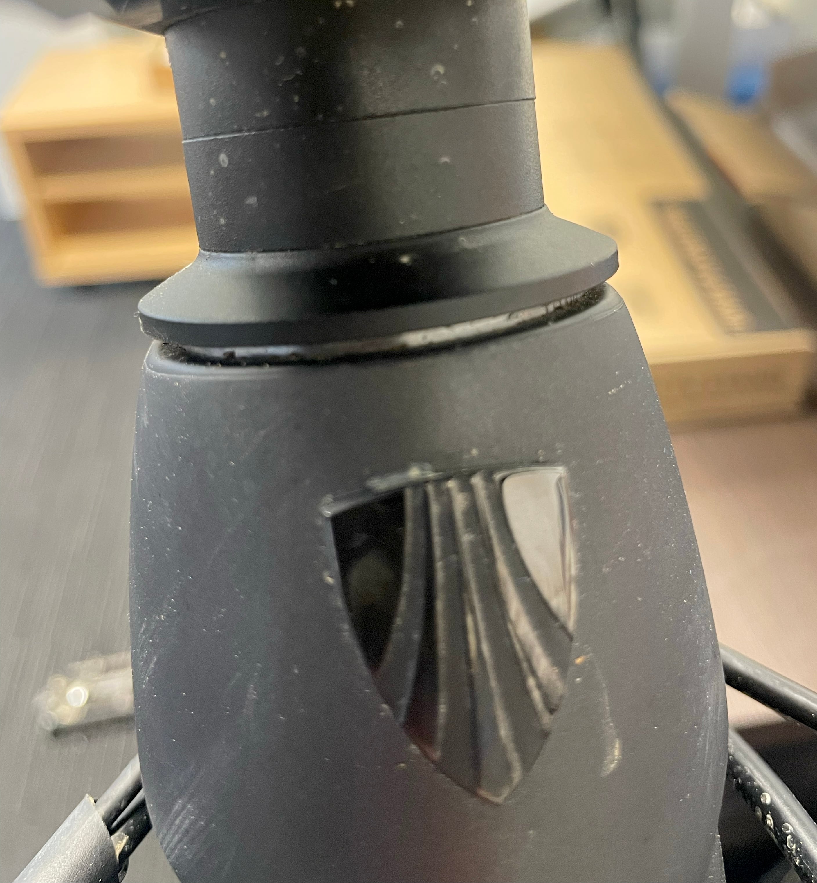

I have a bit of a gap between bearing and headset cap. Is this normal or does it need pressed in more? View attachment 113585
The "problem" with this preinstalled headset is the missing seal.
It's a very cheap version from Bontraeger. I have had the same gap.
So... I used a old headsetcap from a Cane Creek 40:
The seal is now protecting the bearing from water and dirt.
If you want to protect your bearing too, you may buy the cover as a spare part:
Definitely worth it:cool:(y)

Similar gap to yours on the headset cap. Hadn't noticed until I read your post and checked it.
I did get the chainguide on the stock build, yes. The Bolts have already rusted on it though :LOL:
I had some good news about the wheels this week. Trek replaced them with a Bontrager Line Elite 30 Carbon wheelset and XT cassette under warranty. It took a little over a month for them to be replaced but a good end result I think. While it was away, I asked about the headset and the workshop guy said it was fine.
Will look to swap the top part out for something that seals better, like the one mentioned above (thank you!)
Those are great upgrades under warranty, congrats!
The bolts of the chainguide on my 9.7 are also starting to rust, lol. Think I’m going to apply a tiny bit of Fluid Film to them…
