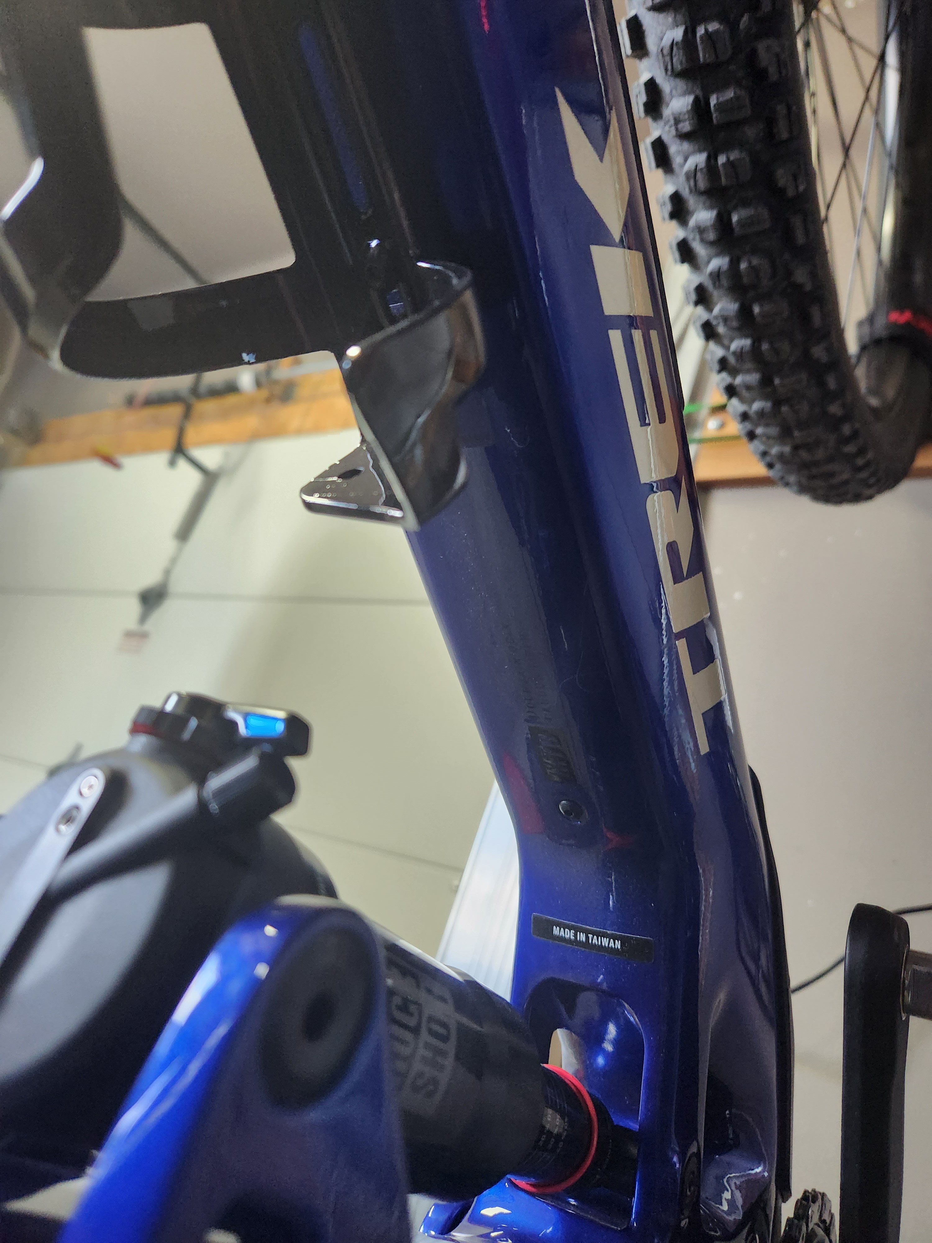

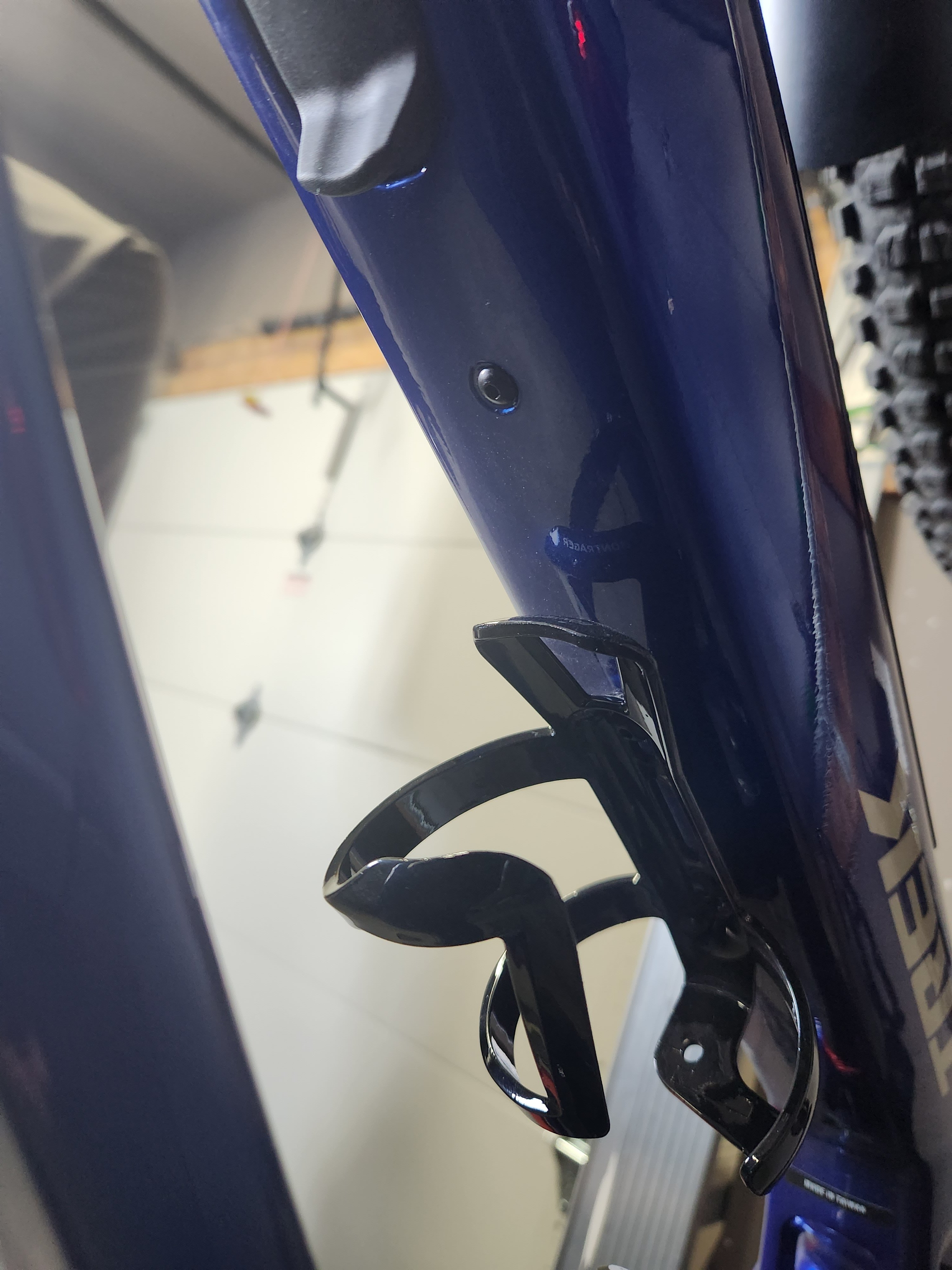

Are you proposing drilling your own holes in the down tube?
No, there are already pre drilled holes with screws on the downtube

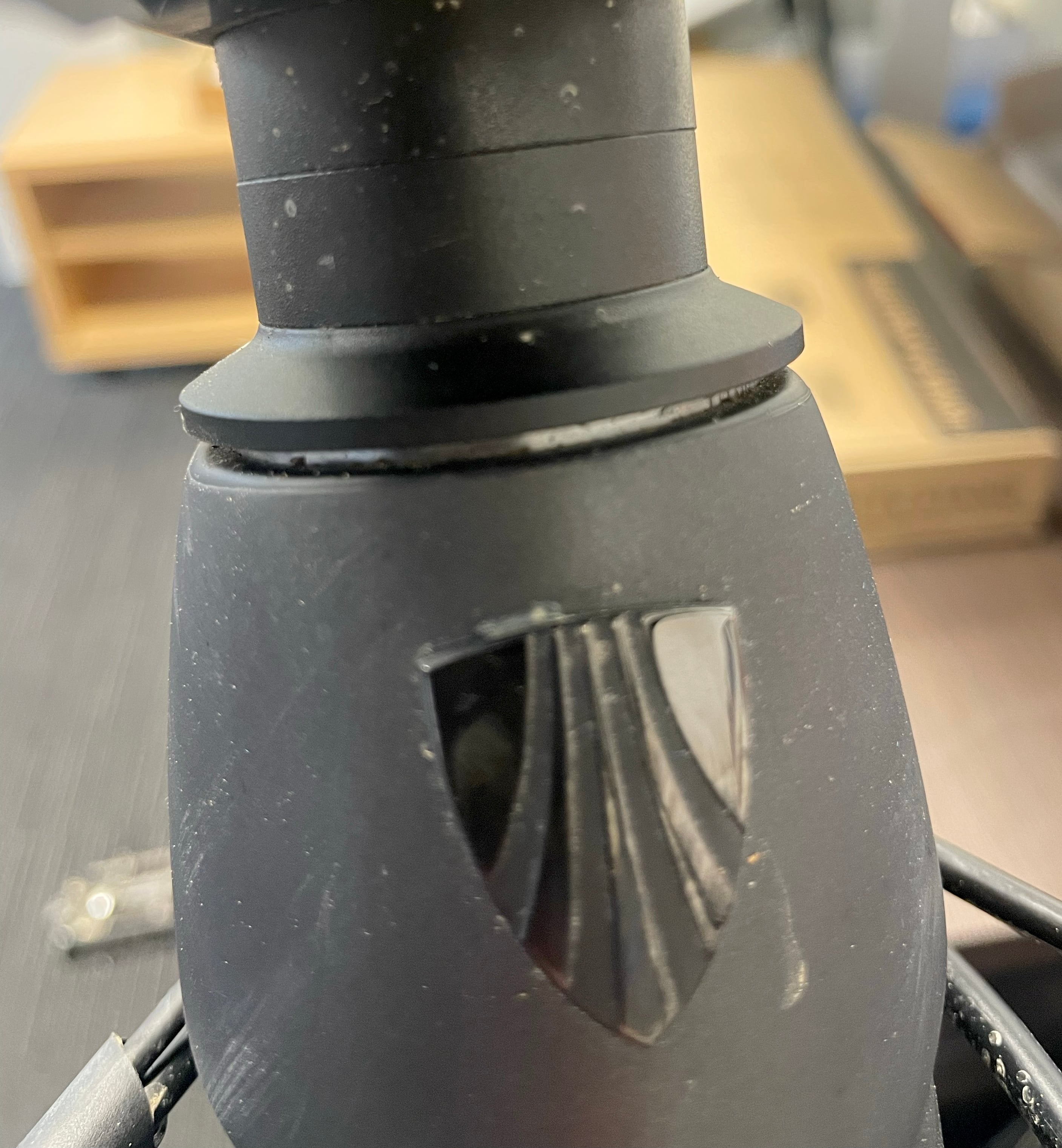

I have a bit of a gap between bearing and headset cap. Is this normal or does it need pressed in more? IMG_7401.jpg

I have a bit of a gap between bearing and headset cap. Is this normal or does it need pressed in more? View attachment 113585

Regarding the gap, I checked my husband’s 9.5 and my 9.7. There doesn’t appear to be a gap like yours.

Similar gap to yours on the headset cap. Hadn't noticed until I read your post and checked it.

I do have the headset gap, and from other posts, this seems to be common!
