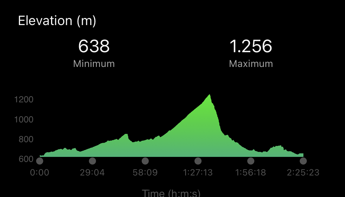

First real battery shakedown tour today … 940hm / 45km / 19.1 km/h / 92-9% / rider total 72kg
Mostly with 100W / 100% / 30%. some @maximum, some @off — after some initial heavy battery usage (range anxiety coming on ;-), consumption settled down - as I saw that I had enough Wh left, the last 15% of the climb was with 300 / 200 / 100.
Outlook for useable terrain coverage looks promising👍🏼
X-axis is time:

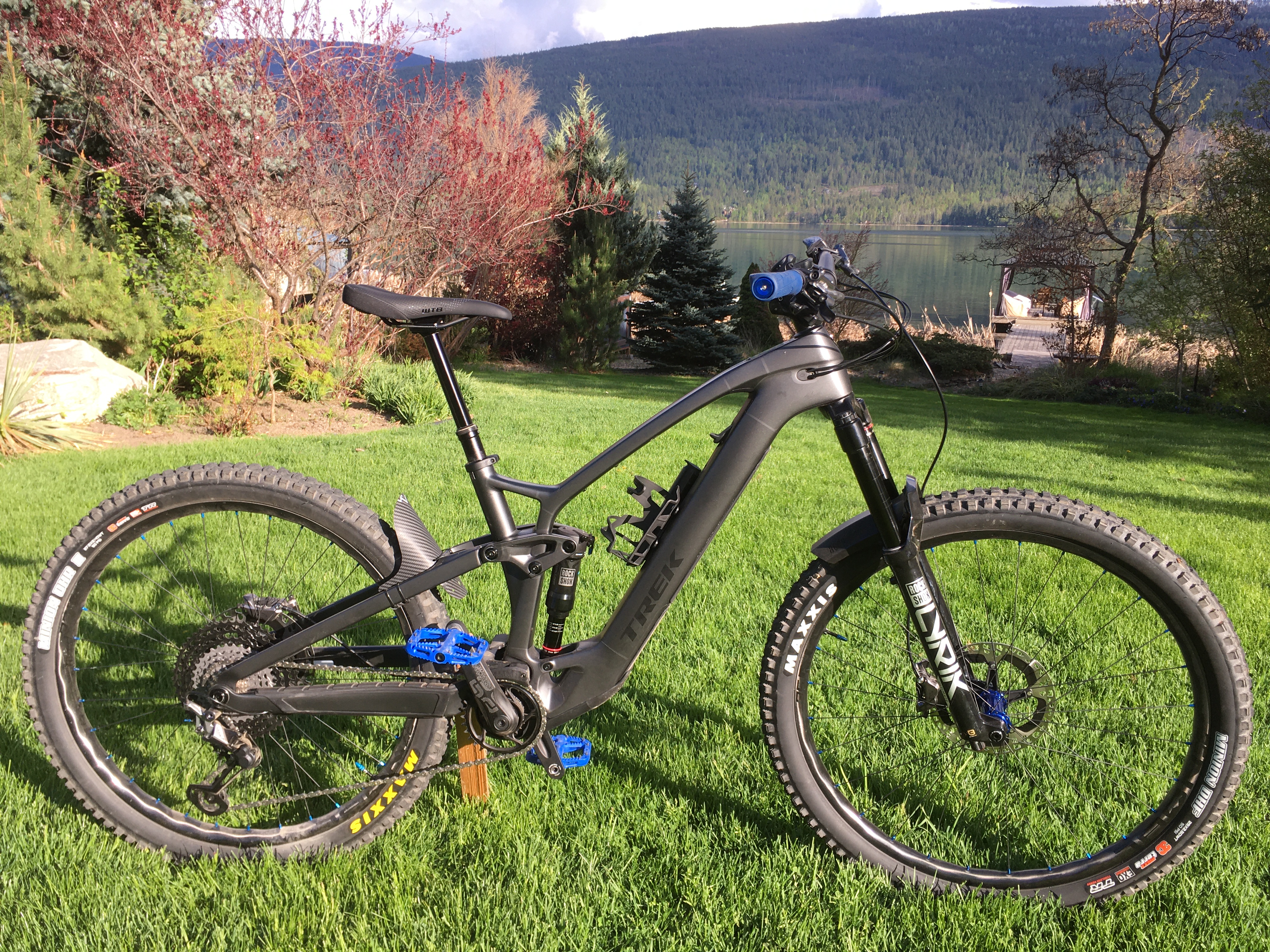

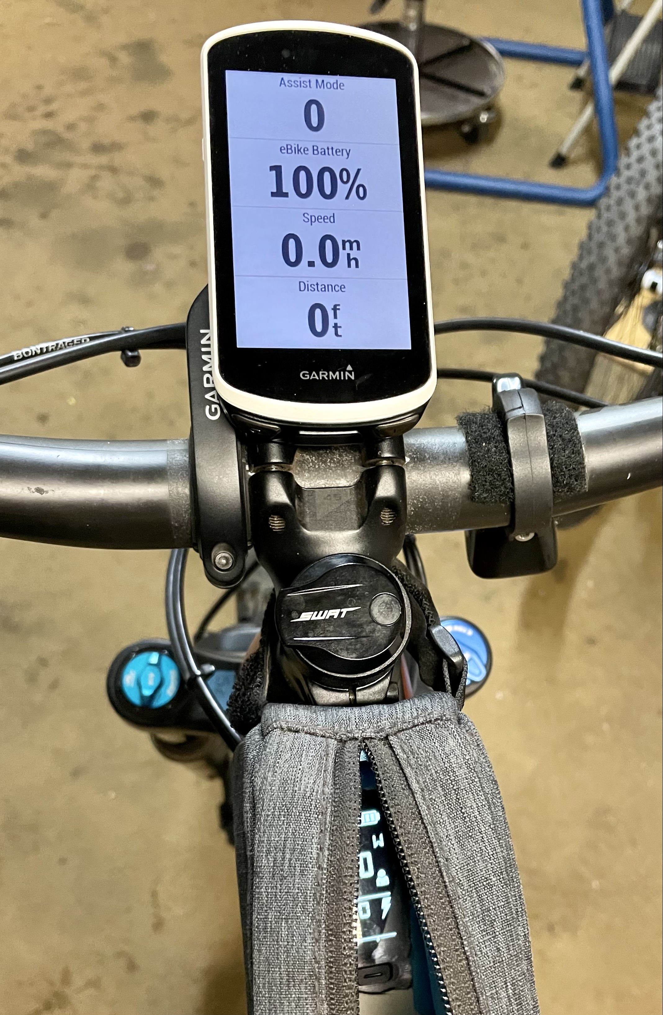

Has anyone had any luck figuring out how to activate the screen “stealth” mode on the Ex-e? The TQ app appears to allow different screen pages to be customized (including a “Blank” setting), but indicates that feature is not currently available for the Trek. My latest software update was done two weeks ago.
I would love to have this option for night riding, more incognito appearance amongst the eye-rolling crowd, and I just find the bright screen distracting/ annoying as my rather OCD-ish tendencies tend to draw my attention to it at inopportune moments. Thinking I might try some super dark window tinting film in the meantime in the hopes the stealth option is added in a future firmware update.
I would love to have this option for night riding, more incognito appearance amongst the eye-rolling crowd, and I just find the bright screen distracting/ annoying as my rather OCD-ish tendencies tend to draw my attention to it at inopportune moments. Thinking I might try some super dark window tinting film in the meantime in the hopes the stealth option is added in a future firmware update. View attachment 115492 View attachment 115493 View attachment 115494
Great looking Fuel. I can't answer your question But . . . Have you ridden through the slop yet with those fenders? If so, do they keep the mud off you? Are they OEM? Thx
Front fender came with the Lyrik fork. The rear is just a $8 plastic sheet type from Amazon. Neither is intended to keep any of the slop off of me… they’re exclusively for keeping crud out of the linkages and sensitive suspension parts.

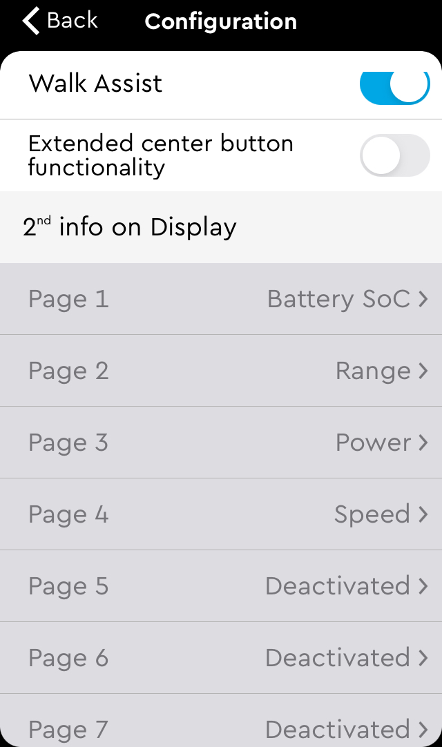

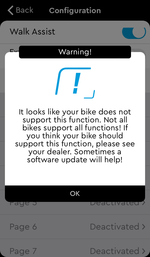

I just downloaded the TQ app and had the same experience, thanks for posting.
I agree the display is too bight for night riding, it can be distracting. And I never use the range or MPH screens, I would be happy to disable them.
Another observation: the bike milage shown in the TQ and Trek apps are wildly different from each other, and neither of them are anywhere near accurate.

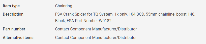

I cannot find the spider online, where can i buy It?
True.... I found only two shops, but "out of stock"
I found a dealer catalog with the spider:
Maybe ask your bikeshop....
