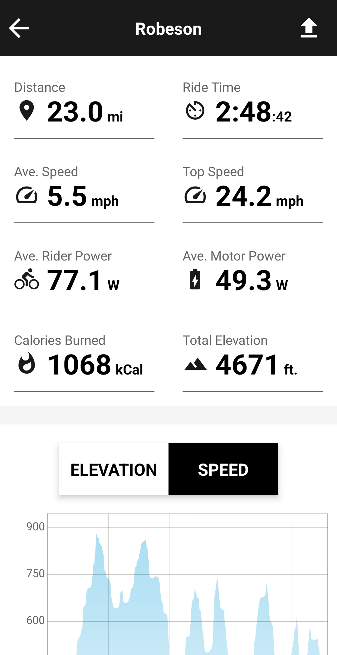

@njatherton just a stupid question: if the battery has 360 Wh and you used your bike for little less than 3 hours with 50 W average motor power, why is the battery empty? should you not have used only 150 Whs (50w x 3 h)?
Can anybody help me?
The motor power metric in the trek app is not accurate

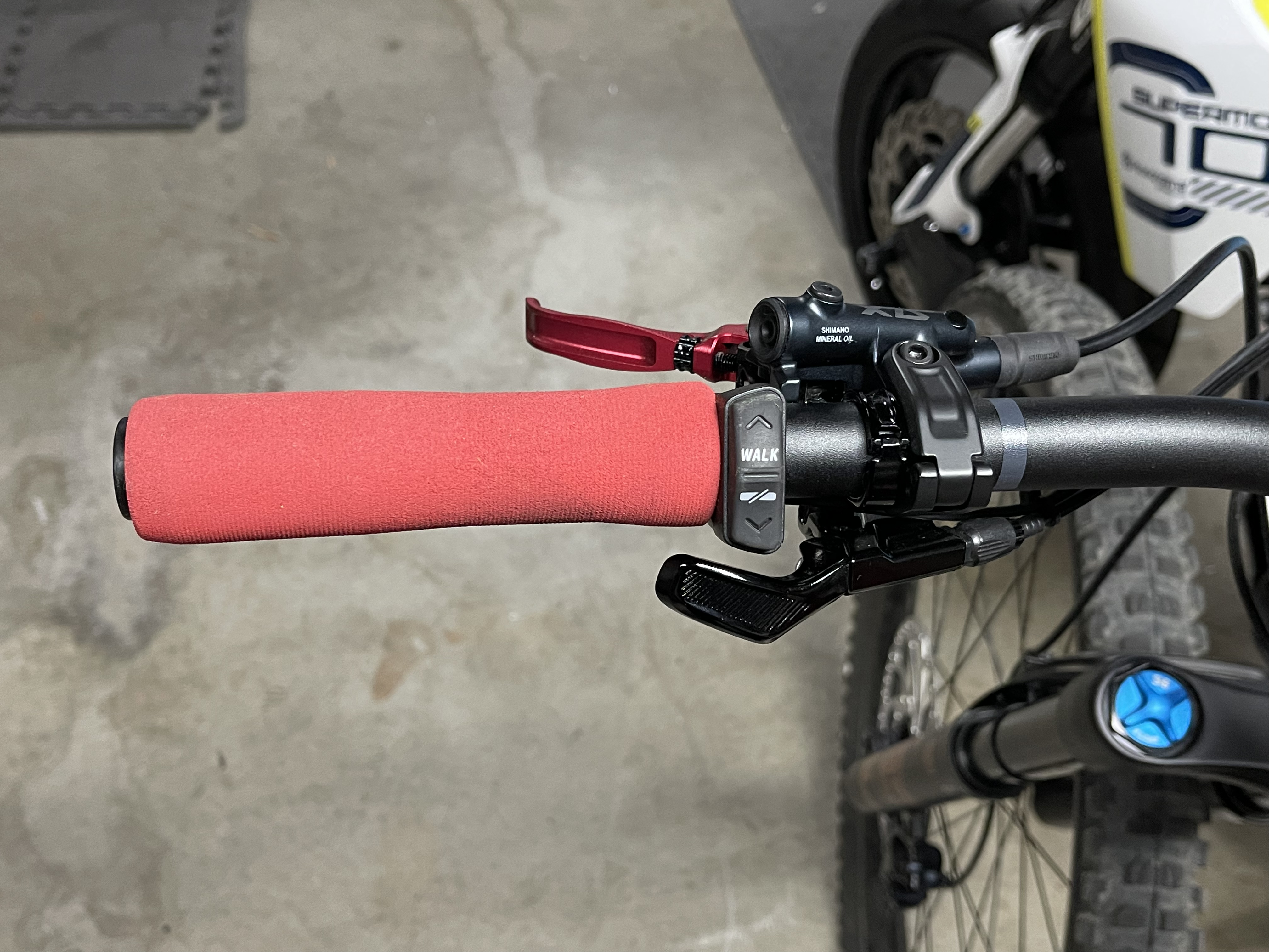

I moved my controls around on the dropper side. I like my levers a little bit inboard, so I can hook the end of the lever with my index finger. So, I slid the lever assemblies in a little bit.
I moved the control switch to the left of the brake lever assembly tab and I moved the dropper lever bracket on the inside of the brake lever bracket. Then I ran the control switch wire on the inside of the dropper bracket so nothing can snag it. I think this will work better for me.
