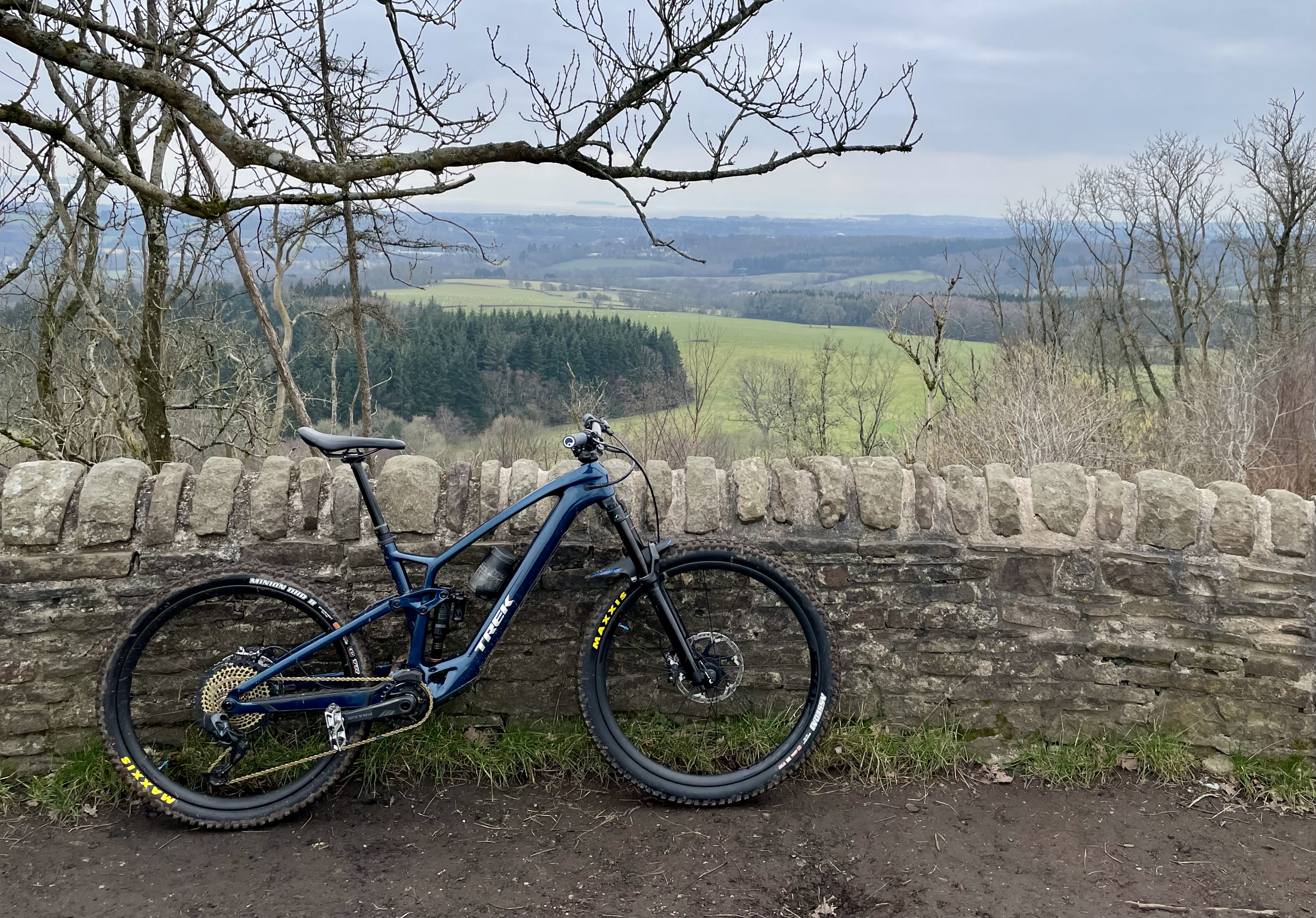

Had my Fuel EXe 9.8XT since October last year after waiting a few months for delivery (still awaiting range extender!)
As for many posting here, it came with incorrect spec, but now finally got the XT brakes fitted and opted for Praxis carbon cranks as the e*13 still not available. XT cassettes also still a nightmare to get hold of in UK, so found a great deal on Sram XX1 cassette/chain combo (in gold which really sets off agains the Mulsanne blue) and used Trek credit towards that and paired with a GX AXS derailleur/shifter. Also upgraded air spring to 160 (with a buttercup) in the Lyrik fork, and gone Mx with a matching 27.5" Bontrager Line Elite wheel. Maxxis rubber, Ergon grips & seat to complete the package (as still cheaper then Treks stock 9.8GX AXS :) )
It was a great bike the day it arrived, but now even better in 160 Mx set-up.

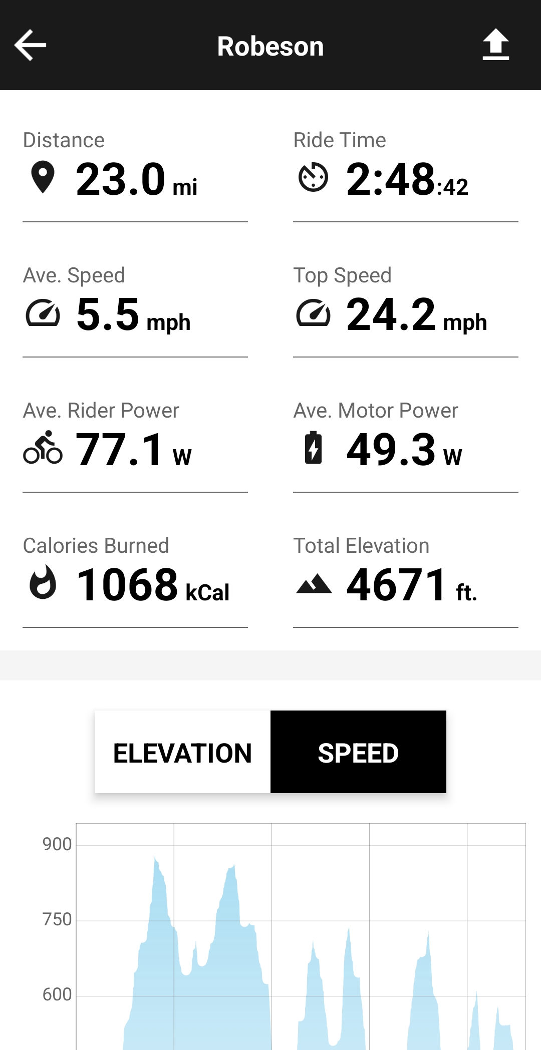

First time I have nearly run dry. Pre-ride at 100% battery estimated miles was 42 but given the amount of climbing I did I am happy with that distance. I was in Eco 99.5% of the time with 3 very quick bursts at Mid to get up some steeper sections.
View attachment 106780 View attachment 106781
Impressive total elevation. My best is just over 4000 ft on Eco with about the same miles.
Yeah nice, that’s impressive! Stock tires? May we ask your weight?

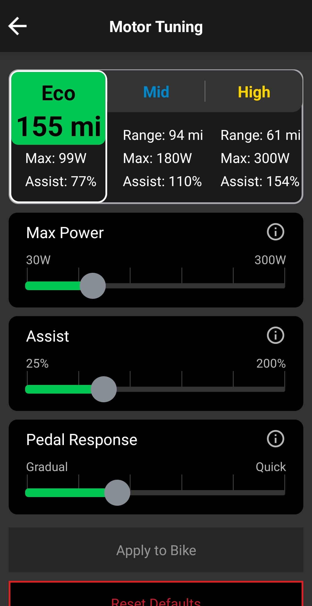

I have a route planned that’s over 4000’ and I’ve been thinking of re-tuning the motor specifically for it, so that all 3 modes would be in the eco/trail range.

@njatherton just a stupid question: if the battery has 360 Wh and you used your bike for little less than 3 hours with 50 W average motor power, why is the battery empty? should you not have used only 150 Whs (50w x 3 h)?
