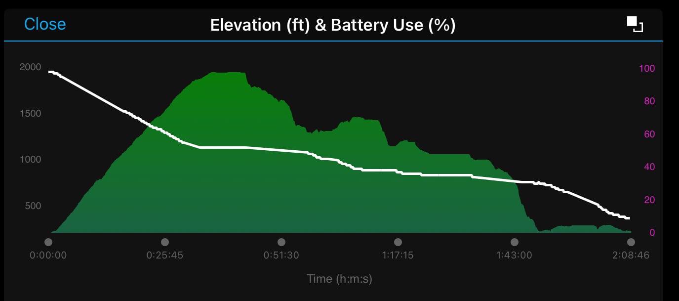

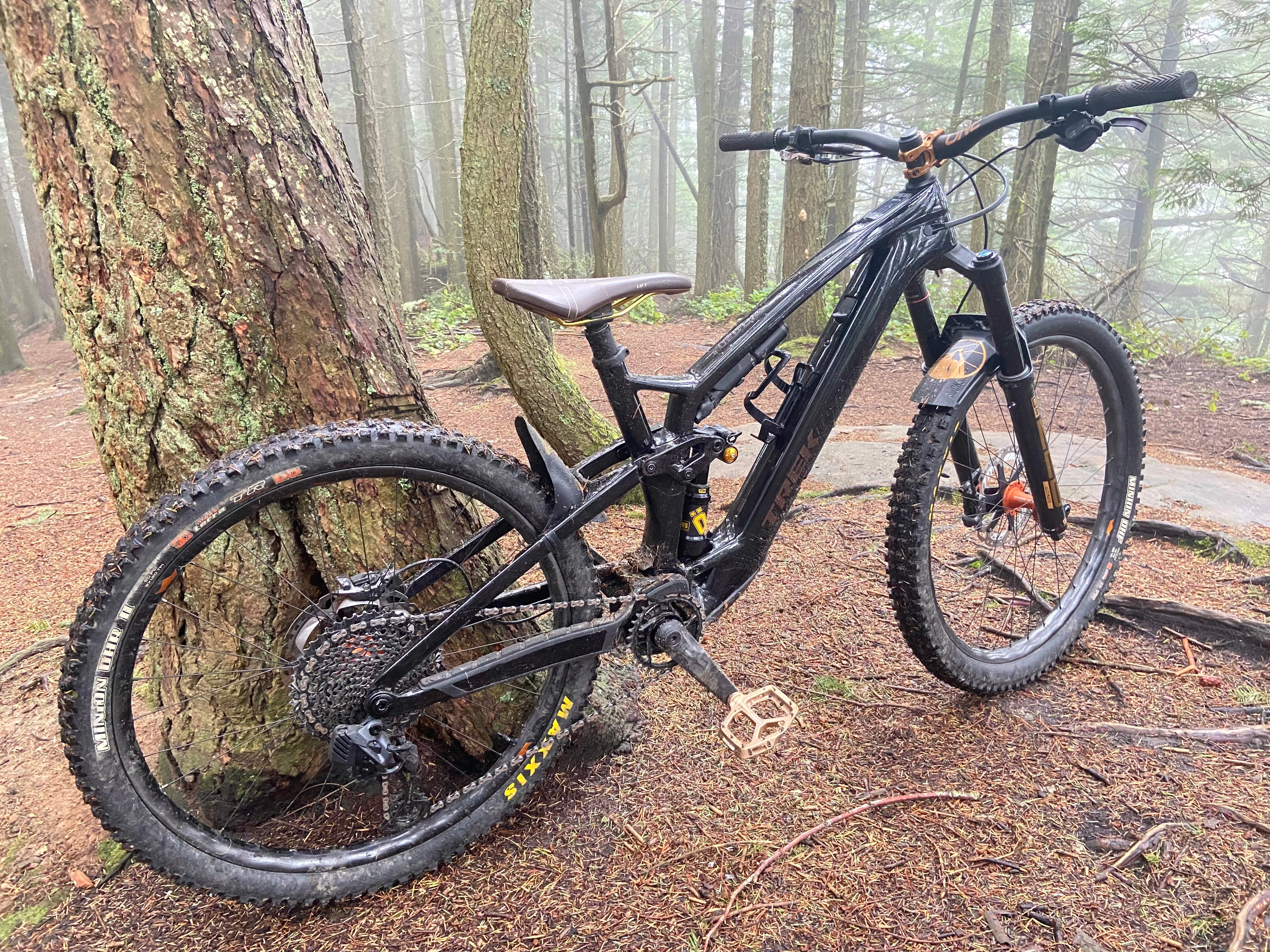

Had a great ride today, bike is running so well! 2750’ , 15 miles, finished with 9% battery. Wet slippery mushy downhill! Spent most all of the ride in trail mode, but with the max power at 300w.

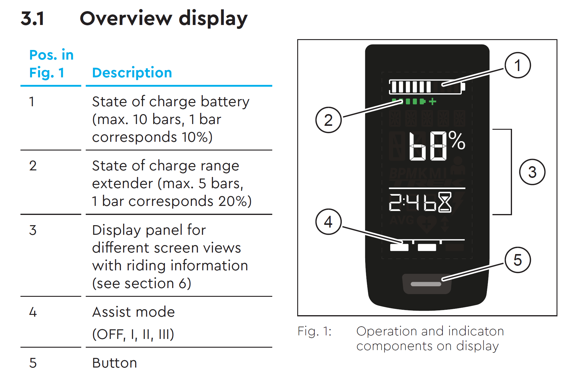

mitea
Sep 10, 2022
135
98
Switzerland - LU
Only rumor I’ve even seen mentioned by media is a mullet wheel speed update. I have some personal wants such as one custom page on the bikes display that you can choose what’s displayed on top and on the bottom. For example current speed up top and battery percentage on bottom. I feel like this should be easier to implement since those display screens already exist.
A suggestion I’ve seen is being able to change motor setting (eco,trail,boost) from the bike display itself in case of remote failure.
Flexibility of the screen is very limited since its a segmented display. But there is also a heart symbol and BPM on the display and some arrows that I haven't seen used somewhere. Maybe it will be possible to connect a HRM to the bike and control the support according to the heart rate. Something similar is possible with the Levos also.
Gd3fit
Dec 1, 2022
57
39
Raleigh, NC
Yeah what I meant was using what’s already displayed on other pages but make a custom segmented top and bottom instead of the default pages mix and match one top segment and one bottom segment from various pages into one additional page that can be toggled through

the range extender battery level is shown in green just below the main battery level display according to the tq user manual.
