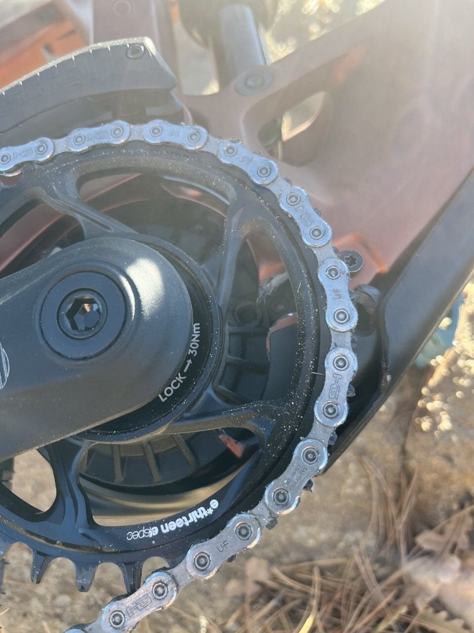

Request for photo of the chain ring Lock Nut (if you happen to have it off)
I'd like to make sure my 3D model has this right.
I'd like a photo of both sides of the nut.
The inside should have an oring and seal attached to, if not then a photo of that would be interesting too.
If I have time to do it I’ll definitely take a pic. If I don’t then I’ll be out of town until early Jan so it’ll have to wait.

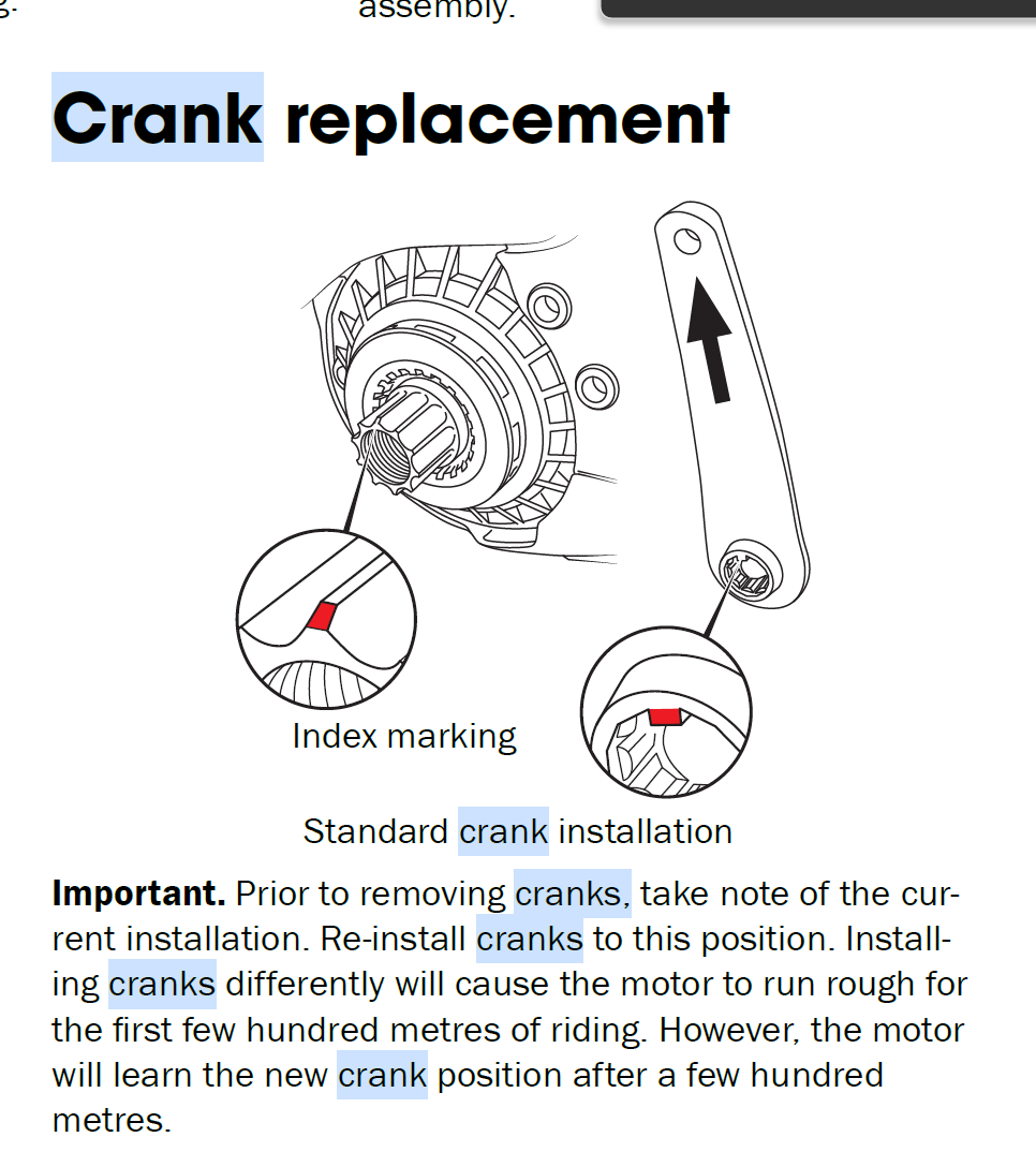

This may have something to do with it... maybe incorrect adjustment of crank arm......
:confused:
"Crank replacement
Index marking
Standard crank installation
Important. Prior to removing cranks, take note of the current
installation. Re-install cranks to this position. Installing
cranks differently will cause the motor to run rough for
the first few hundred metres of riding. However, the motor
will learn the new crank position after a few hundred
metres."
Page 13 of the Service Manual

Hi,
Thanks, yes - the same thing popped into my mind when the drag started to happen as I had remembered that Service Bulletin re the alignments. However I have subsequently ridden quite a distance (about 70 kms) since the mechanic did the "alignment" so it should have re-establised itself by now. Actually my motor system was working well prior to the mechanic doing the alignment tweak work, so he must have spotted something that he thought best to adjust. Anyhooo, will see how it goes at the next update I get done once I hear TQ have released a new version 🤞🤞
Yea same here. Changed cranks, but didn’t “save” the previous crank orientation, now I have a “draggy” motor. Maybe I should try and “find” the original orientation by loosening the cranks and moving the clocking of the cranks to find the original factory position 😂🤦🏼‍♂️🤷🏼‍♂️🤷🏼‍♂️
Because there is no marking on the spindle of where it should go.
The trek manual says there is a mark on the spindle indicating the correct crank position. looks like the corner is "cut off" from one of the splines.

The trek manual says there is a mark on the spindle indicating the correct crank position. looks like the corner is "cut off" from one of the splines. View attachment 102800
Thanks for that. I had noted that Trek info some time back... but as the Trek mechanic saw fit to tweak the alignment I haven't taken the crank off to check if it is aligned as per the Service Manual and don't want to mess with what he has done. I have been away from home the past 4 weeks and when I get back next week I know the Trek store team will be crazy busy with Xmas bike builds... so I will discuss early next year with them (and maybe by then the new TQ software version might be released 🤔)

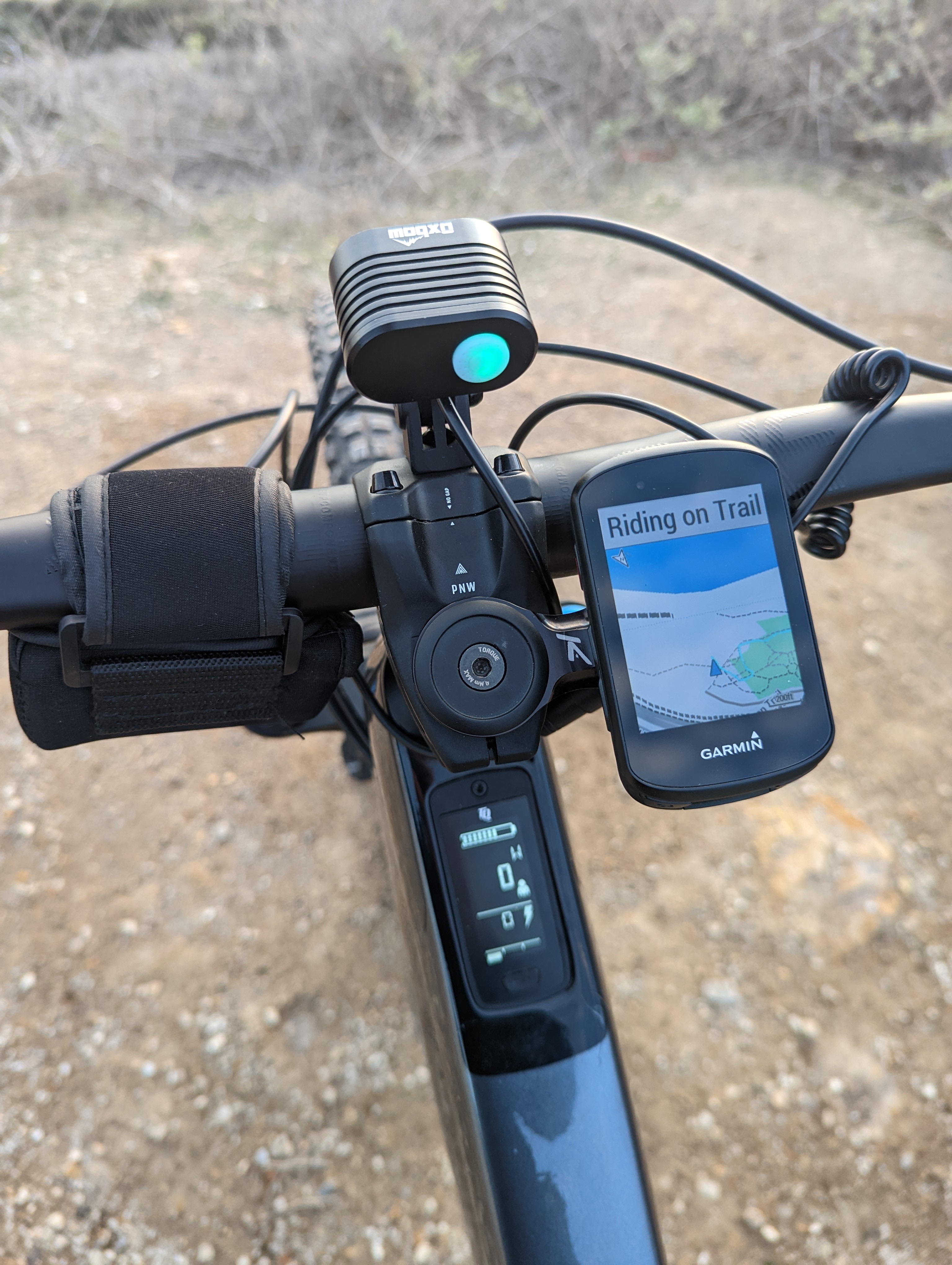

My cockpit.
Rigged for night riding after much goofing around with various mounting scenarios. This one seems to be working well. I use this Oxbow Voyager 2100 lumen on my motorcycle helmets as well. I bought a PNW stem with their Go Pro swivel mount for the light mount. Puts it in a perfect spot and easy to take off. I just strap the battery to the One Up bar and its clean. The K Edge Garmin mount was in the way over the stem so I rotated it 90 degrees. Worked great.
Mounted my Nite Rider Lumina 1000 onto my helmet so no wires leading up there. Takes about thirty seconds to convert it back to day use.
Little evening cruise last night.

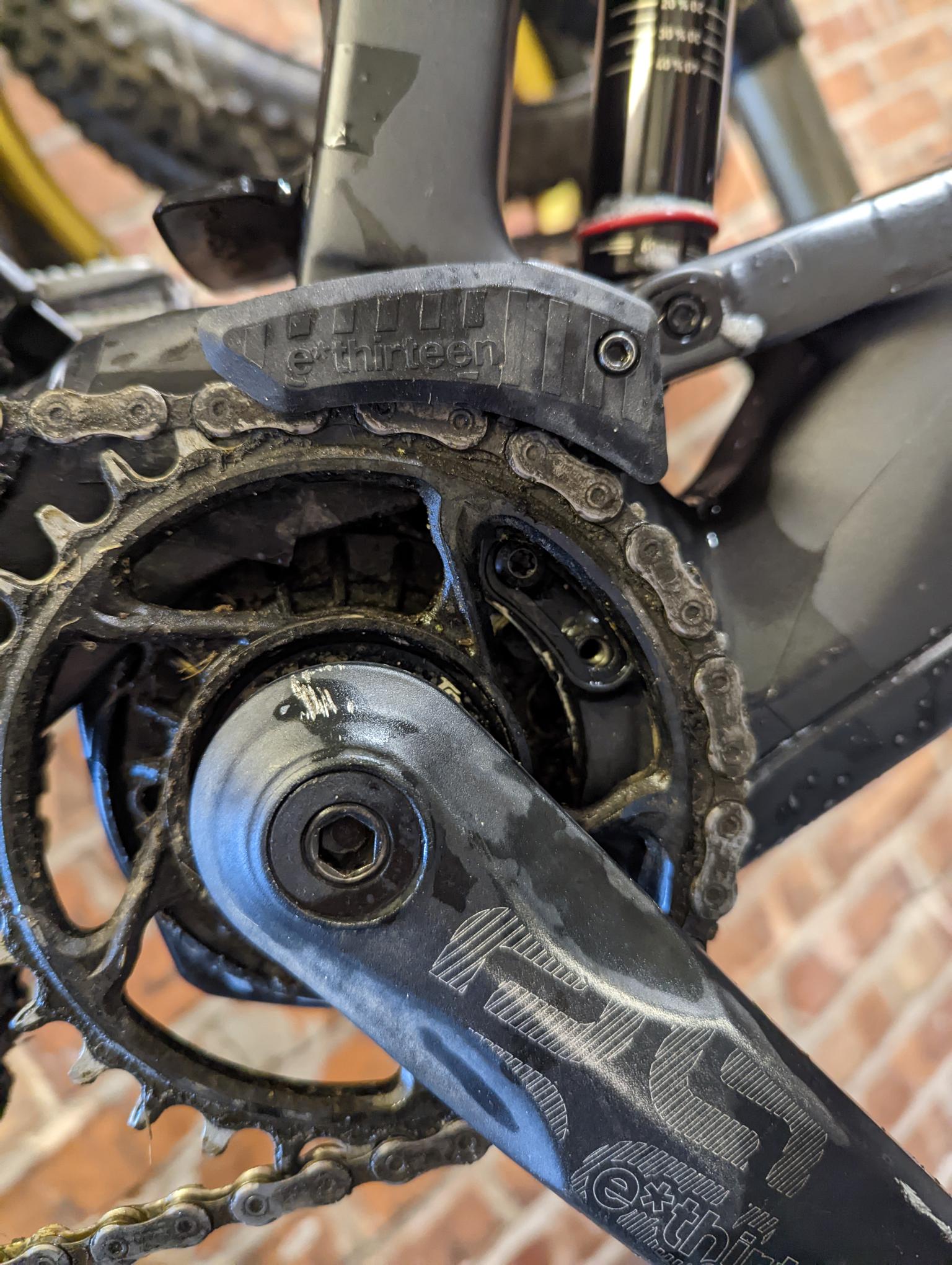

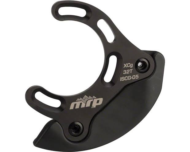

I think these MRP XCg bashguards can work as far as possible mounting holes goes.
I almost ordered one, but then I looked at the mounting holes on the bike. It is literally 2 holes in the carbon frame, and looks like it really is just for a chain device. The impact from a rockstrike on a makeshift bashguard solution fitted to those holes will almost certainly crack the frame in those spots. So I refrained from ordering the guard, and will ride the bike without.

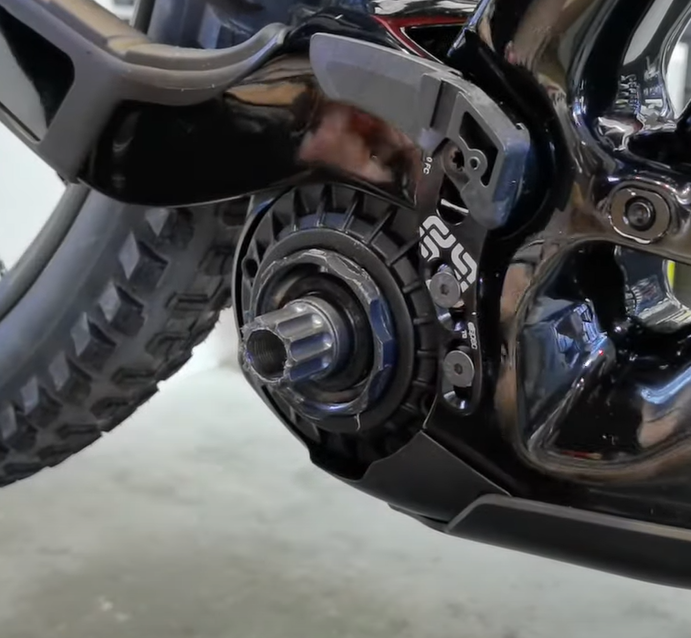

As far as chainring mounted bashguards, I found this photo on a Facebook EXe group, and this frame was damaged after impact to the chainring. So a hit to a chainring mounted bashguard will almost certainly crack your motor out of your frame.
73A42816-D4FD-4361-A54A-68ACC0627FFE.jpeg 07AE1856-E675-4DDA-B836-3111BA91D0D5.jpeg
Sheesh, I hit my chainring today, that's wild how the frame cracked like that after an impact to their chainring. I am loving the mullet but the low BB is definitely a problem for me. I only hit the chainring once, but have had several scrapes here and there. I am ratcheting as best I can, still learning, but it has given me less confidence going over certain rooty and rocky areas... I don't want to put on the rear 29er as I prefer the 27.5, but I might have to test it. I'm 5'6" and have preferred 27.5 and mullet prior to the EX-e.. I didn't get along too well with previous full 29er but also the bike frame was slightly too large for me so that could be part of the problem. I could use some 155mm cranks lol
I’m thinking that failed frame on FB was an outlier/QC issue….
