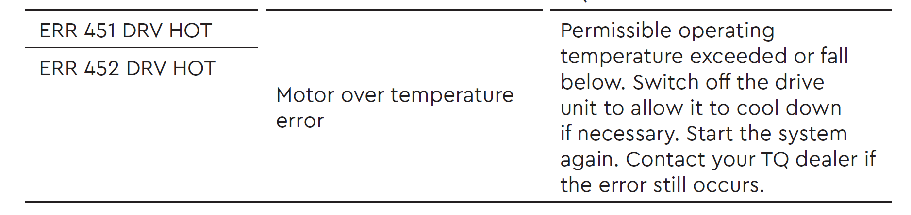

Not quite. I definitely have drag, like the clutch is engaged.
Also, my motor runs hot, and then cuts the power. Today I climbed in max/boost mode around 900ft vert in 17mins, and the system cut the power to 50% of before, presumably because the motor is too hot. At that point the motor was actually uncomfortably hot to the touch.
Motor does not cool down to “normal” performance capability for the rest of the ride, and I have erratic power delivery for the rest of the ride.
I am thinking I could have something like a dragging clutch creating excessive heat, which forces the thermal management to kick in, and cutting the power. This could obviously have excessive drain on the battery too.
Granted, I ride in the Southern Hemisphere, with temps in 25-30C (80-86F) range. But surely this should have been tested? Anyone having issues with the motor running hot? Or feelings of clutch dragging when you turn the system off whilst coasting on a flat surface on a ride?

That does not sound right, take it back.
There is an error code for an overheating motor (according to the manual) , so it might not be an overheat problem you have if you didnt see the error
plus there are more error codes than just the above relating to overheating - check the manual
