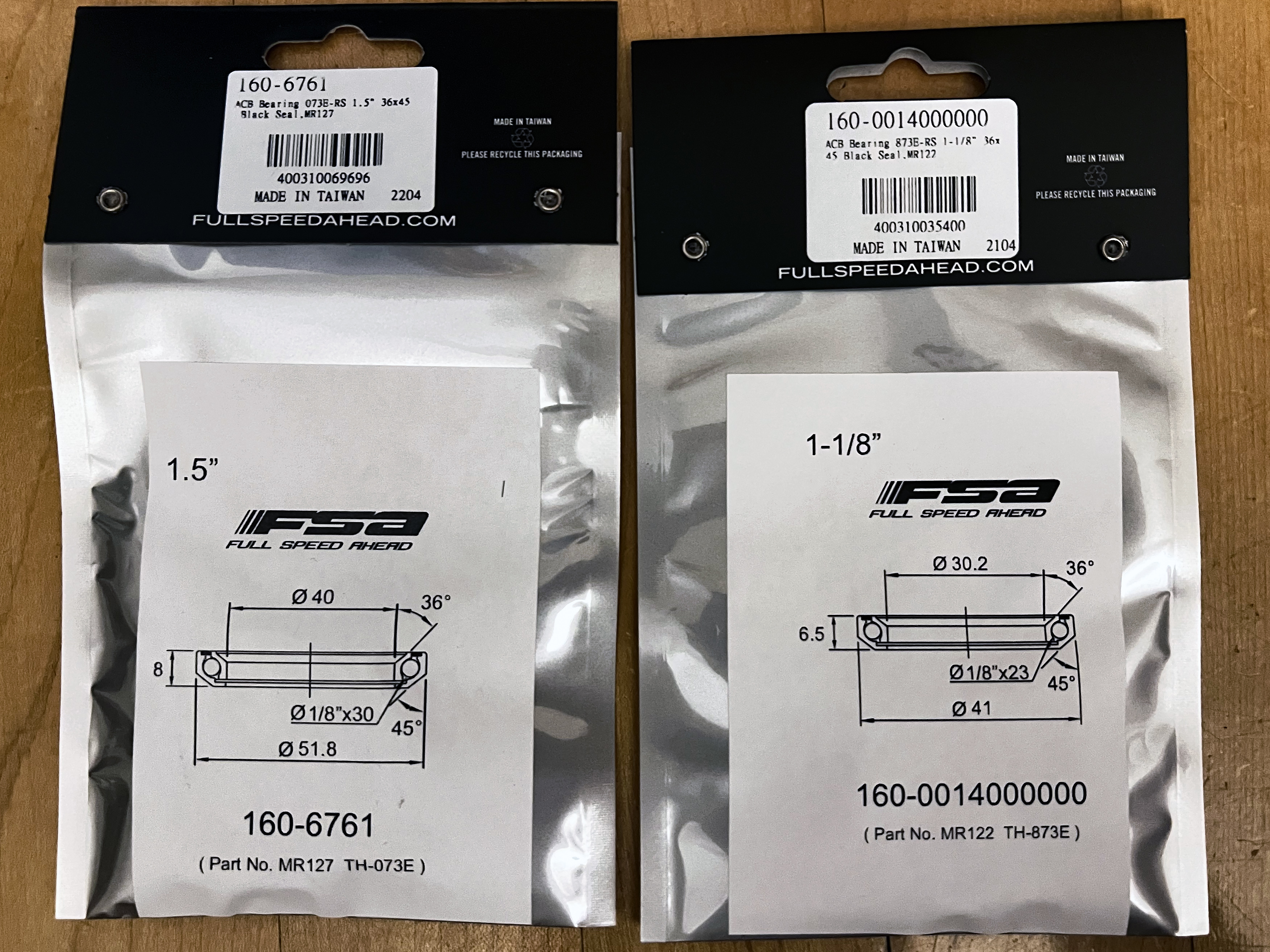

Does anyone know what the headset specs are for the EXe? I have a 9.5 and wanting to upgrade the headset and having a hard time finding this info anywhere.

The trek spec sheet lists the upper bearing as an fsa mr122,and the lower bearing as an fsa mr127

With the FSA bearing specs provided above it looks to be an integrated 41/52. Are you wanting to swap out from the stock ones? I figure I’d replace them after a season. I’m already using a cane creek 40 crown race which works great with the stock headset.

Here you go, see attached for a pic I took of both parts with specs.
