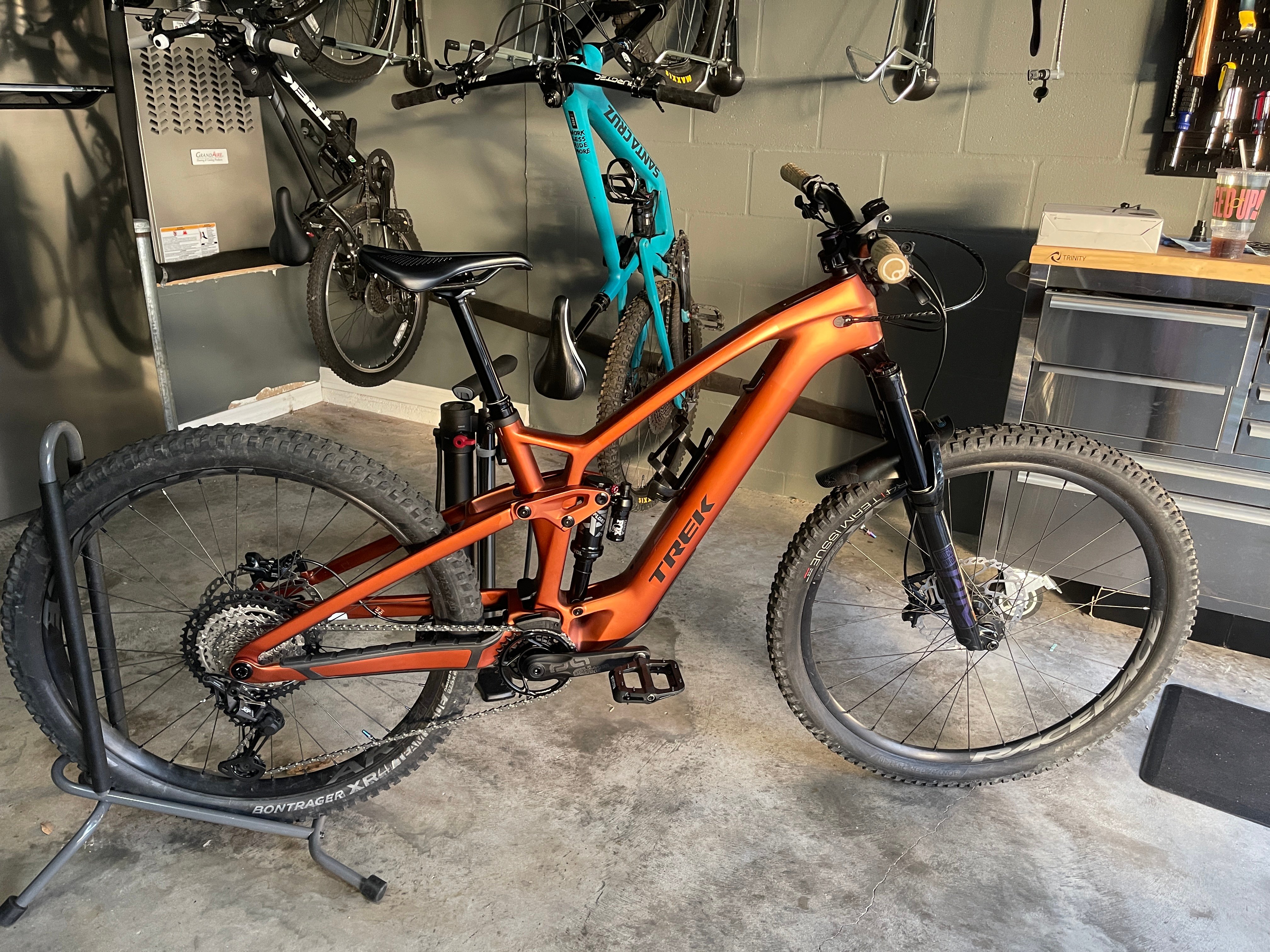

Yesterday I changed the brakes on my 9.5. It came with Tektro Orion 4P brakes and changed it for a set Magura MT7. I planned to change them directly, when I bought the EXE, but found them good brakes. Didn't like the feel in the levelers that much and they are a bit heavy but with good stopping power!
Changing the hose of the rear brake is quite a hassle. It took me 1.5 hour to get the hose through the right holes in the frame. Every time it went up to the seatpost. My other bikes don't have hoses in the frame, which is very easy for swapping brakes.
I changed the R35 RS fork a while ago for a Marzocchi Bomber Z1 Coil 160mm. It is such a big difference in the positive way compared to the RS 35 fork. Night and day. It is much more planted and the smoothnes is very good. Even compared to a Fox36 performance elite in my Banshee Prime.
I didn't like te standard dropper on the 9.5 and swapped it for a BikeYoke 185 Revive MAX. You cannot compare the two pricewise, but it is a dropper from another level. I have a BY in my Banshee and OneUp V2 in a Kona Big Honzo, but the BY is the winner of the two.
It won't take long and only the frame, motor and E13 cranks are the only stock items Just the way I planned when buying the 9.5:)

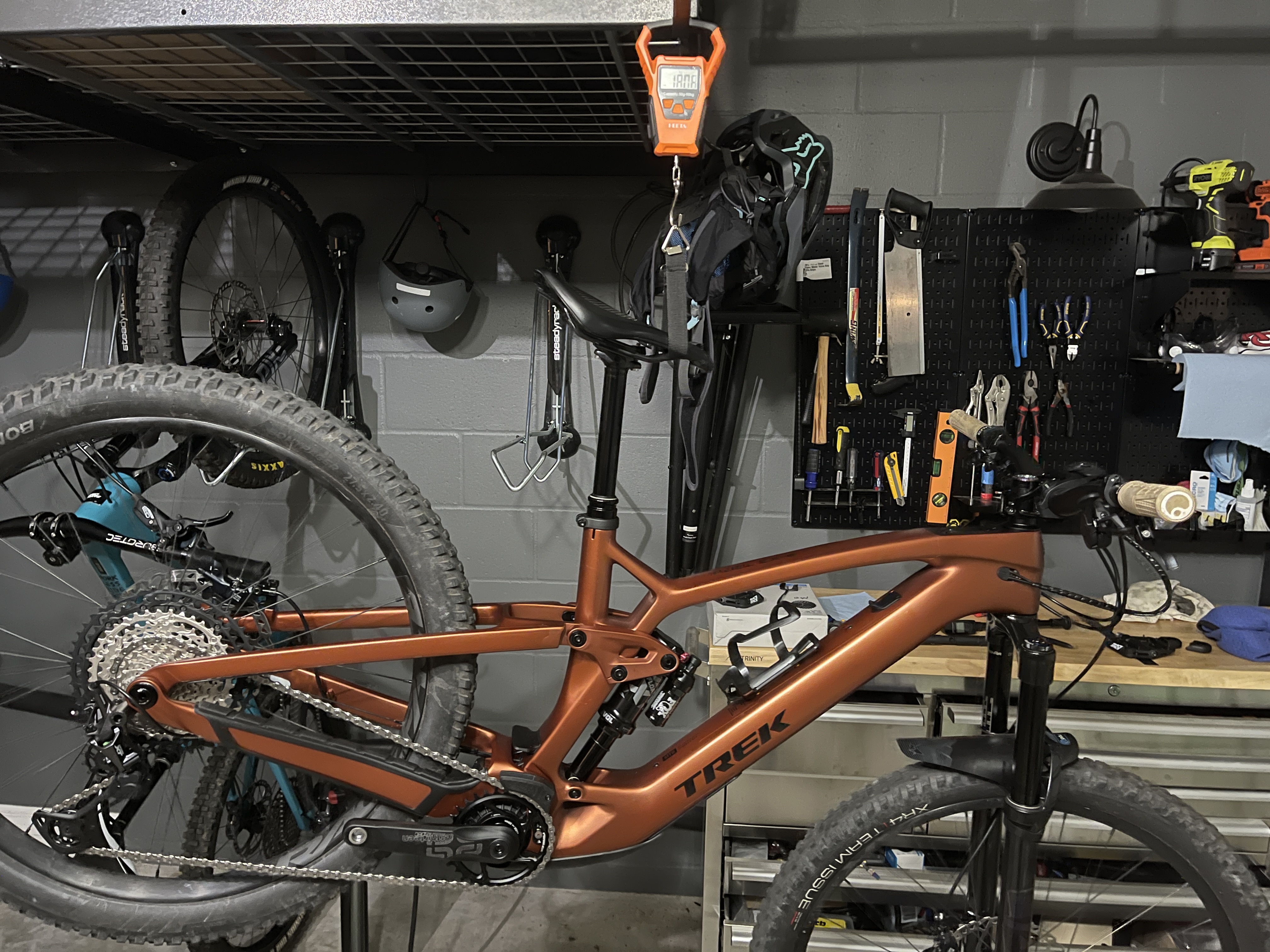

I bought the 9.5 with the intention of swapping a lot of parts over, so far I have swapped the following
- swapped the rockshox 35rl fork for a fox 36 factory 160mm
- fitted an axs derailleur instead of the XT
-swapped the wheels for some dt swiss wheels, and swapped the cassette for an xt cassette.
- swapped the awful shimano m420 brakes for magura mt7
- swapped the handlebars for oneup carbon bars
-got rid of the stock tyres and replaced with assegai exo+ up front, and DHR2 double down on the rear.
I had assumed that the seatpost was going to be pretty terrible, and had plans to replace it with a oneup v2 dropper post, but when I used it I was quite pleasantly surprised, so thats staying, although the lever is a bit big and clumsy looking, but it can stay.
I was also pleasantly surprised by the rockshox select+ shock, I have a fox float x2 factory here that will fit, but I havent felt the need to swap it over.
The 9.5 wheels were pretty terrible - very heavy, and quite weak, it didnt take many rides before the spokes started losing tension, plus it only had a shimano HG freehub, not microspline or sram XD, so limited choice of lightweight cassettes.
weight is now down to 19.2kg without pedals, it started life at 20kg without pedals. AS it stands now its pretty much finished, rides well, is light enough and tough enough

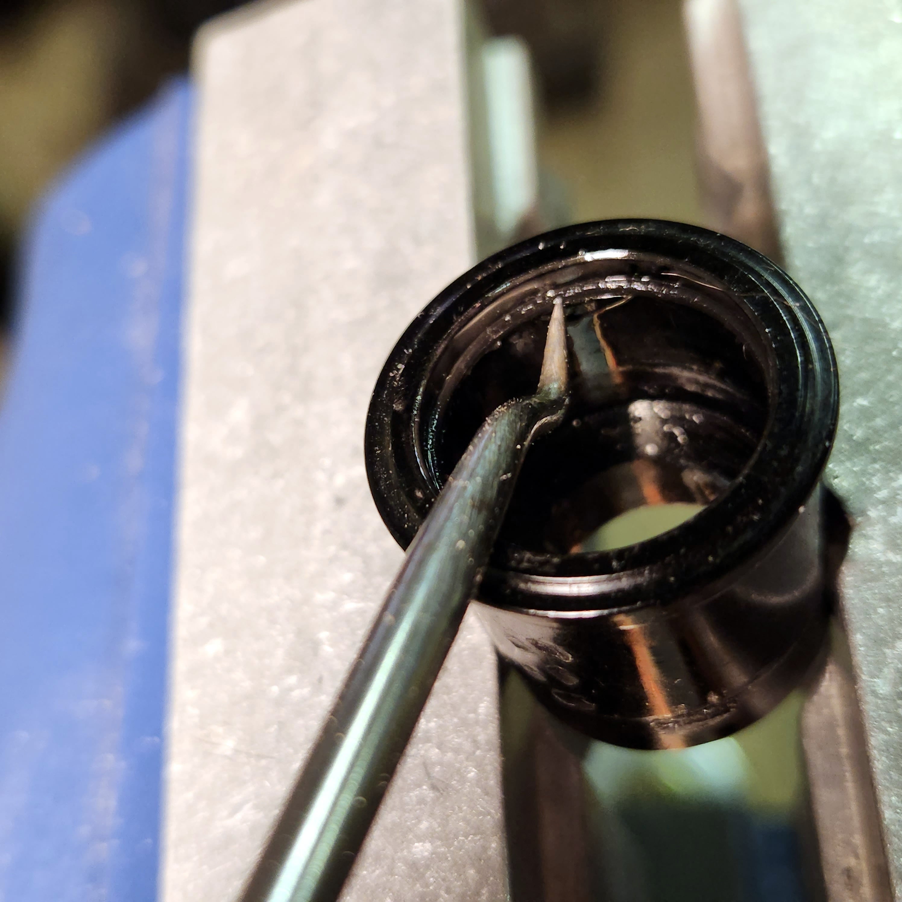

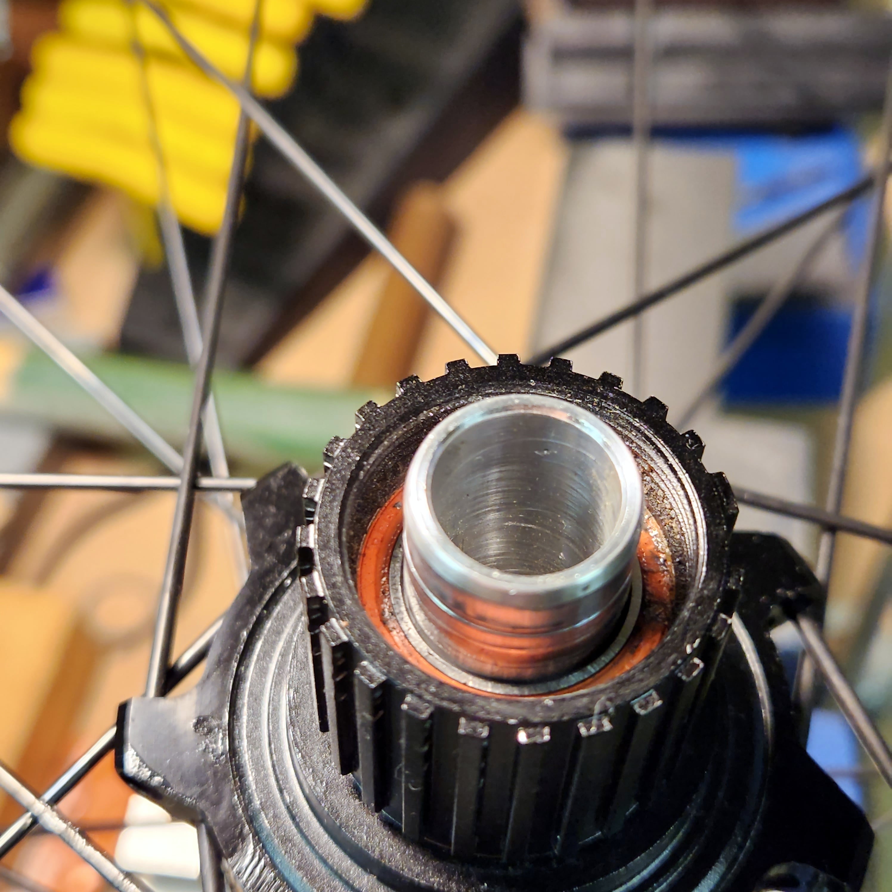

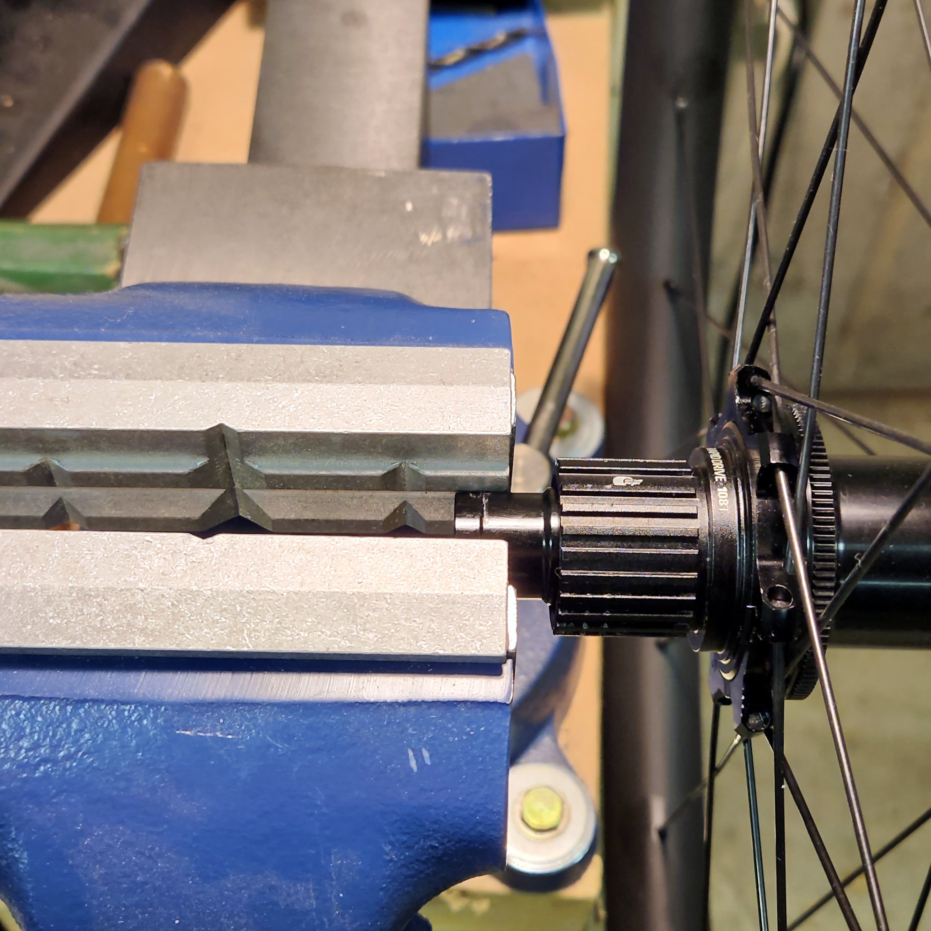

...You said the seal didn't come out with the lock ring, my understanding is that the seal as well s the oring should be attached to the locknut, so that is puzzling to me.
Soft jaws in vise, rock back and forth while pulling up on the wheel. Takes some doing but it will eventually get there. Be mindful you don't smack yourself in the nose when it lets go 😉
Photos of a Bontrager Line Pro wheel.
Using soft jaws to remove the top cap...
Wheel with top cap removed...
Top cap with pointer touching the internal o-ring...
Hope this helps.

Thanks. Visual help’s unfortunately my cheap vice and “soft jaws” don’t hold the end cap tight enough when I’m pulling and rocking. I am tightening down a bit but afraid to do any more damage to the end cap. Meh
gmcttr
Dec 5, 2022
11
22
South Central Indiana
I had to mount it in the end of the jaws rather than the top to get it to hold. I lightly greased the o-ring before putting it back together.
The o-ring is the only thing that makes the top cap snug and difficult to remove.

Alright I’m finally ready to post my 9.7 Pennyflake build. Have not even taken it out on the trails yet but I think I’m pretty much ready. Using many parts I’m swapping out from my 5010 as I plan to use the Fuel EXe for all of my riding.
Weight without pedals and Oneup steerer tube tool: 39.86 pounds (18.08 kg)
Changes from the stock 9.7 build (mine came with SLX 4 pot as an upgrade from Trek.
  1. Mullet
  2. Pike Ultimate 2.1RC 160mm travel with Oneup threaded top cap and stem tool kit.
  3. Oneup 35mm rise carbon handlebar
  4. DMR Defy 35mm Stem (27mm stack)
  5. MT-800-IL XTR dropper lever 7mm stroke
  6. Ergon GE1 grips
  7. M8100 XT shifter
  8. M8100 XT cassette
  9. 29” XR4 2.4” Raceface AR30
  10. 27.5” XR4 2.4” Raceface AR30
  11. Raceface Chester pedals
  12. Specialized Power Expert Saddle
  13. Invisi-shield Wrap
Measured bottom bracket height at 330mm with the Mullet and increased fork travel. For reference my 5010 27.5” in low setting is 336mm which I get some pedal strikes so this will be interesting. Head tube measured at 64.1 degrees. Bike geo calculator seems to agree with my of the measurements.
Pretty happy with the weight. Removing battery will make it a 35 pound heavy trail bike which should be just fine if I wanted to go that route.
Now I just need pics of it out in the wild. 646865CF-2458-43B8-A601-1E20A6EE8300.jpeg CCAAD373-7461-4D54-A5E8-68496A2FAE0C.jpeg
