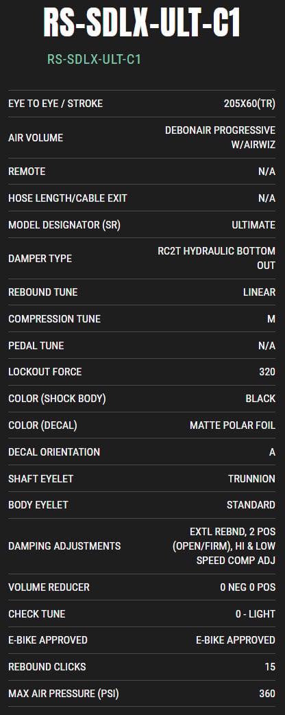

I would like to change my RS Deluxe Select+ damper to a RS Super Deluxe Ultimate damper. can you please send me the serial number of your RS Super Deluxe Ultimate , so I can check trailhead which Ultimate I need - thank you very much!
Here you go. Hope this helps

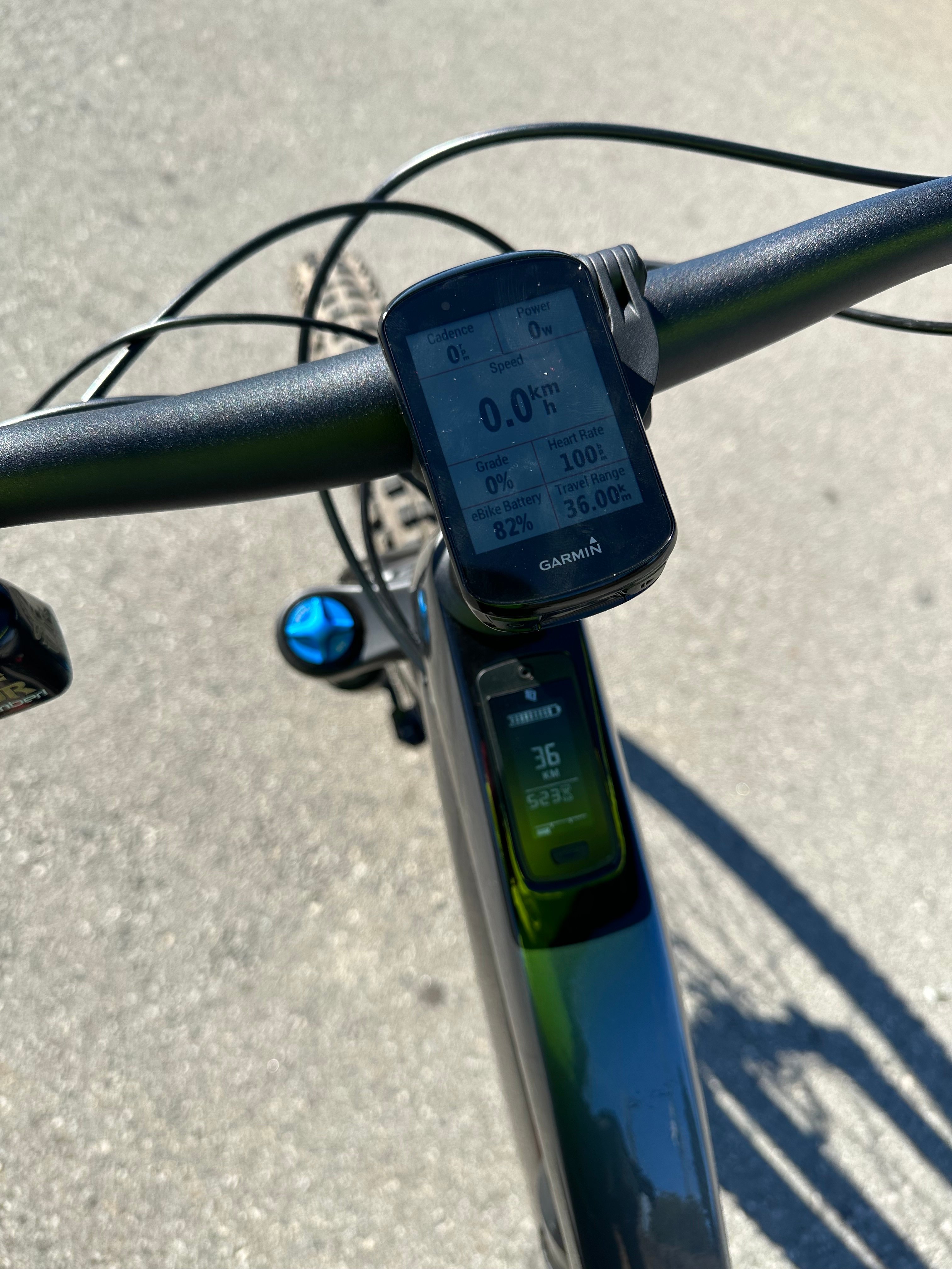

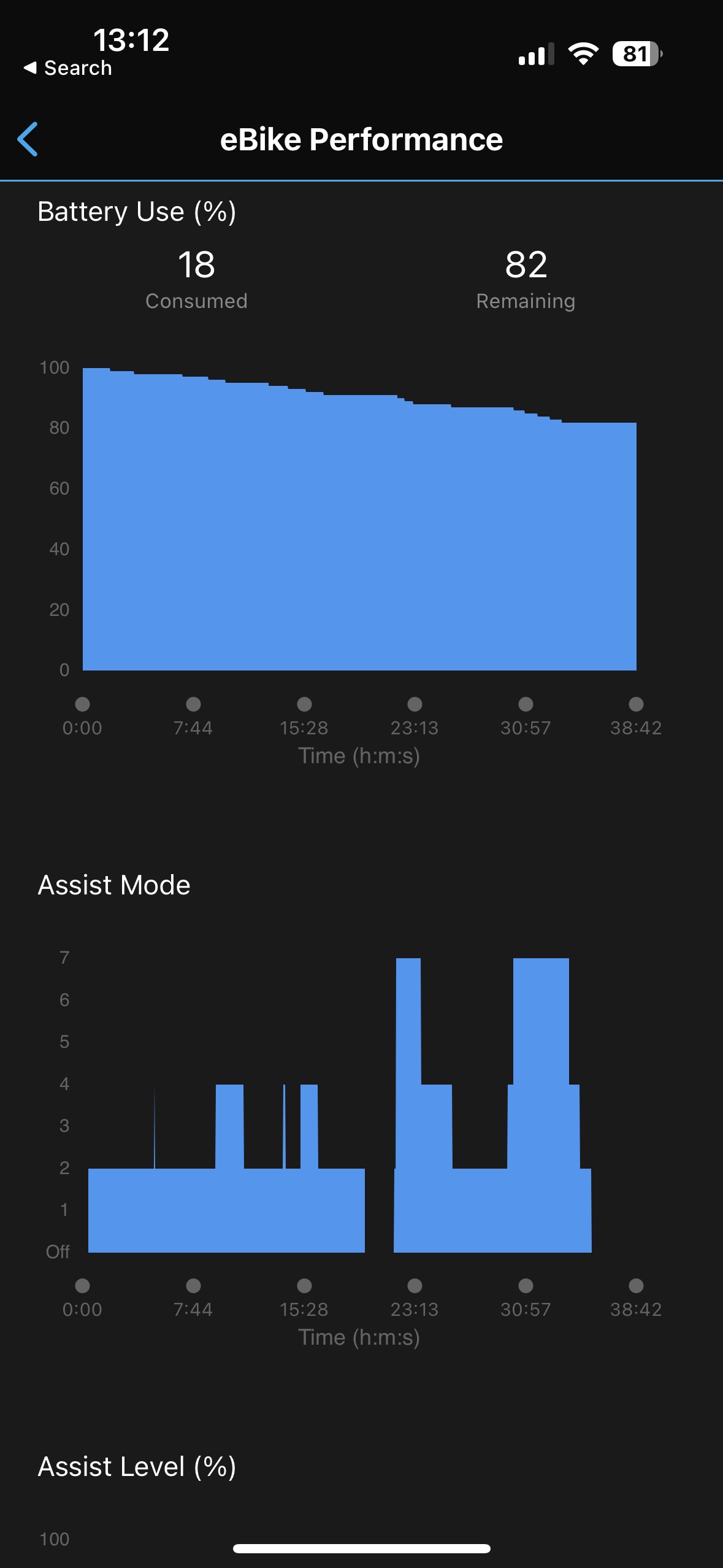

When using the Garmin, you can see afterwards which assist levels you were using (in the Garmin Connect app). Not in percent, though. It shows as 2, 4 and 7. (Also pictured is my garmin mount).

This is with the Wahoo app too. Very interresting to analyze afterwards.
Yes,it helps you work out how long you spend in each mode,and therefore gives a clue as to which mode you should tweak to get more range.

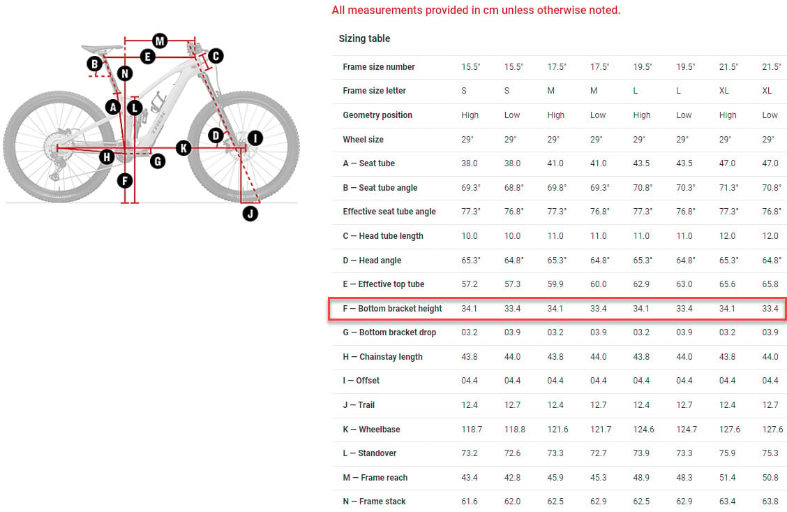

Hi guys, new around here. This awesome thread got me on a Fuel EXe, so thank you, its a great bike! This is the definitive internet source for real world experiences on the Fuel Exe!
BUT: I want to mullet my ride, especially coming off a long stint on 27.5 bikes. This bike has been described as being "lively", and I think a big contributor is the much lower than quoted BB. I do think there is a important error on the geometry chart as quoted by Trek in terms of the BB height. I measured 5 different bikes in Sizes small to large and I can't find a stock bike (29", 150mm fork) with a BB height higher than 342mm, in high setting. Which makes me think in 29er stock form, this bike runs 340-342mm(high), instead of quoted 349mm. Similarly, it runs ±335mm(low), instead of quoted 342mm. My size small with a 160mm fork is at 342mm(high), and with a 150mm fork, its 339mm(high). In Mullet form with a 150mm fork it is 330mm(high).
This should be fine if you run 29 FR/RR, but with a BB drop of 8-10mm in mullet 29FR/27.5RR, it really put this bike into lowest of low territory, and not really "mullatable" as marketed by Trek. If you run it in high, For reference my 27.5 160mm fork bike in size small was 345mm.
Its likely that I am overthinking this!! :) Maybe I should just ride it LOW...
Anyone wants to chime in on their bb heights? @Emailsucks98 what is your BB height with your mullet, 150mm?
I think you ended up being pretty close to correct. Trek seems to have updated their numbers to be closer in line with your bb heights. 341 high and 334 low
